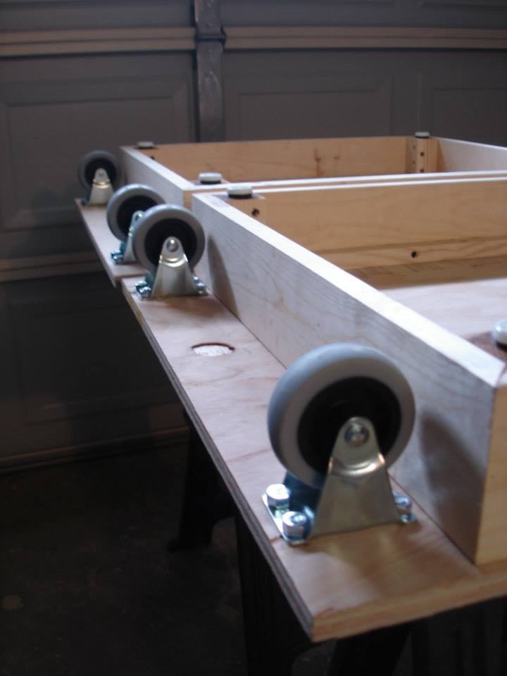

Day 2 - Built the cabinet base. I'm looking forward to getting those pretty sides up off the ground so I don't chip the edges.
I had some strips of oak veneer plywood sitting around and thought it would work well for the base. Tomorrow I'll hit this with primer and paint. I used the build video from Canadian Arcade.
Goals for tomorrow are to follow Zinger's process of installing batons in the interior to avoid drilling through the sides.
mwhitney

Day 3: Primed, sanded and painted the base. Also, started adding batons inside to affix the panels.
QUESTION: What should the interior spacing be between the top panel and the shelf?
I've read 5.875" or app. 149.23 mm. I have my batons set to about 149.61 (off only because of builder error ;) ). Does this sound about right?
Almost completed one side's blocking - this took a ton of time and triple checking.

Made a bit of progress tonight and sorted out the spacing at the top. 135 mm from the underside of the top panel to the top side of the shelf... hopefully I've got it right ;). Many thanks to Zinger for some tips along the way.
Tonight I buttoned up the batons on the one panel and added the key. I followed the measurements exactly from Gaetan's plans but I had to trim a bit off the front-most edge of the key because I'm using 3/4" material. Had I left it, the front panel would have been a bit to close to the edge so I trimmed about a saw blade width of that leading edge.
View from the top:
Also, picked up some nice wheels while I was in Florida a few weeks ago. Twisted Quarter has some great parts so I had them send me the wheels, a coin door, T-mold and my router bit.
Here's my first issue. I failed to measure the wheel height and the wheels are about 1/8" taller than my base height.
Here's the base and bottom assembled:
Here's a closer view. I haven't bolted the wheels on but you can see how they lift the base slightly.
Any ideas here on how to resolve this apart from rebuilding the base? The only thing I can think of is to get some leg levellers for each corner, or, buy some new wheels but I'm not sure if the size increments for wheels are that specific. I'd need one that's about 3.5".
I guess another solution would be to build up the corner braces inside the bottom frame to sit flush with the bottom edge and then nail some of those vinyl furniture feet into them. This would likely raise things ~.25".
Silly mistake...

You can either route the bottom wood panel down in the location of the wheel bases a 1/4 inch to recess the wheels slightly....or you can just get some leg levelers like you said, which I think is the best and easiest solution.
If you extended those corner braces on your base down so they were flush with the bottom of your base, (or the same length) you could just get some cheap nail on nylon pads for each corner ($2)....which would raise the base up 1/4-3/8 an inch.  I know this, because I have done this exact same thing.  The 3" wheels at Home Depot are slightly longer than the 1 x 4 pine wood base material I use as well.
https://www.amazon.com/dp/B00004YOIS/ref=asc_df_B00004YOIS4913288/?tag=hyprod-20&creative=394997&creativeASIN=B00004YOIS&linkCode=df0&hvadid=167142626629&hvpos=1o11&hvnetw=g&hvrand=5718039526752017850&hvpone=&hvptwo=&hvqmt=&hvdev=t&hvdvcmdl=&hvlocint=&hvlocphy=9028915&hvtargid=pla-277840444292
Perfect - I think this is the route I'll go. Is there an ideal placement for the wheels in terms of how far off the back they should protrude and how much space between the wheel and the floor? Thanks for the suggestion.

Well, the wheels you are using are shaped different then the OEM DK wheels, which go straight down...where yours curve out.  So you have som creative license as far as how much they stick out the back.  I always place my wheels 2 1/2 inches from the outside edge of each side of the base piece of wood....I can't remember if that is standard for a nintendo cabinet...and that's why I started doing that.  I use straight mounted 3 inch wheels so they are usually flush with the back of the cabinet and you really can't see them....but again, it really doesn't matter because you have some artistic freedom....as long as they do the job.
As far as the height off the floor, once you get those nylon padson there it will be the perfect distance.  See, like you I had the same problem. Haha.  :cheers:

This is helpful, Wyo - thank you. The photos are great for reference. My wheels actually pivot which I'm thinking may not be the best. I picked up 4 of these anticipating that I may* (read as most likely will) build a second cabinet. Now I'm thinking I could* just put 4 wheels inside the frame in each corner which would raise the whole cab equally off the ground... just a thought. The weight may keep it in place or it may move around too much... tough to know for sure without trying it out. I may resort to picking up 2 fixed wheels if these don't pan out.

Not sure the exact measurement, but as you can see here not much..1/4" maybe?  I forgot when built these two cabs I was constantly referencing my original DK cab I had at the time....so the measurements were pretty accurate.  The front panel buts up directly to the front of the bottom wood panel, so that puts the base back under about 1/4 inch plus the width of the wood you are using.  I used 5/8 wood...where as you are using 3/4.
I don't know if you are in the US but if you are and decide to go with the straight wheels, Home Depot carries the 3" wheels for about $8 each.
But like I said, you have creative freedom since you aren't building a total rep, so I think 4 wheels with casters would definitely make the cabinet easier to move around....instead of having to do 3 point turns all the time. Haha. :)

Perfect - my base has about the same spacing. RE the wheels, four may not be such a bad thing if the weight of the cab keeps it relatively still. I'm in Canada and we have HDs here but if I can keep the expense down, that would be ideal. It's only another 20 bones, but things are adding up - $70 on paint and supplies today (add that to the list of receipts my wife doesn't need to see ;) ).
Worst-case, the cab moves too much and she goes up on her back for the leg levellers and new wheels. Since this is not an authentic DK replica as I'll be adding my own graphics etc, these details aren't as important as if I were a DK3 purist.
OK - I've beaten this detail to death - onward and upward!

Hard at it this weekend and made some good progress.
Wheel base was too long so had to trim and drill some new holes:
That's a better fit:
