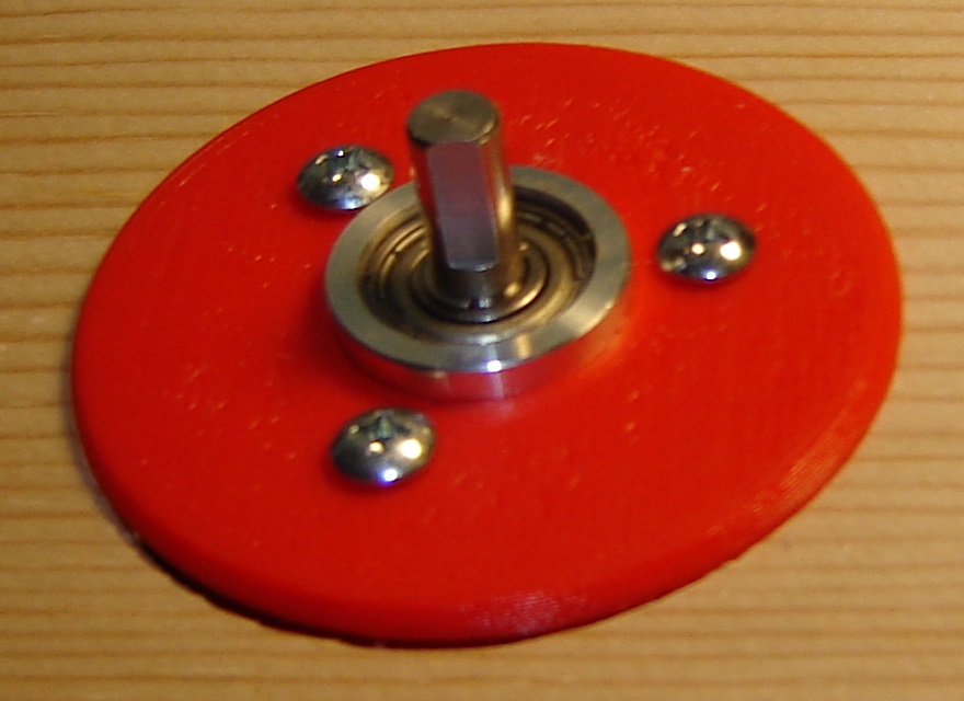

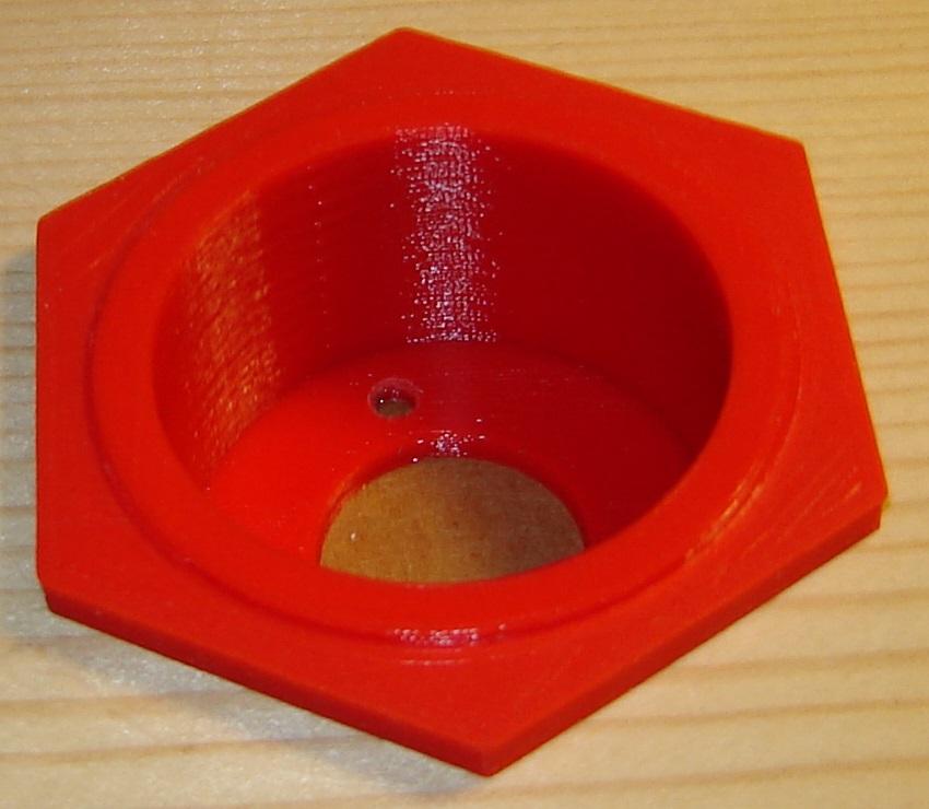

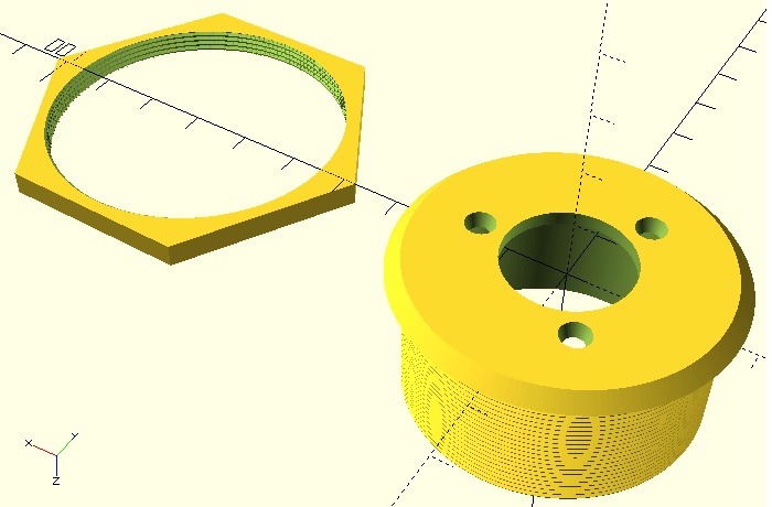

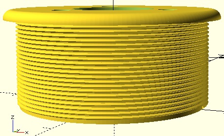

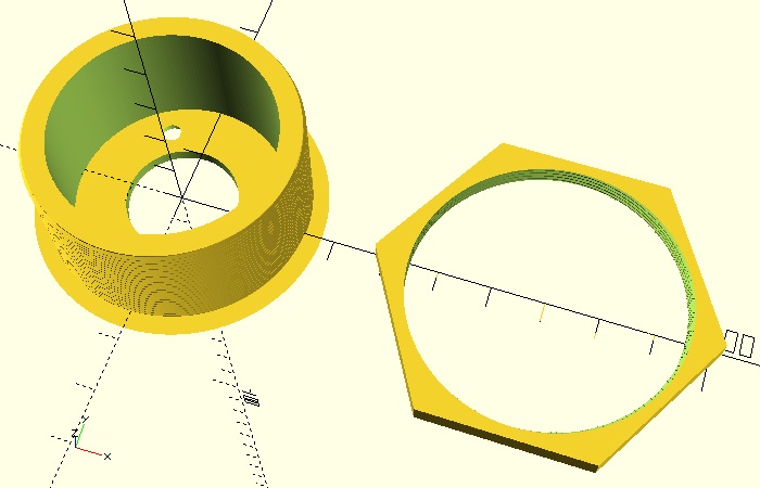

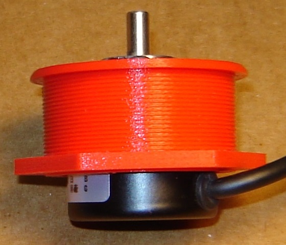

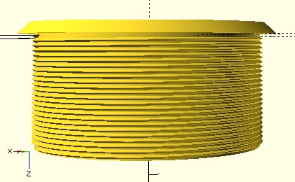

For anyone who missed Marsupial's  Build your own HID-mouse compatible spinner project, here are two parametric mounts created in OpenSCAD.
The first one has a chamfered bezel.
- The OpenSCAD code generates a model with both the nut and the mount.
- The .zip files linked below reorient the mount so it is print-ready. (i.e. face down)
- Be sure to download the .zip files for both the desired mount and the nut.  The mount .zip files do not include the nut.
Code: [Select]
// Rotary encoder mount and nut created using thread library found at https://www.thingiverse.com/thing:31363
// Metric Screw Thread Library
// by Maximilian Karl <karlma@in.tum.de> (2012)
// only use module thread(P,D,h,step)
// with the parameters:
// P    - screw thread pitch
// D    - screw thread major diameter
// h    - screw thread height
// step - step size in degree
module screwthread_triangle(P) {
difference() {
translate([-sqrt(3)/3*P+sqrt(3)/2*P/8,0,0])
rotate([90,0,0])
cylinder(r=sqrt(3)/3*P,h=0.00001,$fn=3,center=true);
translate([0,-P/2,-P/2])
cube([P,P,P]);
module screwthread_onerotation(P,D_maj,step) {
H = sqrt(3)/2*P;
D_min = D_maj - 5*sqrt(3)/8*P;
for(i=[0:step:360-step])
hull()
for(j = [0,step])
rotate([0,0,(i+j)])

The second one  has a rounded bezel.

Installation instructions:
1. Drill a 2"/50mm hole in your 3/4" thick (or less) control panel.
2. Fasten the mount to the CP using the nut.
- Keep in mind that it is very easy to cross-thread if the nut isn't kept level.
- Use the "turn the nut backward until you hear a click then turn it forward" trick to avoid cross-threading.
3. Fasten the encoder to the mount using M3-0.5 x 8mm screws.
4. Install the knob.
Links to .ZIPped, ready-to-print .STL files made using the OpenSCAD code above:
    Chamfered mount - http://forum.arcadecontrols.com/index.php?action=dlattach;topic=164992.0;attach=387887
    Nut - http://forum.arcadecontrols.com/index.php?action=dlattach;topic=164992.0;attach=387888
    Roundover mount - http://forum.arcadecontrols.com/index.php?action=dlattach;topic=164992.0;attach=387889
*** Be sure to download both the desired mount and the nut. (the mount .zip files do not include the nut) ***

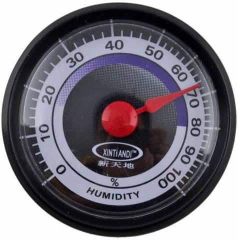

A small (2" diameter) analog hygrometer (humidity meter) like this one is an easy way to see how well your desiccant is -- or isn't -- working.
- It fits inside the hub of most spools.
