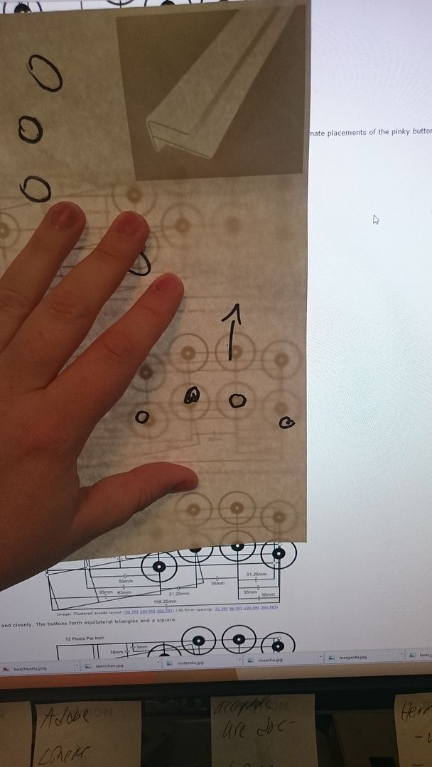

Next Up - Control Panel Design
I've seen a lot of discussion and stress about control panel design.  Specifically with button placement.  I know I want a 2 player panel as the number of times I'll have more than that playing will be waaaaay fewer than the amount of times my wife will ask me why I built that giant piece of crap.
I also figure that this probably won't be my last build.  If I want to play 4 player games, I'll just plug the control panel and monitor of my second cabinet into the first cabinet.  Pow.  Instant 4 players spread out over 2 cabinets.  That took away any stress I felt about not having enough space for players.  Even if the cabinets aren't in the same room, my house is wired with Cat6 network cable.  I can just use an HDMI over ethernet and a USB over Ethernet extender and solve the problem.
I also want to keep the number of buttons to a minimum.  Easy as possible for people to play and figure out.  I've landed on 7 RGB LED buttons per player, 1 and 2 player start, exit and pause.  I think I can do everything else from combinations.  I might hide a shift button on the top of my cabinet, but I'll cross that bridge when it comes.
The RGB LED is important because it will light up what buttons to be used for each game or system.  I would imagine "dead" buttons would cause a lot of confusion to people.  Having the correct ones lit up would probably take care of that.
 When I was trying to figure out the button layout I went around in circles from traditional and non-traditional.  Again, trying to keep withthe theme of easy, I thought that 2 evenly spaced rows of 3 or 4 would be better.  then it struck me that most of the people who will play this thing haven't been to an arcade in 20 years.  It's not like there's a lot of muscle memory to be retained, its there?
So wit htat freeing thoguht, I set out to find the perfect ergonomic button placement.  Here's how I did it:
I took a scrap piece of paper and then wet my fingers under the kitchen faucet.  I laid the paper down at the right height on my kitchen counter and proceeded to madly "button mash" my wet fingers on the piece of paper.
The result was the exact places where my fingers naturally fell.  I circled those with a black sharpie
Then I pulled up the button layouts from slagcoin.com held up my piece of paper to the monitor and scrolled down the list until I found something that lined up with the black dots.
Voila.  A near perfect match with the Sega style button layout (ecept for my pinky).  I have giant steam shovel hands, so I'll probably just stick to the layouts on slagcoin.  Easier to measure and drill and a good compromise between what I want and the correct size for regular people hands.
« Last Edit: May 10, 2015, 02:22:35 am by uberkirby »

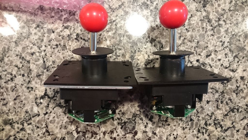

My Controls arrived !!!
Here's my U360's with the long shaft and restrictor installed.  Pretty happy with these so far.

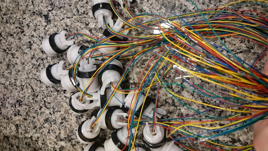

Got the LED buttons to.  Definitely some assembly required on these.  Put the LED and the diffusers in them all.  I was pretty sure that the website said the wiring was "ready to go" .  This is definitely not ready.  Not a huge deal but something I wasn't expecting.

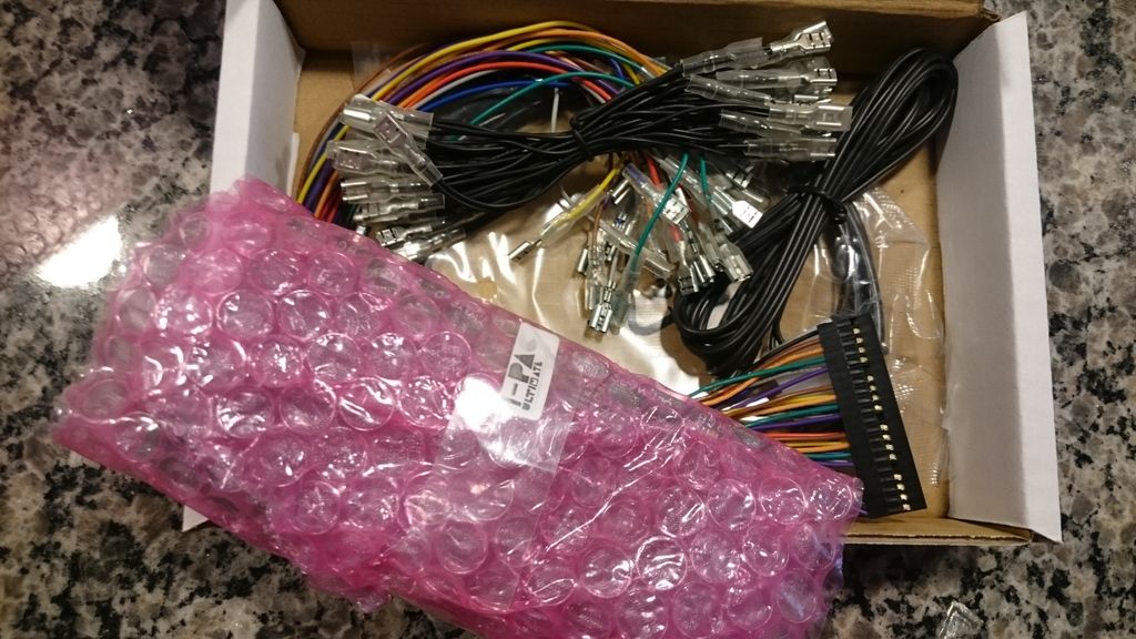

Here's the Ipac Ultimate.  These wires are ready to go which will save a bunch of time

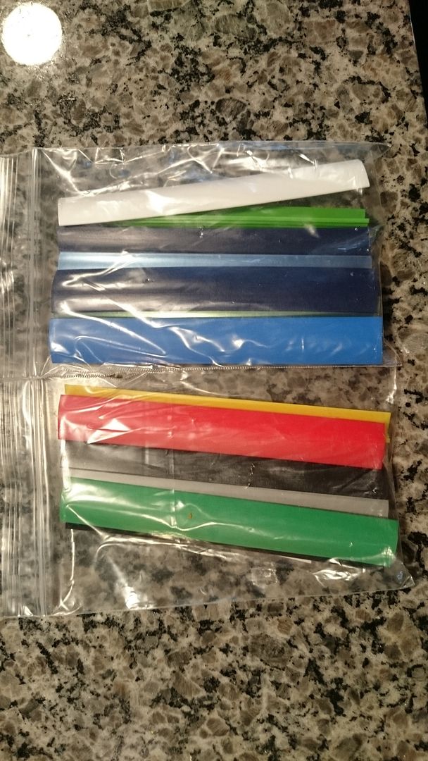

Also got my free samples from tmolding.com.  The red should do nicely for what I have in mind.

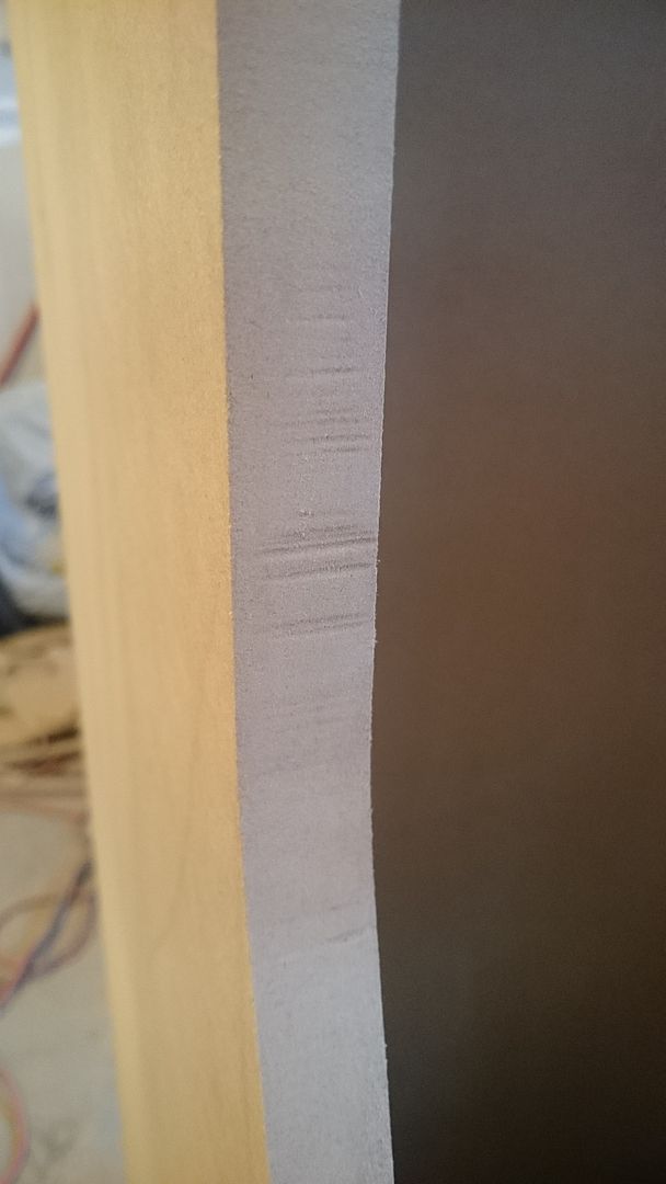

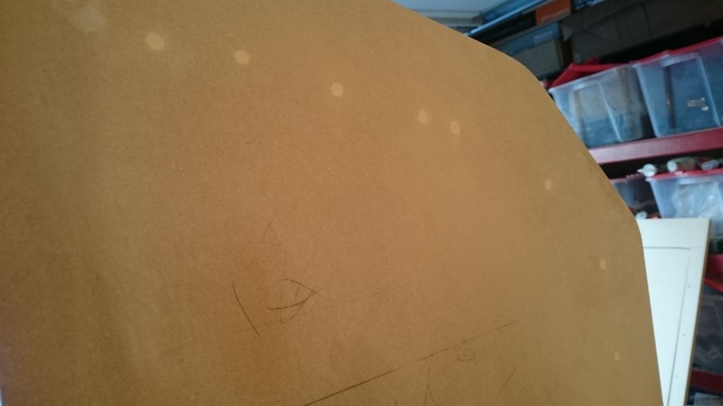

Here's what happens when your router sucks and you don't now what you're doing.  30 seconds of sanding fixes that up.  My new router with the same bit hasn't had this happen, so I'm inclined to blame it on the crappy Black and Decker I used on this.
I didn't support the cut for my control panel properly and this happened.  A quick clean up cut with the tracksaw/sawboard and it will be fine
Also got the angle wrong.  Some wood filler and more sanding will level that out
and the last problem on the panel was a little bit of overhang.  Another trim will clean it up
And here it is fixed up.  Mostly.

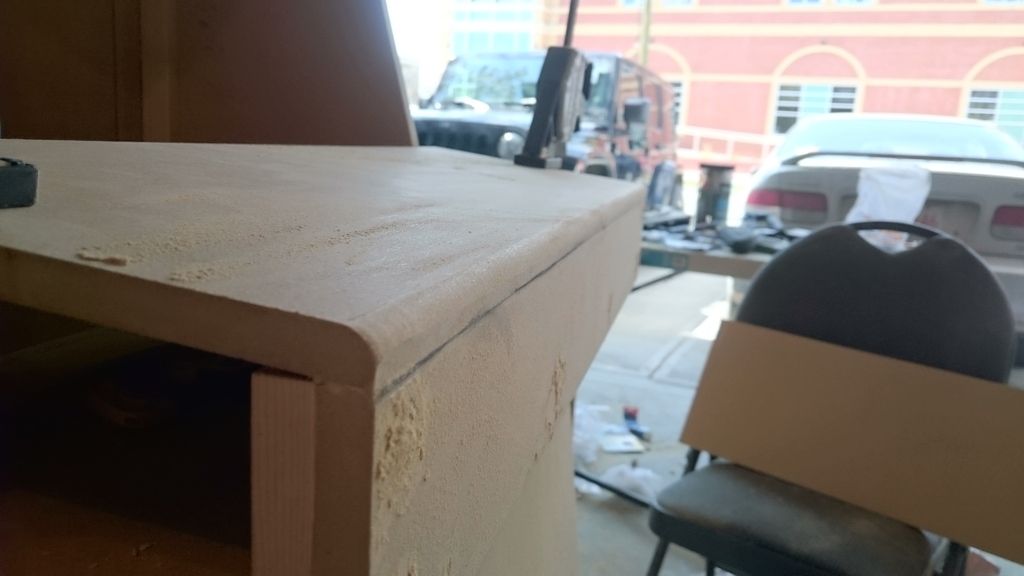

I trimmed it up, did some sanding, and filled some of the gaps with filler.  Note the super terribad job I did of filling the nail holes.  And pay attention later to how it doesn't matter at all.  Just fill it and sand.  And if you need to fill and sand some more.  No big deal.
Got the edges on the false front routed nicely.  The Dewalt router is awesome.  The front looks cool.

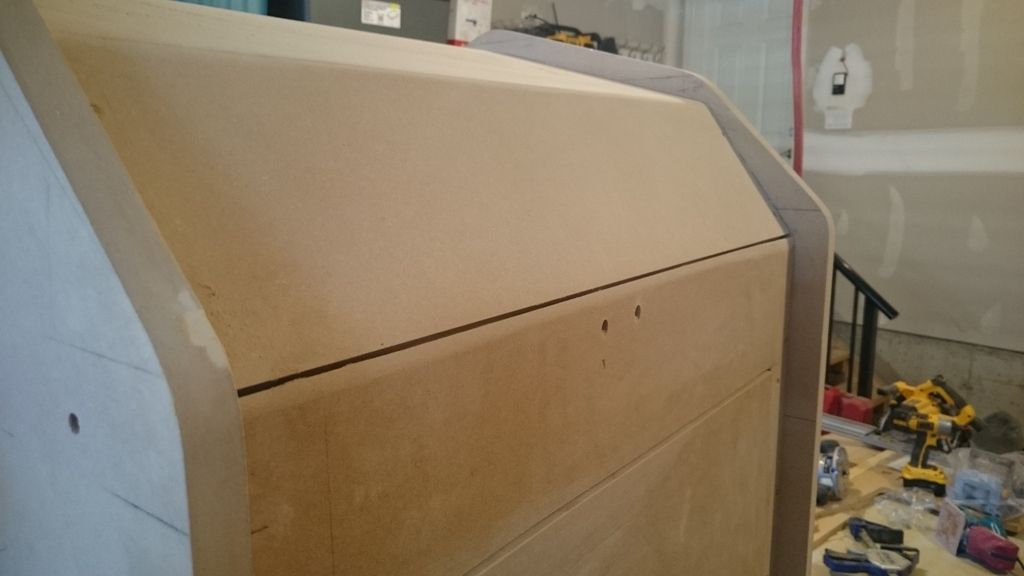

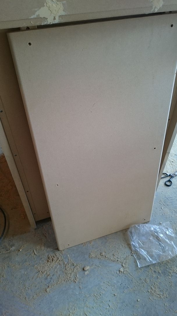

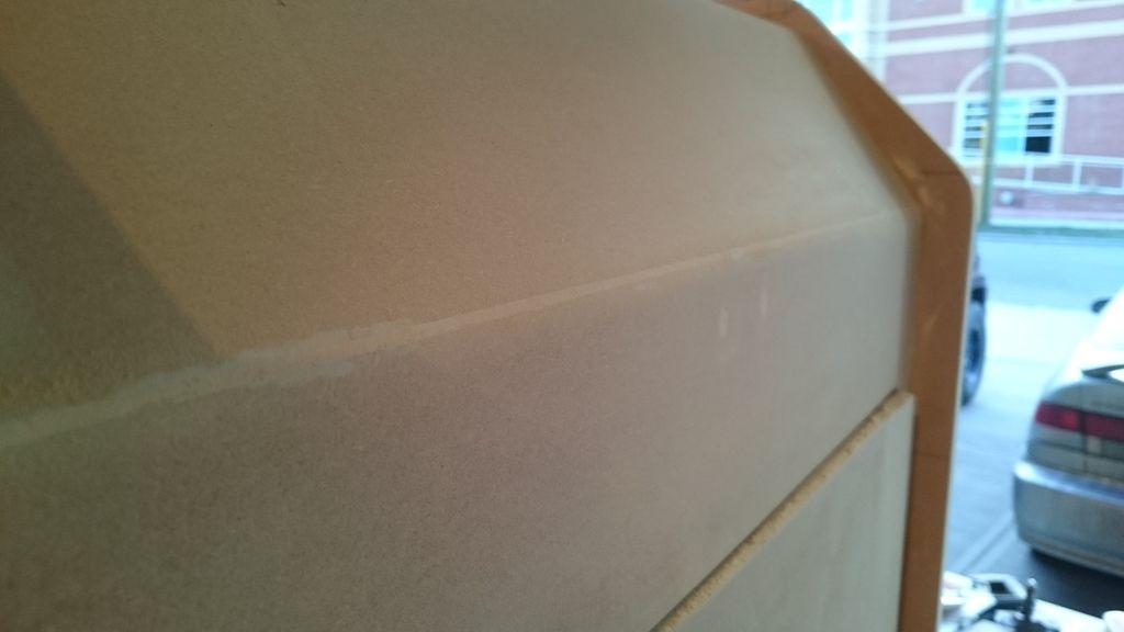

Check out the massive gaps between my panels on the top.  I cut these according to the plan, but there was no mention of any angles so I cut them straight.  Look pretty bad right?
Another gap in the front
More filler
More sanding and I'm completely satisfied.  Smooth as can be.

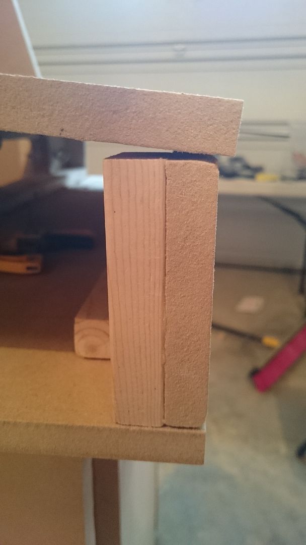

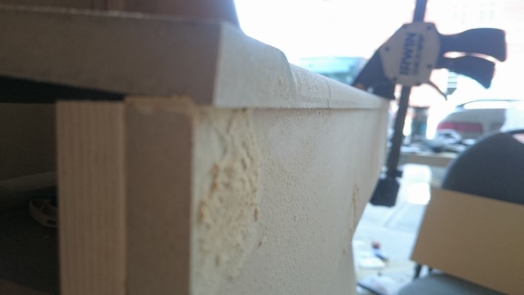

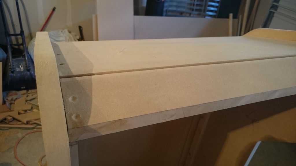

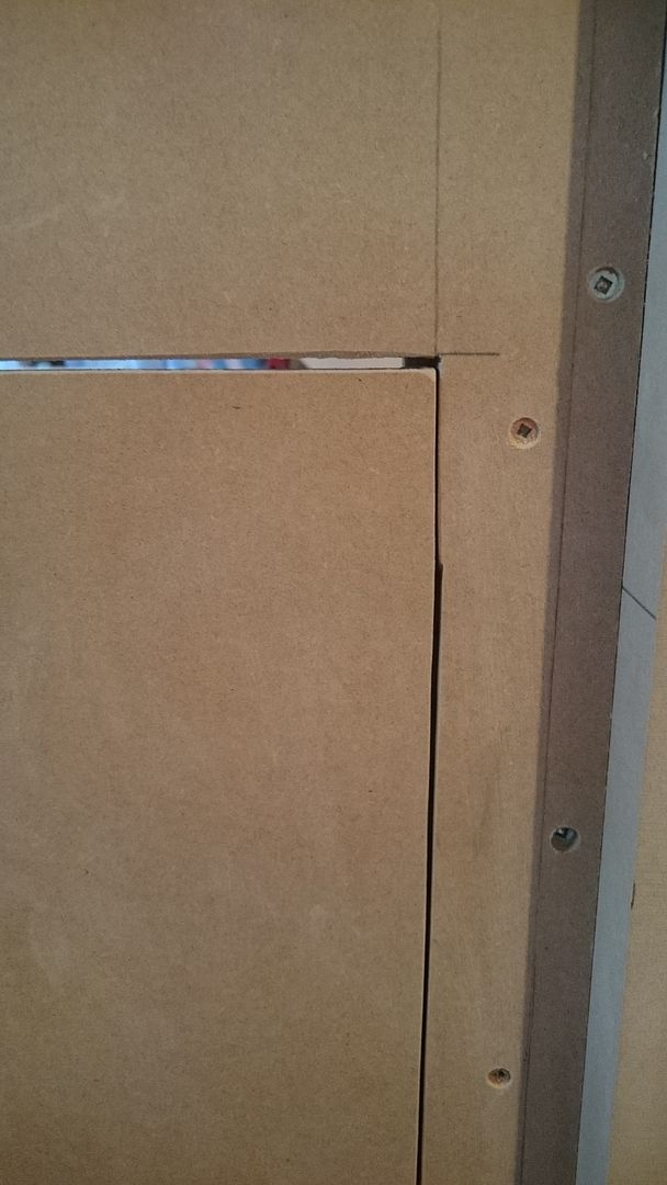

The gap in the front is a lot bigger and I don't want the panels to be able to move and crack the wood filler in the gaps, so I dug through my junk bucket and found an angle bracket.  Put it in the vice and bent it to the right angle, then screwed it to the inside panels.  This will be hidden behind the marquee so nobody will see it.

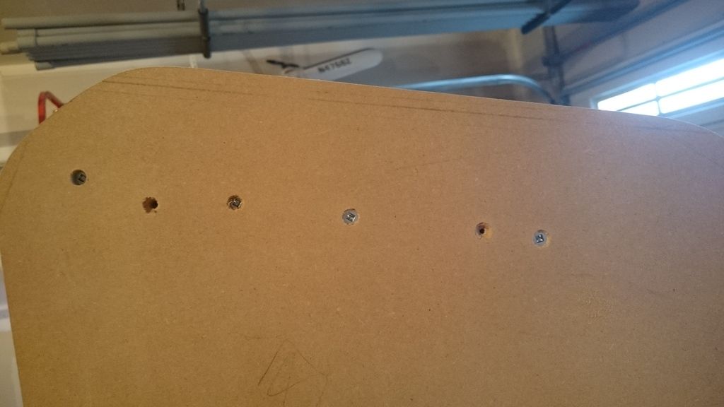

By this time you're probably guessing at where I'm headed with most of these.  Mistake.  Wood filler.  No mistake.
Here's a few where I measured incorrectly and missed the inside firring strips or where I stripped the MDF and could get a bite with the screws.  Yup.  More filling and who cares.  Not this cowboy, I'll tell you that for free.
Here it is filled and sanded.  A couple of the holes need a bit more attention, but that's a trivial matter.

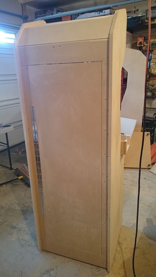

Here's my back door cut and installed.  Looks pretty reasonable, right?
How about now?  It was a tricky cut with the circular saw.  i wanted to save the inside piece to reuse as a door (different than the plan) so I had to basically plunge the saw into the panel part way through, trying to stay on the correct line.  Then finish the corners with the Jigsaw.  Yeah, the jigsaw drifted a bit.
Not sure if I really care since this is on the back of the cabinet where nobody but me will ever see it, but if it starts to bug me, I'll probably put some trim around the entire door to cover all the gaps.

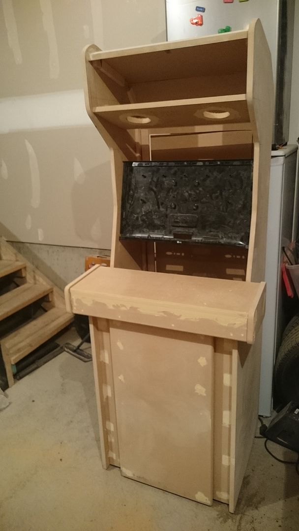

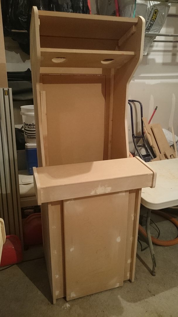

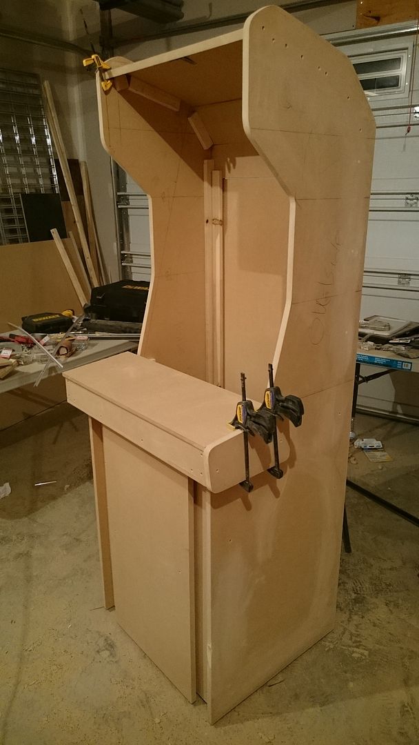

So this is pretty much where we stand at the end of today.  It looks like this, except the front panel edges and control panel edges have been routed and some of the gaps and holes have been filled.
I'm already getting some awesome responses from people when they walk by on the sidewalk.  That's been keeping me motivated.  Yes, I'm a whore and I'm feeding on the attention.  waddayawantfromme?
At this point I've put in about 3 days of work and/or parts runs to get to this point.  No idea how much planning and daydreaming time, but I wouldn't even know how to measure that.  I'm up to date with my posts and pictures so anything new will be coming as it happens.
So, hopefully, you can see that for all my lack of skill and knowledge regarding wood working, I've been doing my best at each stage of the game and despite the mistakes, the result still looks pretty reasonable.
If you are on the fence about starting a build, or even if you've previously said "Love to but I don't have the required skills", I encourage you to think about it again and give it a shot.  Can't do too much worse than me on a lot of this stuff and, as you can see, the impact is pretty minimal.
I'll continue tomorrow.  I would love to get the speaker holes cut, the monitor mount built, and a new 3/4" control panel cut - I want to try something with the joystick mounting
« Last Edit: May 10, 2015, 02:18:00 am by uberkirby »

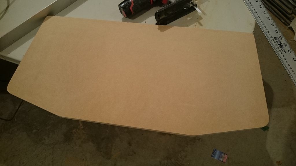

I got tied up yesterday and didn't get much done.  today was a different story.
Inexplicably, I wanted to try out my new biscuit joiner and ended up starting a totally separate control panel.  My reasoning is a bit of a blur but I have an idea I want to try:
Top panel cut and sanded
Side pieces of the box cut, sanded, and traced
Dry fit
What I'm going to do is build a completely standalone control panel roughly laid out like a 2 player Tankstick.  I'm going to put an Intel NUC small form factor computer in the control panel and just expose the HDMI out and power cables on the back of the cabinet.
2 small fans on the back of the control panel will keep air circulating.
The idea is that when I go to somebody's place, I can take along a completely armed and operation arcade machine with me just by grabbing the control panel.  I got distracted yet again before I could finish the joints.
uberkirby

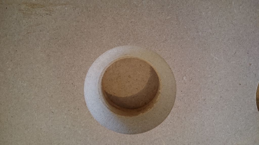

i played around with different control panel options and ended up drilling out a jig for the control setup I like best.  not I can just clamp it down on any future control panel, and route out the controls without needing to do any measuring.  I somehow missed taking a picture of the final product.

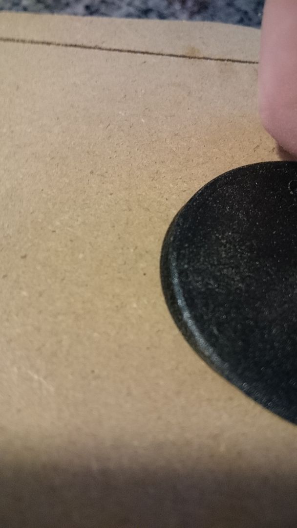

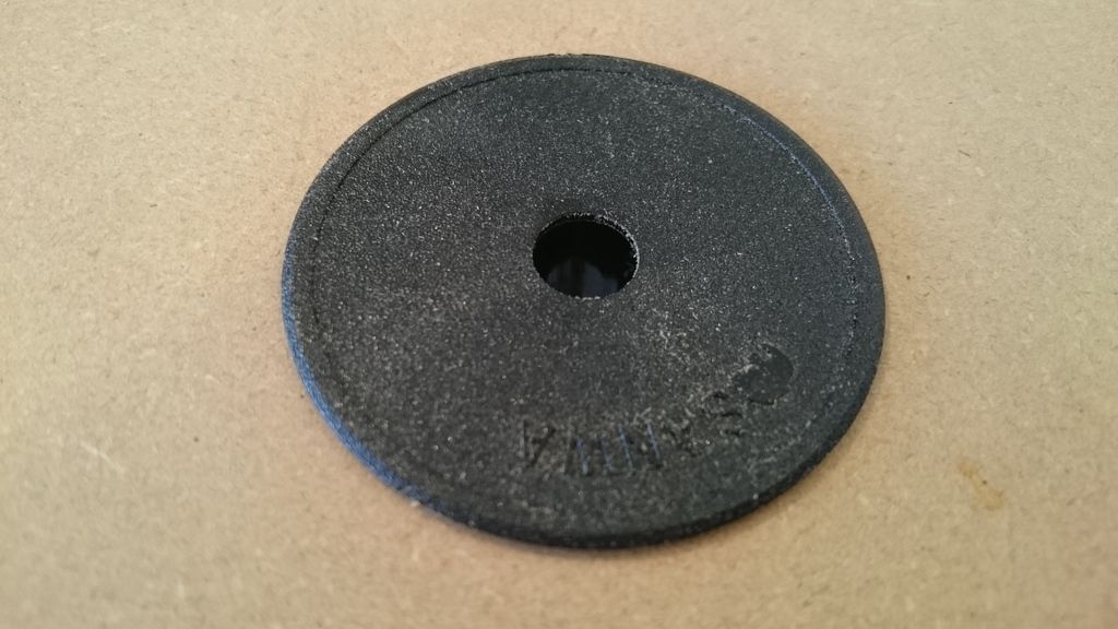

As part of the process, I also played around with different ways of mounting the U360 joystick.  I have the top mounted restrictor plate which is supposed to be mounted on top of the panel so you can easily switch from 4 way/2 way/analog.  The restrictor sits up above the control panel so you can grab it with your fingertips.  Problem with that is you can't use a dust washer like that.  For aesthetics, I want a dust washer, so I tried a few mounting options.
One that worked really well was adding another piece of 1/8" MDF below by 3/4" control panel and then mounting the joystick underneatt.  i used my router with a chamfer (I think that's what it's called) bit to cut the hole out a little wider at the top so you can lift the dust washer up and still use your fingers to adjust the restrictor plate.  Worked really well.
Here's the hole
http://i38.photobucket.com/albums/e138/kengel_photos/Cabinet%20Build/DSC_0071.jpg

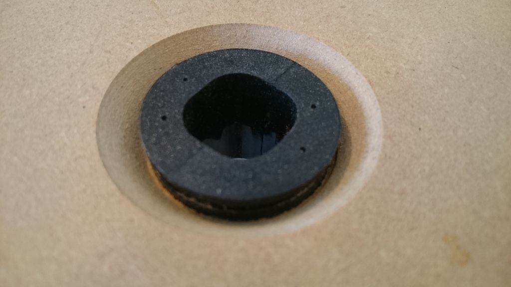

Here's the joystick mounted
And here it is covered with the dust washer.  Exactly what I wanted.  No hole is visible
the one small issue is that with full articulation, the hole becomes visible again.
Here's full articulation with the 8 way.  Just barely exposes the groove on the bottom
Full articulation with the analog setting (no restrictor) is a different story
http://i38.photobucket.com/albums/e138/kengel_photos/Cabinet%20Build/DSC_0078.jpg
I don't think I care that much but if it bugs me when the cabinet is finished, I can make/order some custom oversized dust washers.  they don't need to be that much wider.  We'll see

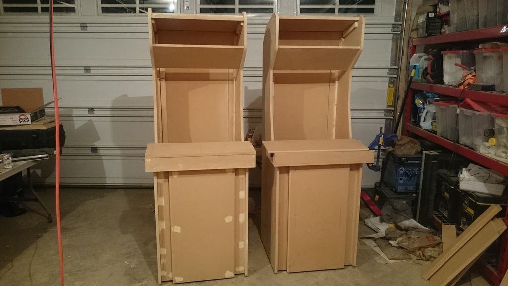

As for cabinet build progress.  Well, long story slightly less long, a buddy came over and really liked my cabinet, so we ended up doing this.
Ignore the bottom part of the marquee.  It's just pressed in there on both cabinets for the picture and are at a completely wrong angle.  Makes everything else look crooked which is not the case.
So we smashed out a second cabinet in record time.
I just need to buy my monitor, build my monitor mount, cut my speaker holes,  and finish filling holes and mistakes.  Hopefully finish that tomorrow.  Maybe putter away on the computer and software.

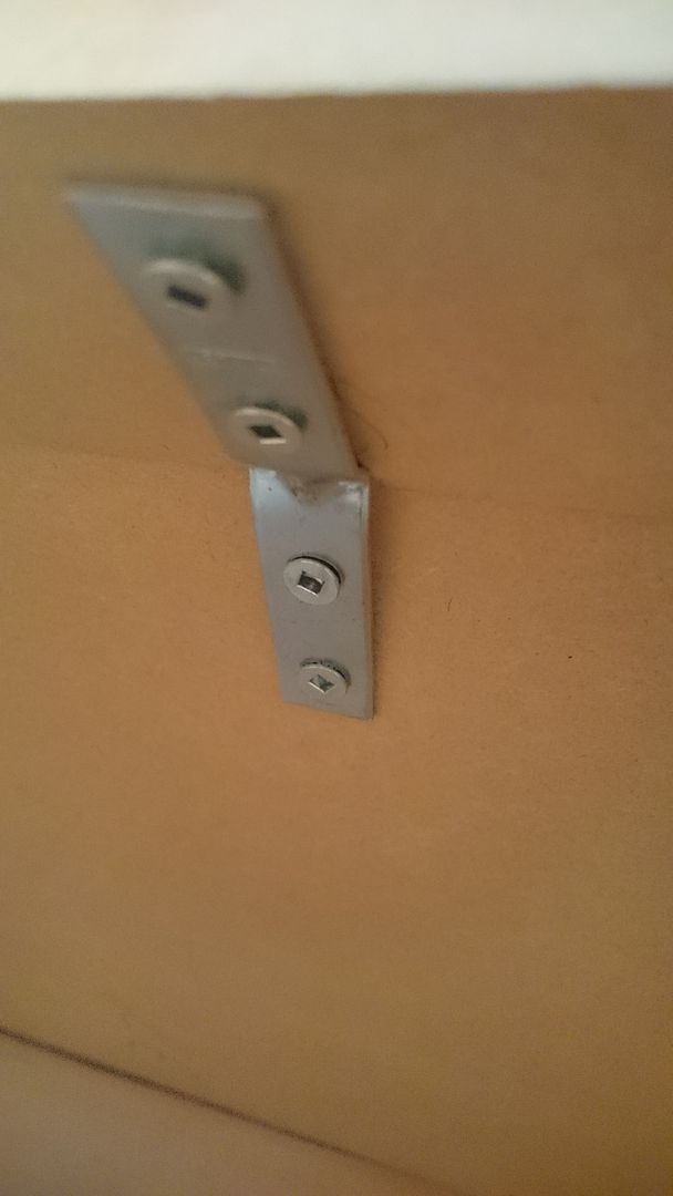

I couple of parts of the cabinet aren't 100%  square.  Like 1/8th out in some places.  Wherever it matters, a giant clamp and some wood screens puts that area back on track.

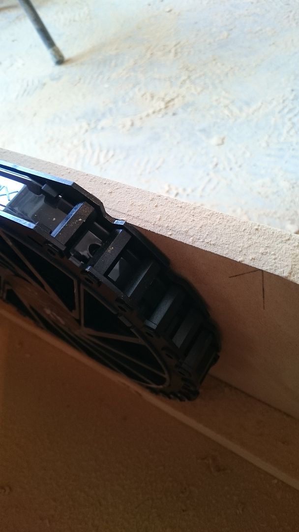

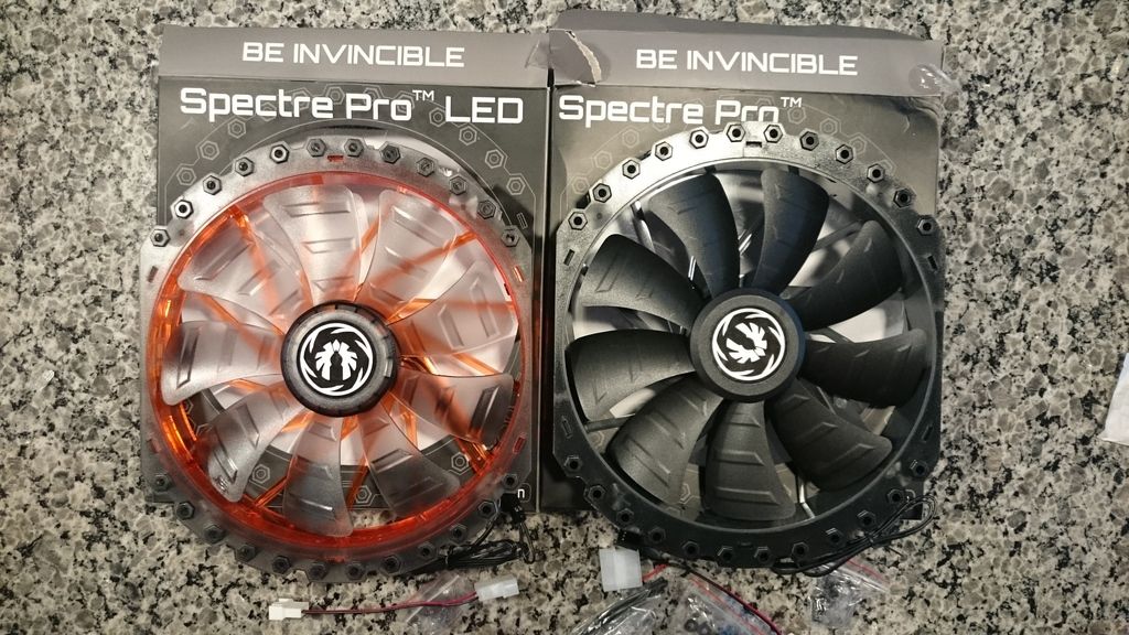

I was going to use this 230mm LED fan behind the coin door panel to blow some cool air into the cabinet.
But they are too tall and extend up into the slot that will eventually be used for a coint door.
So I just used a template like this and cut a couple of 140mm slots instead.  I think I might even like it better as it spreads the air flow over my CPU and my GPU.

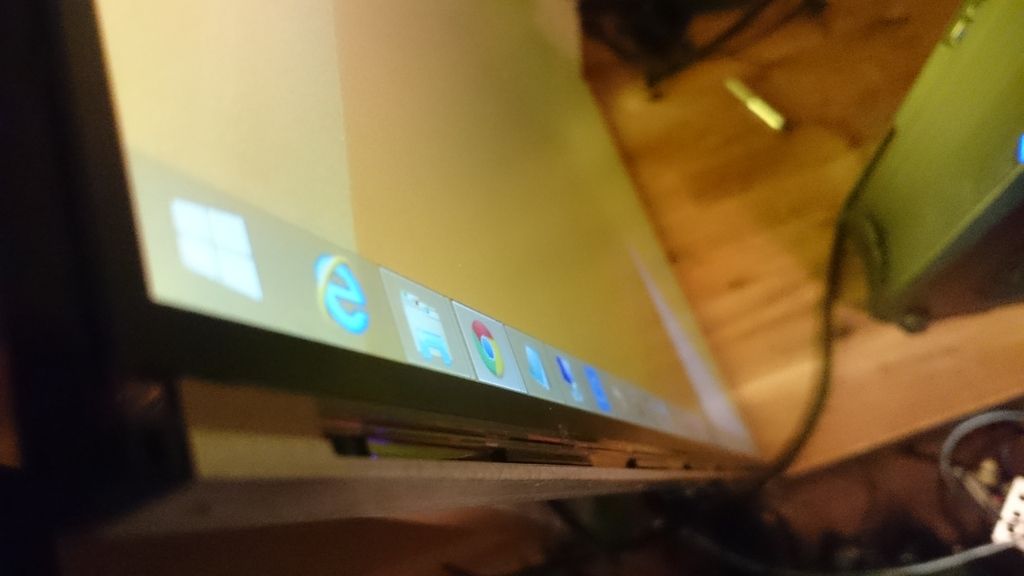

I found that the space allowed to me for the vertical wasn't enough to get a decent monitor in there.  I could only fit a 39" that, when flipped vertically, which would only allow for a screen 20" wide.  not what I'm looking for.
So I started the hunt for the biggest monitor I can fit in the cabinet.  Internal width is 24" so I wanted to get as close to that as possible.
Bingo.
Factory dimensions are 24.2" wide.  I figured I could de-bezel and gain that .2 back.
Sure enough, after doing that, the width was 23 15/16" and fit perfectly.  Height was 13 15/16 in case anyone was interested.
De-Bezel Pic 1
De-bezel pic 2
As an added bonus, I ran the bezel through the saw, cut the sides off  and now have the perfect mounting solution.  I'll put the cut bezel back on and use the VESA mounts on the back.

So after a couple more evenings in the garage I have the control panel sides on, the monitor bezel mounted, and the marquee bottom attached and speaker holes cut.
Here's mine.  Note the monitor bezel sans monitor.  I think I'm going to raise it up a bit, but this will definitely be my mounting solution.  24" wide mdf board + 100mm VESA hole patter = easy mounting
You can see more hole filling and smoothing I'm trying to do.  I obviously haven't quite figured out the best way to spread the wood filler.  I'm doing it the same way I would mud drywall and it's not working at all.  When I run the blade over the hole, it tends to pull the putty out of the hole as I pass over.  Mind you I've spent absolutely zero time trying to Google this.  Sanding is just so easy that I haven't bothered.
and here's the second cabinet a buddy is building alongside mine. Main differences are a simplified marquee top (The instructions were missing some measurements and directiongs, so he skipped one piece) and a 5/8" control panel top.
