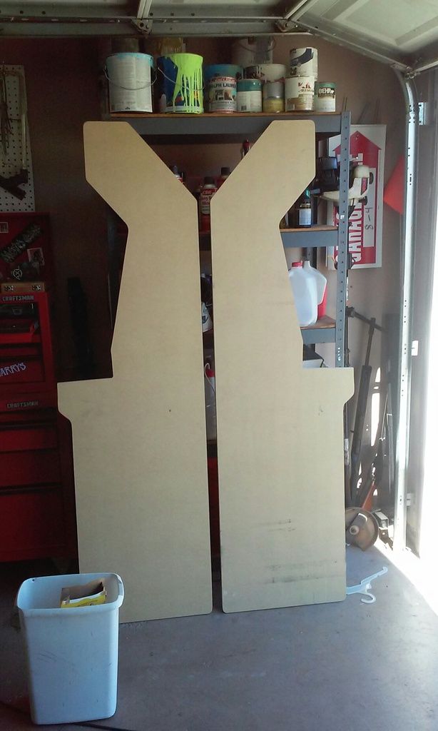

OK, long story short, my neighbor's been asking me for a while to build him an arcade.  So, I finally acquiesced and subject started taking shape over many many beers and a few nights of cards, etc.  So, when he mentioned that he wanted a totally 4-player cab with bells, whistles, chachkies, and cup holders (for you maximus!)....I started searching out cab designs that I could show to him to give him some ideas.  So, when I showed him Flynn's Arcade, he almost started drooling.  Meanwhile, I'd sketched up some z-backs, some slimlines, whatever and he was pretty well set on what I'd showed him.
ChanceKJ was kind enough to share the dimensions of the cab and the basic layouts...and I got to work.  This will be the build thread to memorialize my shameless copy of the Flynn's Arcade with a few changes and some other shortcuts and techniques that I have to use without a table saw.

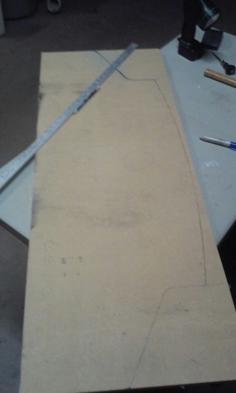

Sides cut:
The edges were armored using this process.  All of the shaped edges on the angles of the cab and CP box will also get this treatment:
http://forum.arcadecontrols.com/index.php/topic,122362.msg1310052.html#msg1310052
Batons applied (18 gauge nails and gorilla glued)

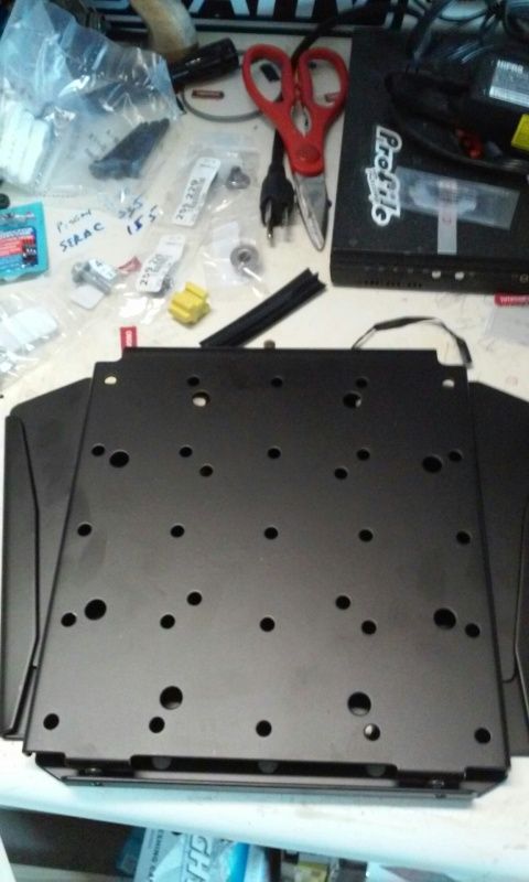

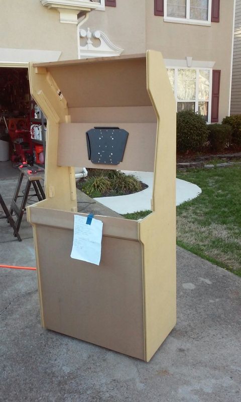

I found a sweet low-profile TV mount on flebay for 13 bux.  It's very heavy duty and is only 1/2" deep:

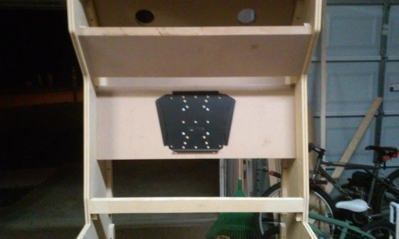

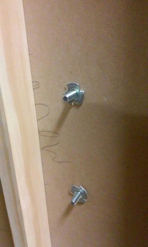

1x3 clear pine and 3/4" MDF monitor mount:
Centered and held in place with blind nuts and 1/4" bolts:

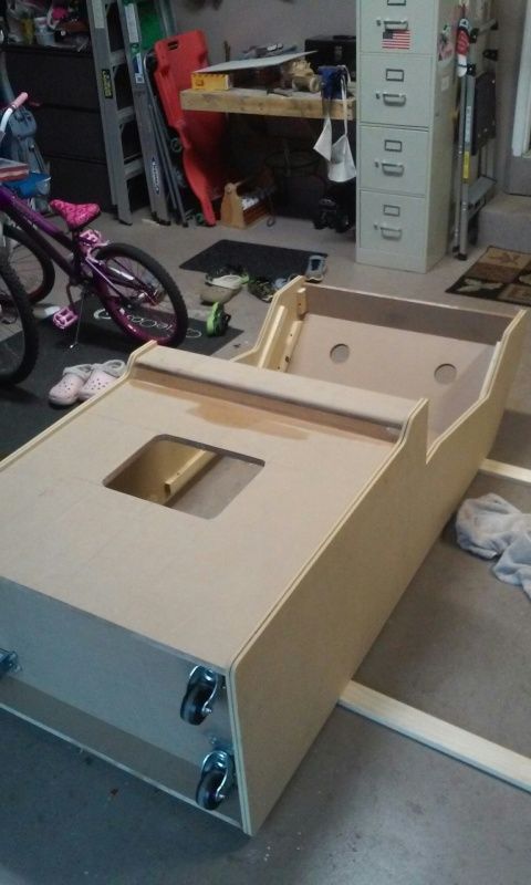

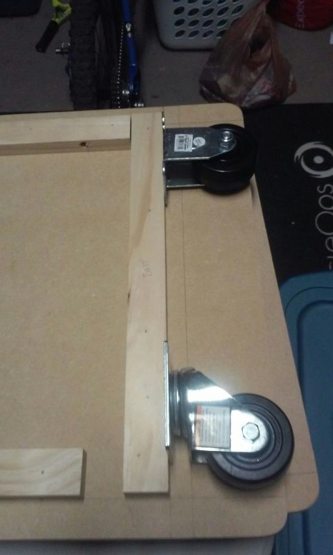

I'm going with castors on this one.  The right side (facing it) will have the swivel castors and the left will be solid.  It'll roll from the side because this thing is WIDE:
Mounting location found:

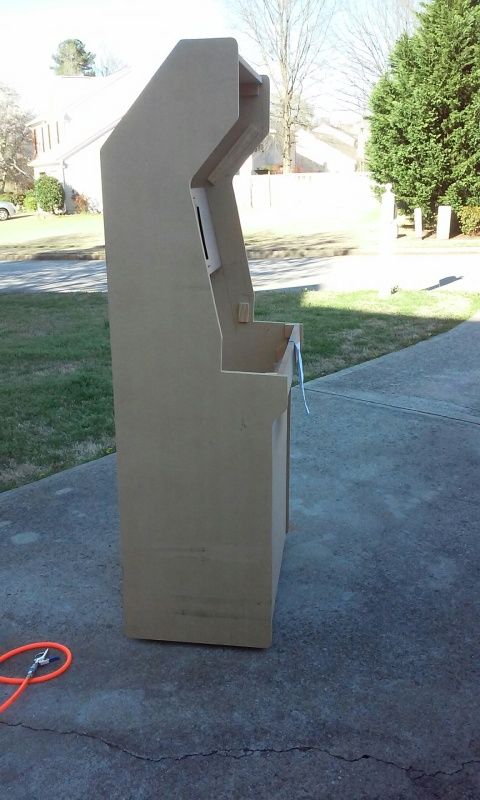

Standing on it's own for test-panel fit:
Wheel carriage designed, implemented and tested.  Handles really well!:
Finally, my new next door neighbors know what they're in for:
TV in place and mount fine-adjusted:

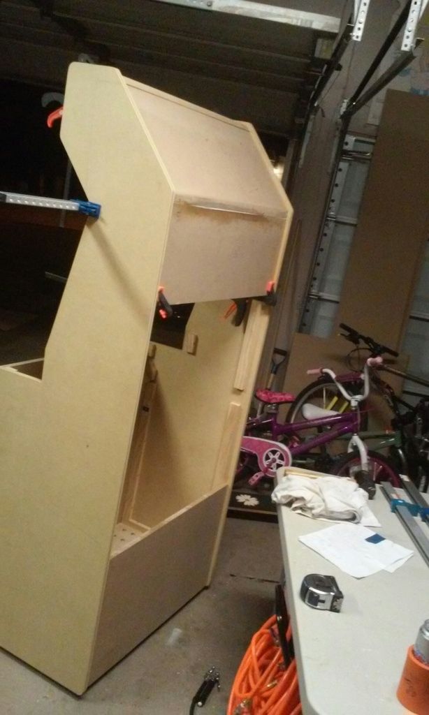

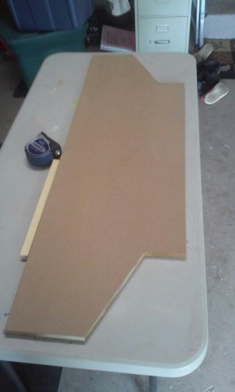

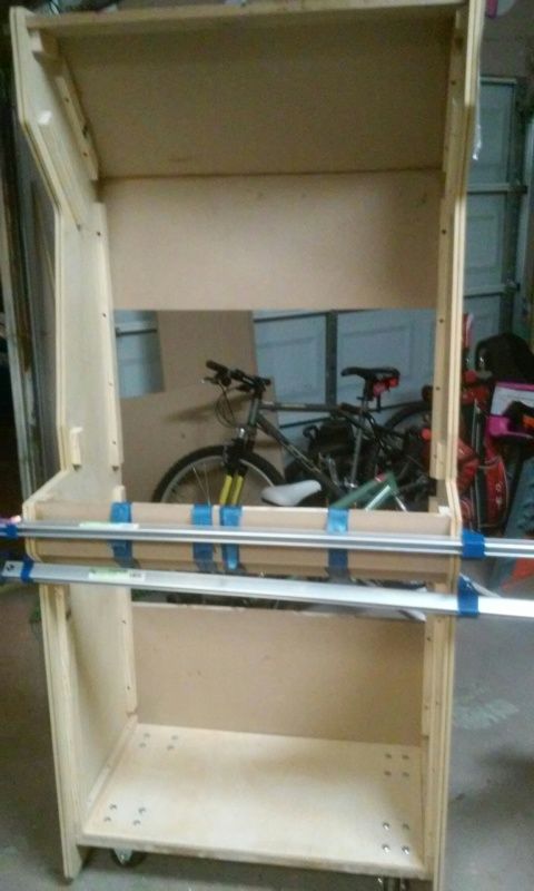

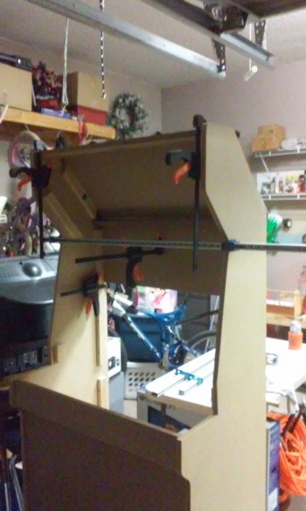

Top, back-top and top-back panels glued together after shaping.  Still needs a lot of hand-work since cutting these radical angles with a skil-saw and a straight edge is mind numbing.  I'm only about 1/16" out on one intersection and even less on the other.  It will require a minimum of wood putty:
My clamping web to get all the angles mated perfectly:

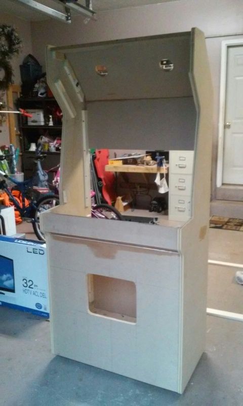

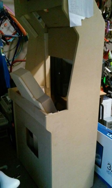

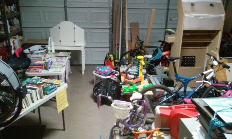

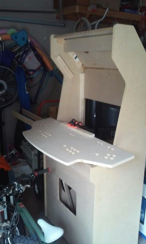

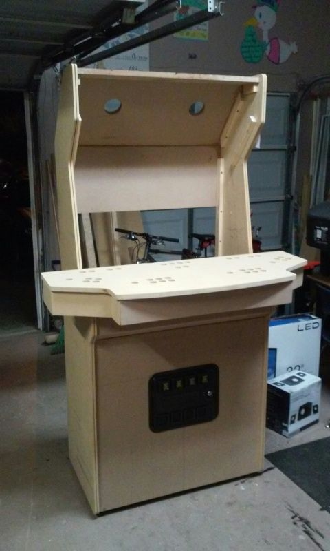

Good update today.  After cleaning the garage, spreading mulch and countless other crap this weekend, I got a couple of hours to spend on this.

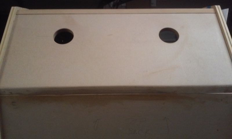

First up, HOLES!  3" soffet vents will go in these.  There will be 4 2" vents on the bottom.  They'll be painted hammered black:

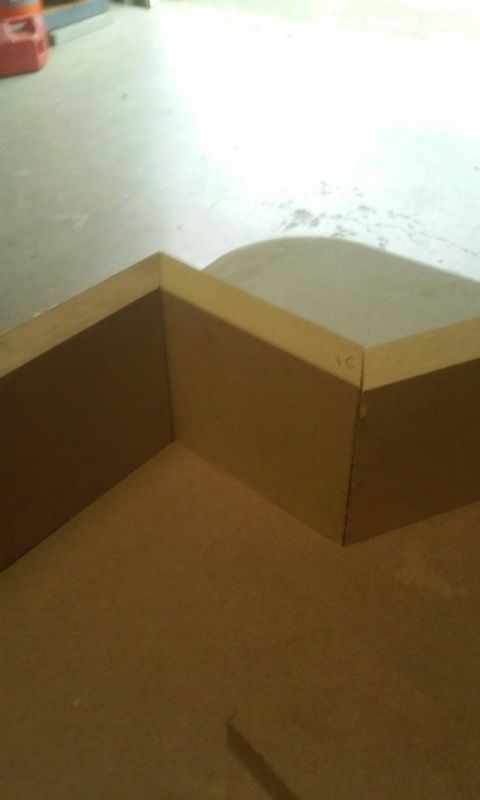

Then, I was able to start gluing the front panels in place.  First up is the front "chin" piece, then a 45 degree-cut piece that will meet with the bottom front panel at 45 degrees.  Had to get creative holding it all together cuz this thing is so WIDE!
Next up, laid the old girl down and glued the front bottom panel on:
Stood it up and it looks like this:

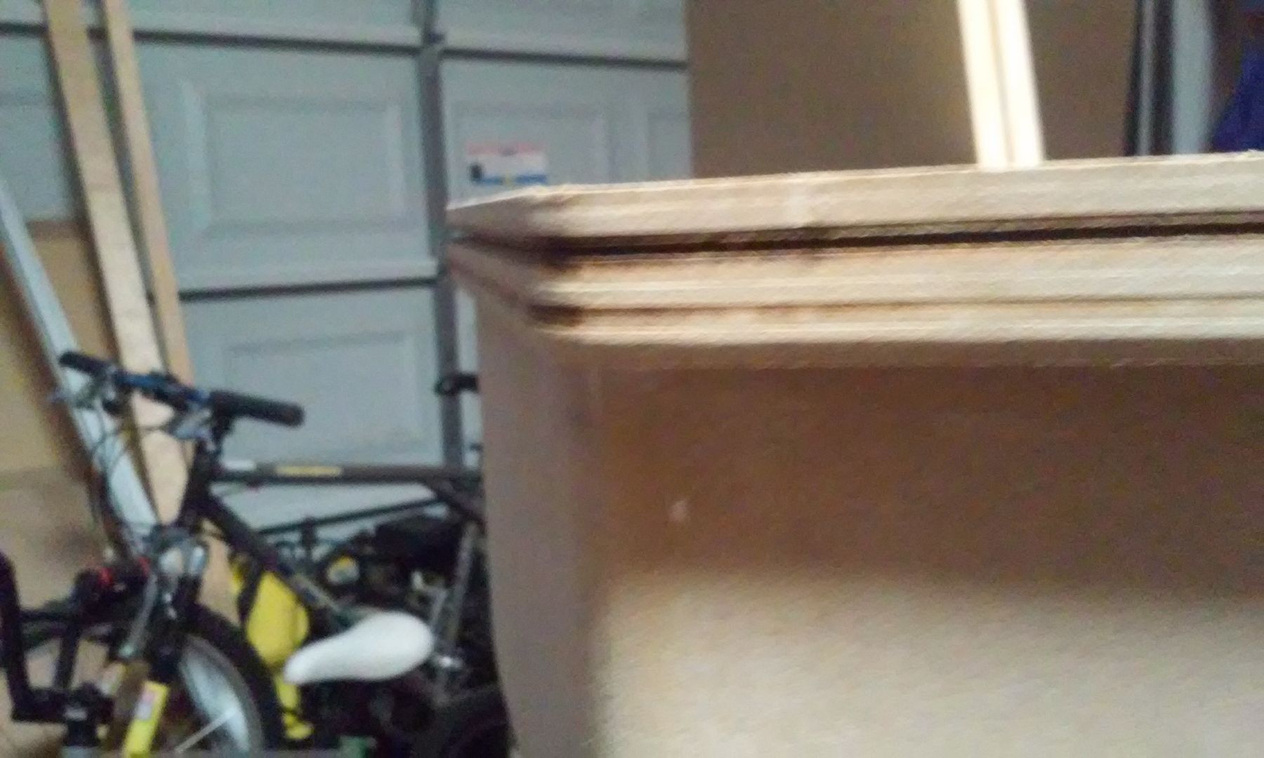

It's only about 1/16th out at one bottom edge.  Not bad for no table saw.  measuremeasuremeasuremeasure:
Door is pretty square.  I'm going to clearance the hole a little more so I can really square it when it's painted:
Artwork ideas are being kicked around.  I'll update the thread name when it's been chosen.

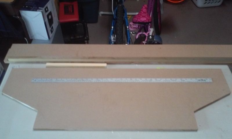

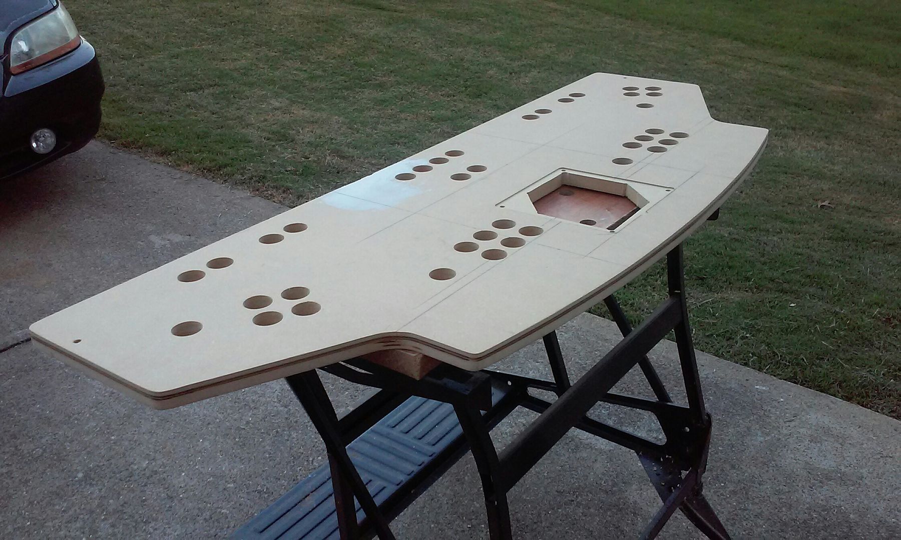

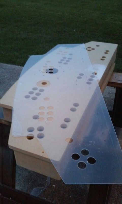

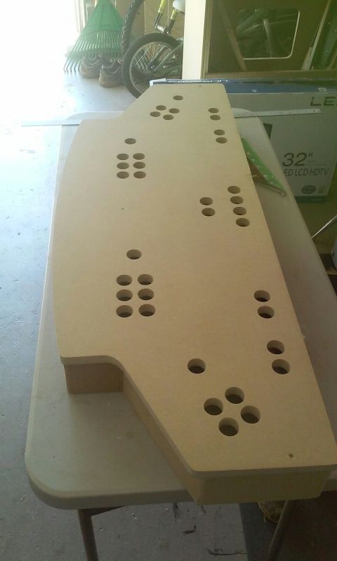

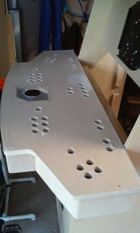

K.  So, it stopped raining for exactly ONE day.  I got a couple of hours in yesterday.
First, laid out the CP top.

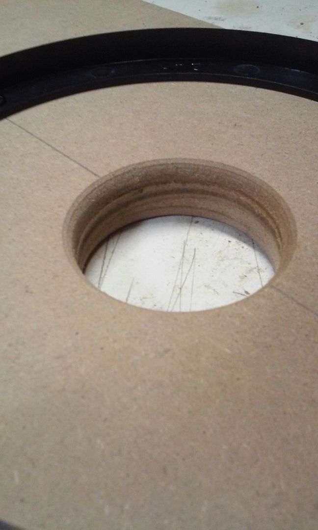

Then got out in the driveway with 2 different saws, a 3" hole saw and my sander:
The clamps are for a damaged area.  The damn thing fell off the sawhorses when I was sanding it and took a chunk out of the top.  Figures it couldn't be the underside.  :angry:  I'll fill that with filler and it should be good to go:
Getting closer to home:
Started the CP with a 3" hole saw for these curves first.  They came out nice:
I'm going to have him order the TB and mount tonight so I can start cutting the football and doing the routing for that.  FOOTBALL!:

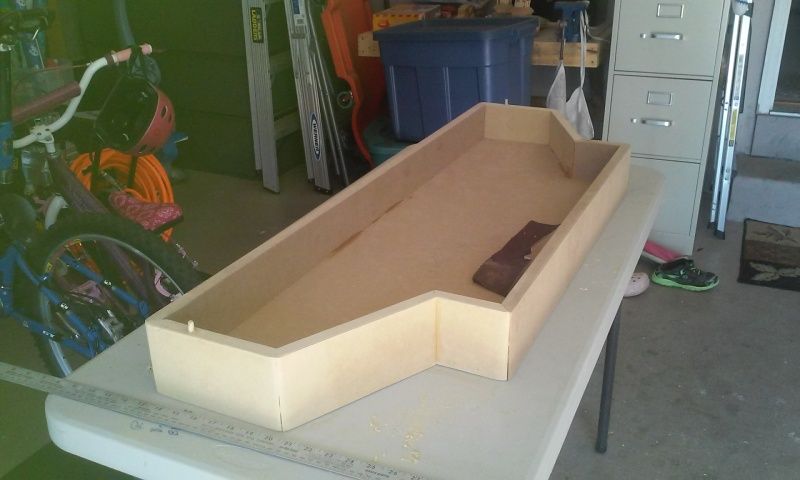

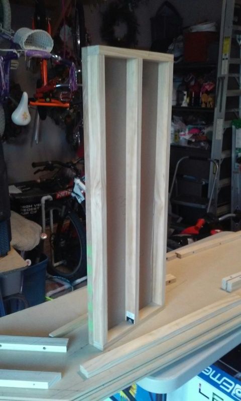

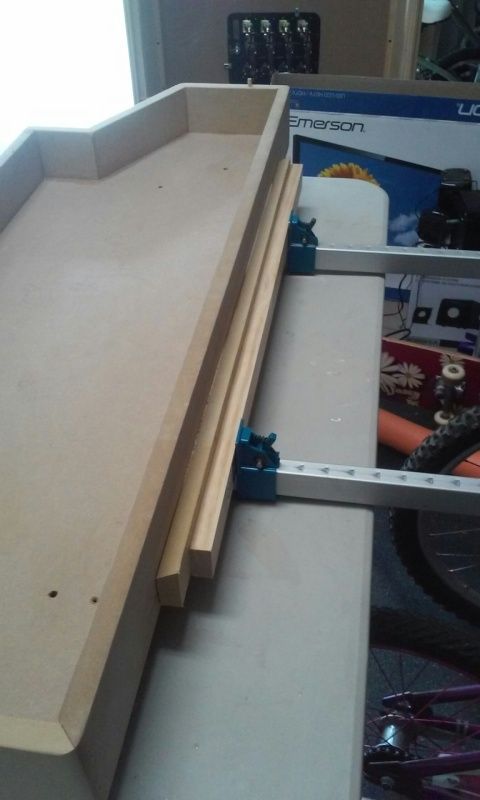

Well, the rain held off for a while, so I got busy for an hour or so.  Made the box bottom:
Had to rip 4" strips for the box....which sucks without a table saw!  :banghead:
So, I should be able to miter this thing together tomorrow hopefully.  Then, some wood filler around the entire case and I can start with the internal layouts for the CPU, power, speakers, etc.

Of course the weather held off so I was able to get back out there with the miter box.
It's almost oh-beer:30 so I'm gonna take a break for the night.  It'll get glued and pin-nailed tomorrow night.  Then I can sand it smoove and round the edges and we'll be good!

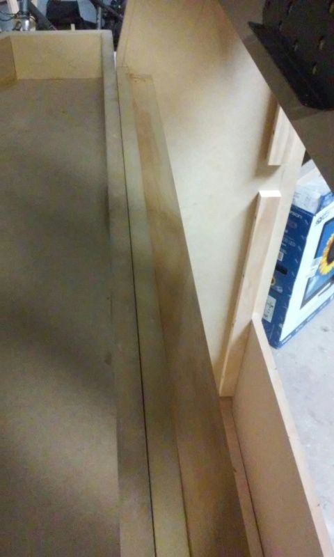

Got the box glued up.  Had a couple of glue issues on a couple of corners, but those will be covered with putty.  Shame, too since the cuts were damn near perfect.
Got it sanded and rounded and the locating pins for the CP top installed:

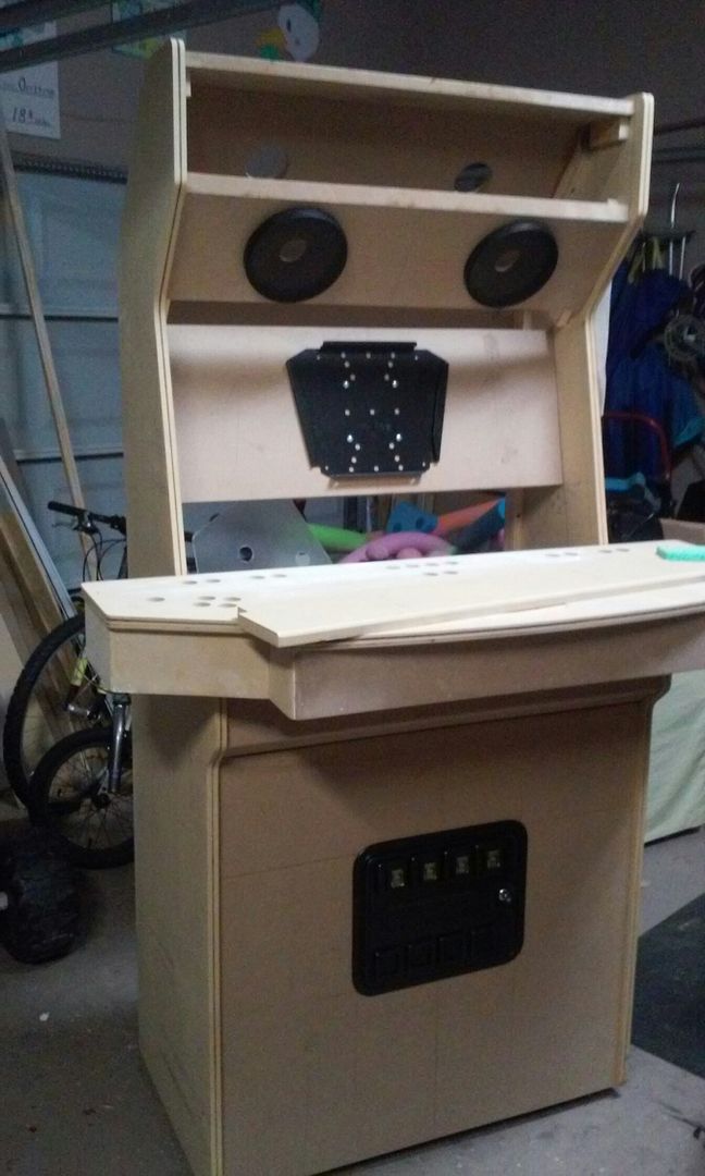

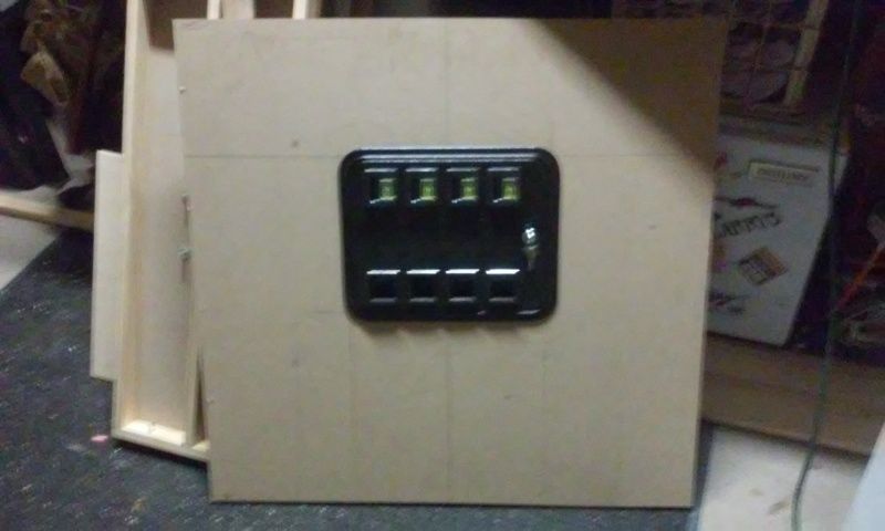

Arcade content:  Worked a little on the coin door placement.

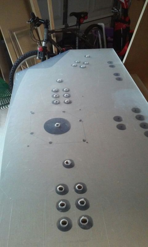

Just a quick update.  Had a birthday party today but I managed to do some mockup this morning.  Had my neighbor (the owner) come over and get a pic to send his buddies.  Figured I'd share the sheer scale of this thing.  He's almost 6'.  I'm 6'1" and it's taller than me too.
Next up?  CP plexi routing, routing the trackball mount flush to the CP and some clearance for the monitor glass.

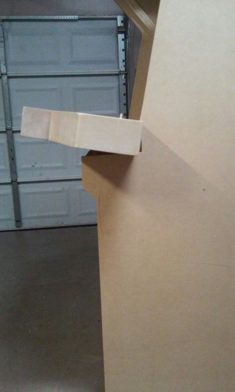

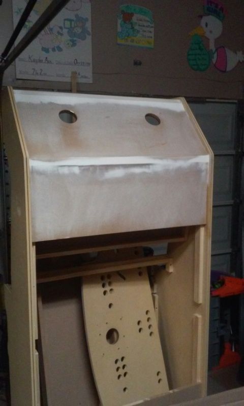

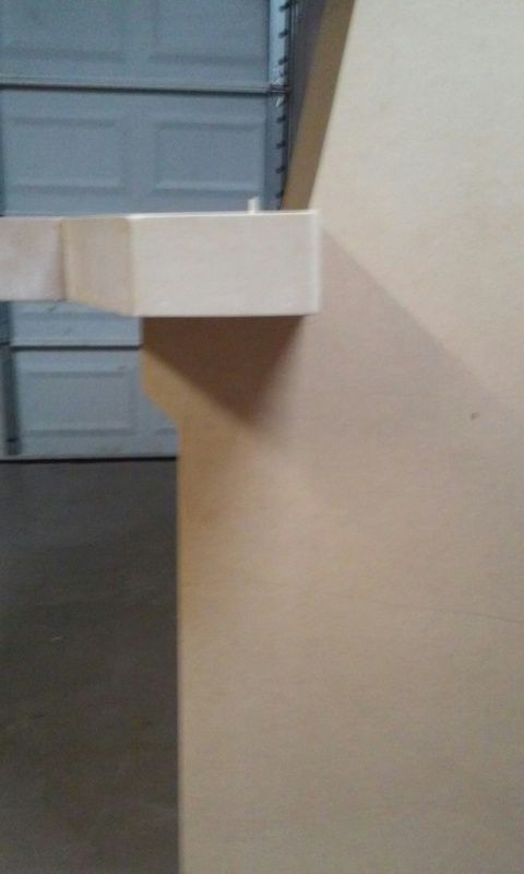

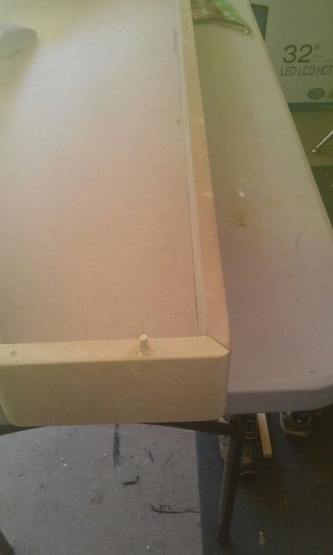

OK.  Glue's dry!  :applaud:
So, the attachment mechanism for the CP box is a riff on this:
One piece is glued/screwed into the cab.  The other one is glued to the CP box so the orientation is such that the one attached to the case captures the one on the CP box, holding it very still.
Gluing up the cleat on the back of the CP box:
Tip it into place and down/back to lock it in:
Small 1/4" dia. pins made from dowel are used on the front panel of the cab to locate and hold the front in place.  Feels pretty tight!

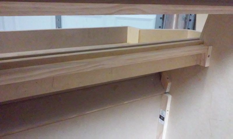

Here's what it looks like from the back inside the cab:
Here it is from the top.  You can see the cleat mounted to the cab is reinforced by a 1x2 piece of hardwood.  This should be a great place to capture the plexi, too.
Phew.  Glad that worked!   :o

Yeah, I'd slap a latch on the front (open the coin door, reach up, unlatch). I could see it getting pulled up and off during a rousing game of SF or TMNT.
Nice idea! :cheers:
mcseforsale
  • Posts: 1471
  • Creepy Mario Dude
Thanks.  Stole the idea from dad.  He used to hang cabinets that way.  Made it easy to hang them with one dude.
AJ
AJ
Yeah, I used a French cleat to hang my wall-mounted jukebox. Putting a latch on the lower front should make it pretty solid.
mcseforsale
  • Posts: 1471
  • Creepy Mario Dude
I *KNEW* it had to have a name.  Yeah.  I have a couple of latches, but I'm not feeling the love on their finish.  I might just get a Happ CP latch and be done with it.  I thought that's what I'd ordered, but the flimsy Nintendo types showd up instead.
AJ
AJ
Yeah, I would just make sure the latch is on the inside of the cab, maybe even a pair, one on each side, but you should be able to hide them pretty well. It's pretty much the way most CPs lock down.  :cheers:

But, I did get some time last night to start on the plexi for the CP.  Neighbors must hate me what with the router routing at 9pm.  But I was able to get most of it done.  My drill batteries died while making the pilot holes for the router bit....probably because I had to go so slow making the holes so the plexi didnt' crack.  I still need to finish 10 of them or so.  But good progress none the less.
The most nerve wracking part...HOLES!
After 20 min with the router and 1/2" trim bit:
I'll be putting a 45 degree chamfer on the TB and joy holes once I get the last 10 button holes done.

Dammit, dammit, dammit.  Got the plexi cut and the football cut out and the damn rain set in...just after I set up the plunge base on the router to inset the TB mount.  Ugh... :angry:

Small problem....YARD SALE.
Dammit!

Well, I'm back at it.  The weather around here is finally not in the melting zone, so I got out the tools and started working again.  I started a new job and stuff about 6 weeks ago, so I've been terribly busy.
I got the speaker holes and mounts built.  Basically 2" holes routed with a 1/4" roundover.  6 3/4" speaker grills, etc.  Looks pretty nice.  I have to make one final cut on the back of the panel to allow for the plexi, but it's essentially done.  I'm going to make this panel removable with some cool fasteners...I just haven't worked that out yet.
Next, on to the marquee box.  The back is removable and is screwed into a permanent cleat made from nice pine 1x2.  I'll be using the Nova Matrix from GGG, so the marquee box can be shallow.  Single hole for any electrics that need to pass through.  1" with 1/8" roundover.  I'm going to cover this with some rubber with a slit in it to keep light leak at a minmum.
next up is sorting the PC.  I haven't decided if I want to de-case the PC, or leave it as a lump in the bottom.  This thing is pretty tippy and the weight might help.  Plus, the PC going into this is a monster and might serve as a media server since the owner is a musician and needs a place to keep his recordings and writings.  Decisions, decisions.
