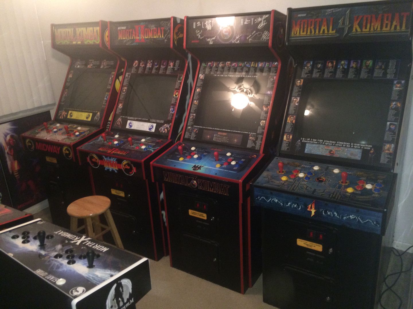

Yes, not a bad job on your first shot! If you need any MK advice, let me know. I have all the cabs...
I am so jealous of your collection that I find myself wishing bad things on you.. :angry:
MK3FAN
  • Posts: 975
Re: Mortal Kombat Dynamo cabinet conversion to MAME
« Reply #4 on: March 31, 2015, 01:03:04 am »
haha. No worries. You aren't the first person to wish bad things on me. ;)
