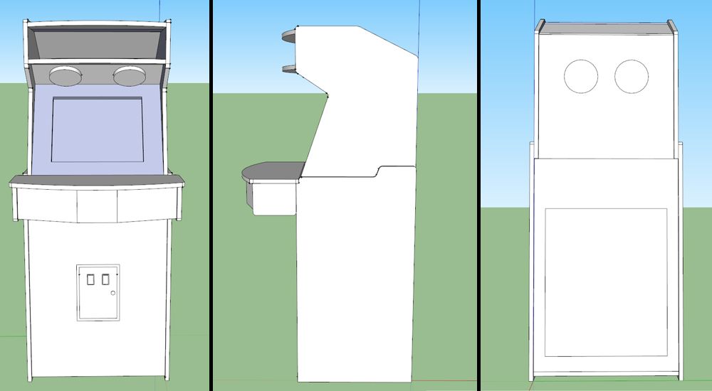

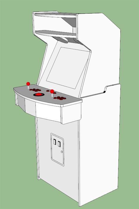

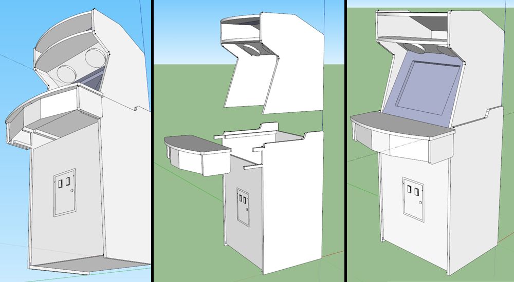

My sketchup is a bit rough, need to watch more youtube tutorials. But it's a fairly accurate representation of what I want to accomplish. The top hood and the control panel will be removable since this thing will eventually need to move at least once or twice. This also means I can build more than one control panel if I really feel the need to (probably not).
The underside of the control panel is open for easy access to the J-sticks to switch between 8-way and 4-way. Is this a terrible idea? I don't see any other cabs doing this.

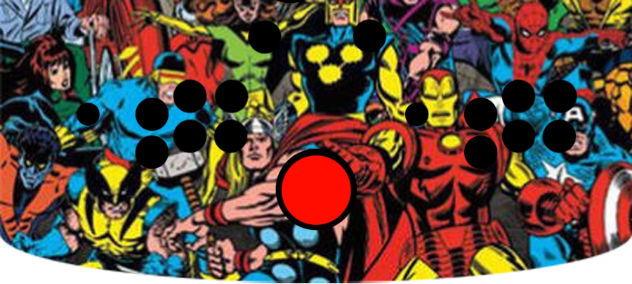

Staying under budget means getting poster on ebay for cab art. Luckily I found some stuff that will work well for the sides, controls, and marquee.

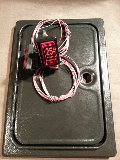

I've had these credit buttons but never used them, but I wanted a coin door. This was a compromise to save money. I'm just going to mount these on this plain steel door I picked up.

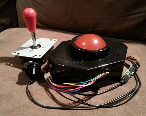

Trackball, J-sticks, black butons.

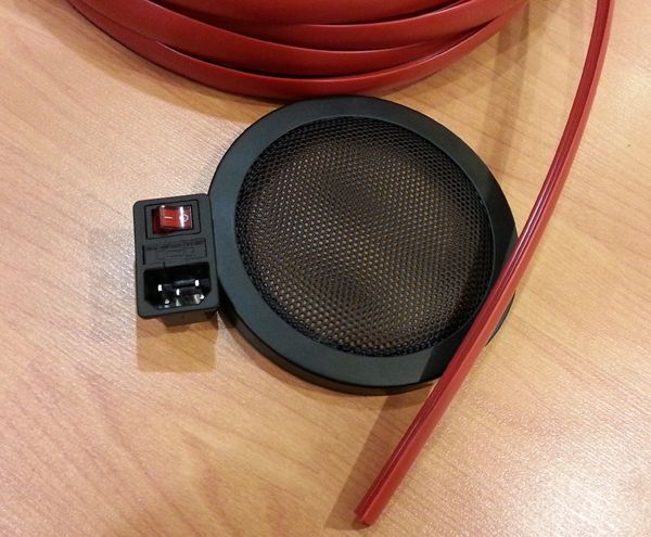

T-molding arrived along with speaker grills and the power switch. Also picked up some MDF. That's exciting.

I also slimmed down the cab a bit and made all of the angled cuts parallel and the curve of the control panel match the curve of the marquee. I'm eager to start cutting.

The open bottom CP:  I have one question, do you have a cat or kids in the house (even as visitors running around)?  A cat will jump up and into the cab yanking wires, a kid may just play with them.
Other than that I can't think of a reason why it would be a bad idea.
