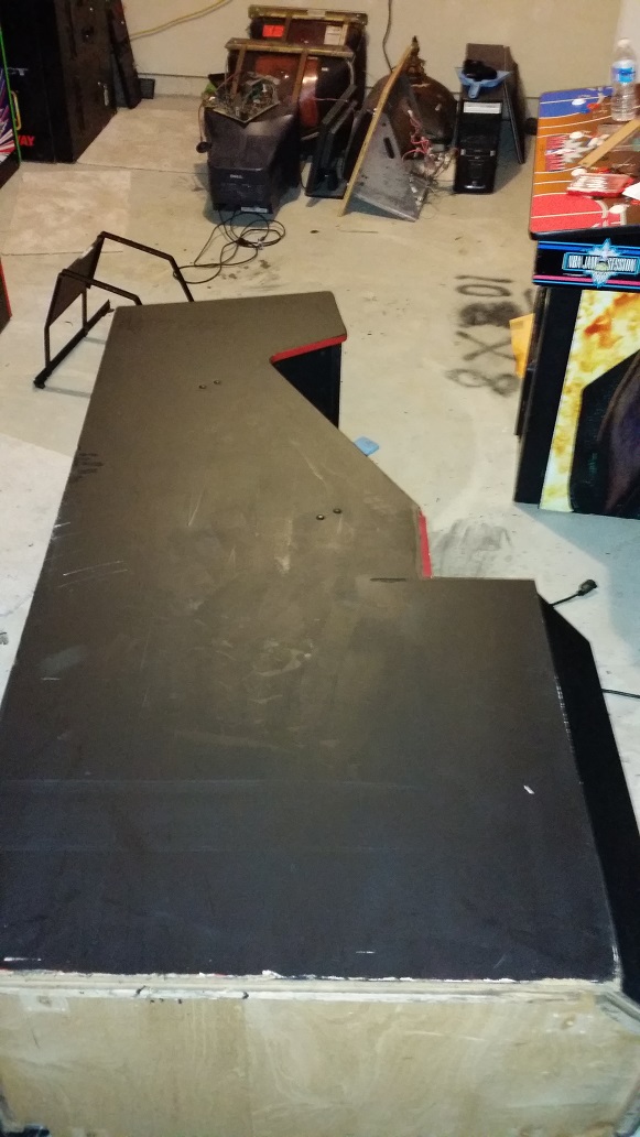

Picked up an original Mortal Kombat cab over on KLOV for $300. Ended up costing closer to $425 after tolls and gas. Just going to restore it, no plans to make it a moving cockpit.
Here are the pictures from the for sale thread, aka the BEFORE pix:
The flash makes the sides look white, but its from the flash. sides are painted black:
« Last Edit: August 30, 2014, 12:58:40 pm by Malenko »

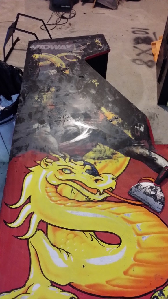

« Reply #1 on: June 25, 2014, 10:29:31 am »
Here is the top corner before any paint is removed:
and here's a layer off:
They obviously left the control panel on while painting:

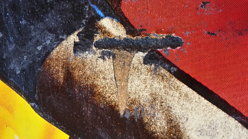

Quick fun fact. They spray painted, then rolled on paint, then spray painted again. I finally get to see *some* of the side art:
Its pretty beat up and faded, and will eventually need to be replaced.
Bottom doesn't look much better:
The funniest part of this is how great the tiny little piece near cage's hand looks, the part that was covered by the CP:
Most of the paint off:
pretty decent sized gouge:

Paint is almost completely off this side:

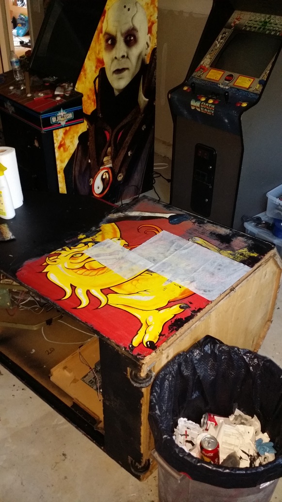

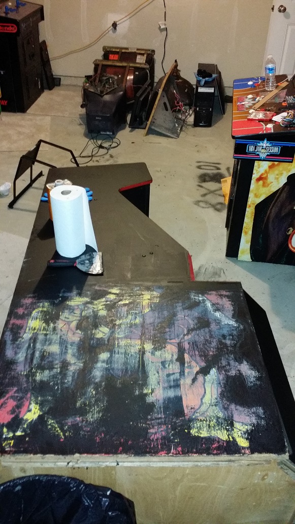

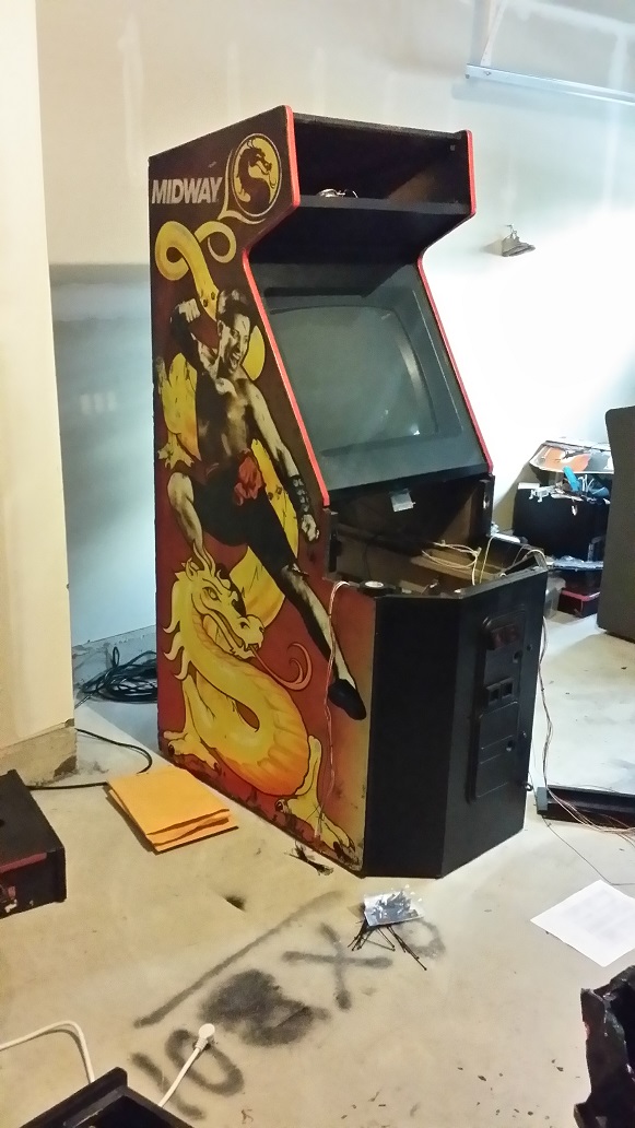

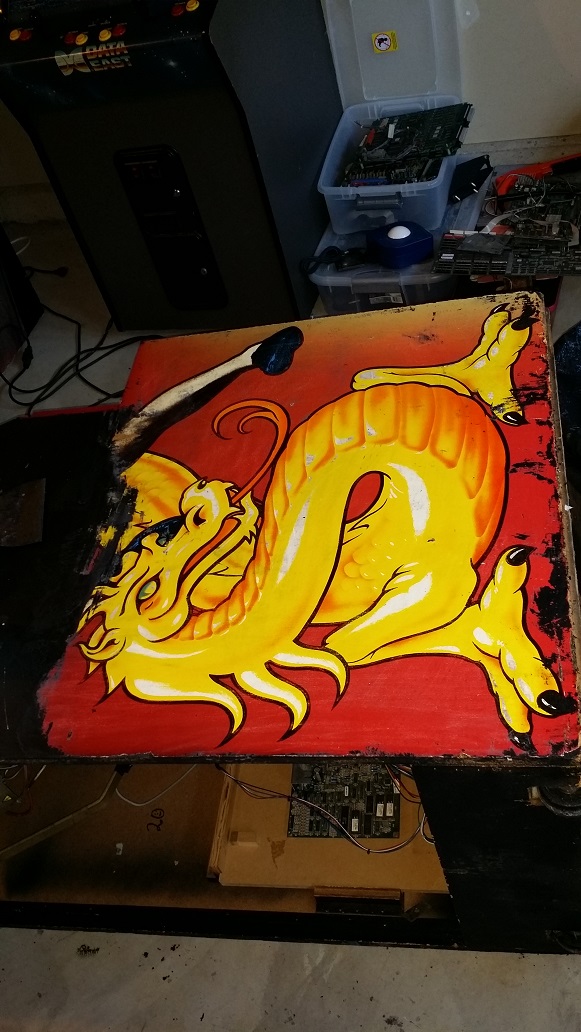

Started the other side a couple days ago. All the arcade monitors and PCBs and cabs in the picture are just me Xhowing Off.
This is pretty much how it started:
and a ton of elbow grease later, You can see the dragon starting to pop through:
Quan Chi is impressed with how its going:
But for some reason, the side art looks better in the pictures than it does in person:
started getting the top part clean:
Johnny must have fallen and scraped his knee:
And even though there is some black paint on the sides still, Im not removing anymore. Ive inhaled enough chemicals and abused my putty knife enough for a cab who's art will eventually be replaced.
I started rewiring the JAMMA loom, sound, video, and power are all ran. and the loom is zip tied and separated into player 1, player 2, power, video, coins/service, and sound. So really all thats left is to wire up the CP.

I used kleen paint stripper, the 30 minute kind. I spread it on, then scraped it off about 10 minutes later. That's enough to get the top layer off without damaging the art.
Then I used this stuff:
http://www.homedepot.com/p/Motsenbockers-22-oz-Latex-Based-Paint-Remover-Lift-Off-5-413-01/100047250
basically spray it on, then scrape it off. The trick I invented was to spray it on, then lay either paper towels or shop towels on it, then spray them. Let it sit for 30 to 45 minutes, then scrape, then wipe with the paper towels (thats why you see paper towels on the cab in some of the pictures) I came up with that technique about 5 years ago when removing the paint from my KI cab: http://forum.arcadecontrols.com/index.php/topic,88688.0.html

ok, so heres the cab with video and power hooked up:
Cool, well, from the factory, the main board's Jamma edge faced towards the front of the machine so when you slid the board out through the access, the Jamma harness and all the board's connections were right there and you didn't have to slide the board all the way out. Does that make sense?
Rotated the PCB and JAMMA loom wiring to match this:
might remove the volume pot, I have it turned all the way down and its still SUPER loud.
Here is how she sits now.  The art on the front is trashed, there's a black button blank where they drilled another button above the high attacks, its gonna stay that way until I can order a new CPO. I'll fill in the holes with dowel rods and remove the gaps with bondo. Before all that, I'll put the dustwashers between the wood and metal CPO. Also, it'll get the plexi-glass cover too, oh and new tmolding.
The monitor is pretty much perfect. There is an ever so slight AM2 burn in on the bottom right, that you simply cannot see when the monitor is on, and theres a very minor degauss issue on the bottom left.

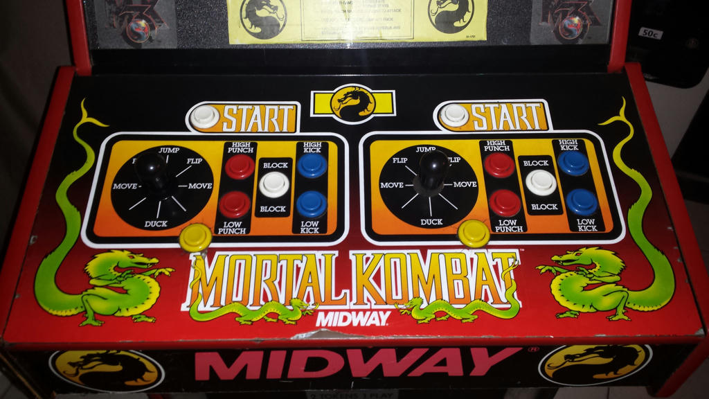

So here is how we last saw the control panel:
Now I have a marquee (custom redesign, very close to the original)
And now my front art is installed, I still need to apply the CPO, and MIDWAY side pieces:
and yes, I *LOVE* the yellow t-molding. It really makes the machine pop!

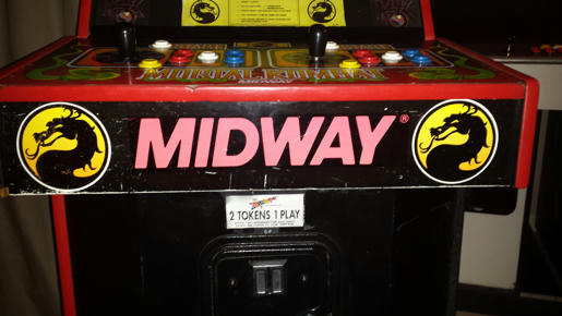

« Reply #31 on: August 30, 2014, 12:57:46 pm »

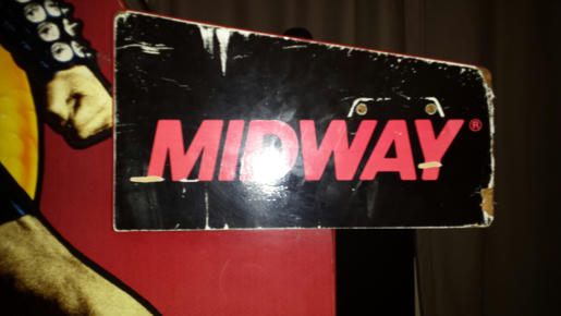

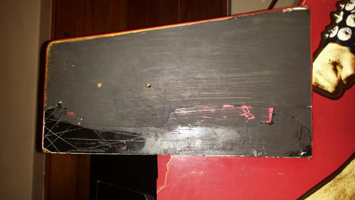

So I got midway sides printed up ( I made the choice to drop the ®)
first shot has the old CPO, second shot has the new CPO
And I put the CP overlay on:
going to go ahead and consider this one done.
