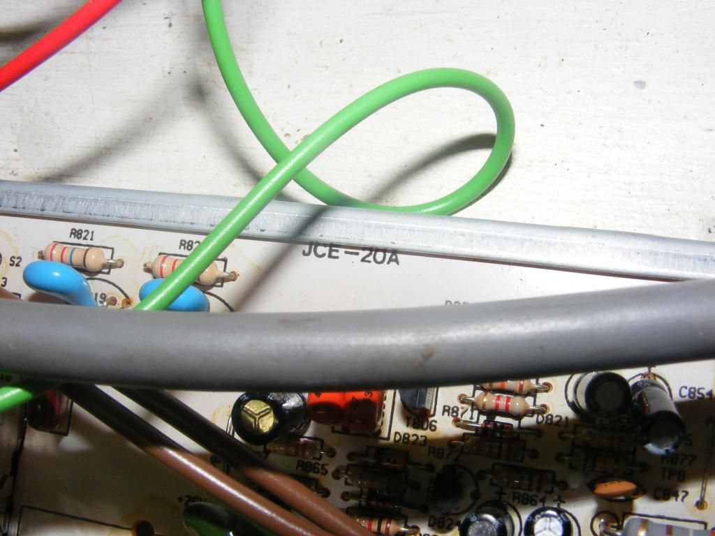

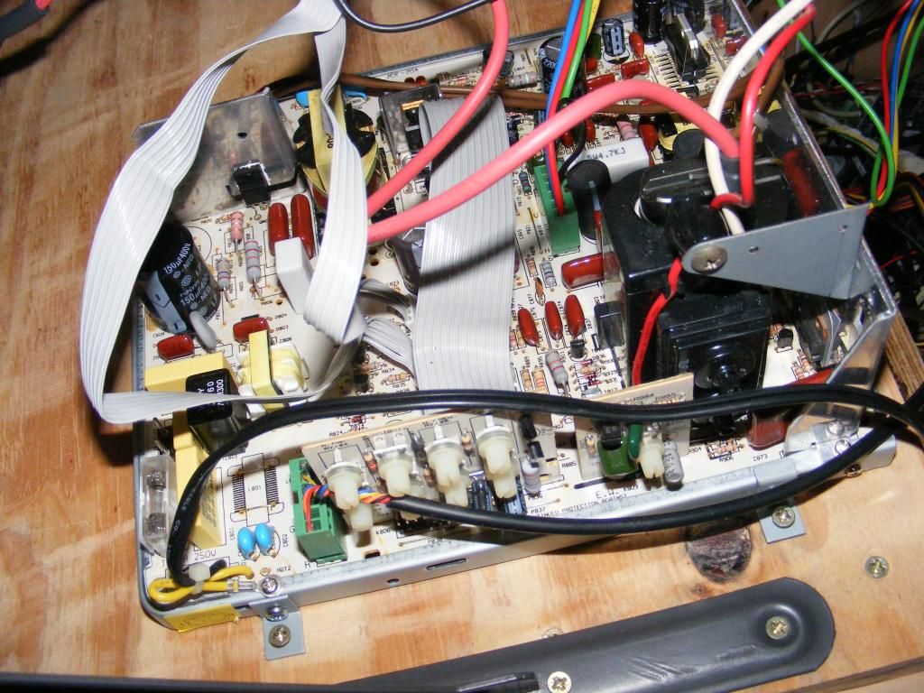

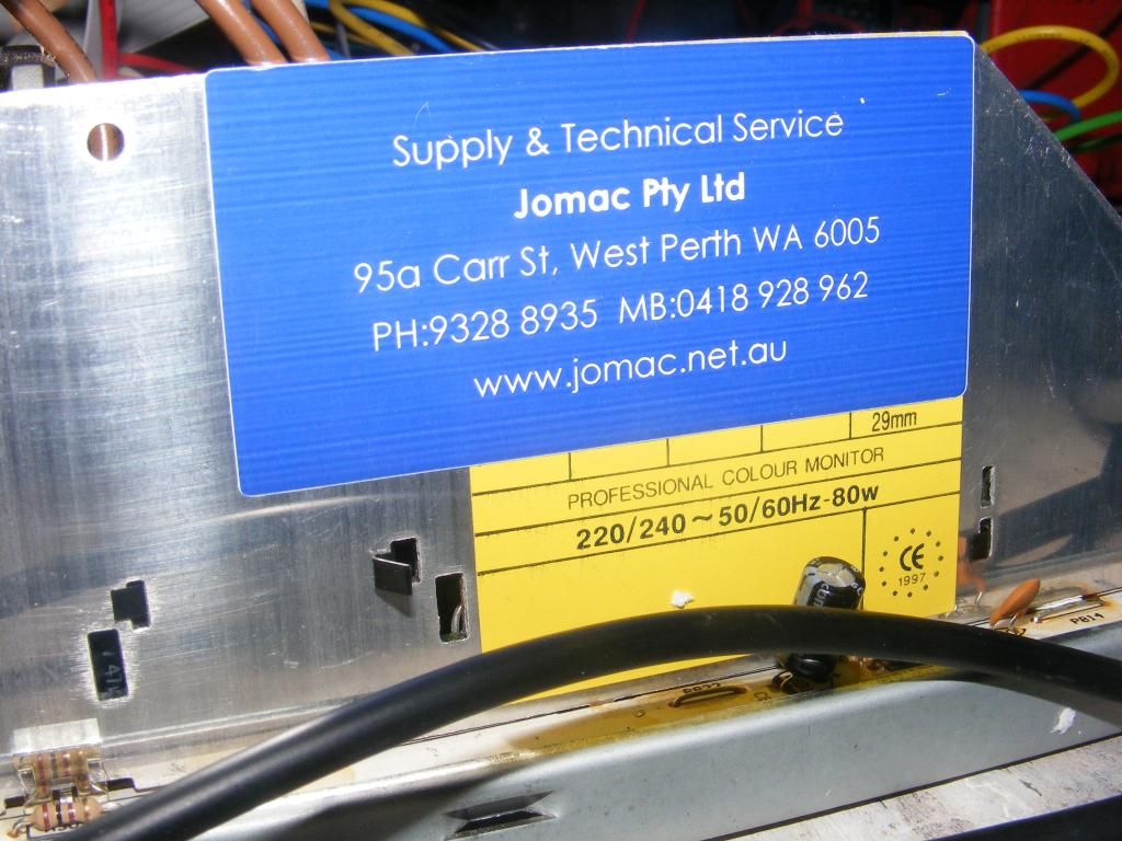

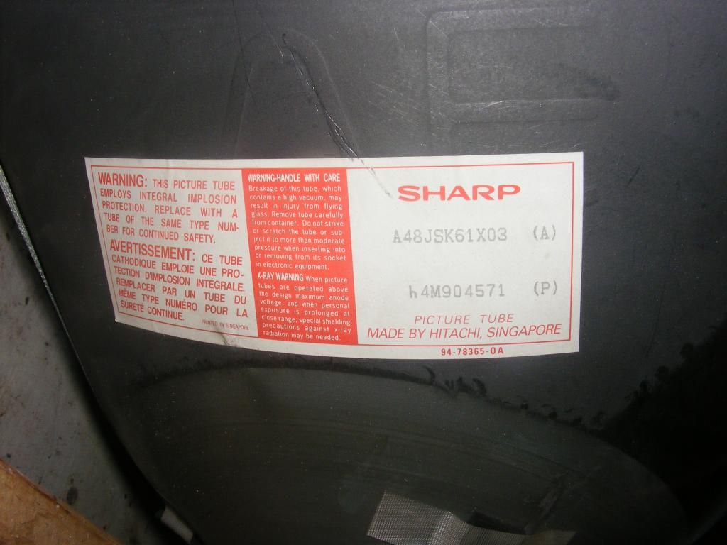

Well the chassis is brand new and the arcade tube is meant to be old not sure how old. An arcade repairman bought the new chassis and had the tube spare and he set them up for me. He dosnt know anything about connecting a computer to an arcade monitor. He's only ever used real deal boards. here some photos i could find of numbers on the tube and chassis. Last picture shows the whole chasiss which might be helpfull for identification i couldn't find anything on the JCE-20A number.
Ken Layton
  • Guru
  • Posts: 7061
  • Technician
That's Joey at Jomac in Australia:
http://www.jomac.net.au/
