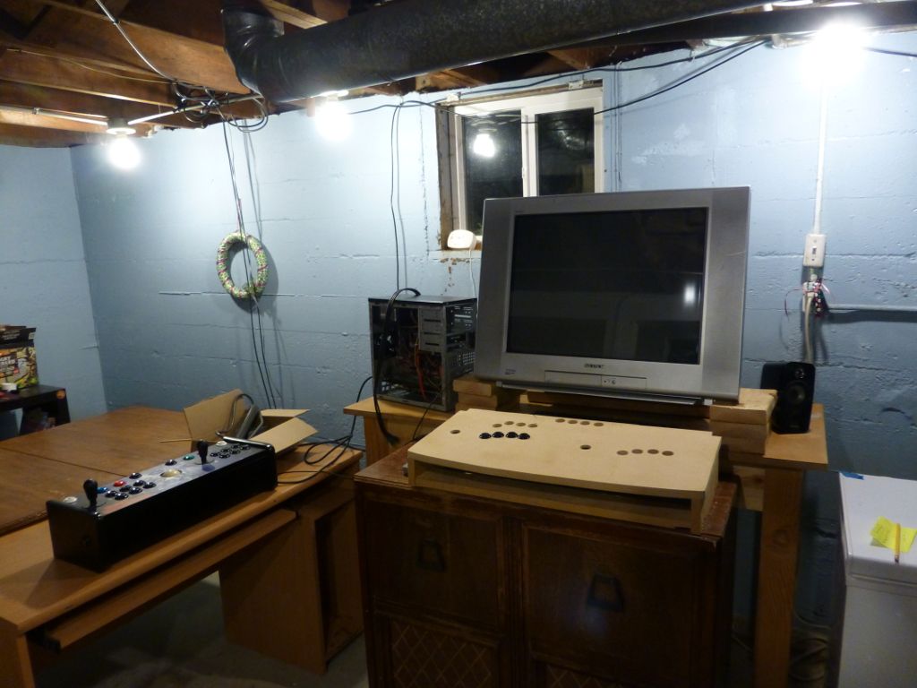

EPOCH arcade: I want to create something easy to use, ergonomically friendly, small list of favorite games. I want to avoid franekpanel syndrome and would like the project to be simple but professional. It will be two player stand-up, six buttons per player, 4 other buttons (player 1, 2, admin,exit).
I draw a lot of inspiration from the alien cab by epyx, the street fighter cab by Martijn, and Delusionals art and style.

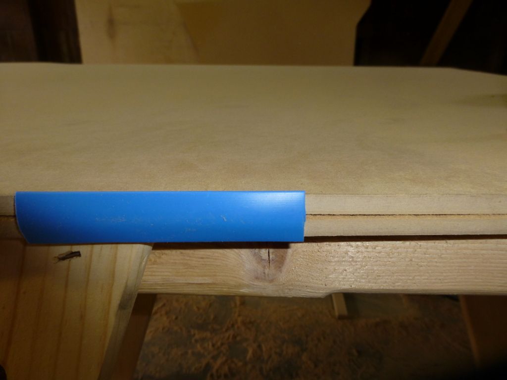

For those who have been here before. Any reason not to put the t-moulding on already if I have it? I figured it might protect the fragile mdf edges at this point.

Ended the day by putting on the first bits of t-molding. Wow it looks sharp, almost kinda glows!

Fruits of my labor today. Control panel is cut to shape minus rounding the corners. I obsessed with it so that it fits perfectly flush against the glass, the inner panels, edges, everything. Next up is to order the artwork and and speaker grills. If anyone knows of some cool speaker grills or ways to mount speakers I am all ears.

Rounded the corners of the CP and and have started the drilling for the holes. Because I went with sanwa buttons I need to recess the buttons and joystick. I created a couple jigs to help with the process.
to create the button jig I cut out two pieces of 3/4" mdf approximately 9x10 and 9x22". Using the smaller piece I taped on my button layout from slag coin and used a scratch all to make indents into the wood. I clamped it down and used a 1 5/8" hole saw (required for nut that attaches to sanwa buttons). Then I dropped some screws below the surface and used some wood glue to attach the two boards. Then using my template bit I cut the pattern into the lower piece as well. When I am ready to use it all I have to do is clamp it to the cp and run the template bit at the appropriate depth. I also created a jig to recess the joystick for under mounting.
