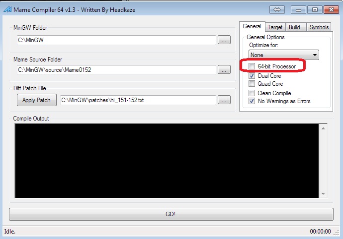

So I am compiling MAME 152.  I am obviously following this great guide.    I have two questions, which I am hoping won't be too hard to answer.
This is from my arcade machine computer:
I am running the MAME Compiler program.   Should I be checking the 64 bit Processor checkbox or not?

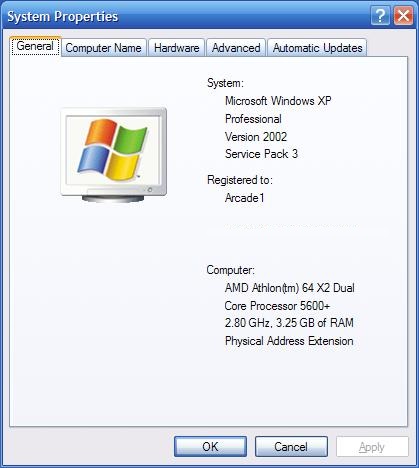

I know that my Windows XP I am using is 32bit.  But my processor is an AMD Athlon 64 X2 Dual Core 5600+.  Doesn't that 64 in the processor's name mean, that it's 64 bit?
So Question #1:
Should I be checking the "64 bit Processor" checkbox or not?

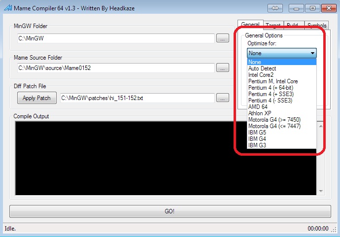

Next, I am wondering what to choose in the "Optimize for" dropbox.  These are the options:
So Question #2:
Based on my processor being a "AMD Athlon 64 X2 Dual Core 5600" what should I choose in that box?  Athlon XP?   I would pick auto detect but I am not compiling mame on the computer that will ultimately use it.

So I think found the answers to my questions myself.  I found this list of AMD Athlon 64 processors on wikipedia.  And since I have a AMD Athlon 64 X2 Dual Core 5600 looks like in the "Optimize for" box I should then be picking AMD 64.  Not sure how I missed that before.
Then for the second question about the "64-bit processor" I was questioning if that should only be checked if I was using Windows 64 bit.  So it was a windows vs processor question.   But it says right there 64-bit processor it does not say 64-bit Windows.   So I'm going to go ahead and check that box, along with Dual Core as well, since my processor says right in the name that it's Dual Core.
So I think I'm set.  If you guys think I'm wrong on any of that, let me know!

I would say don't optimize for 64 bit if you are not running the 64 bit version of Windows. You will get better performance in MAME though if you use a 64 bit OS.
You can't run a 64 bit application on 32 bits Windows even if the processor is 64 bits...
