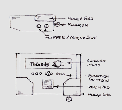

I'm so taken with Pinball FX2, I've decided to build a cabinet for it. It won't be a traditional style but will embrace the fact this is video pinball. I hope for it to be 3D compatible. I'll be starting with the controller first.
The basic, main design elements will be as follows:
-Based off a 360 wired controller (already hacked and soldered)
-Provide nudge capability
-Incorporate a touchpad for menu navigation
-Include a plunger
Just to give an idea as to what this will look like. Rough concept:
The sides and the nudge bar will be covered in black PlastiDip - a durable rubberised finish.
The remainder of the case will be covered in blackboard vinyl. It has this finish:
The artwork will have clear acrylic over the top
The plunger will be made from a modified balltop joystick

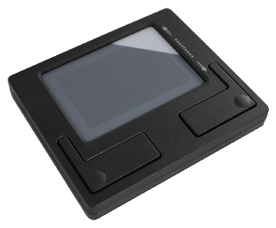

The touchpad I have bought for this project:
The nudge bars will be pushed forwards to activate. Tension will be applied using secateur springs (also purchased):
The mechanisms for the nudge bar and the plunger will be explained later. Hopefully my designs for these will work out :)

Interesting idea on the nudge bars, but I'm not sold on pushing forward to nudge sideways.   :dunno
Most pinball games allow left, right, and up nudge.
One of the guys on VPForums.org used a floating lockdown bar and 3 microswitches.

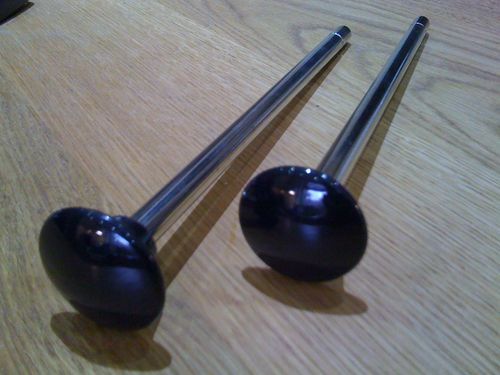

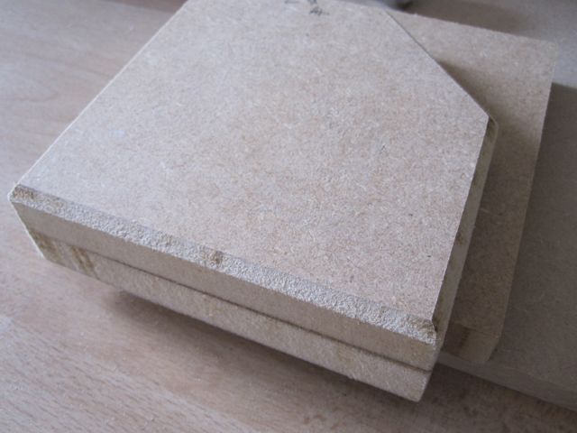

Nudge bars have been completed with a routed beveled top:
Will be working on the main box section next.

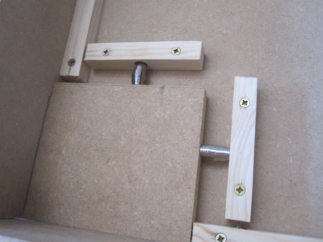

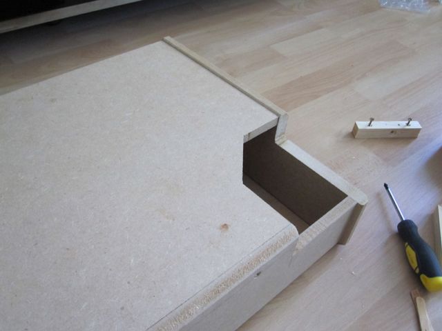

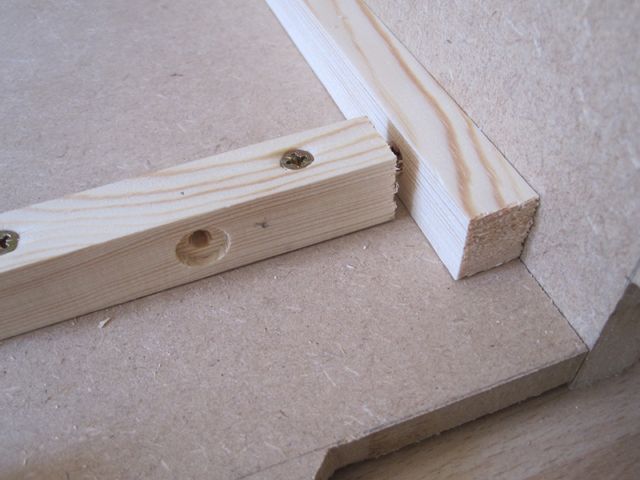

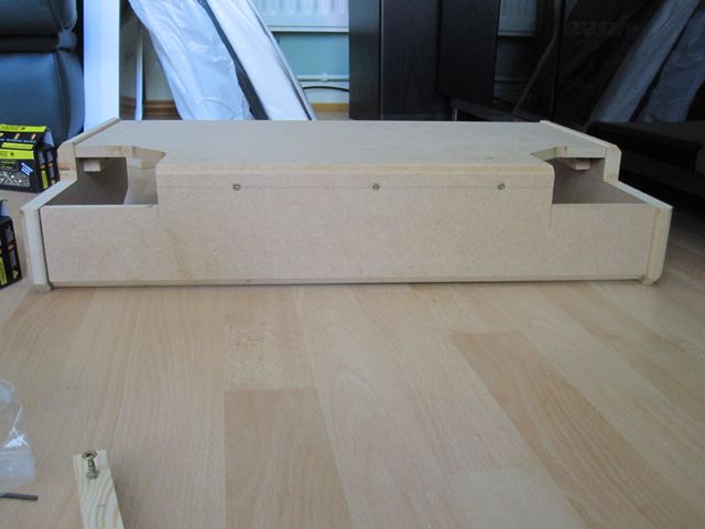

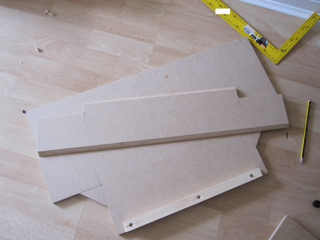

I though this would take a bit of engineering and it's proving to be the case. Still, I'm quite please with how it's turning out. I still need to shape and adjust things a little but it's giving me confidence that it's going to work.
Progress today:
Front piece cut and shaped:
Frame for the spring loaded mechanism:
Spring retaining hole (I'll probably make this deeper and glue a washer in it):
Secateur springs in place (I had to get someone to help me with this due to the strength on them):
View from the top:
It's a decent fit at the moment. The nudge bars will need to be adjusted to allow a small range of movement (about 5mm). Still, it's looking good.
Any expansion gaps will be filled in with expanding foam tape so it should look nicely finished when done.

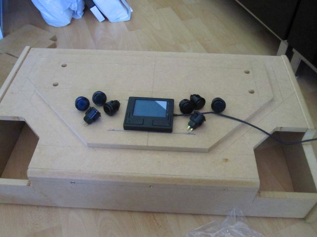

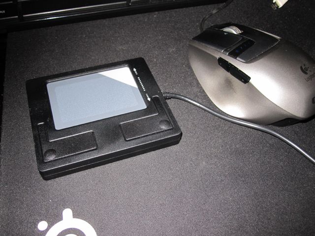

My touchpad arrived today. Looks like it's going to fit the bill perfectly. I'm not taken with the light coloured triangle in the corner so may cover the touch area in black vinyl. I tried it out to see whether it still functions and there are no issues with it.
Also ordered a shooter. The Balltop joystick idea wont work out as the shaft isn't a uniform width. I need to investigate hooking the pad up to a slide potentiometer as someone else has done. I can get away with soldering but electronics isn't my strong suit. If anyone can throw in some advice, I'd really appreciate it.
I only get to work on projects at the weekends unfortunately ...

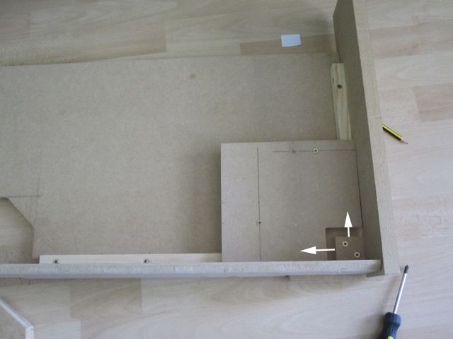

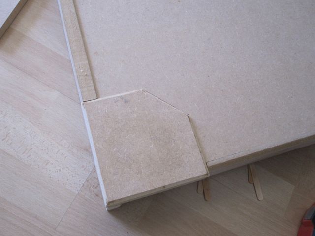

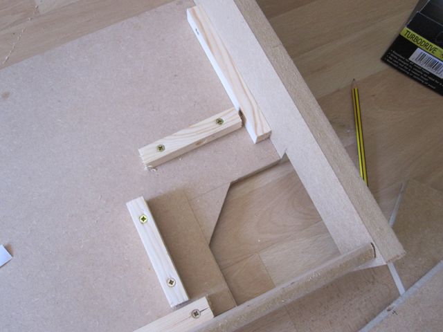

I've added a retaining plate to keep the nudge bar level and also a corner stopper. The stopper helps the nudge bar to track in the correct directions when pushed in.
Now I need to do the other side ....

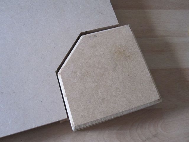

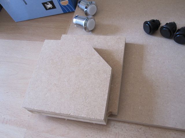

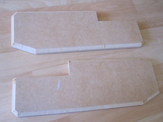

The sides have been shaped and routed along with the back of the top panel.

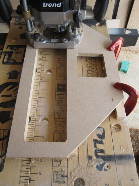

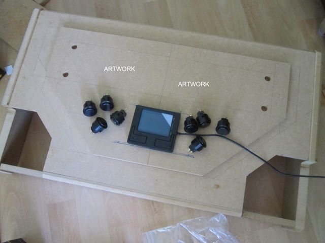

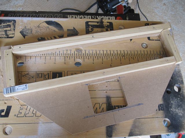

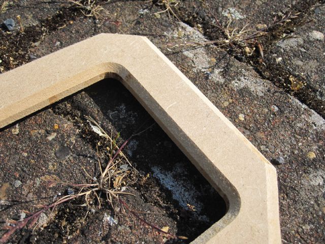

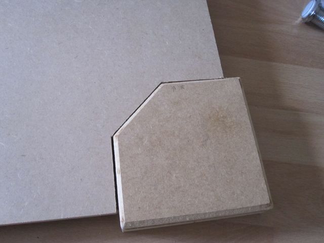

Started work on the frame. The basic shape has been cut out. Insets for the artwork and touchpad will need to be cut out. The sides will be heavily beveled to help integrate into the panel better. The buttons will be in clusters of 4 either side of the touchpad. It will be finished with black Plastidip ... eventually.
Click a pic for a video tour
SpaceHedgehog
  • Posts: 937
  • Last login:March 14, 2026, 10:40:09 am
  • Almost done ...
Re: Custom Pinball FX2 controller - eventually a cabinet ....
« Reply #20 on: July 07, 2013, 10:01:36 am »

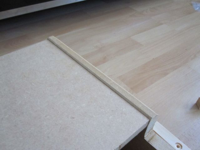

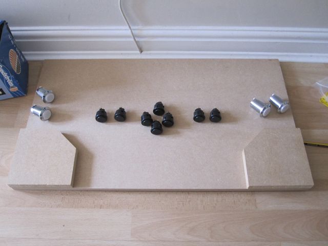

Just throwing in a few progress pictures ...
« Last Edit: July 07, 2013, 10:03:08 am by SpaceHedgehog »
SpaceHedgehog
  • Posts: 937
  • Almost done ...
« Reply #21 on: July 07, 2013, 12:02:58 pm »

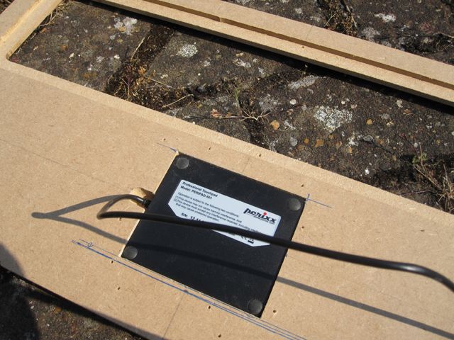

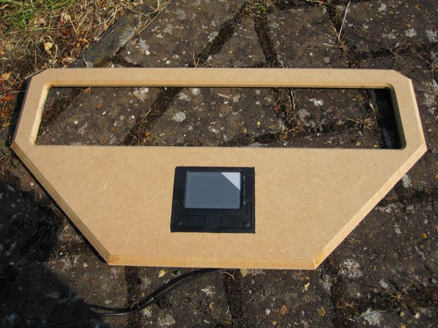

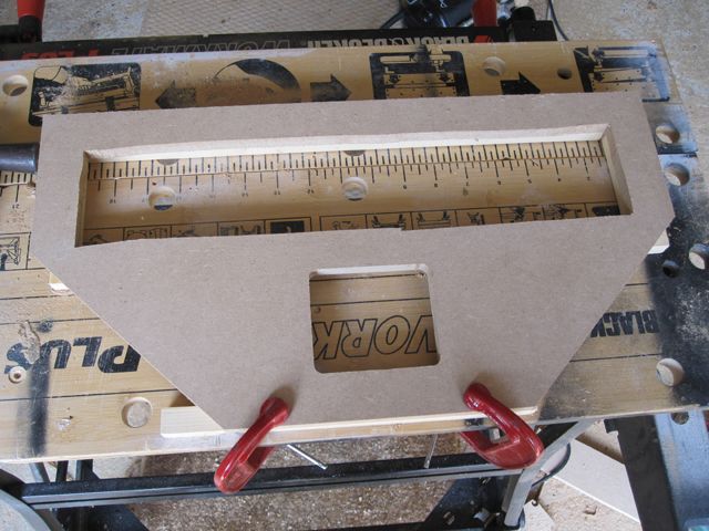

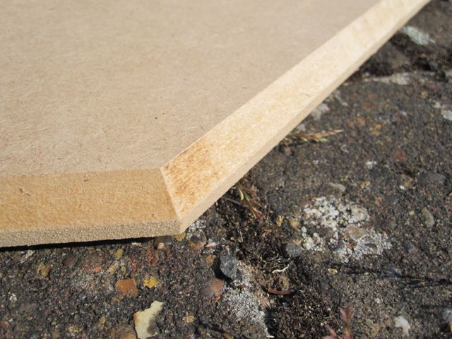

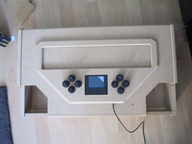

Well this panel's taken most of the day to do but has turned out as well as I'd hoped:
Turns out that the trackpad is exactly the same depth as the MDF. It's always great when you get a break like that.
Front:
Back:
Close up of the beveling:
And the inset for the artwork:
I'll get some acrylic cut and do the artwork soon.
Edit: To give an idea what this will look like in place ...
« Last Edit: July 07, 2013, 01:49:56 pm by SpaceHedgehog »
