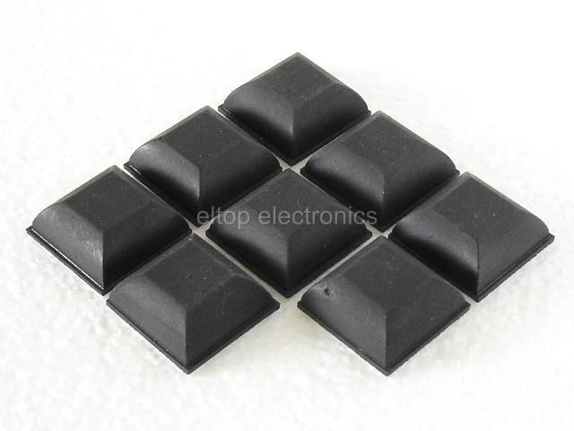

How much does this weigh/did you have to add any weight in order to keep it in place while playing? I'm looking to make a single controller similar to this (with less buttons, though) and I'm wondering how it's going to hold up using my HAPP™ Competition Arcade Joystick - whether I am going to have to hold down the box with my hands while using the joystick. I'm thinking about just building the case out of wood, not metal like you did, but would like to see if maybe there is a benefit to using the metal. I'm also trying to make it as small as possible to increase portability.
Thanks.
GeoMan
  • Posts: 183
  • Last login:September 16, 2026, 11:19:23 am
Re: Single Arcade Controller [FINISHED]
« Reply #7 on: September 06, 2013, 10:13:06 am »
The box i use is made of thick plastic. Only the top cover is made of thin metal (1mm). And no, i didn't have to add any extra weight.
If you place anti-slip feet underneath, you will have no problem. It is important to use ones with a larger footprint. I use 6 of these at the bottom of my controllers:
But if you still feel that you need extra weight, you can just glue a piece of lead inside your box using epoxy glue.
Regarding the controller size, you have to take into account that your hands need to be resting on the top cover to be able to play comfortably. My controller is 32x18cm and that size JUST allows for your hands to rest comfortably on it. Any smaller and you will not be able to play for more than 15 mins non-stop.
