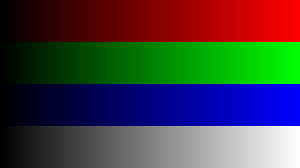

then, display a gradient pattern something like this:
adjust your red green and blue drive so the white is white and the red,green,blue is nice and bright, but without causing the black to start turning color or the bars to start "bleeding" out of the squares or bars. sometimes you need to switch back and forth between bars and black screens to see if the black is getting tinted by the colors.
on the gradient, adjust the "cutoff" to match any color that doesn't have a cutoff or adjust them so they look the same. (some chassis preset one color and you have to adjust the other 2 to it.)...
the cutoff is going to adjust how quickly a color rolls off to black in the gradient. too high and the color stays on too long (most of the color bar shows as bright) too low and the color rolls off to black too soon. (the first few colors are bright then it drops off to black).
make sure your whites stay white. take a few minutes away and come back to it. you eyes will get used to a color tinted white. stepping away for a while will refresh your eyes. otherwise you'll look at it later and wonder why the white is all green.
that should get you pretty close. Be warned again, you are looking at an old school CRT, it's not going to have a million to one contrast ratio like todays high definition TV of today do... it's more like ten thousand.

"your first step is going to be to set your brightness/contrast/black levels to the middle (halfway point)."
So I set to 50%: brightness, R G B gain and what would be black levels? Are those R G B background?
"adjust your red green and blue drive"
What would be the drive? Would that be gain?
"on the gradient, adjust the "cutoff"
Are those the adjust on the neck of the CRT? The  R G B BKG?
I think I just need to match the terms to follow your instruction to the core :)

During another attempt this ROM has several test patterns one of the tests is a gray ramp that has black bars going to white, from left to right on the upper part and from right to left on the bottom. Same image, just mirrored.
I believe this is my main problem, when I set the screen gain with brightness so I can see the almost black bar and this gives me a picture that I can see all the details this at the same time gives me a washed out black. if I play Pac-Man the playing field is all washed. The Mega Everdrive menu that should be back has that white veil.

I took several pictures to let you see the problem. All pictures were taken with the same calibration, same cut off, same everything.
The thing is, same images that have dark background will show fine and some don't.
Since a picture says more than a 1000 words:
awesome picture during gameplay
now the problem:
title showing ok:
problem:
the screen seems to drive it's brightness by itself.
fine:
washed background again:
What do you think causes this? Low screen gain, high screen gain?

either your screen control might be a bit too high or your color drive is too high. all that text should be a blue color. it might be your pics, but yours is bordering on nearly white.
veggav
  • Posts: 24
  • Last login:December 28, 2024, 06:53:22 am
Re: I just can't calibrate this arcade monitor!
« Reply #15 on: June 24, 2013, 02:10:58 pm »
I'm using the brazilian cps2 board so the text is kind of purple/pink.
Hey LilShawn I think I nailed it.
I was trying to have pure black on the background because I was watching too close the screen.
If I understand it right, I SHOULD see the scanlines even on pure black screens, right?
When I reduce the cutoff too much (the controls on the neck board) I can get pure black background but I start to loose details, that was my first and main problem.
I took a picture of what I'm talking about:
If reduce it too much I'll loose that last square on the color bar.
The cps2 color pattern isn't the best. I have a konami board that has a much scaled color bar that shows the impact of twisting the cut off.
Putting it simple, should I be aiming for a pure black background or should I see scanlines on black background?
If looking at the screen far away, from the couch, the scanlines just will show as a grey background.

« Reply #16 on: June 24, 2013, 02:44:09 pm »
i wasn't sure about the brasil version. my MAME romset is quite old and none of the regions work on this game. guess i should update sometime. :-\
ideally you want no scanlines on a black or "no signal" screen...but like you said, you are going to start looking deficient in other areas, you have to compromise in others and achieve an even balance.
I think you are as close as you are going to get with that pic... don't forget, you are dealing with old technology. you aren't going to get razor sharp 100% pic here. especially since that chassis wasn't made specifically for that tube.

Not only are you dealing with old technology, you're dealing with a set that has some hours on it.  The tubes do wear out...
Ideally, a no-signal or fully black screen is indistinguishable from the set being turned off.  In practice, a little black level creep is unavoidable to get decent low-intensity gray performance, but you should not be seeing retrace lines on a black screen ever.
Also, these things don't get nearly as bright as you might want unless you've got a very late model tube with little time on it.  A modern LCD monitor, especially with LED backlight, will easily be brighter than this CRT when properly adjusted.  You may be overdriving the tube (turn down gain/contrast) and overloading the power supply.
