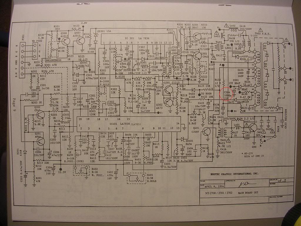

Hey all,
Got one of these NEOTEC NT-2701 monitors in which the HOT and Flyback were replaced a little over two years ago and suddenly, the other day, it developed the dreaded Tick Tick Tick.
I check the HOT and sure enough it is blown. I replace the HOT and check the board over and can't find anything else wrong. I fire up the monitor and it now has Horizontal collapse...
As far as I can tell IC 401, IC 501, Q 501, and the yoke are all good.
I am missing something here... What is it?
Thanks

should you not be looking at the horizontal yoke circuit,there are a couple of diodes,a resistor plus the hot(looks like a bu25xx) can't see if its q401 as the schem is poor

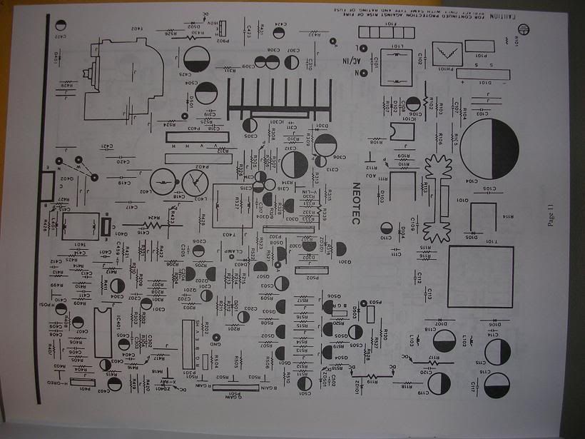

The Horizontal control IC is IC401 an LA7851 which has been replaced.
The above drawings from MKFan4Life are the original series and the monitor I have is the later series from 2004. I need to upload these drawings as they seem to be impossible to find on the web for download.
I am not sure how horizontal collapse is even possible.  If I have horizontal collapse doesn't that indicate that the HOT is good and switching and that the flyback is good too?
How can I check the yoke for internal shorts?  I checked the yoke on a known good WG 27D9200 and I got the same resistance reading of .05 Ohms.
Oh, sorry about that.  This manual came with my monitor in the Gauntlet Legends cab when I got it.  Seems like users on here told me my chassis itself was odd, 'cause I showed pics of it where the neckboard has the NT-2701 designation on the attached cardboard, but on a metal plate on the chassis it showed NT-27E.  Schematics in the manual seems to match well though.  Lol.  :dunno

I am suspecting that C423 (924J / 400V) is bad but can't find one anywhere.
Flyback MRCFT-252 is the same one I have used too.

FINALLY got back to working on this recently...
Turns out C423 IS bad, OPEN actually.  Couldn't find a film cap rated at .92 mF so I ended up with a 1.0 mF film cap instead.
Picture is nice and wide now and still has plenty of Horizontal width adjustment.
THANKS, as always, to those who helped out.
