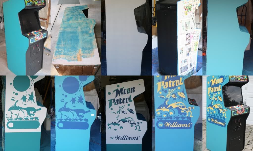

I know I have other projects going on, but this one is for a customer so it gets to jump the queue.
This cab had some work done to it prior to me getting it.  The sides had been painted.  Black has been repainted as well and a new cpo was installed.  Game is working.

Monitor has some pretty bad screen burn and will be replaced with a new one
Citristip makes quick work of the old paint
See...it was a Moon Patrol
After scraping off the old paint, I sanded down the sides to get them nice and smooth and remove what Citristrip left behind
Looks like the previous owner did some bondo work as well

Repeat for the other side
This side had some loose wood that I pulled away.
Some bondo will fix it up
In the pics, the sides look pretty good, but once I got a close look, it needed quite a bit of bondo.  Corners needed to be reshaped, edges needed to be smooth, etc.

2 coats of primer later...
Sides masked off for painting of the black
up next, the blue paint then the stencil work begins.

Boy, I can't believe how much work is was to match the paint on this cab.  Since I didn't have an original paint to match against, I planned on using paint codes that others had provided.  The first option was to use the codes from gamestencils site. I took them into Sherwin Williams to see if they can reproduce based on the codes.  They couldn't match Behr paint codes.  So I went over to Home Depot which sells Behr paint and asked them.  Problem was that site has the codes, but not the base color.  Without that, they can't mix it.
Next option was to use the codes that are on Noiseland Arcade site.
This was going to be easy.  All the codes including the base color were there.  Off to Home Depot again.  Only to find out that they have discontinued the use of that base color.  Once again...no luck
Third option was to go with the codes the Phetishboy over at KLOV used.  This was a Dutch Boy color so I went to their website to find out where the nearest location was.  They listed 84 lumber as a site.  Well that's just two miles from my house.  I head over there...only to find out they don't sell any paint.  Back to the website.  Okay, there is a K-Mart 15 miles from me that has it.  Back into the car...only to find out that while the do carry Dutch Boy paints, they don't have the codes for any of the colors I'm looking for.  However, he did tell me that they get all their paints from Sherwin Williams.  Okay, back in the car and off to Sherwin Williams.  Guy at SW tells me that while SW makes the Dutch Boy paint, he doesn't have any of the codes.
About to give up, I pick up every paint sample that is close to the colors I need.  I do this at Sherwin Williams, Home Depot, K-Mart and Wall-Mart.  I'll use the color swatches to try and match up to pictures.  This won't be easy as every Moon Patrol seems to be a different color.  Add to the fact, that almost nobody has a color that even comes close to the base blue color
...and then...
I finally hit on something close.  Glidden Paint #WGB13 Caribbean Sea looks to be a pretty good match from the samples from Wall-Mart.  Along with WGY13 Warm Gold for the Yellow and BHG116 Corsair for the dark blue.
First light coat of the base blue applied:
Still wet, but here it is up to a picture of an actual cab (looks pretty close)

Four coats of the base blue and she is now ready to start the stenciling.

Time for the Moon Patrol graphics.  First the blue layer.
Stencil lined up and held in place.  The key was to use a level to make sure the Williams Logo section at the bottom was parallel to the ground.
Stencil applied and pre-mask removed
The rest of the cab masked off (repeat for the other side)
And sprayed
This color was a little more on the purple side than I wanted.  However, it still looks good and will really pop once the contrasting yellow is applied.

The more I looked at the dark blue color, the less I liked it.  Even though I did find pictures of an original that were much closer in shade to the one I used, it seemed too purple.  And since I want things to be perfect  ;D , I stripped it down and ordered another set of stencils.  My fault for not checking the paint first.  The sample I had looked good and I went with it.  I spent so much time on the base color, I just assumed the dark blue would be the easy one.  Oh well...

Okay, a couple of more coats of the base color and now she is ready for the stencils.  When the base was originally painted, while still wet it looked like a good match, but as it dried, it really darkened up a bit too much.  Since I had to repaint it, this time I added some yellow paint to the mix.  Since Yellow + Blue = Green, this added a nice aqua tint to the paint which I think matches the original much better.

After a bit of a delay waiting for the new stencils, they have arrived.
Stencil applied:
A few coats of the new blue paint:
And the reveal:
I like this color much better.  The yellow should really pop when it's done.

Time for the yellow stencil.
Once carefully aligned with the registration points left behind from the blue stencil...
...several light coats of yellow are applied:
Then time for the big reveal.  This is one of the most fun parts of this hobby.  Nothing like pulling off the final stencil and seeing what you created (albeit can be a bit stressful)
Boom!!!!
Totally pleased with the way this turned out.  Now to put it back together.

I installed the new monitor, t-molding, new white buttons, cleaned up yellow and red buttons, added TM and R symbols to the sides
Restoration is finished!  All I have left is to install the High Score save kit (and ship the game)

For those of you that don't want to read the whole thread, here is a pictorial synopsis...
