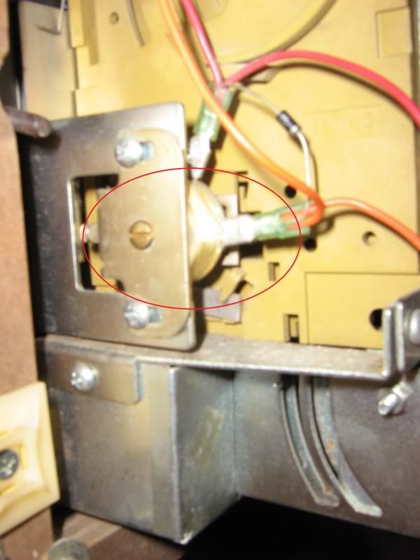

Got a pic of exactly what part is clicking ?

http://i3.photobucket.com/albums/y84/tiedyeskater/IMG_0168.jpg
so when i fire up the machine it flashes 02 06 1987,  then the coin mech clicks the light flashes on then goes right off  and continues in that fashion

That is the lock-out coil. It is to prevent people from losing money in a machine that is turned off. (won't accept coins)
It should click one time when the machine is turned on and stay on in order to "unlock" the coin mech.
Is the WHOLE machine resetting ? To where it flashes the date code and all that over and over ?
yea pretty much we got it to stay on and add credits by fiddling with wires tryin to find breaks or anything

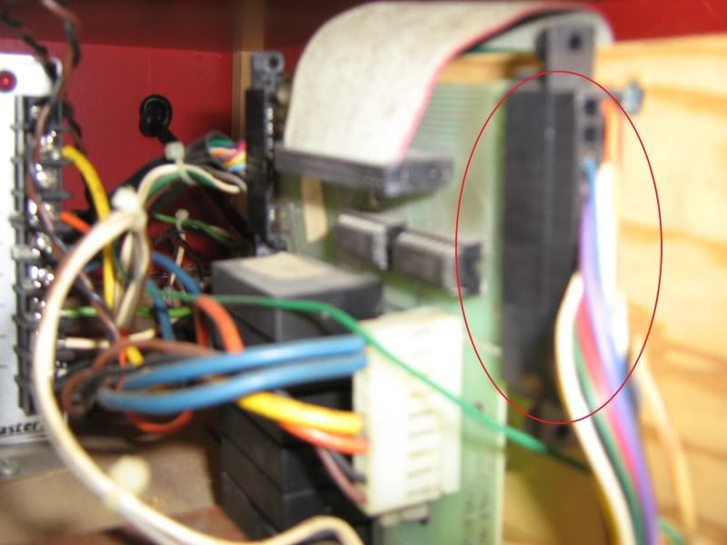

Measure all the voltages on the switching power supply. Make sure they closely match what they are marked. (+5vDC, +12vDC, etc, etc)
Re-seat all your wiring harness connections and the ribbon cables.

http://i3.photobucket.com/albums/y84/tiedyeskater/IMG_0162-1.jpg
i think that connection was loose i took it off and popped it back on and its been on for like 20-25 credits played and no resets

Yeah, that style edge harness can get a bit weak over the years. Or it just may have been a bit "dirty".
So is the machine running 100% now ?
Dropping fine?
Stopping the motor when it goes right ?

yessir i have had it on all day and the credits stay added no resetting all the bump stops  work good
