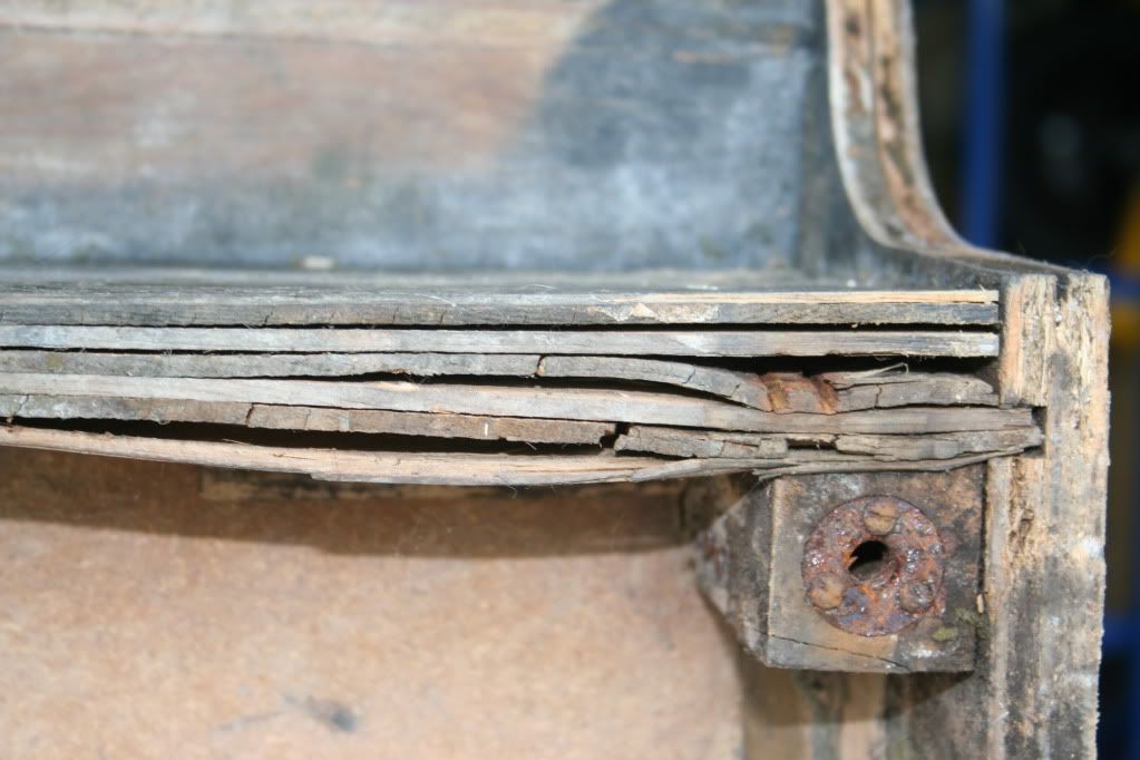

Now that she is apart and outside in the light, let's take a look and see what we have in store for us:
Hmm...looks like this got too close to something hot.  T-molding has melted and it looks like the wood has been burned
Bottom looks to be in rough shape
Upper back door is missing and lower door is swollen and needs to be replaced
Let's check underneath
Well, the front kick plate needs to go
and the back as well.
Looking closer at the bottom of the cab, that looks like mold
Yep, and pretty nasty stuff underneath
Cab seems pretty solid, with the exception of the front kick plate and the back lower section.  That mold is pretty nasty.  It seems to be just on the surface and I can probably sand it off.  Time to break out the heavy duty respirator!
I'm wondering if I should just use the cab as a template and cut new sides?  Saves having to deal with that nasty stuff.  I may do some work on it and see how bad it is first.
« Last Edit: July 28, 2011, 09:12:47 pm by Spyridon »

The front kick panel pretty much came apart in my hands
Same thing with the back

The front kick panel pretty much came apart with a crowbar in my hands.
Fixed. :lol
Spyridon
  • Posts: 1480
Re: (another) Space Invaders
« Reply #34 on: August 18, 2011, 08:47:29 am »
Fixed. :lol
ha, the crowbar was just to hold the pieces of plywood apart for the picture.  I just used my hands to pull it and it crumbled as I did.
