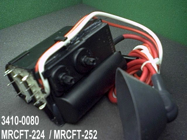

those thin lines are just flyback lines,meaning the screen volts is too high on the flyback and needs turning down
the fact that the picture reacts to a physical shock points squarely to a bad solder joint or plug connection

how would i turn down the flyback to get rid of those lines?

« Reply #26 on: October 11, 2010, 03:21:58 pm »
on the flyback transformer there are 2 adjustments-one is focus and the other is screen volts
google flyback transformer images and you will see

Been looking over it.  That solder joint you reflowed on the flyback that we all saw earlier in this thread looks BAAAAAAD!   :(  The pin sticking through is not joined with the solder AT ALL.  I hope the trace (which is now lifting pretty bad) will take some fresh solder.  I think it will be ok.
Your 2-pin connection for your degauss has the solder joints cracked all the way around both pins and is wobbling all around.  I'll reflow them with fresh solder.  Found one place where 2 pins are touching on the back of the chassis, but I think they are linked to the same trace.
Your new flyback like the one pictured here:
does not line up properly with the screw at the top where it attaches to the metal bracket for added support, but there is a hole in the bracket that I think I can make work to support it.
It would have worked better if you bought this model:
but I think they are functionally the same.  Also, the little clip that holds the red and gray wires was broken when I opened the package.  (No biggie, just serves to guide the wires somewhat.)  Might have been that way when you received them as I could not find the broken off bit in the package anywhere.
Funny thing, too (not surprising being a Neotec) your chassis looks ALMOST identical to my Medium Res NT-2701.  VERY SLIGHT differences.

I believe there are a few models that will work with these Neotec boards, 'cause when I Googled them, yours usually came up in a listing with the other models, but I think there are simply differences in the housing.
I'm going to fix all the bad solder joints first, especially the one on the flyback and that one Kevin spotted (am betting that is your main culprit!).  Then I will test it out on one of my spare 25" tubes and see if it displays ok and if your initial symptoms have improved.  That will tell us if it was the flyback I hope, unless it ended up getting damaged from the arcing.  I'll keep you updated man.
Pics of your ACTUAL old flyback and the ACTUAL new one so you can see the housing difference and the broken wire clip on the new one:
The arrow points to a spot I could likely use for the hold-down screw for your new flyback:
The arrow points to the spot the screw will have to enter on your new flyback:
Here's the broken clip on your new flyback:
And another view of the broken clip:

Couple more hiccups on this flyback installation.
The footprint has a part that slightly juts into the way of a ceramic disc cap, unlike the old flyback.  I was able to bend the cap out of the way enough to clear it.  But then, when I tried to seat the flyback, the 2 pins that appear to be there for mounting support (right under the Screen and Focus knobs), won't allow me to seat all the way down.  They are a little farther away from the main 10 pins than those 2 pins on the original flyback.  Here's a pic:
Also, I don't know HOW I didn't see these cracks as soon as I removed the old flyback.  But they are very evident sitting on the work table:
I REALLY think the MRCFT-252 should be put back in this chassis.  But I have seen the MRCFT-216 listed for "NT-2515C" (this chassis has an "M" added, thus "NT-2515CM") on arcadecup.com and another site.  Not sure where adidas1984x bought this MRCFT-216 from, but he said they told him this is what fits his chassis.
Does anyone know if I can just bend these 2 support pins enough to make the flyback seat down all the way (while still allowing them to poke through and be soldered), or will this cause problems?

« Reply #62 on: November 09, 2010, 04:22:08 am »
i would just bend them to fit if it were me doing this job

Contacted Neotec Support from the email link on their site and a "Peter Wang" replied with this:
you can use ft- 216 flyback. nt-2515cm is very old one. so the layout is little different with the newer version.but the flyback are same.
neotec
peter
So I will go ahead and bend the pins enough to allow them to still be soldered, but let the flyback seat all the way down.

The final testing went well.  The flyback seems to be working great along with the newly-installed cap kit.  I left it running for several hours with zero issues and even banged around on the frame of the monitor a little to see if there might still be any bad solder joints.  It's rock solid.  Played through Mortal Kombat 1 with absolutely no glitching, collapse, or anything to note.  Shipped it back out to him Saturday morning.
