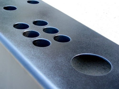

It's been a while since I've had time to work on this project.  Between new jobs and Real Life (tm) little has been done.  I found a bit of time and the bug is back to make some real progress on the cab.
I need to order the monitor very soon so I can start to get the woodworking complete.  Javery's Bella Cab has inspired me to go that route in regards to monitor mounting.  I think I'm still going with my planned Viewsonic mentioned earlier to keep the 4:3 ratio aspect.
That being said, I began peeling off the old artwork and vinyl to see what structural damages to the structure need repaired.  I wasn't concerned about salvaging any of the artwork; I can print new for far less hastle.  The back vents and the entire front and back of the cab appeared to have wood splitting, which I thought could be water related based on the musty smell of the cab in general.  There are also holes needing filled around the coin door from an after market security bar across the front.
My process for removing the vinyl was to grab a hairdryer, warm up the surrounding area, and starting from a corner, to slowly peel off the giant 'sticker', working your way towards the heated section.  You pull off as much as you can before the vinyal appears to stretch.  You don't want it coming off in tiny bits and it will tear, so do it slow and try to remove it all in one giant sheet.  And oh yeah, protect your fingers from the heat.  After 3 hours of handling hot plastic you get blisters believe it or not.
I was nervous about this process, as I have heard of others removing vinyl, but never saw any photos of this process.  I found that it comes off pretty easily, and is very similar to removing wallpaper.  I started in the morning and after 3 hours I got 75% of it off.  I quit only because my fingers became blistered from the heat.
Here is where I'm at with that process.  I'm hoping this weekend I can begin the patching process with bondo to repair the base.  I'm also talking with some folks about getting the vinyl printed.  Seems like it will run around $350 if I only want the 2 sides and front in vinyl and paint the rest white.  However, MY cab came with a vinyl top, bottom, and back side.  A true restoration means I would not paint this.  I'm up in the air over how I feel about this at this point.
Finally, pics.  Enjoy.

Notice the bottom chipping.  I think the old woodglue, clamps, and bondo trick are in order.

« Reply #74 on: October 14, 2007, 12:10:59 am »
So believe it or not, lots of work is being done on the cab.  The inside is mostly painted black, and you don't get to see pics of that yet cuz frankly, it's not ready yet.  However, this weekend I've made quite some progress on the control panel.
I've rebuilt the control panel pictured previously because I quickly realized that in order to route the bottom holes for the trackball and joys, I was going to need a flat piece of wood.. not a permanently assembled "l-shape".  Live and learn.  The second time around was faster with my new router skills anyways.
I decided to try the route out the bottom technique I read about in another thread (which I'll reference when I find it again).  What I ended up doing was taking the unit apart, tracing the teardrop pattern onto the wood.  Next, 2.25" hole saw to remove enough to completely surround and hug the plastic lip.  Then, I took a 3/8" strait bit and carved out all but 1/16" inside the teardrop shape, so that from the top it appears to be seamless.  We'll go over the mount more in detail in a few.  I also decided to bottom mount my u360's, dust washer on the bottom.
The bottom and top lips have been routed out to fit snugly as the exactly how the original metal cp did.  The unit is mounted via the same European hinges I used on the back door, so the entire control panel swings up, exposing the innards for easy access (pics of that later).
The MDF was primed with gray killzs primer, then I hit it with 5 or so layers of Krylon spraypaint for plastic sufaces.. wetsanding with 400 grit paper in between.  I spent more time on the top then the bottom, and ultimately, I'll be covering the entire cp with artwork.. but this should make it feel complete until I get around to that stage.  I hand rounded all corners on this unit to soften the feel a bit.
Pics as follows:
Top view.  Top row (p1,coin1,turbotwist,coin2,p2).  Middle row (joy1, p1fighter layout, 2.25 betson trackball, joy2)
bottom view
Front view
Top angle
trackball detail
Bottom angle
