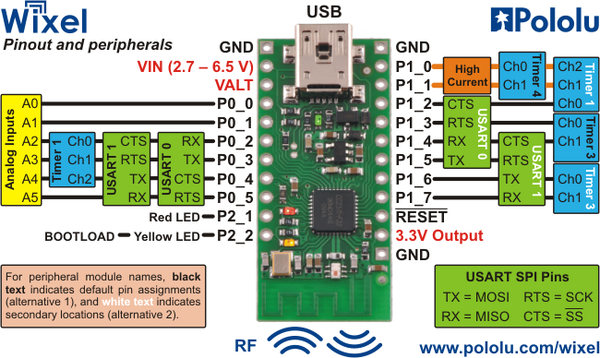

Would it be possible to run aimtrak guns or other usb guns wirelessly with pairs of these usb wireless things?
http://www.pololu.com/catalog/product/1337
and a battery?  It probably wouldn't all fit in the pistol shell, but is the concept sound?

For starters, even if the link would carry all the needed data (didn't really dig) -- you'd need to write the code to pass the USB data.
Warning about radio regulations: The Wixel has not been tested or certified for conformance with any radio regulations, and the Wixel is shipped with only a bootloader that does not use the radio. The 2.4 GHz band is relatively unrestricted in many parts of the world, but it is your responsibility to comply with your local regulations if you program your Wixel to use its wireless capabilities.

This would not work as the wireless module would need to have a USB host controller for the gun to connect to, which of course it doesnt have.
If you compare a wired to wireless mouse, the design is totally different. The dongle which plugs into the PC is actually the mouse as far as the PC is concerned. The actual mouse just sends positional data over the wireless link but the mouse itself has no USB functionality. The gun would work the same way.
There are two possible enhancements to future versions, namely recoil and wireless but they are unfortunately mutually exclusive, at least as far as a proper recoil goes, so there might at some point be a recoil and a wireless version but not a wireless with recoil.
I am at present designing a wireless mouse for a client, and we might use the same dongle for a future Aimtrak version which will make it more viable.
Bluetooth is another option but that is quite impractical unless millions of them are being made.
