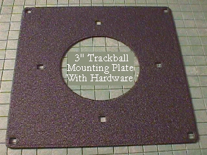

So this is the style of mounting plate the TB came with... and no bolts with it...
The picture on the listing showed the new style plate.  I'm not upset.  Just disappointed.  For the price the plate was basically a freebie.
Now the trackball itself is an Imperial unit.  It was new in the plastic and functions perfect.  I'm really happy with it.  It needs to be mounted very shallow to be used.
Should I scrap or sell the plate and buy a new style one?  I just don't see how this is going to work well.  Do the exposed bolts restrict any play?  Am I just being too vain?

Second, the new style mount appropriate for the Betson/Imperial trackball is WAAAAAAY better than that plate. Firstly, it has welded studs that are flush on top (no protruding bolt heads! WINNING!). Second, it has a nice lower 'carrier' that ever so gently cradles the trackball housing, and has a nice grommet opening for routing your wires, so they are not hanging off of the plastic trackball housing.
LINK FIXED!
http://www.happcontrols.com/trackballs/55032100.htm
Its only $12, which is the opposite of what Happ usually charges for things. Usually they want ridiculously too much money; Here, it seems like they are asking too little? I would think some of the vendors on this site would have them too...

Now thats one serious piece of CP hardware.  I've never seen that part before.  Its surprising that its cheaper than the simpler looking trackball plates.  Unfortunately Happ has a $25 minimum order.
I have a drill press so I'm gonna try to create some countersunk bolt holes in the existing plate.  The trackball excepts flathead screws already.  Worse thing that can happen is I have to buy the uber plate from Happ if I trash this one.  I just have to find bolts now.
