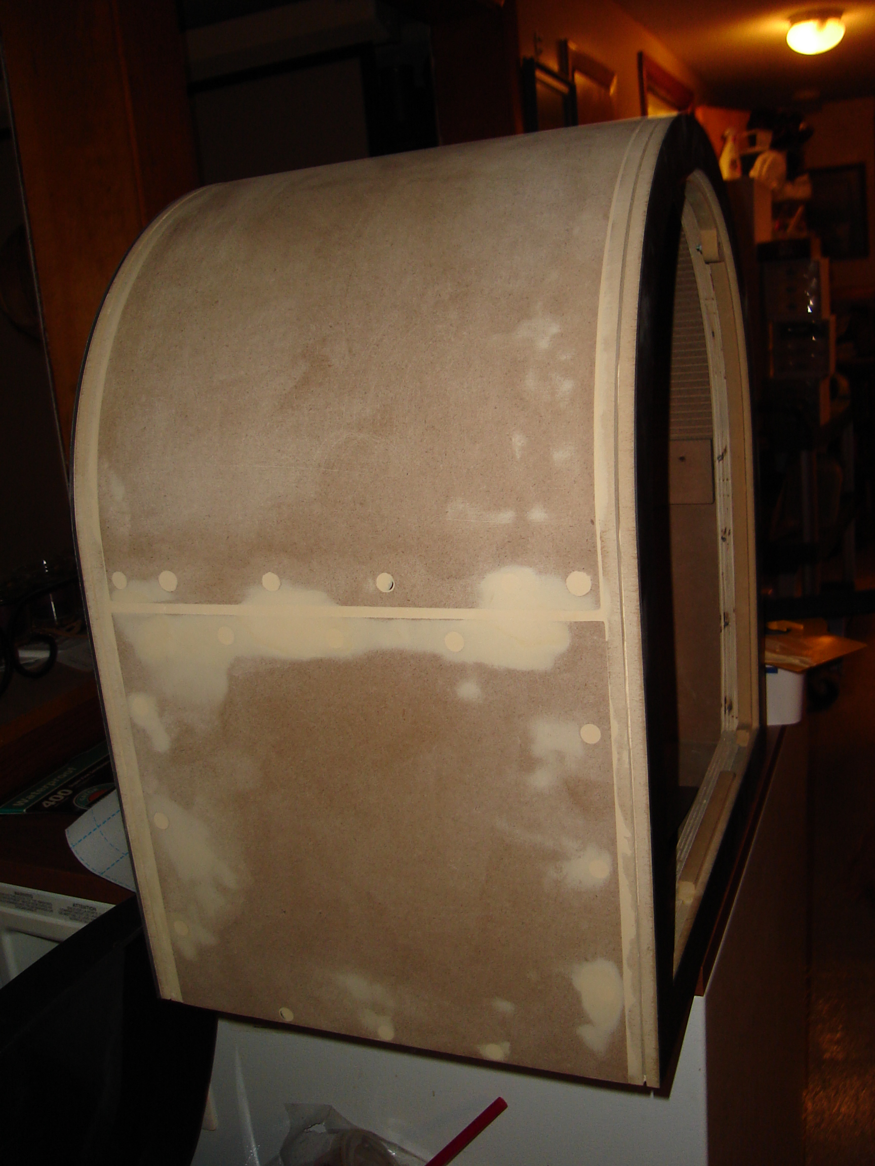

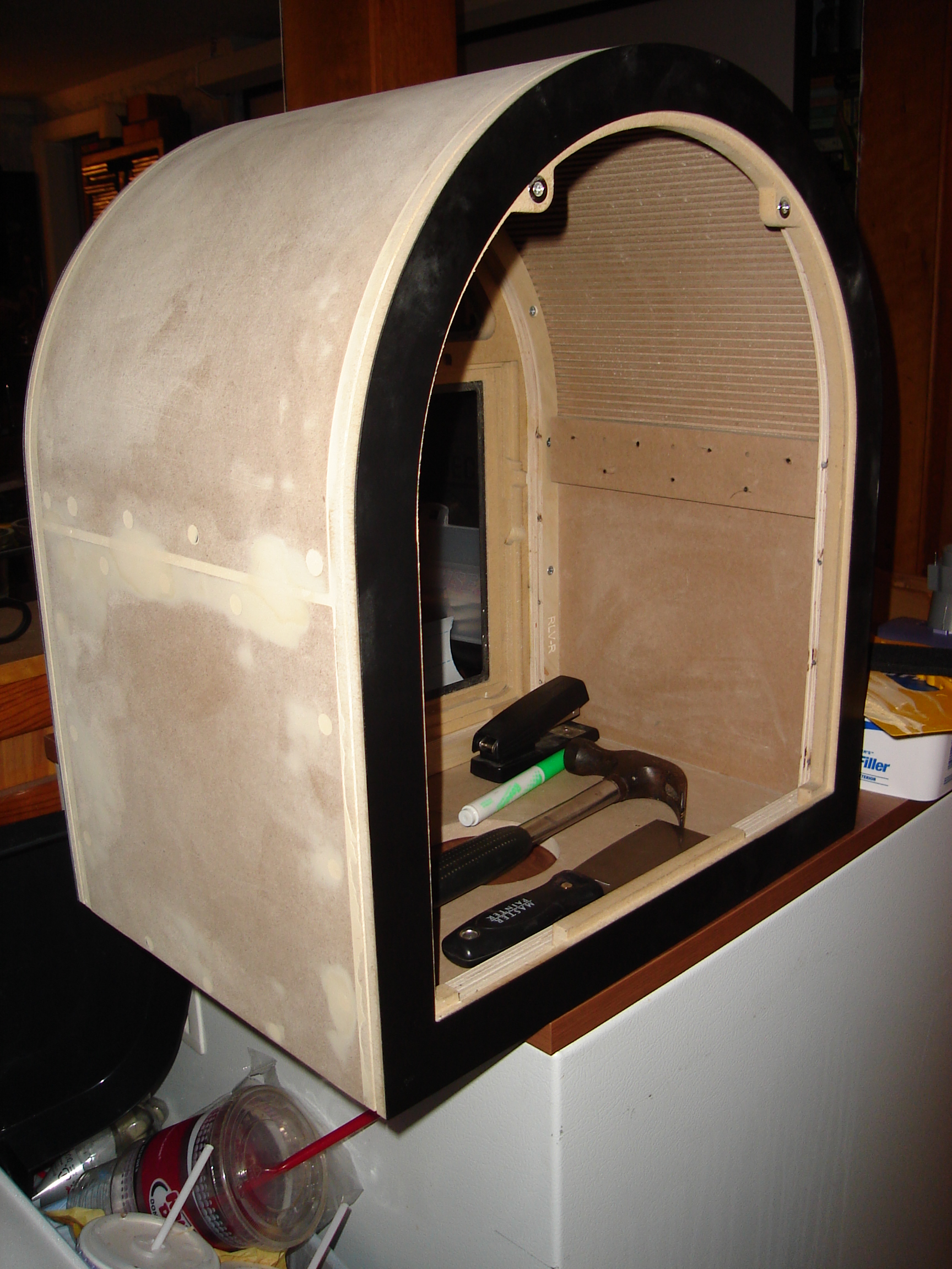

Tips and tricks on assembly:
Mountain sent it shipped with ribs in place. For extra strength I removed them and glued them in position as well. It may be overkill but no harm in doing so.
The instructions suggest rolling the curved top in place. This is not necessary. The top is solid and easy to bend in position.
You WILL need to countersink the screw holes in the curved top, and I suggest slightly countersinking all the predrilled holes in the side and bottom, a bit more than the countersink they are shipped with.
Make sure to flush the side pieces to the bottom on the front and back. After bolting the top in place there will be 1/8th" gap on either side above the side panels. This is normal. Fill and sand similar to how I am doing in this picture.
The included drywall screws may not split the mdf like a regular wood screw, but they will extend into the case. Either find 3/4" or 1/2" fully threaded flat head wood screws (or really short drywall screws?), or break out the cut-off wheel and nip them. - Use a reinforced cut off wheel, not the standard one you see shattered in this picture.
The curved top is extremely tough. The instructions recommended running beads of glue to add to the sturdiness once it is in place. I may still do this but it is built quite well without it.
Also when the touch screen is mounted there is a 1/16" gap between the glass and the acrylic. This is for the proper function of the touch screen. To mostly fill the gap I am adding dark gray foam tape ( most likely with the edge blackened with sharpie ) to make it look tighter.
