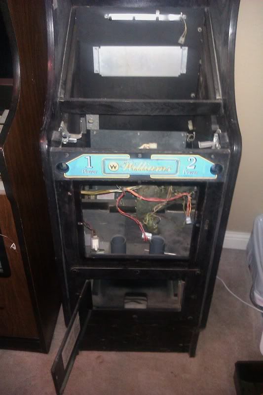

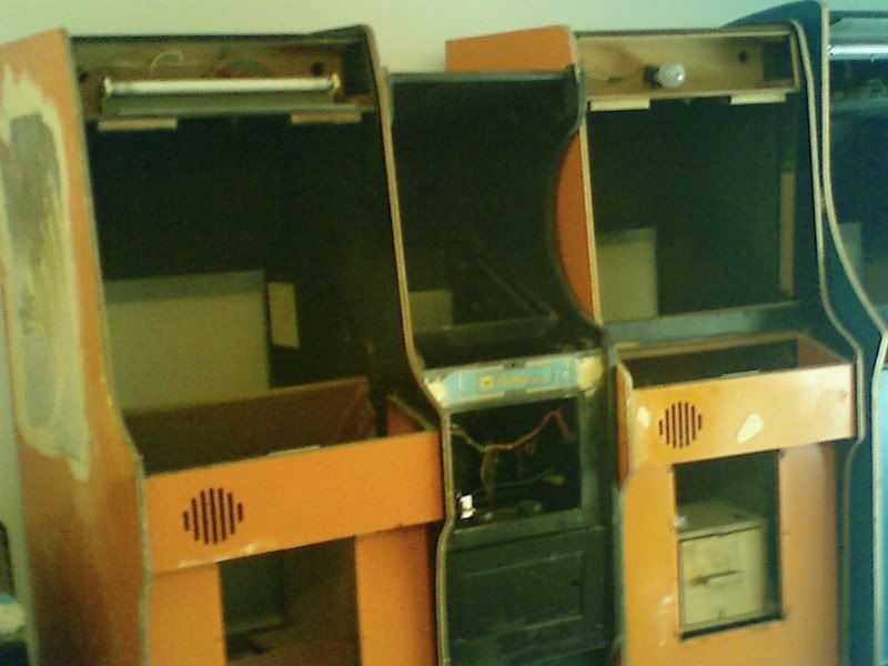

This is borderline a "restoration" and a "project". I bought a Williams mini cabinet about a month or so ago. It is a Bubbles mini but it was missing the control panel and a panel under the marquee. Some nice wood damage along the bottom and sides and of course, no original boards.
So this is my chance to build a Stargate mini!!!!
I will post more photos but THIS is what I have started with:
I have gotten help from Mlenardon from coinopspace and klov with artwork. He is the reason I am posting this, as he asked me to post progress, I will. He sent me a CPO scan, a marquee scan and a bezel scan. I actually found an NOS Stargate Mini marquee and bought it. Now I have to work on a custom bezel.

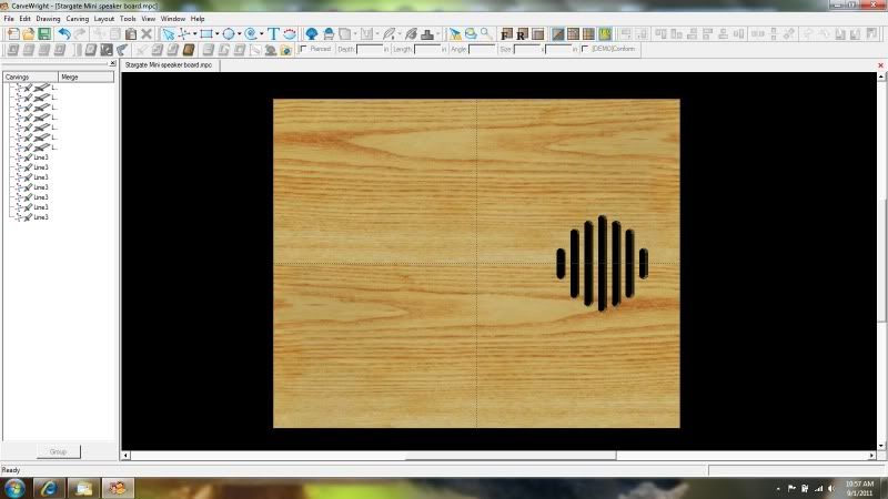

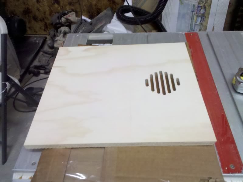

I am having custom wood cut for this. One panel for the CP, with a mortise cut for a Nintendo 2 way joystick (you can't find the original Stargate mini joystick) and the under marquee panel with a Nintendo style speaker grille routered out. Much, much more to come...

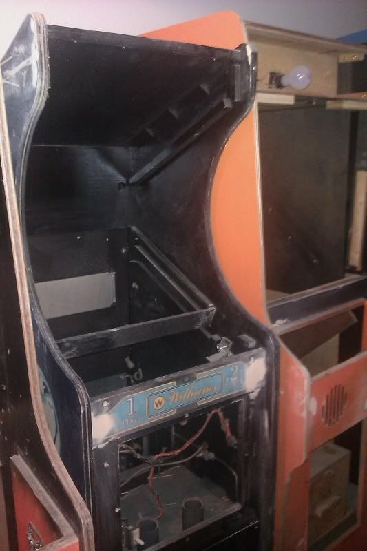

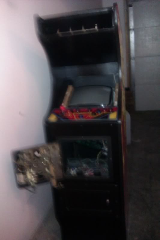

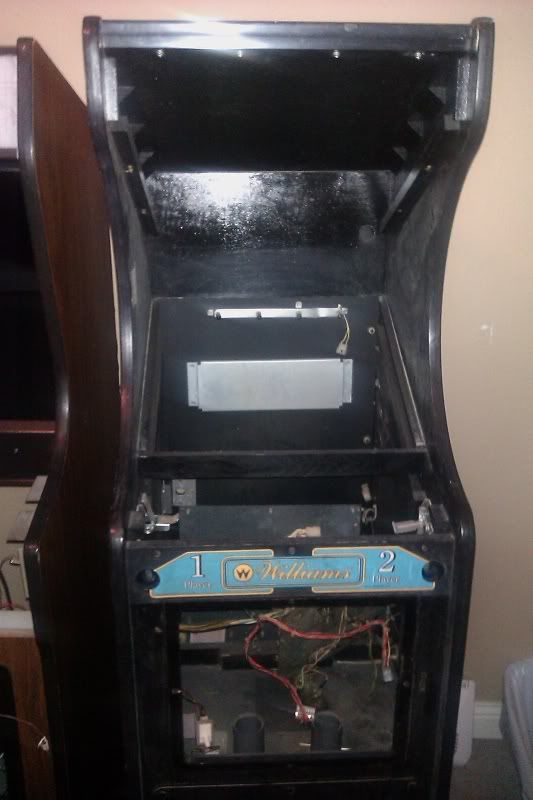

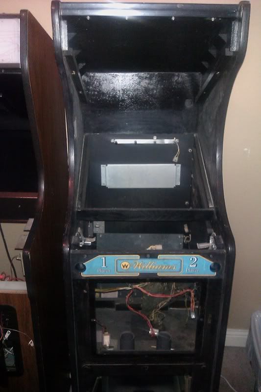

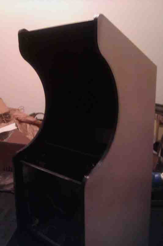

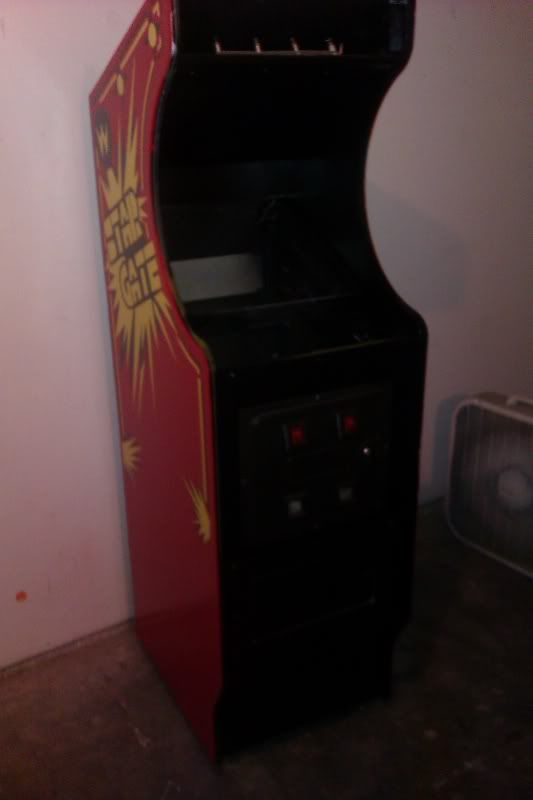

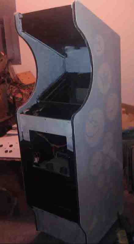

So this is what I started with. No control panel, no marquee and the panel under the marquee with the Nintendo style speaker grille cutout removed.
There was some wood flaking at the bottom, as the leg levelers had been removed and the cabinet was being slid around directly on the wood, which is always bad. I put on 2" casters to raise her off the floor and make her easy to move around.
I love Emlers Wood Filler, not toxic, easy to use, cleans up with water. I breathe enough toxic stuff from the paint!
Here she is in the cue for bondo work in my overcrowded garage! The Nintendo & Midway cabinets are conversions I am working on for a client, they are not mine.

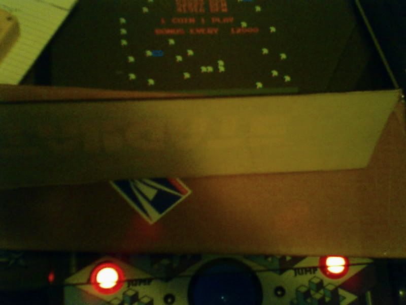

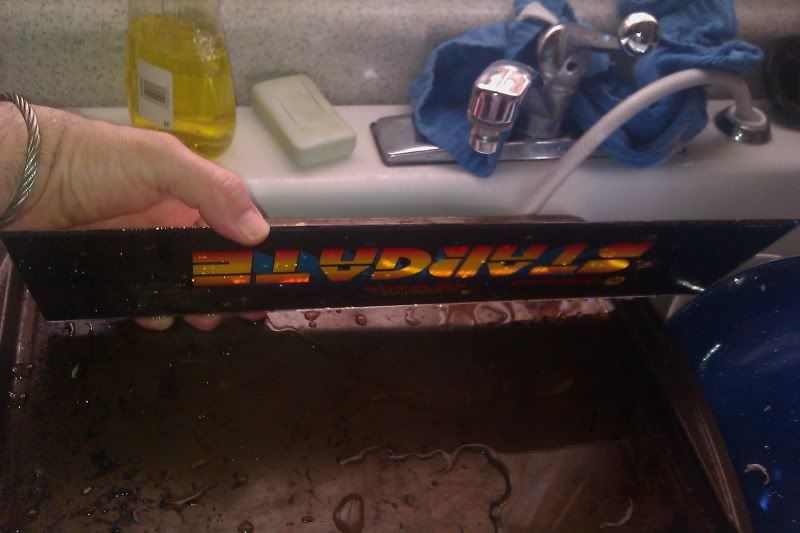

And look what I found! An NOS Stargate Mini marquee!!! Still has the proctective layer of paper on the back!

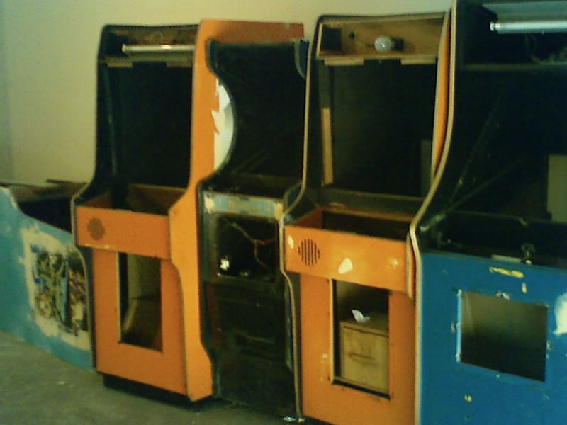

Here's a few shots of savit4l8r's Stargate mini and the only photo of a Bubbles mini I have ever found:

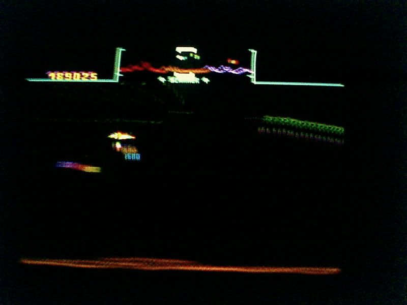

And a recent screen pic of my Stargate High score I just got on thursday:

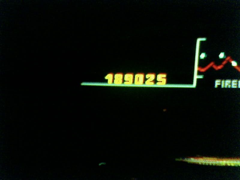

The greatest game ever created IMO: look at this beautiful, grainy shot of a real G07 monitor working perfectly with Stagate!

Nice.  Somebody else around here owns a Carvewright.  LOVE my machine!  (Hope he's not charging you too much!)

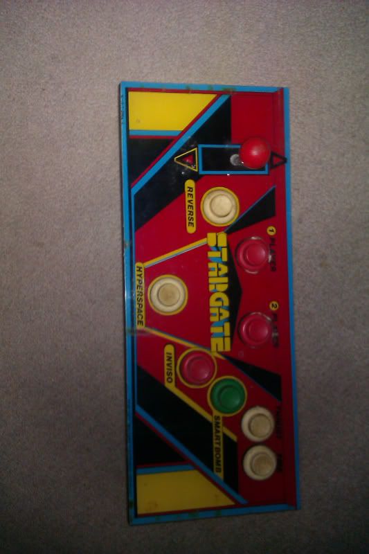

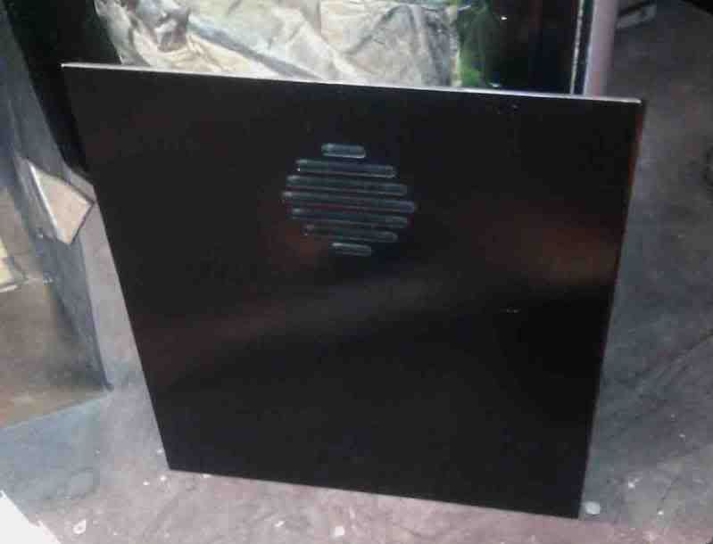

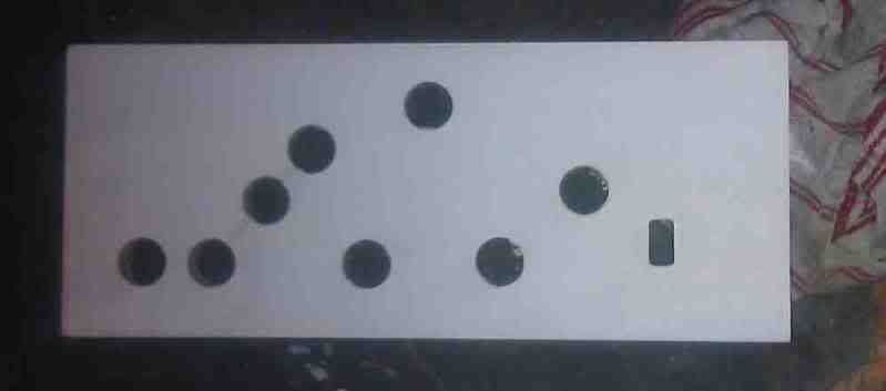

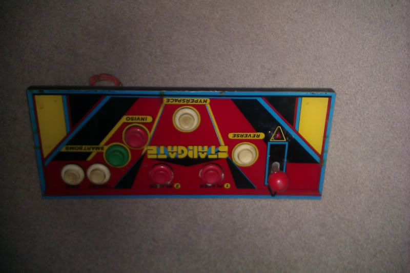

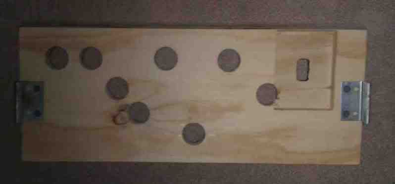

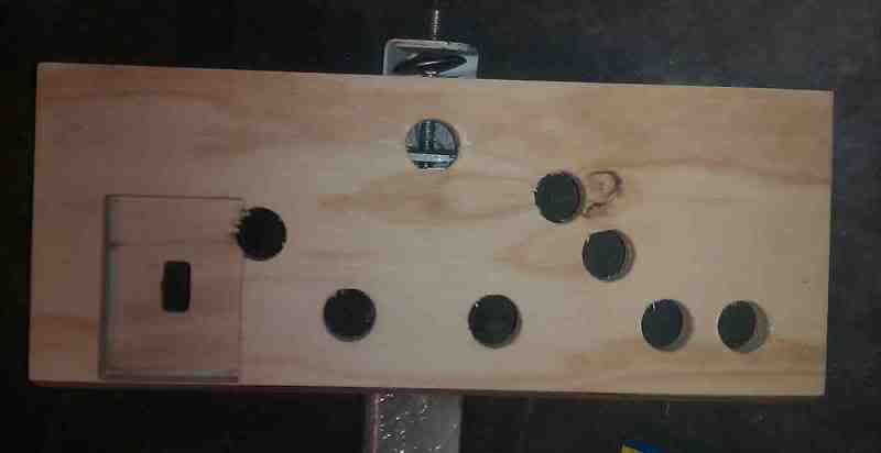

The under marquee panel cut by Jeff412 over at KLOV. Nice work and it shipped perfecly!
The control panel cut by Jeff and the buttons holes drilled by yours truley.
Control panel primed with Bullseye 321, this is awesome stuff!
Bubbles start buttons bondo, first round of bondo.

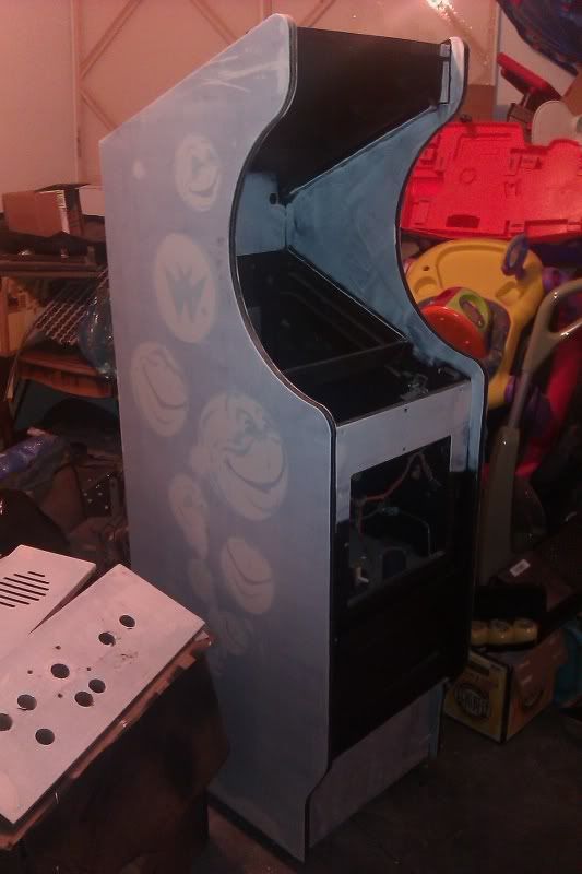

Start priming the sides and some of the front. The bottom two carriage bolts on the Williams mini are inaccesable without taking wood apart. So instead of tearing up wood or cutting the bolts off, I decided to leave the bottom coin door on the cabinet. I never do things this way, as you can see that the top coin door has been renoved and has been refinished to be installed much later on.

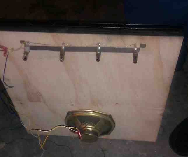

Here's the under marquee panel with an original 6" Williams speaker from a Duramold and the real marquee light strip from the Bubbles, so even though the wood is new, the working parts are real, original Williams parts!

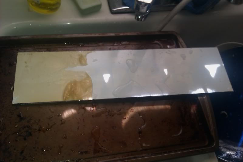

The panel primed and painted with Rustoleum high gloss black professional. I will tell you that the "professional" versions of Rustoleum spray far superior to the "regular" cans. The pro versions do not drip, spray in any direction and go on super duper smooth. I can't find a Hammertone black in the professional cans yet though.
I actually tried good ole trusty "Satin Black" and I did not like the finish, Stargate cabinets have a nice sheen to them, kinda a semi high gloss. When I work on basket case Williams cabs, I always reach for satin black but this was a special case and I was able to get the cabinet really smooth and take my time. The high gloss is a bit "glossier" than original but I like the finish and I am going glossy on this.

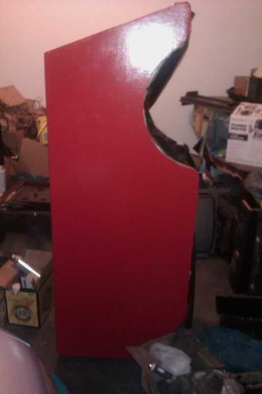

Re: Stargate Mini project
« Reply #6 on: September 24, 2011, 01:17:01 pm »

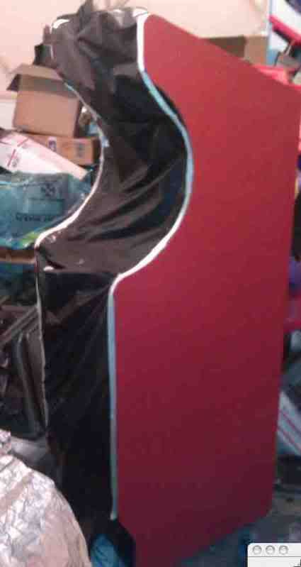

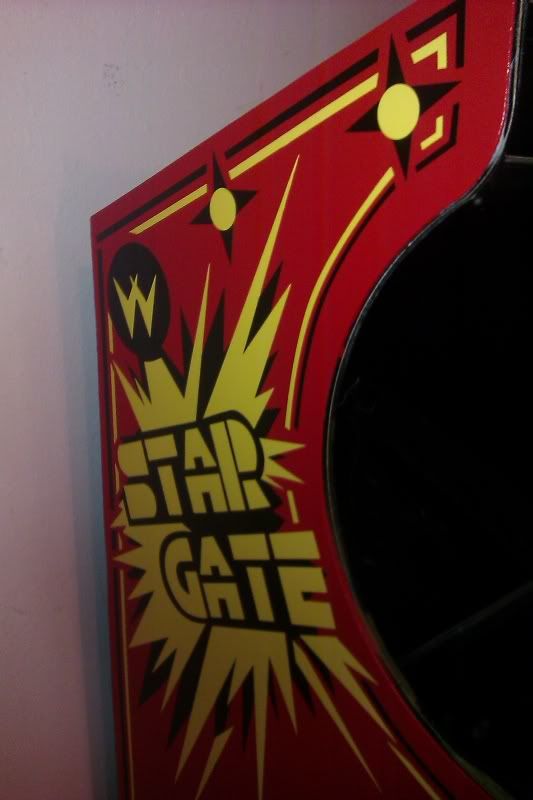

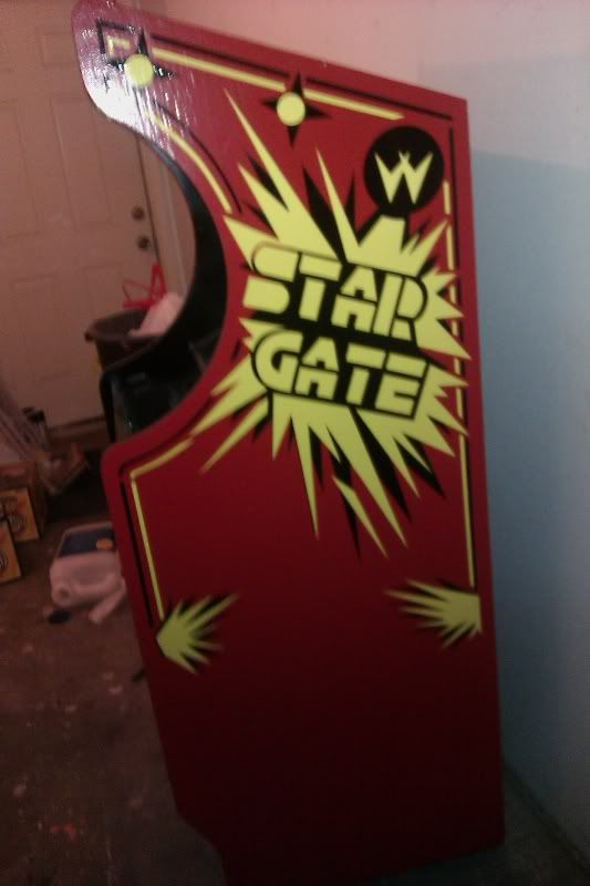

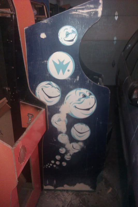

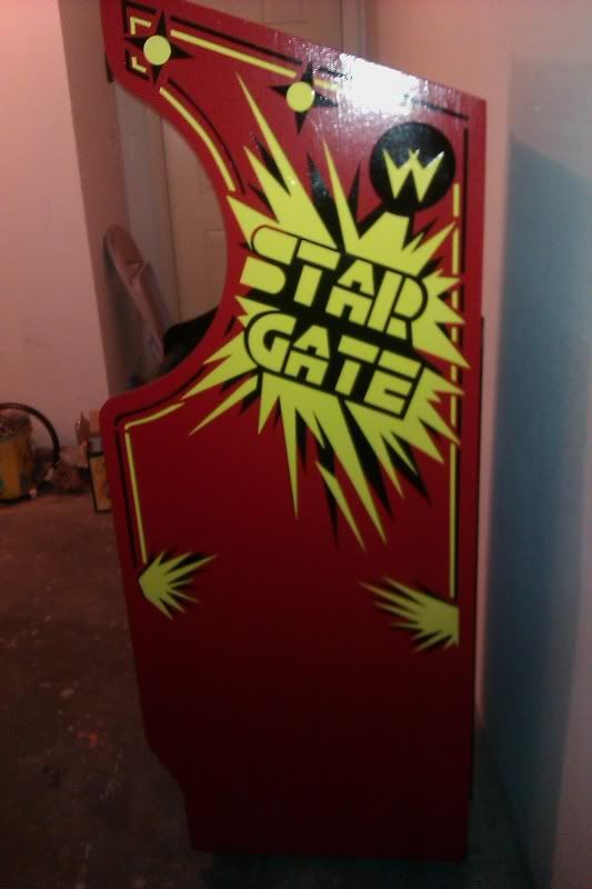

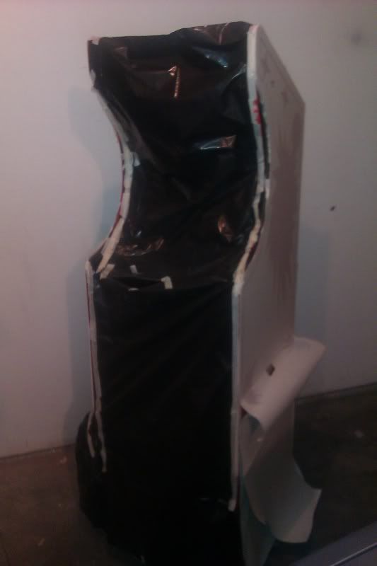

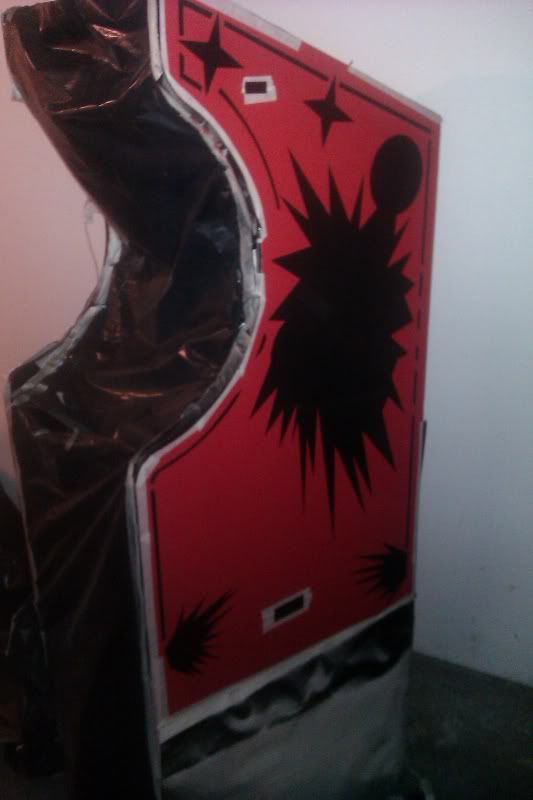

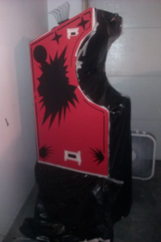

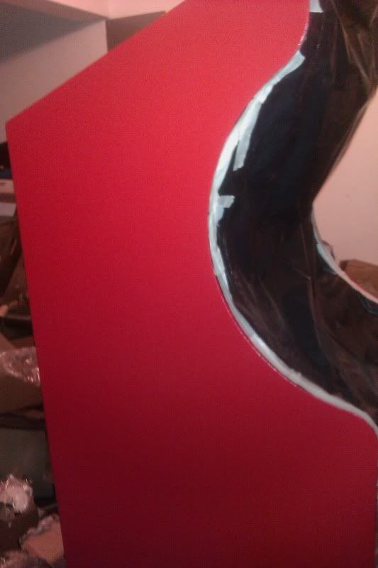

I went maybe 4 passes of primer/bondo(woodfiller)/sand before I got the front acceptable, it will never be perfect, especially with high gloss black paint but it will work.

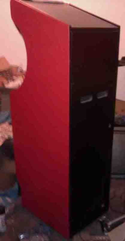

Then it was time to start painting the red base on the sides. The only color code I could find was "Ralph Lauren Duke Red" from Home Depot. They do not carry this brand anymore but they can go into their computer and match almost any brand of paint, so I had them mix a batch of semi gloss, which you see here. I actually want this glossier and I will be buying another can of this but in high gloss.

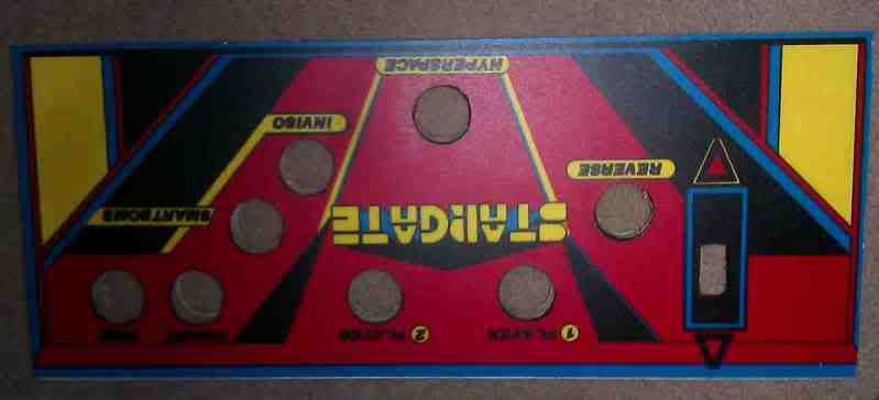

CPO from arcadeoverlays. I am very happy with this CPO material, the best non-NOS CPO I have ever used. Really close to the old school polycabonate. A few hours later and we have 8 button holes and the 2 way joystick opening cut out!
I have no ability to cut button holes like in an original Williams cabinet but I am very particular about using real, leaf switch buttons. Stargate should never be played with micoswitch buttons, it just never feels right. I love translucent leafs and I have used some old leaf switch holders made for plywood. The buttons cannot be held in with pal nuts anymore but since this will be in my home and not a real arcade, I'm not worried about the buttons going missing or falling out.Stay tuned!!!!

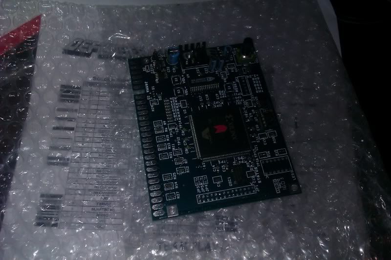

I just could not believe this when I saw it in a sales post on klov. So I spent $40 on having a new, fresh control panel cut and another $35 on a new CPO that I will not need....

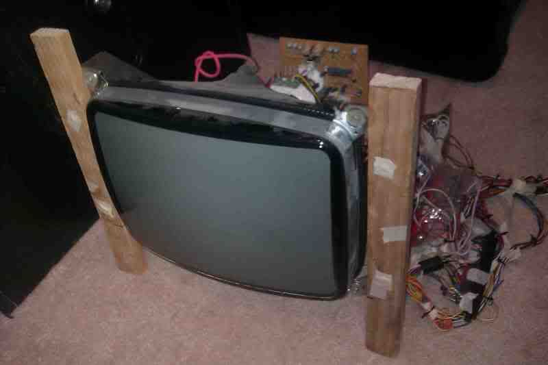

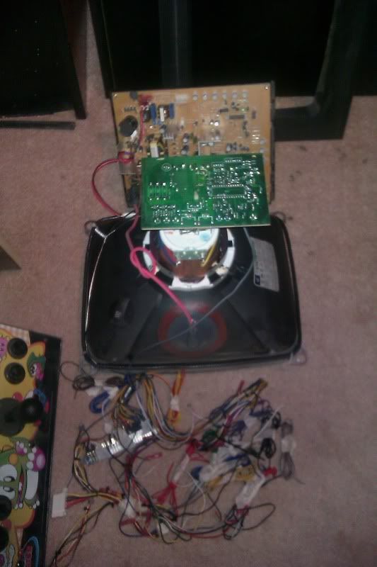

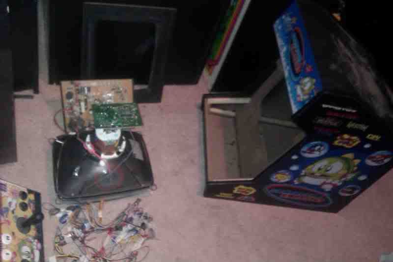

So the 15" CGA monitor I will be using is from this Taito "Gameroom Classics" Bartop cabinet, sans PCB, of course. This monitor is basically brand new and displayed Stargate perfectly. Since it was crammed in that tiny bartop, the monitor has no frame and was extremely difficult to pry out of that tiny cabinet. I did not want to disconnect some of the tiny, tiny wires that connect the jamma harness and the monitor, so I decided to work around the harness that came in the bartop. A bit messy and not the "correct" way of doing things but this will get the job done. I used a monitor frame from a G07-FB0 that I broke the yoke on and it fits perfectly! Then I had to figure out a way to mount the monitor in the cabinet and I really do not want to cut a big piece of plywood and cut a hole, so I took a shortcut. I carefully measured the slots on the inside of the cabinet where the wood is suppposed to slide in, cut my wood and mounted it to the monitor frame. As you can see, the harness is still there!
The contrast ratio of a real, CGA arcade monitor is much higher than VGA CRT's I have encountered. Stargate has some really cool strobing effects in the attract mode, mame plays Stargate perfectly but does not DISPLAY prefectly...years of experinece on this one...

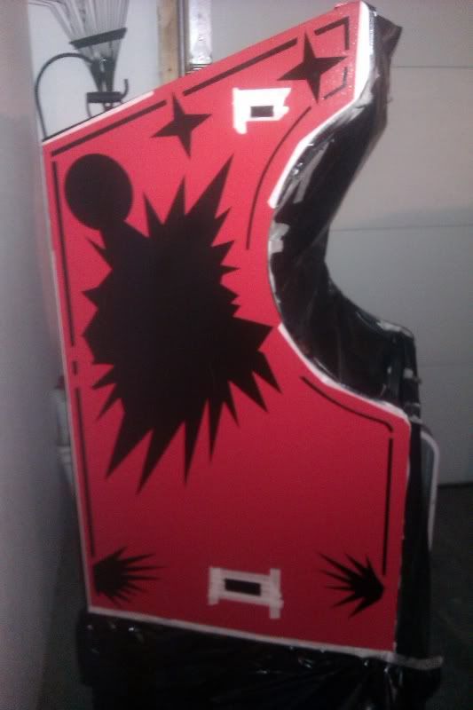

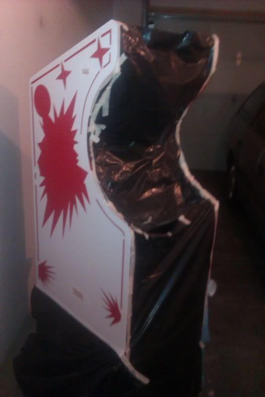

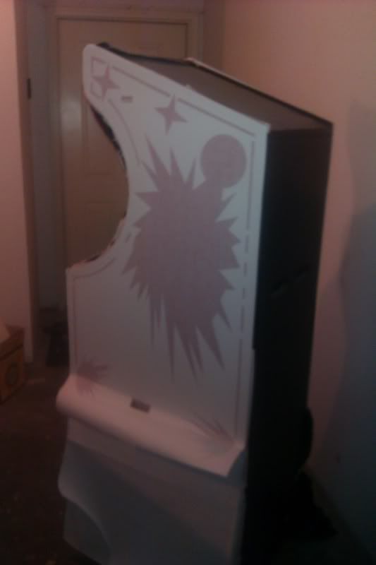

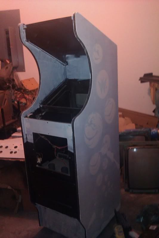

I must say that this particular little cabinet has been more work than any other cabinet I have ever worked on! Every little detail is always more work than expected on this one.

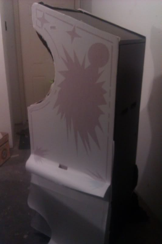

For instance, the T-Moulding on the Williams mini is very detailed and has curves in almost every spot in the the length of the t-moulding, making this a very detailed job. A full sized cab usually takes me about an hour, this took me 2 hours!

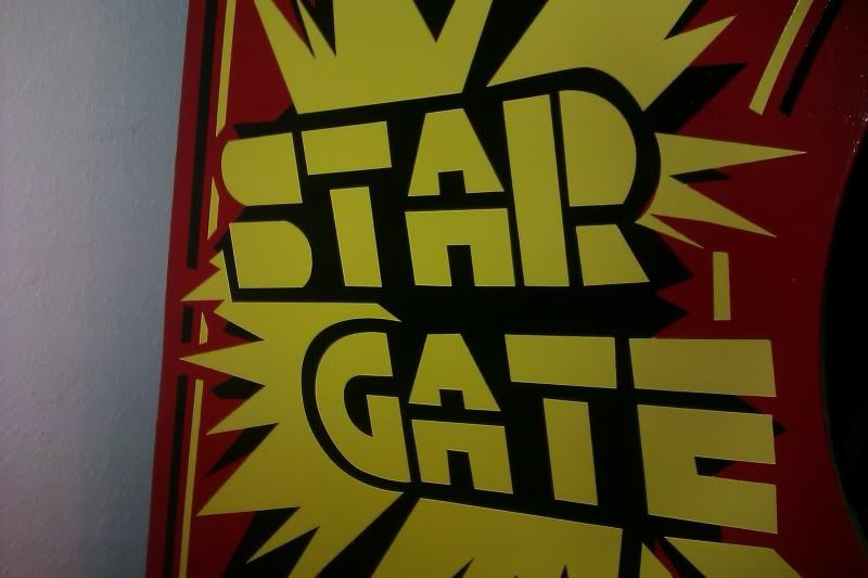

I am posting a few shots of the stencils as they went on. Again, very advanced stuff here. This was my first stencil job and I am glad I have done lots of side art installations before I tried this. Doing stencils is almost like doing painting/side art TIMES 4! !) Paint and sand 2) apply stencil(s) 3) paint stencil(s) 4) Remove stencil 5) repeat as neccessary! YIKES this is very, very detailed work. Do not be in any hurry when you attempt to do this. My results were not perfect and I learned a few things along the way but I like the way it came out.

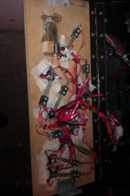

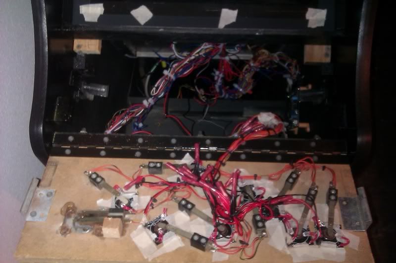

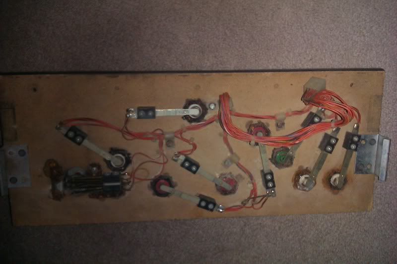

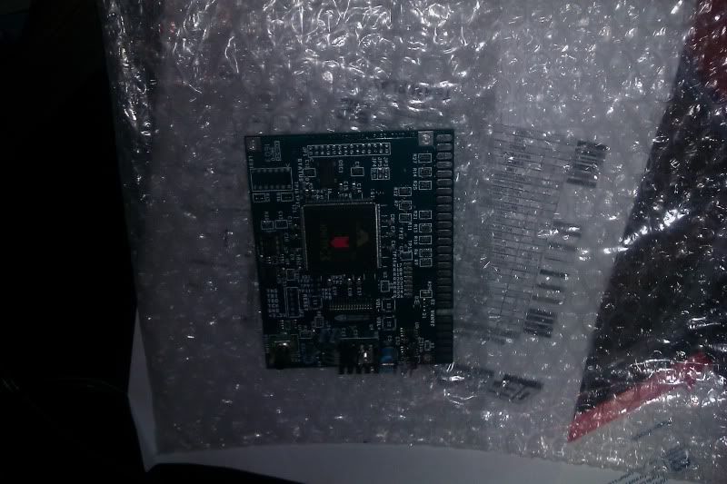

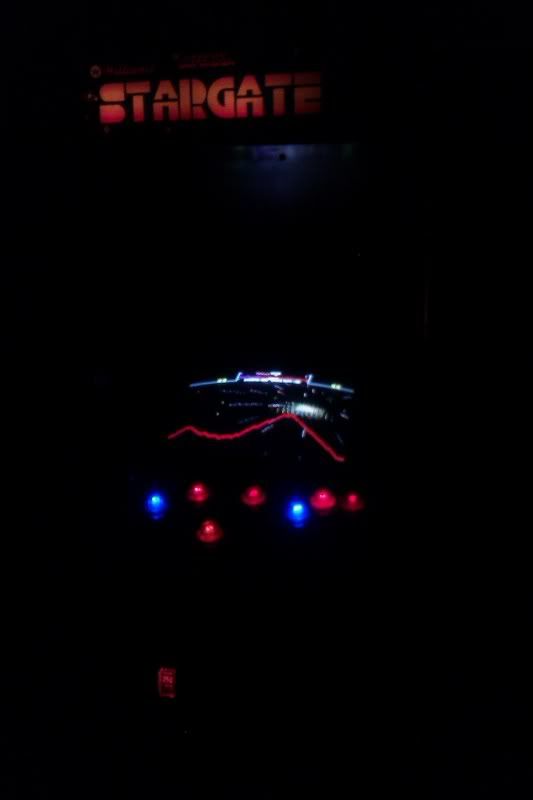

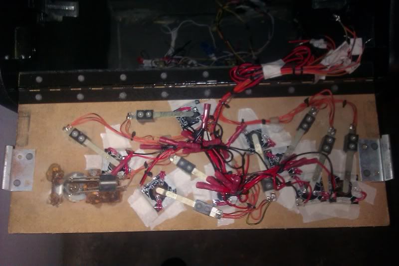

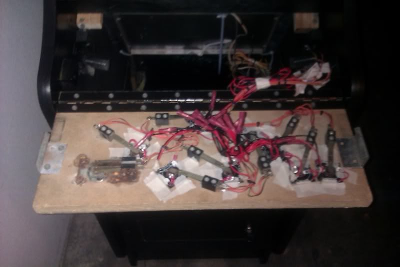

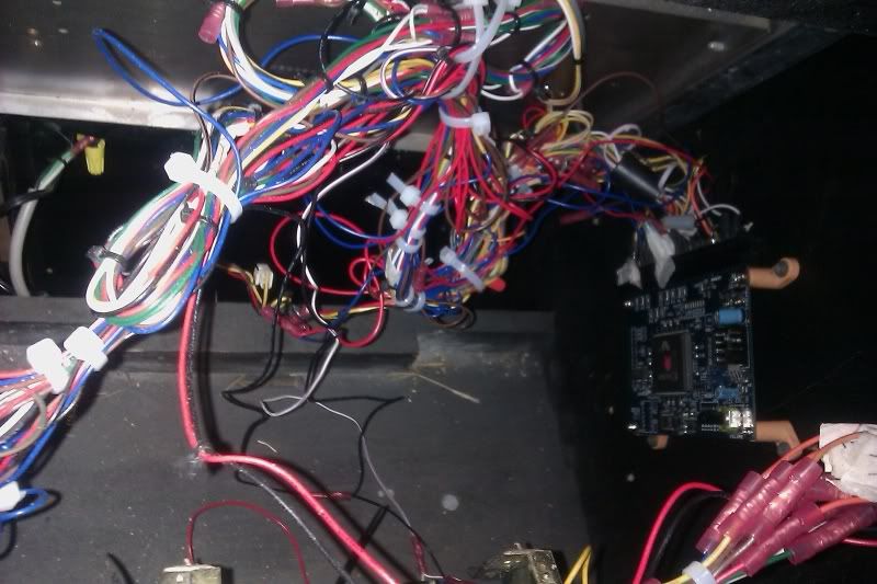

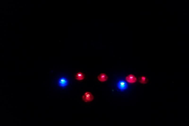

This little project turned into more hours of wiring a cabinet and control panel than I have ever done before. This is almost embarrasing but when I add up all the time involved with just this tiny control panel, it comes out to about 10 hours of wiring altogether and I DO know how to wire a control panel but this one was just soooo much detailed work in a tiny, tiny area!
The nicemite led's worked perfect! They were crucial in getting all those led's into basically no area to install them. The Stargate mini control panel I bought had the artwork reverse printed onto plexi and this made the cp just a tiny bit thicker than normal. So the pal nuts just had no meat to grab onto the leaf switch buttons, so I was forced to tape the nicemites down and the pushbuttons themselves are held with friction, as they are super duper tight in the plexi. In fact, there is joint compound in the holes from where someone glued in the original buttons. This is about as much wiring I could get into one tiny area!
You can see how I mounted the PCB towards the front of the cabinet, works nicely, as the volume pot control is directly on the PCB itself.

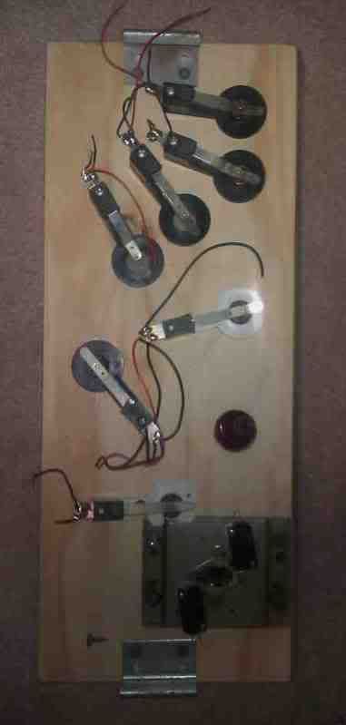

The special two way joystick needed to be rebuilt, as it was very sloppy moving up. I salvaged a Midway joystick for leaf switch parts and rebuilt this bad boy. No sloppiness! I has to use two screws instead of bolts to hold the leafs, so I screwed into a piece of scrap wood to hold everything together.

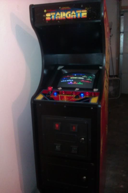

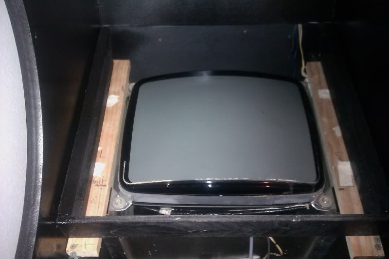

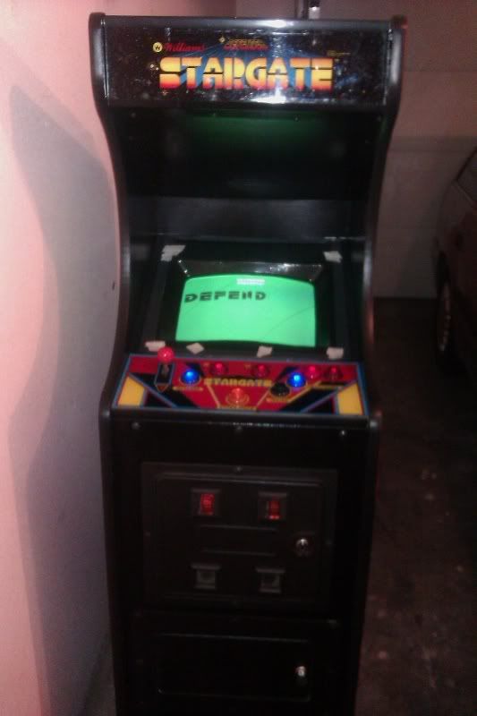

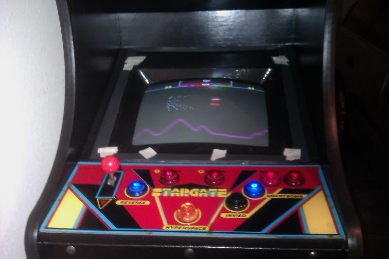

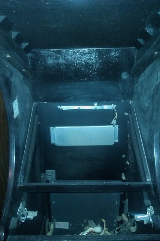

Here's how I mounted the monitor. A real, 13" CGA monitor, no VGA here!
The coin door is missing the coin return flaps, that can be taken care of later (Lizardlick has these)
Again, I ran into way more work than I ever imagined with the marquee. I thought this part would be easy but since the marquee is an actual 28+ year old NOS marquee, it still had the protective backing paper on it. I soaked this for hours in soapy water but it took at least 45 minutes of very, very carefully scraping off the paper, piece by piece by hand, ACK!

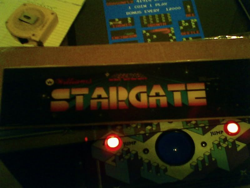

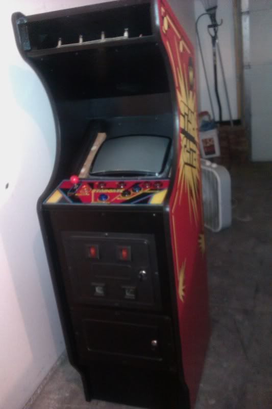

So after hours and hours of wiring and connecting and all the other stuff, I reach that critical moment where I hope everything is connected properly and won't blow up when I actually plug the game in for the first time. Posting progress here, just makes this even more of a highwire act, as if I fail, I fail in front of all the peeps reading this thread. I double, triple, checked, said a prayer, plugged her in and......
SHE WORKS!
« Reply #18 on: October 29, 2011, 10:19:15 am »
Very nice! :applaud:

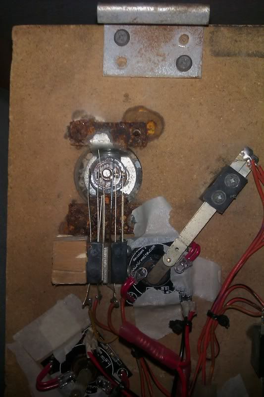

Is tape your final solution for your LEDs? I know the last thing you want to do is more work to your CP, but this seems like a good solution to your pal nut problem:
Recessing holes for your pal nuts would be ideal, but if you don't want to recess holes for the pal nuts, the screws seem like a more reliable mounting method for the LEDs than tape.
taylormadelv
  • Posts: 377
  • Last login:February 18, 2019, 05:46:59 pm
« Reply #19 on: October 29, 2011, 10:22:53 am »
She's not completely done but I get to post some very satisfying photos of her working here; I normally like my marquees off but the fact that the 6.3V bulbs are real dim in the marquee fits me perfectly, very happy with how the marquee is dim and doesn't light up the room it is in.
You can see the plastic bezel that I am using. It had a smooth, plastic finish, which I did not like and did not match the Williams bezel, so I painted it with Rustoleum Hammertone black and got a finish that is close to an original Williams bezel. I have used masking tape to secure the bezel until I cut a new piece of posterboard for the plastic bezel.
Also, as you can see, the Green translucent button is so dark that the led barely shines through it. Nicemite did not offer a dark green option, I really needed it...
The glass bezel and the bezel artwork will be last....Thanks for looking!
I will be looking into a solution like this. Remember that the CP is 28 year old, crumbly particle board and will fall apart instantly with any resitance. So drilling is out. I do not like using masking tape as a permanent solution. I like the screws solution, I will probably try this....
