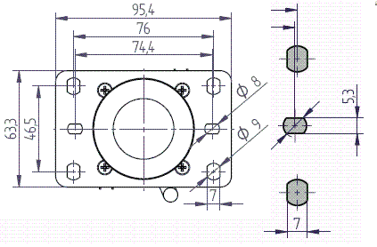

I currently have two mag sticks and I'm thinking about switching them out for two U360's.  Do they have the same mounting so I don't have to drill new holes?

These are the mounting plate dimensions for the two sticks:
Mag Stick:
JLW/U360:
As you can see the Mag Stick mounting hole dimensions are 76x46.5mm. The effective mounting dimensions of the JLW/U360 are 85x50mm.
While they are not an exact match you could probably enlarge the holes in the U360 mounting plate so that you can use your existing fittings. The U360 mounting plate has small 5mm wide mounting slots so I would imagine you would have to enlarge them anyway as I presume your mounting hardware for your Mag Sticks is larger than 5mm. As long as you use a decent size washer on the enlarged mounting hole I think you would be fine.
The U360 also has a very slightly larger mounting plate (97x65mm vs the Mag Sticks 95.4x63.3mm). If you have recessed your joysticks you will need a slightly bigger recess but I would imagine they will fit in unless your were very precise with the pocket dimensions.

Here you go. The Mag Stick plate is in blue and the JLW/U360 is in red:
As you can see they are not too far off, you would just need to remove a little of the U360 plate. You can easily do this with a small round file or Dremel or whatever.
Hope that helps!  :)

Thank you.  That was immensely helpful
