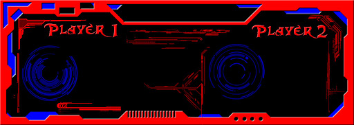

Optical Control Panel
This first project of mine is super budget, and I have no space in my house with 4 kids to keep a CP setup or build an arcade.  So I am modding my computer desk into the CP,  To make it look more official and to cover my holes if I have to end up top mounting the joysticks I knew I needed an overlay of sorts.
I decided the best/easiest way to do this was with a adhesive vinyl print, It was hard to find a place to do this in the size I needed and anybody that did it custom wanted WAY to much money.  I got lucky and finally found a link from here in another thread to mamemarquees.  There prices are not too bad but what I found interesting is they have different stuff, the Vinyl was more expensive than the marquee and the marquee being a nice plastic material seems like it would hold up as a CP just fine, even if the marque product is not supposed to be suitable for a overlay under a piece of lexan or plexi I see no reason it wont work.
I thought to myself what a waist though, it.. could light up for a great effect as thats what it is designed to do.  So thats when I figured hey why not just cut my entire wood CP out except for the frame and put a nice piece of plexi in there, mount all the controls to the plexi and put the marquee under it and then wire some lighting up.   Forget light up buttons... how about an entire light up control panel???
Here is the 30 minute mock up of my control panel design.
What I am going to do is install the stuff into the panel, take a picture of it, and then in photoshop overlay the CP with this design and move things as needed, stuff like the blue circles are supposed to be centered on the joystick.  I designed this with the idea of vinyl I did not even have the clear CP w/ lights idea yet.  However this design seems almost already absolutely perfect for that idea, the black should block out the light mostly or completely and the red/blue will light up like fiber optics.

@ Optical Control Panel
I don't see an image?
