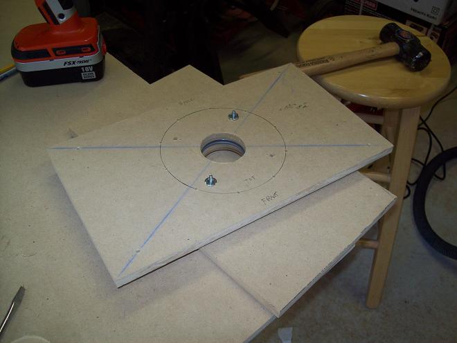

Man what a beautiful day.

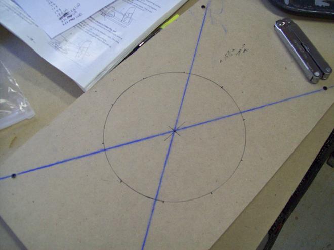

I had already attempted to make the two pieces that will rotate against each other, but I didnt like the way it turned out.
But I will touch on it a bit.
I cut two pieces of 1/2" MDF, one a 1/2" shorter than the other.
I then marked the center with a chalk line to each corner.

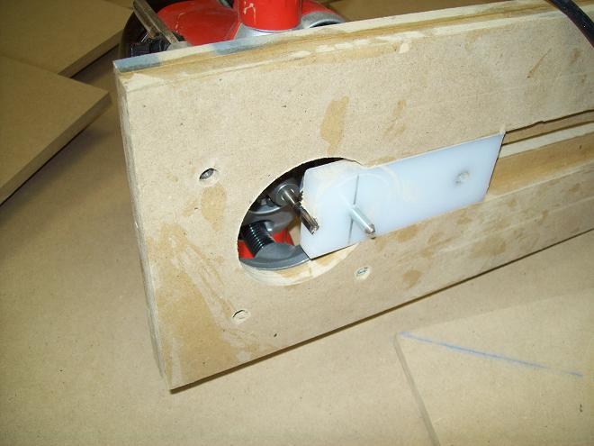

I then set up my circle cutter to cut out the center hole.
I had to route out a space for the bit to clear in the nylon block I used.

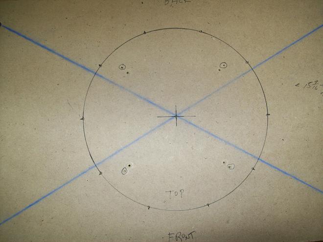

I then attempted to mark the holes for the magnets. I have 10 magnets so there needed to be one at every 36 degrees.
This was very hard since I had already cut out the center hole, and I decided to scrap these two pieces and start over.

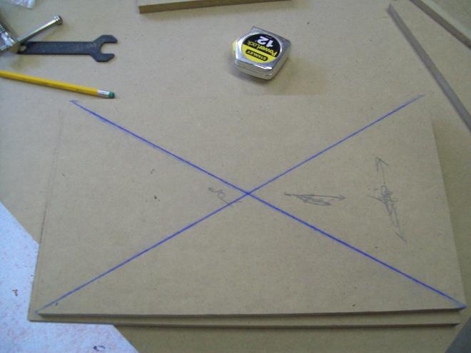

So I cut two more pieces the same size.
I fastened them together with 4 screws. I marked the top piece again with the chalk line.
My chalk line was a little off on one corner, so the center was off. I corrected it.

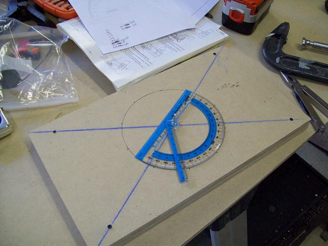

I then fastened my protractor with a small nail right to the center mark.
I marked every 36 degrees from 0 to 180.
I then twisted the protractor around and lined it up with the 0 and 180 marks, then I marked out the remaining 36 degree marks.
I then traced the round part of the protractor, making a circle, which gives me a good drill mark on each 36 degree.
I then removed the protractor

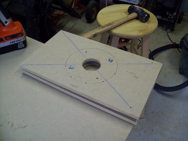

I then laid out the lazy susan bearing on a piece of paper, and marked each mounting hole.
I then lined up each hole with a straight edge and marked the center.
I then punched the nail through the center mark and attached the template I had just made to the center hole of the top board. A little piece of tape helped to hole it still.
I then drilled holes for the lazy susan bearing mounts.
The inside holes went through the bottom board.
I drilled the holes very small, and I circled the ones I will use on the top piece.
I also drilled out the magnet holes.
I then used a hole saw to cut out the very center of both pieces.
I then removed the 4 screws and separated the 2 pieces.
I drilled out the holes in the top piece for T-nuts which will fasten the lazy susan to the the top piece.
Here are the two pieces with the lazy susan bearing installed for test purposes.
And here it is rotated a little more than 90 degrees.
After I was satisfied that the magnet holes still lined up in all positions, I separated the two pieces again.
I cut both pieces 15 1/2" in length. But since the skin will add 1/4" to each side of the top, I needed to cut it down a 1/2"
So I put the top in my table saw and cut 1/4" off each end.
I am kinda worried that the 15" is going to be long enough. It will be very close.
I know it doesnt look like I got a lot done today, but I found that my table saw was cutting about a 1/16" out of square, so I had to adjust the blade. I hadnt done this before so I had to find the manual and figure out how to do it.
The manual says it is factory set and shouldnt need adjusting but it told how just in case.
I found one of the locknuts on the adjusting screws was loose, so I guess thats how it got off.
This took me a good hour.
Come on weather, hold out another week or two!

I got some work ironed out that was nibbling on the base of brain today.
First, I laid a magnet shell and a magnet disk between the two rotating pieces. It is a tight fit, so I will have to countersink them a bit. Wont be able to do that until I install the laminate. (Which, BTW, I ordered yesterday. Lowes says it may be a couple of weeks wait on that.)
Here is a pic of the magnets, shells, and disks. I ordered them from the same place Mountain did. (Rockler).
After a lot of thinking about a stop, I came up with this. Its a piece of aluminum angle. I plan to fasten two blocks on the bottom for this piece to contact and stop rotation.
I found that if I stop so the magnets line up to help hold it, it will be about 17 degrees off 90.
Or I could go 17 degrees past 90. Either way Im not too happy with it.
Whats your opinion? stop before 90?
Or after 90?
I havent decided yet what to use for stops. I thought about a small block.
Here is a long piece laid in just for reference. My dog keeps stealing small pieces of MDF that hit the floor, and I hate to cut this piece yet. I thought about using it in the corners of the box.
Im also having the same problem Mountain had with his lazy susan bearing. It rocks back and forth slightly. I dont have the tool he used to fix his. I tried vice grips, but maybe I just ran out of patience. I decided to move on to the top part and leave this alone a bit.
I cut the MDF 15" long. it turned out to be 15 1/16", which may be better, because Im worried that 15" might not be wide enough.
I marked the center of the board and another mark down from the top 7 17/32".
I drilled my 1/4" pivot hole.
Then I got out the mighty circle cutter (inspired by Mountain's design), and proceeded to cut in circles. (Correction: half circles.):
I then marked it out, using Nvts' drawing (adjusting measurements for my width).
I also changed his marquee base width to match the cut out for the monitor width.

First, I cut out the hole for the monitor, which I had marked last night. I used a jig saw first, then set up rails to guide the router pattern bit to cut right down to the mark.
I didnt take pictures of the setup for each cut, but I basically had to lay out rails to guide the router bit four time.
Here is the finished product:
