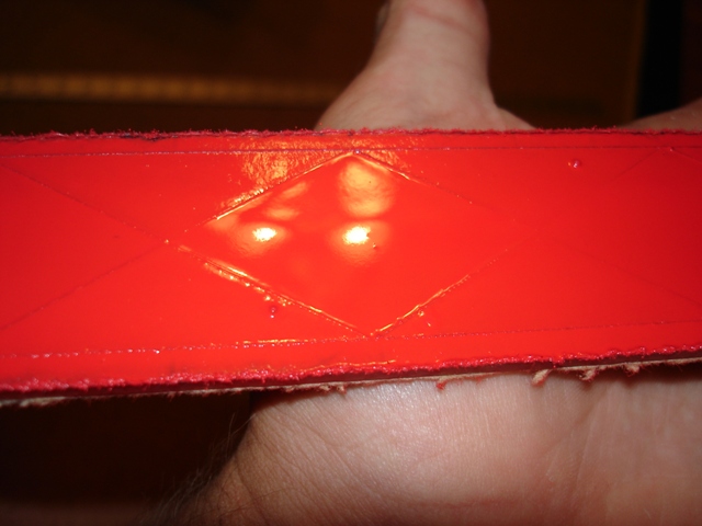

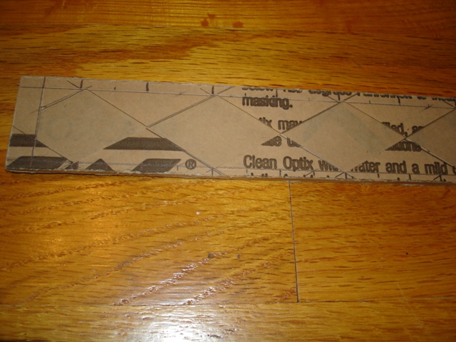

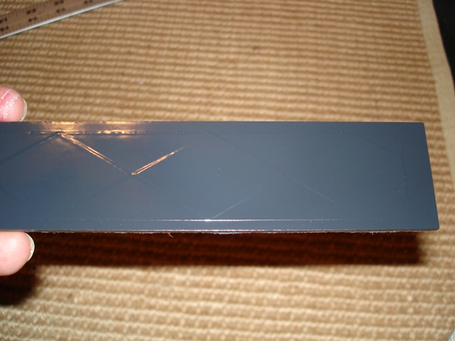

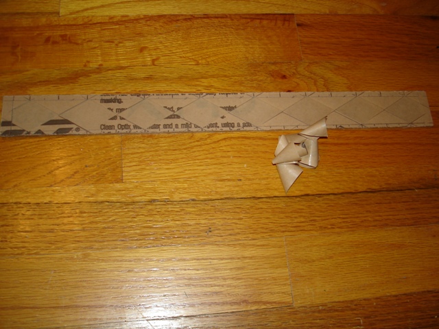

1.  I drew up the borders and the triangles first.  I then used a hobby knife to cut out the red triangles.
2.  Here is the red layer painted from the backside.

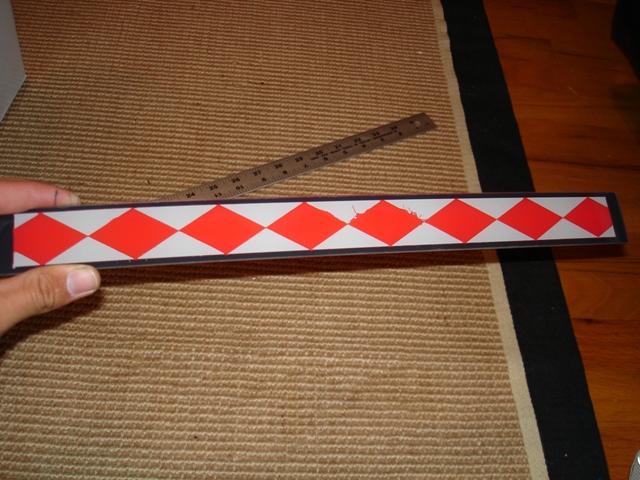

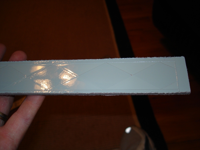

3.  Here is the grey area prepped for paint.

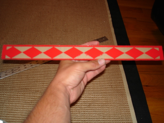

4.  Here is the grey area painted on the back.

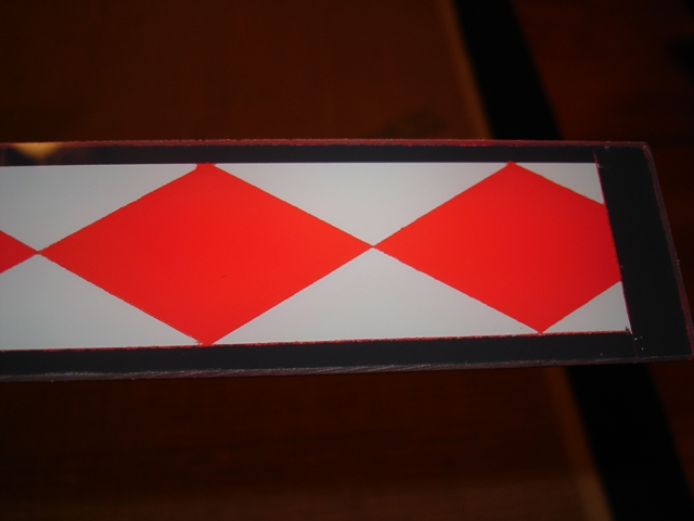

5.  Here is the black layer painted on the back.
6.  Here is the final product.  When I get the rest finished, I'll show the plexi placed on the table.  I think it matches the center felt very well.  Note:  I didn't let the paint set up, so you can see the blemishes of removing the paper before the paint dried.  That error will not be repeated.  I was more worried about the overall project and knew that there would be temporary problems.
