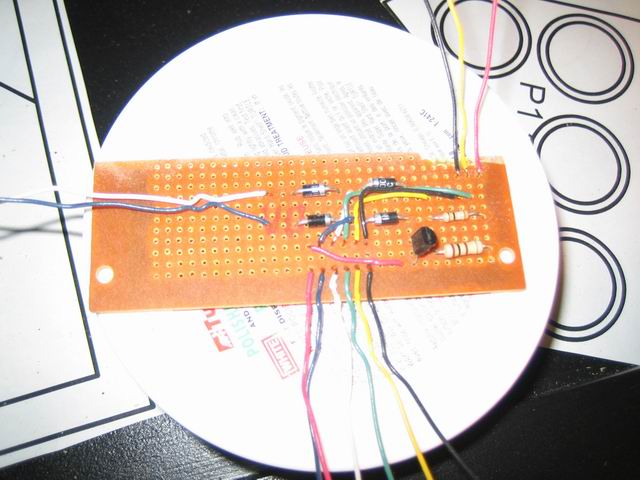

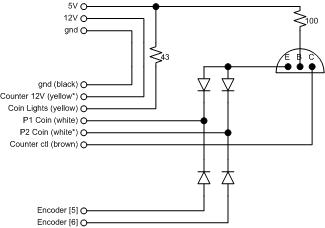

Adding a "computer" switch in the CP
bringing the 5v/12v from the PC power supply to the CP box
Doing the protection circuit to share the same encoder input between a microwsitch 4-way joystick and the P360.

All right, the arcade is playable for tonight party (worked on it all night = no sleep  :dizzy:)
Still a lot of stuff here and there, but the basic is there...
Cheer  :cheers:

Joystick protection circuit
On my CP, I have 2 joystick for Player 1.
- happ Perfect 360 (dedicated 8-way)
- miss pac man reunion (dedicated 4-way)
I want to connect them to the same inputs on the encoder.
Since the P360 is an optical joystick.  It's behavior is not the same as the regular microswitches
the microswitch states are:
- Pressed  : The NO pin is shorted to the COM pin (grounded)
- Released : the NO pin is OPEN
The P360 has some driver instead of switches:
- Active   : The buffer drives 0V
- Inactive : ???
When the P360 is inactive, I'm not sure exactly what the buffer outputs (5V, Open, HiZ (weak 5V))
If the P360's were open collector (Open) type buffer (not sure here if this is the right word), then, shorting the 2 joystick pin together wouldn't be a problem.
If the P360's isn't open collector (5V or Hiz), then activating the 4 way (gnd) vs the unused 8-way would cause contention:
- the P360 tries to drive 5V
- the 4-way short the pin
==>  We end up the P360 driving a non negligible amount of current which will/might eventually "bust the buffer".
So I found some really low voltage diodes (0.2V compare to 0,7V of the std 1N4104) and connected them to protect each one of the 4 P360 outputs...
Did the soldering.  the diodes are surface mount diode.  So I only had a tiny surface to connect them.
And finally, to secure them into place, I used my famous hot gun glue.
Hot Glue is your friend...
