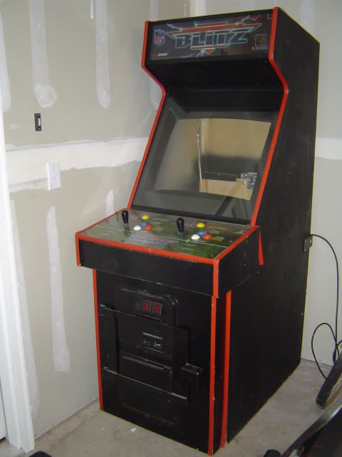

I've already done a little bit, but for the most part I'm still at the beginning of this project. I have an old NFL Blitz cabinet that a local arcade distributor was kind enough to give me and I've pretty much gutted it completely. I'm tossing the control panel and installing one that I've already had cut out by Knievel a while back. Here's the Blitz cab (details on the project will come after the shots):
The marquee still lights up!
I'm planning on a 2-player cabinet that also includes a spinner, trackball, and dedicated 4-way stick. I was going to get an arcade monitor to drop right in where the old one was at, but I think I'm just going to use a PC monitor since it's my first time and i want to simplify things where it's possible to do so.
Later tonight I'll get some pictures up of Knievel's work on the control panel and share some of my artwork that I've been kicking around. I need to get my PC built or bought next, does anybody have any recommendations on specs (I want to run pretty much everything on this beast)? Any help for the PC side of things would be much appreciated.

FYI... I am not positive, but I am pretty sure that that cab is a Mortal Kombat 2 or 3 converted to Blitz. What does this mean for you? Nothing at all, just thought I'd mention it.
BTW, those are definitely my favorite cabs.  :cheers:
Quote from: saint
saint is all powerful.
Apparently he is.
Jeff AMN
  • Posts: 1213
    • Gamer Theory
Re: Blitz cabinet stripdown and MAME makeover
« Reply #8 on: February 16, 2007, 03:18:43 pm »
It most definitely was a Mortal Kombat II cab...the service manual inside confirmed it. Oh, I guess when I peeled off the Blitz side art to find MKII sideart underneath it was a good clue too.  ;) Yeah, it's probably my favorite style of cabinet as well. I do like some of the designs people have come up with here on the board, but if I had to work with a pre-built cab, it would definitely be this one.

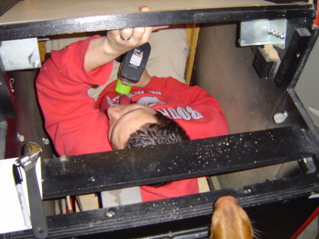

« Reply #15 on: March 01, 2007, 10:33:01 am »
Assembling the CP box:
It all fits!
De-casing the TV. I'm using a 27" Samsung set and going through the component connections.
Priming the CP box...the final finish will be a black semigloss.
Here's the vinyl covering I'm using as my overlay. It looks speckled thanks to dust, but it's actually a smooth and shiny black. It should look nice with my lighted buttons.

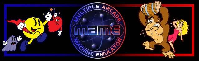

What do you guys think of this as my marquee art? It would be backlit and printed at mamemarquees.com.
Knievel
  • Posts: 965
    • Knievel Kustoms
« Reply #22 on: March 07, 2007, 12:29:57 pm »
Goes well with the button colors. How about adding some red into the Mame logo?
Might be cool to have some old school charcaters on one side(pac-man, donkey, kong, etc) and some newer characters on the other side? But maybe you're all about the fighters.
Are you going to carry that theme onto the cabinet..blue t-mold on the left side red on the right side ? :)

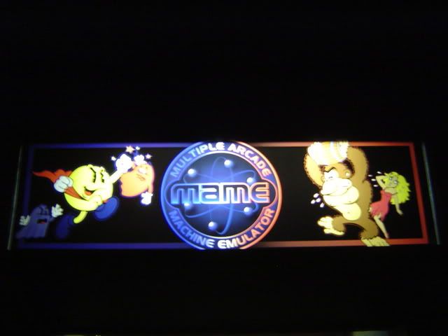

Here's the marquee I ended up liking best. You can't see it in this size, but there is a blue outline around Super Pacman and a red outline around DK. Any opinions?
NiteWalker
  • Posts: 792
  • Routers can do anything.
Re: Blitz cab MAME makeover [Marquee Opinions Needed!]
« Reply #25 on: March 08, 2007, 12:28:36 am »
It's nice, but I liked the metal slug art better.
Maybe the metal slug art and a sort of classic character collage on the other side to even things out (because the metal slug art has the 4 characters and the vehicle.
Whatever you end up going with I'm sure you'll love it.
Knievel
  • Posts: 965
    • Knievel Kustoms
« Reply #26 on: March 08, 2007, 10:23:04 am »
Heh, lucky guess on the t-mold scheme eh? That'll look great.
The logo on the marquee looks good, and I like the classic characters better.
The Kong art works really well with the red, and Pac with the blue. Did you try the Pac art from the original marquee?

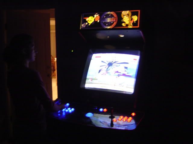

Control panel assembly is underway. Tomorrow I'll start with wiring and LED/resistor soldering. By the end of the weekend I hope to have things finalized with the panel. My computer arrived today as well and I'll need to get everything configured, but I've already figured all of that out on my current desktop.

The marquee! Nothing fancy, but classic and clean.
The photo makes it look washed out, but in person the colors are VERY vibrant.
Workin' on building that rat's nest.

I just need to replace the cabinet t-molding, mount the TV inside the cabinet, and I'm pretty much finished. It's crazy that this project is almost at its end. Thanks to everybody that has helped me so far.
Here's the marquee, the colors get washed by the camera, it looks great in person.

Here I am installing brackets for the monitor shelf. My dog Bowser is helping me with the alignment...
And here's a (fuzzy) shot of my wife playing some Street Fighter II. Just a few more odds and ends and we're ready to call it finished. The screen image washed out in the pic, but it's vibrant and rich in person.
