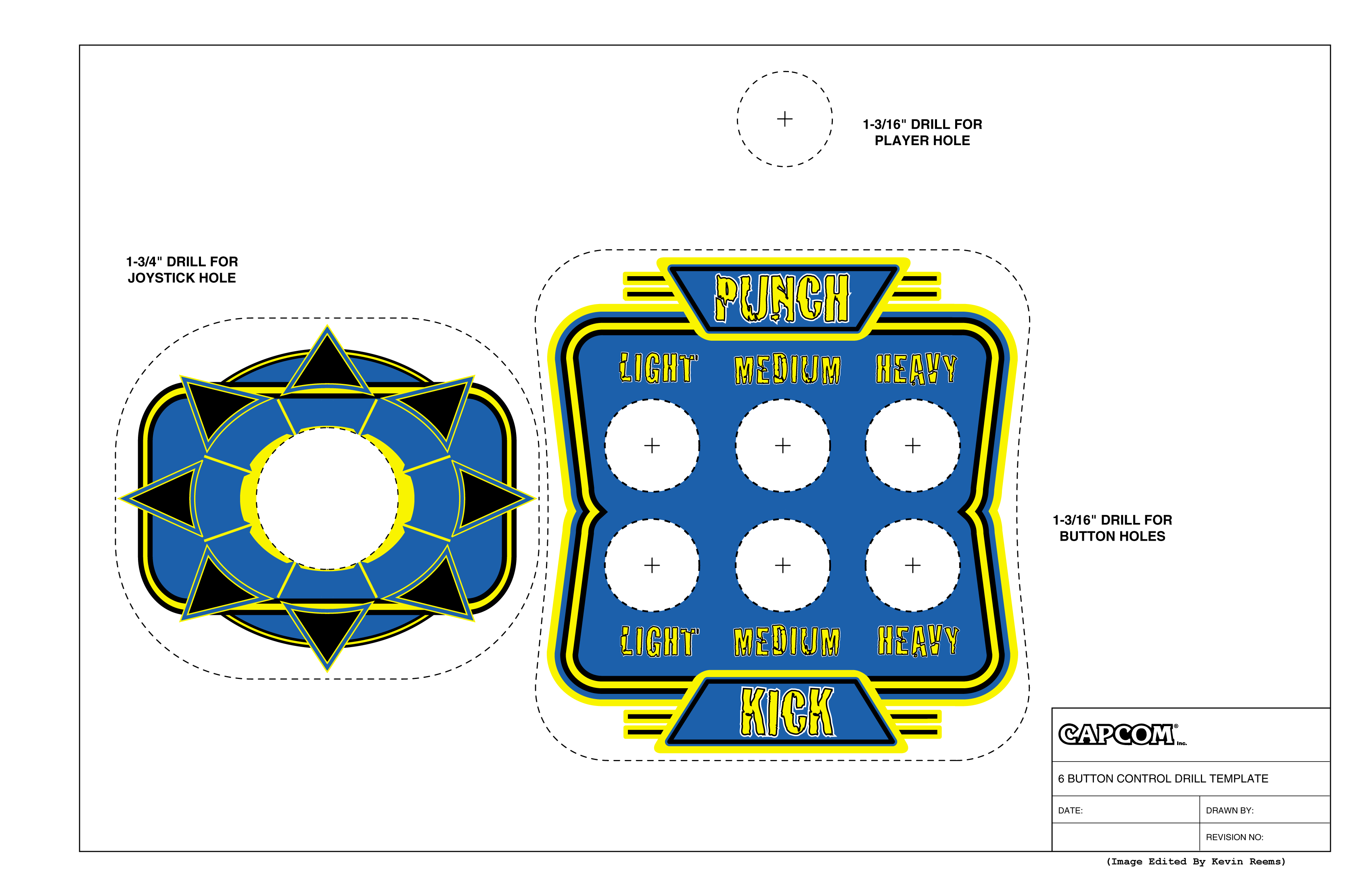

For players 3 & 4, what's the best way to arrange the 4 buttons?  A 2x2 square, or a row of 3 with one underneath, or 4 in a row?  (From what I've seen, the 6 buttons for P's 1 & 2 should be 2 rows of 3.)
Why do I see so many panels that have 7, or even some with 8 buttons, not just for P's 1 & 2 but for all 4 players?  Is that for other emulators or PC games?
Also, I've searched around and can't seem to find one, but does anybody have a graphic, or perhaps PDF file, of the typical 6 or 7 button layout that I could print out and use to mark the panel?

While he was a bit of a jerk about, he also answered the guy's question.  Harsh enough to let him know what he should have done, but nice enough to actually answer the main question.  clhug got the answer he needed, and I bet he'll look a little harder next time.  :)
Now, for the rest of it, it's all personal preference.  The main reason for 7 buttons is to add the NeoGeo style fighter pad (bottom four buttons) to the Capcom style fighter pad (2 x 3).  I don't know many (any?) arcade games that will use all 7.  As for why people do it for all four, I'd assume it's either for consistency or console ROMs.  Personally, it never made much sense to me.
www.arcadecontrols.com/files/Miscellaneous/CapcomTemplate/Capcom_2P-6B_Template.gif is a good layout to start with, if you're into fighters of course.

Thanks for the suggestions folks.  I do appreciate it.  Thanks the pointer to the template escher.
In my own defense, I did search, LOTS, before writing my initial message.  I found lots of messages talking about different layouts and pictures of layouts but not a specific printable overlay.  However, I thought again about the search terms I was using.  I hadn't tried the word "template".  Once I did that then some posts with exactly what I was looking for turned up.
