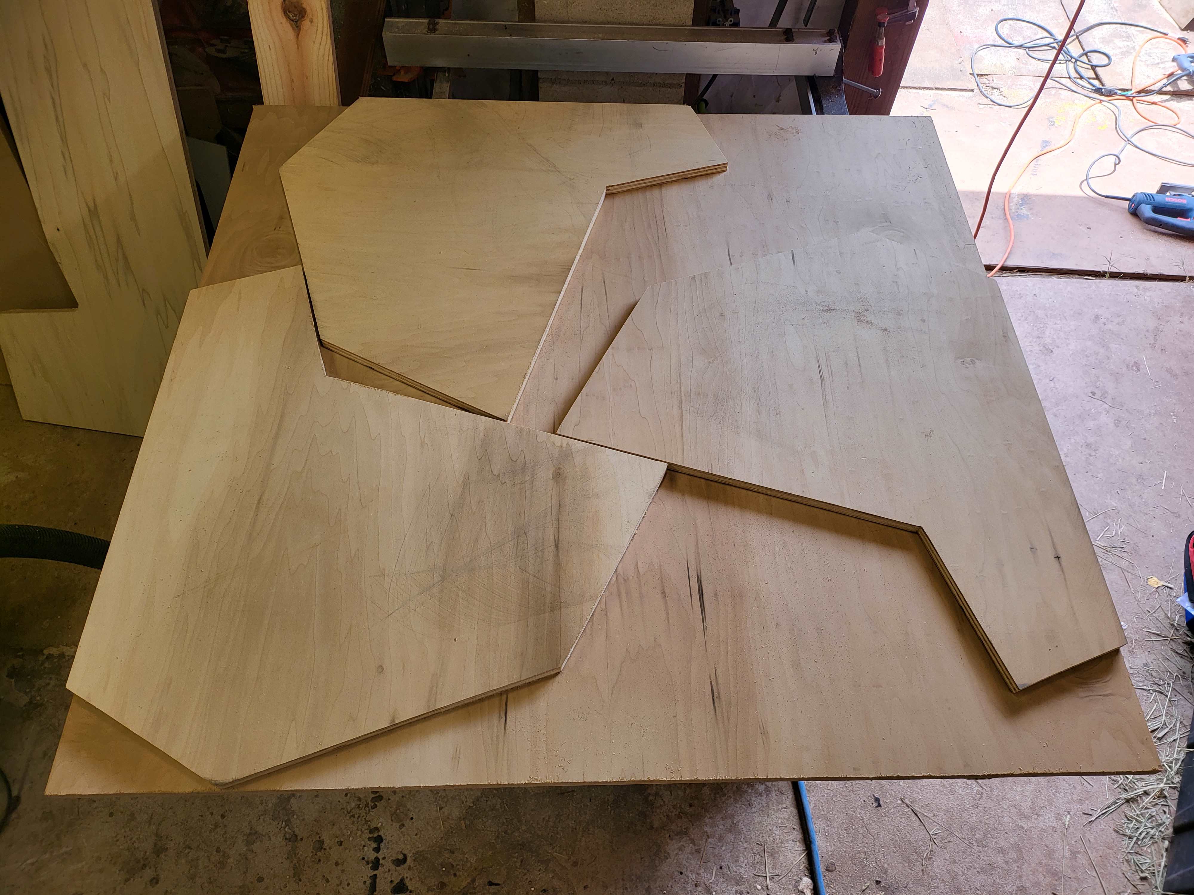

Since I am waiting on things for EVERY other project in the works at the moment I figured what the hell...
I've had this bartop profile in my head for too long now.
I really needed to use up some smaller pieces of plywood that make building something bigger impossible at the moment.
I needed to clear up space in the shop by using up other parts I had on hand.
I needed an excuse to build something for a horizontal something since Aaron had fpga'd some fun stuff that I want to play again on the new BitKit2!
I can't help myself.
The activity is far enough away from the house that the missus usually doesn't notice this ridiculous activity so I don't get in trouble.
First off is how small can I make something that fits a 19" tube.  I've been at it for a few years with the graph paper.
I figured this was realistically the smallest thing you could hope to cram a 19" tube and a JAMMA setup into and I wanted another cabinet with a really geometric vibe.
I have run out of space for full size uprights (until I win the lottery- which I don't/can't play) so I needed to rethink this train wreck of a hobby/obsession as it was anyway.
I HAD actually spent some time on it so that by the time I got around to dropping a monitor on it the whole thing actually appeared feasible and not simply a waste of a piece of plywood.
You can see where I am headed with this round of what the hell already.
I'm convinced the urban legend of the military guy in Hawaii with a dozen environmental DOTs is a fabrication of some bored maniac so I need to do something and I have all these parts now, so...
What is REALLY awful about the whole thing is the girlfriend of a buddy of mine is opening a second location for their rather eclectic vintage everything store and after hanging out at my house for a bit asked for a cabinet to put in there, ostensibly for sale (ha ha- all the girls who work there want something to do at work I think.)
I won't have anything but a legit CRT using thing in my universe and the ladies wanted real retro so it is a wonderful excuse to go down the "how small can I make this freakin thing anyway?!" path.
Giving 18" plus from screen apex to the back of the neckboard (and then considering the neckboard can be 1.5" above tube centerline)- and then leaving a little wiggle room after that, and then making it wide enough to accomodate the bracing to actually hold the tube securely (which I went with 21" inside panel width to not fight with it all) I arrived at this:
And holy crap it fits.
Even have enough room to get the neckboard off without having to remove the tube.
I also wanted enough room to sneak the whole chassis out through the front with the control panel out if need be.
It all works.
If you look you can see that I included a seperate access panel underneath the control panel so that you could pop that off to work on something without needing to pull the entire CP out.
There is also enough room above the screen for a Missile Command style marquee and speaker setup.
Plenty of airflow, room enough for a SMPS, isolation transformer, and monitor chassis on the bottom panel and a JAMMA board on one the interior walls and- Bob's your Uncle.
Of course it all gets worse than that.
If I'm making one for me, and one for the ladies, then why not... three?!
Conveniently, I caught a head cold on our flight back from the East Coast so I had the last two days to finally work on ripping CDs down to FLACs for the jukebox build (oh yes!) and to get going on this project.
I got some decent time on these today and yesterday, so-
Time for some spar varnish sanding sealer!

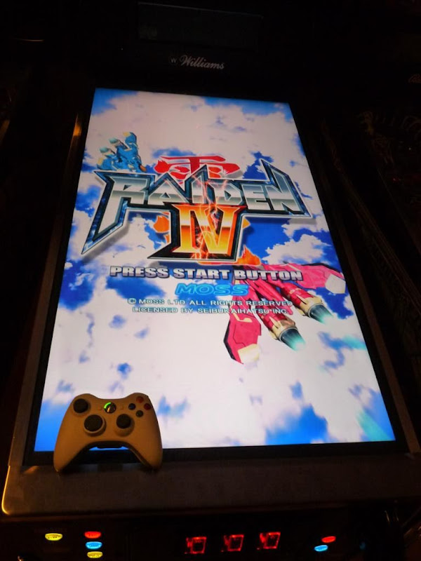

I have been logging small bits of time here and there figuring out my BitKit2 board- with help from Aaron as usual.
That guy rocks.
Of course as a "proof of concept" I need to work on the one of these bartops that I will definitely keep, yeah?!
I have a control panel to play a few of the games Crafty already has built the HDL for and I am putting together another CP to play Wacko and DOT also.
This is going to be awesome.
The details are starting to sort themselves out anyway but I have some glass work to do to be satisfied.
There is still some gameplay weirdness but I can't figure out why as I am using a regular old K7000 so it shouldn't be gagging on displaying MCR games- but it is.
Sorry about the squishy pic.
There is definitely an odd one inch worth of crap on the left side so I need to figure out what I am doing wrong here.
This is of course a Franken-monitor from a consumer tube and real arcade chassis but it produces a really nice image except for when it is running an MCR game presently.
I'll figure it out.
At least at this point I am confident enough that I can keep going.
I just need to decide what board goes in which box at this point.
Pandora Box?
19 in 1?
Shift to a vertical screen with an old 4 in 1?
Glad to have choices-
Any thoughts anybody?

And I sorted out the display on the BitKit2.
Image widened to adjust out that extra bit and getting the screen flip setting correct made all the difference.
Now its pray for a DOT update from Crafty!

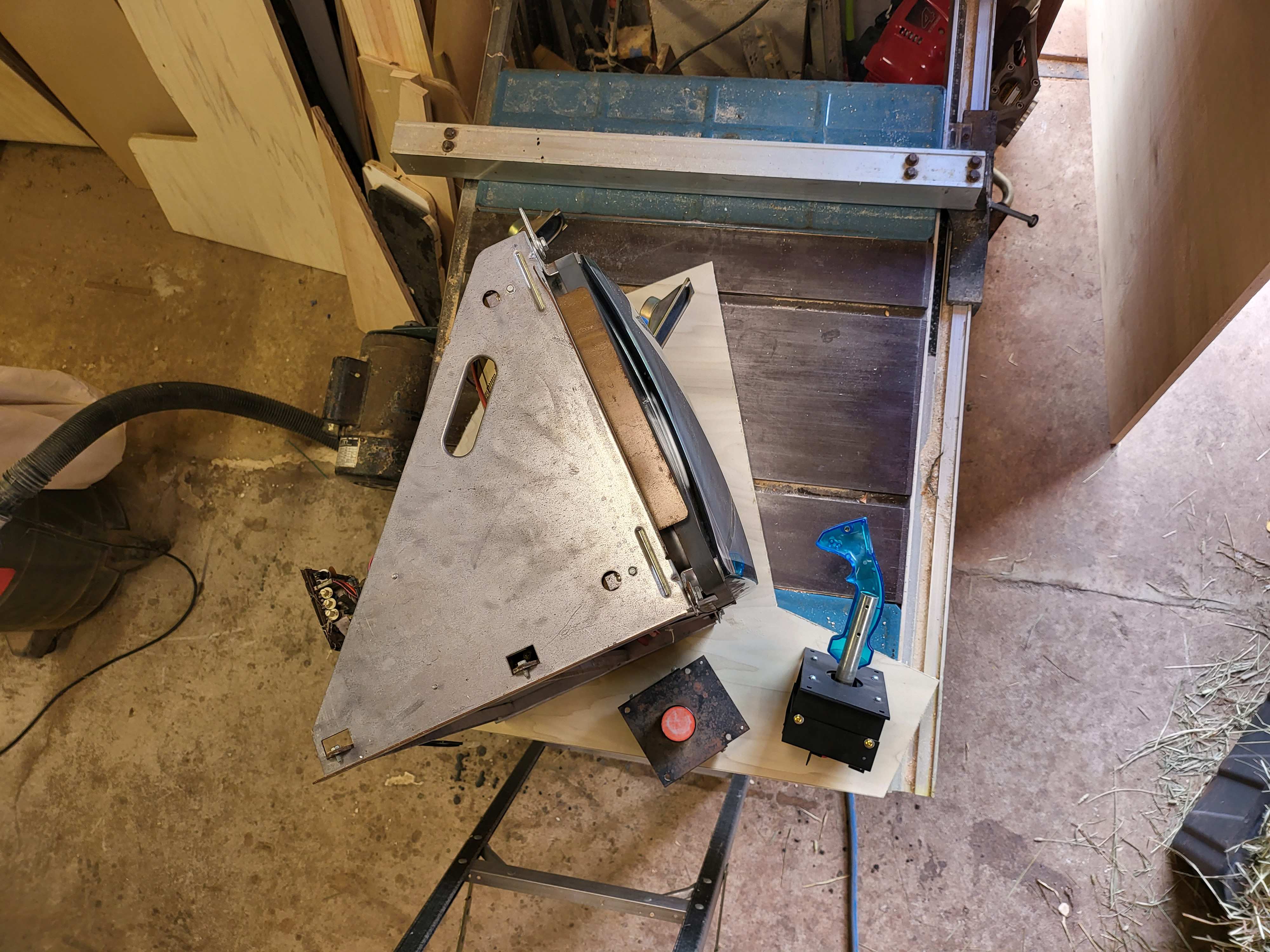

Remembered that I had this 4in1 board (how old must this be?!) and this seemed like a great use for it.
Ms. Pac, Frogger, DK, and Galaga.
Got a few shielded isolation transformers because this is so shoehorned together that I discovered that an unshielded one was making the image do the hula.
Sideart on, T molding in and it starts to look like a reasonable facsimile:
Of course then there is one of the least fun parts of the whole building your own stuff- bezel/surround/whatever you want to hide the inside of the machine with.
I was NOT in the mood to get crazy with this one so I tried to think of what would be easy.
1/4" plywood seemed like a great idea.
And then you try to get a decent start on the parabolic curves of the stupid tube perimeter and figure out that this approach may be as ridiculous as all the other crap you have done so far.
I hope all the 19" tubes are this same stupid shape and I can just trace my pattern in case I get this dumb idea again.
After what seemed like a half hour of shaving and sanding I finally got something that fits well.
Biggest issue with this approach was having to go so damn slowly because once you take the wood off it is gone forever.
But the silly thing fits.
The next thing I hadn't thought at all about is how the hell do I hope to get speakers in here since I turned the tube vertically in a cabinet I designed for a horizontal 19".
Can't go above so must go beside.
Anchoring them was a head scratcher since I didn't want to screw with how nice and clean the smooth surround was going to wind up and then I thought "why not just epoxy some machine screws to the backside of the thing?"
Cut holes for the speakers, try to bullseye where the screws should go, and then get out the glue.
Paint the thing up, put a little screen over the holes so that some punk kid can't stick their finger through the cones, and then bolt them up.
Damn, they fit.
