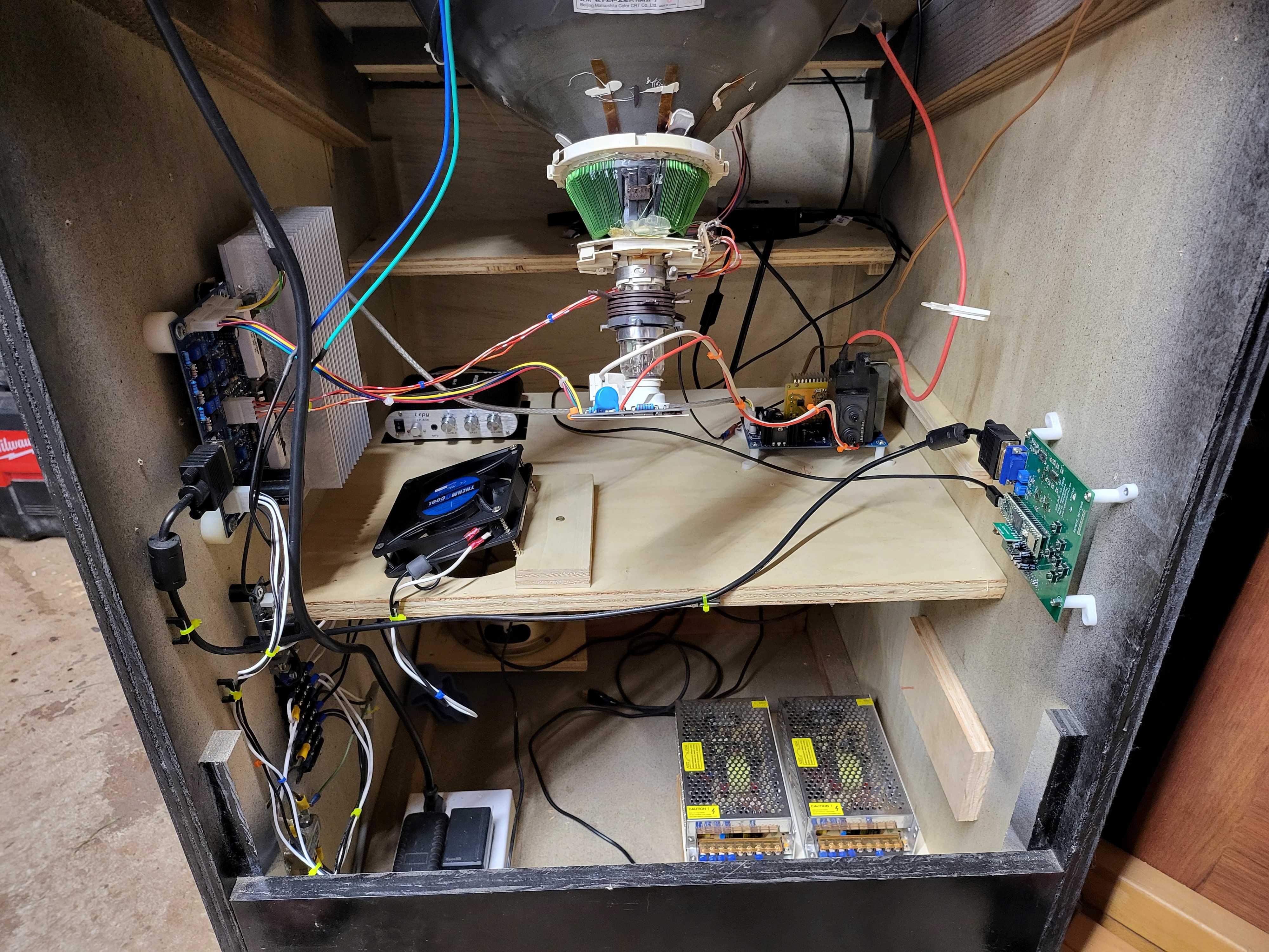

No matter what I may hear from anyone about component heat tolerance I will be putting a fan on this heat sink also.
Only question is should it be mounted directly to it or not and should it be pushing or pulling in relation to air movement across the heatsink.
For an open layout like your setup, I'd go with push for better directionality.
- Pull will draw air from the path of least resistance.  The far side of the heat sink will not get as much air flow.
I'd probably put the fan(s) to the left of the heat sink and slightly above it, blowing parallel with the cooling fins and slightly downward so the air blows through the entire length of the fins.

I was thinking along the same lines but wasn't sure if my thinking was correct.
Only other possibility was is it even better to put the fan in the side of the cabinet and have it draw air from outside to blow across the heatsink.
Thanks as always for your thoughts Scott!

Scott's right, have the fans blow over the heat sinks. I'm thinking you could use multiple fans, maybe two 4" fans? I'd also suggest a large fan (quieter), at a vent near top, to draw hot air out. Put in a vent at the bottom to stimulate airflow throughout the cab.

I had forgotten that the way I built the cabinet there is a huge vent across the front toe kick panel.
If I just drill a hole in the top panel and put a fan sucking out on it that should help immensely.
I might actually shift the deflection board over to the side of the cabinet and put a fan underneath it pushing air through the slots and up.

Fans do not "Suck" anywhere near as good as they "Blow".
 You can test this for yourself.. with a standard box fan.   Place the fan facing away from you... and see if you can tell any difference.
Then point it towards you.
 The thing about "Air" is that it behaves like a Fluid... and Fluids flow and swirl, in very chaotic directions.
 All PC Servers, use Forced Air, to blow through them...  as do standard CPU coolers.  Anyone that has tried to reverse
their CPU cooler fan to "Suck" the heat away... has typically ended up having their CPU permanently Fried.
(or severely heat "Throttled".. until it completely overheats and auto-shuts off)
 Most Arcade Cabinets have top vents for rising hot air to escape.  And many even have Fans that are mounted towards the top of
the cab, that push out of the top-rear of the cabinet.
 Additionally, some cabinets have Inlet fans at the bottom... to pull cooler air into the cab.. with the top fans blowing hot air out
of the cabinet.
* Actually, the fans at the bottom, are probably more to cool the Power Supply / Transformer units, that typically sit down there.
 I highly recommend using a good cooling fan, blowing directly across your heat-sinks.  The cooling will be Far more effective, and
will greatly extend the lifespan of the electronic components.

Yeah, I'm not in the mood to build a manifold for a fan to draw through for the "suck" concept to be functional.  I have space to arrange well for the "blow"air flow plan.
I'm going to not fight physics so I'll mount the deflection board on its side so that the fan will be blowing up through the cooling fins- and then have a fan on the top panel drawing air out of the cabinet.
There is a 2" deep slot that is the width of the cabinet in front so there will be plenty of air flow available.

« Reply #58 on: March 28, 2023, 08:22:15 pm »
Trying again.
Had a chance to get back to the machine and turn it on after rearranging things finally.
I pulled most of the parts out first to have a good uncluttered think on it.
The result is...
Wound up leaving the power supplies, DVG, and the Pi in the same places and swapped the HV unit and deflection board positions.
Makes for a better cooling layout, keeps those parts as far away from each other and the tube as possible and the parts still remain on the shelf I made for the stuff.
It also allowed me to turn the deflection board on its side and possibly gain a little in velocity as regards the heat being evacuated through the cooling fins.
The 120VAC fan I got is kind of noisy (and may get replaced if it is distracting once I have the bezel area built and in) but it certainly does what I wanted it to.
I drilled a hole in the shelf to allow the fan to draw from wherever it likes and gave it a good angle to shoot into but still across the heatsink.
The other bonus is I got to add a block of ply underneath the heatsink to carry the weight of it on its own.
Prior to component rearrangement and install of the fan I was seeing 185 F on the heat sink next to one of the transistors.
In that same spot the temp is now down to 95 F.
I expected a good drop in temp, but wasn't expecting one that dramatic.
Certainly worth the effort!
I'm stoked.

Once I had the cheap little 2.1 channel amp I got in place and fired it up the fan noise nearly disappeared from a player's perspective.
By the time I get the bezel shroud done the noise will be a non-issue.
Which is good, because there are enough issues yet still as it is!
I actually had to shift layout here AGAIN because once I finally got to play the silly thing with everything powered up in place it was alarming to see how much vibration in the screen image the fan was producing somehow.
I thought it might be a power supply ripple type of issue and powered the fan from outside the cabinet, tried with an isolation transformer too and still had major image shake.
That freakin 120VAC fan is generating quite the emf to get spinning apparently.
Maybe next time it is worth getting a 12VDC supply and fan and maybe there won't be a 2000mg of caffeine kind of jitter to the image with the fan closer to the tube.
I dropped the shelf and deflection board down a few inches- which of course necessitated dropping the power supply shelf to the floor, which also made it necessary to shift that two gang junction box over alao.
And move the degauss board.
 :banghead:
At least the effort netted the desired result.

I was afraid to connect anything else to the power suppllies feeding the deflection board or I would have gone exactly that route with a 24VDC fan!
Been terrified to blow something up here all along really.
And it isn't even so much the $$ but the fact that these kits are still kind of in the unobtanium kind of realm still currently.
I waited over a year for a USB-DVG unit (even after I had paid for it) and I have been on the wait list for an Amplifone repro kit for longer than that at this point.
Not to fault any of the crew involved in making these things mind you, they all have busy (and sometimes rather complicated it appears?!) lives of their own to lead, but when you are obsessed with this stuff like I am it is unnerving to wait so long- and to sometimes think it is never going to happen anyway.
I had experimented with the fan positioning and orientation before I decided on the current layout.
Literally just waved it around in the cabinet with it plugged in and running to see how it affected the image on the monitor.
Even tried to Faraday cage the stupid thing in its original spot to no avail.
I found how close I could get it to the tube without any drama with the hot and floating technique and then mounted it another inch further away than that even.
And so we have composition #3.
Hopefully the only thing that moves from here is the audio amp, so it can be played with through the eventual coin door.

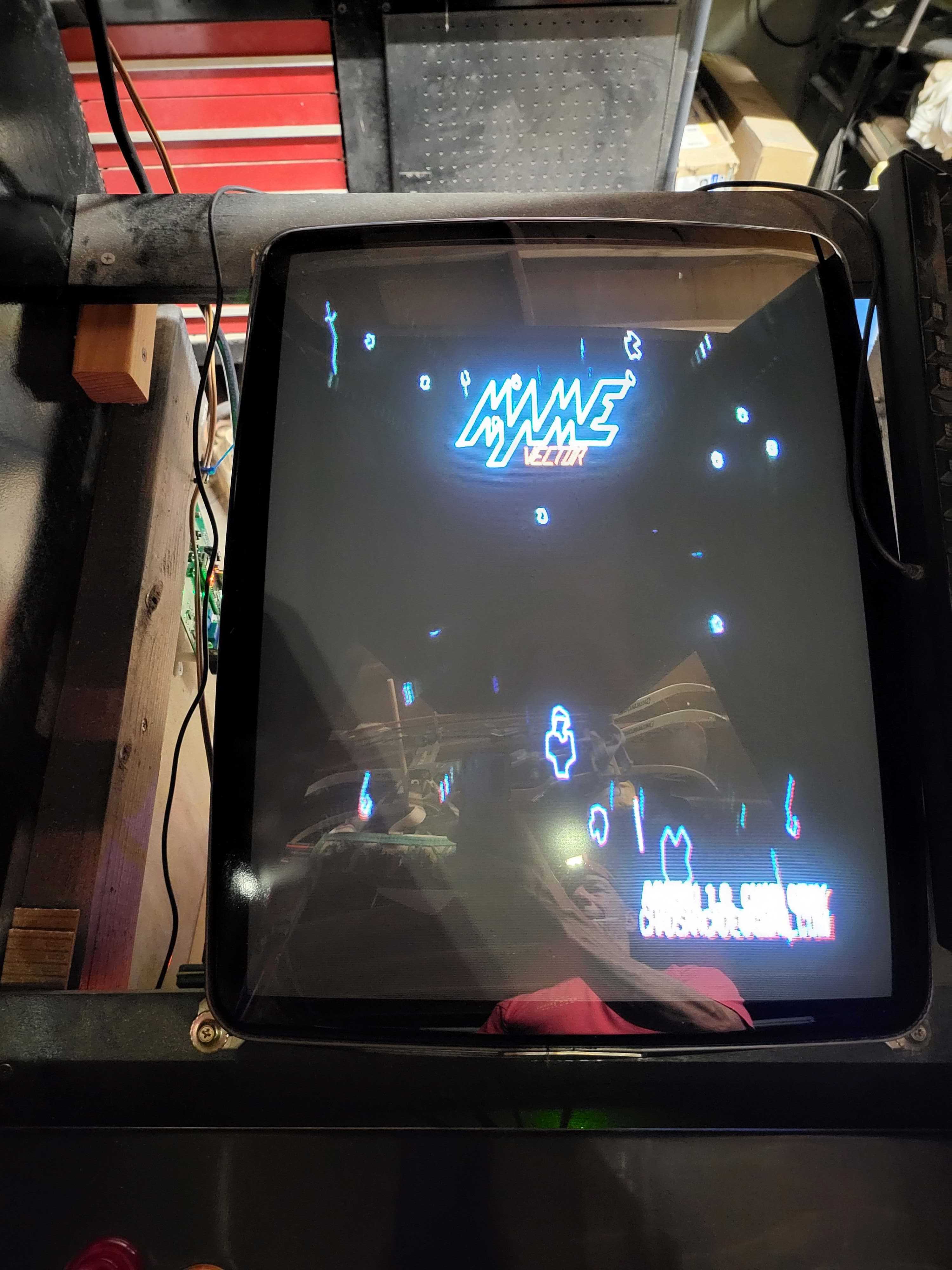

With the thousand bpm shake managed it was time to address the broken vector weirdness which randomly appeared once I had nearly everything else sorted out.
Full disclosure:
I have tried three different rewound yokes on this thing so far.
They have very similar values in terms of resistance but produce different quality images for sure.
One was the original to the tube.
Sadly I pulled a bunch of correction strips off of it before I realized that maybe they should stay and I have had major convergence issues with that one since.
Maybe some day I can get it back to good, but dialing in a yoke is pretty heady stuff that I still know almost nothing about yet.
Many of the numerous documents I have found on purity and convergence tuning speak as if it is a very scientific and systematic process that is not difficult.
Ha-
Of all the esoteric themes in this hobby yoke gymnastics are easily the most arcane.
Another fellow CRT maniac here (who is far beyond me in knowledge and skill) has a bucket of old yokes from tubes he has scavenged and last I was at his house we dug through it with an inductance meter and found a few with promising values- so I rewound one of those.
The mounting collar is kinda beat up so it is hard to get the thing to stay seated really well but I tried it anyway.
It too produces a fairly un-converged image.
The kit that I bought second hand from a gent in Canada (although I don't believe it was used- maybe not even tested out) came with a rewound yoke- and that is what is currently (haha) on the tube.
The convergence still gets a bit wonky as you get to the outer perimeter of the screen, but during game play there is really no discernable issue thankfully.
And so even as good as I could get this last yoke to look there was still some weird stuff going on with the image on screen.
Such as....
What was really weird to me at first about these bizarre tails to some of the images is that they don't all head in the same direction or have any consistency to them at all really, but after I thought about it this makes sense.
The image is being drawn by the guns which are aimed at the center of the screen and then the beam is deflected to the proper position and then lit up when it is in the right spot, but it is not as if the beams need to draw one image, go back to center, and then get bent around again to draw the next.
If you crank up the screen adjustment on the HV unit (lower dial on the 'flyback transformer'- which it isn't in this case- even if it looks like one to you) you can actually see the path of the beams as they are flying around the screen- and then these weird tails on images make sense.
It is a pretty impressive sight really.
What I was looking at is the beam getting lit up ('Z' axis voltage in Atari-speak) before it actually got to the location it was supposed to be drawing something.
So the deflection board is (very!) slightly slower in bending the beam than it is in lighting it up- and hence the timing being off just that little bit makes for a line where you don't want one.
Enter Slew Rate.

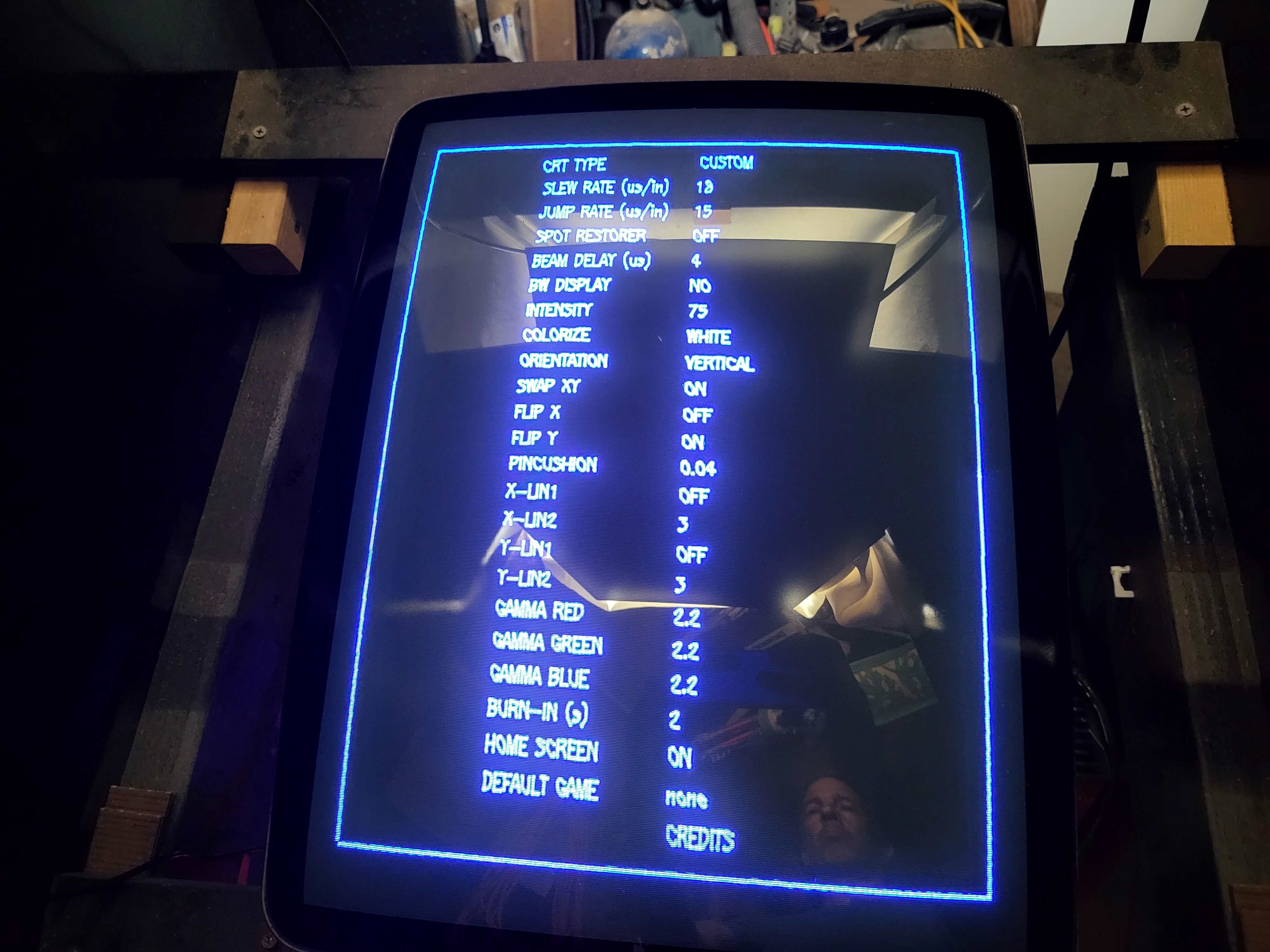

The USB-DVG has a menu all on its own, accessed by a button on the board itself.
The first thing you see when you access it is this.
As my world expands here I am starting to figure out what all this crap is now.
The first line is an obvious one, as it lists all of the original vector monitors here (G-08, WG6100, Amplifone, etc...) and selecting one automatically loads the settings below for what works best with a healthy original monitor.
I selected the Amplifone one for this to begin with since that is what Barry cloned here with this kit but this is where the nuances of this hole thing begin to get tricky.
Note that I said that those default settings are for a "healthy original monitor."
My boards and tube are fine BUT, this is NOT an original yoke- and this is where it starts getting sticky and this is all finally making sense to me now.
My rewound yoke does not act EXACTLY like an original Amplifone one because the outer yoke coils, although having been rewound to get close, are still a slightly different inductance/resistance than original (so are the inner ones for that matter) and therefore they DO NOT deflect at exactly the same rate as original ones do.
Cranking up the Slew Rate allows the beam to get knocked around faster (it allows a faster rate of voltage change to the deflection to more precise) and therefore get to where it is supposed to be in time for the 'Z' axis to get lit up at the right time and draw the images properly.
Neat, yeah?!
Even just a few ticks of bumping up the rates yielded great results.
Behold!
I'm still trying to figure out exactly how the "Jump Rate" and "Beam Delay" settings affect what I am seeing.
Anyone who knows more about electronics here please chime in!

Looks fine to me, vector games were always slightly screwy looking.  Stop being picky and move along.

You are absolutely right of course pbj, but it is fun to see how all this crap works and figure out how to get it to look really good.
There is still some pulsing in the menus and other weird stuff that I will probably never sort out.
What is excellent is that none of the stuff that was really distracting (like the cute little pigtails) ever seem to occur when the games are running.
The more I learn about it the more amazed I am that somebody could figure this ---steaming pile of meadow muffin--- out to begin with.
And then the speed at which all this stuff occurs will forever blow my mind.
I'm stoked really.
This thing plays Cosmic Chasm, Tempest, and Tac/Scan well and it looks awesome.
What is nice about this really is that the next vector machine will be considerably less of a pain in the ass!

I quite liked how the settings screen looked, before you adjusted the slew rate. That font be crazy man!
Thanks for the pic showing the beam paths - a penny just dropped, somewhere in my brain. Now I know exactly why they are called "vector" monitors.

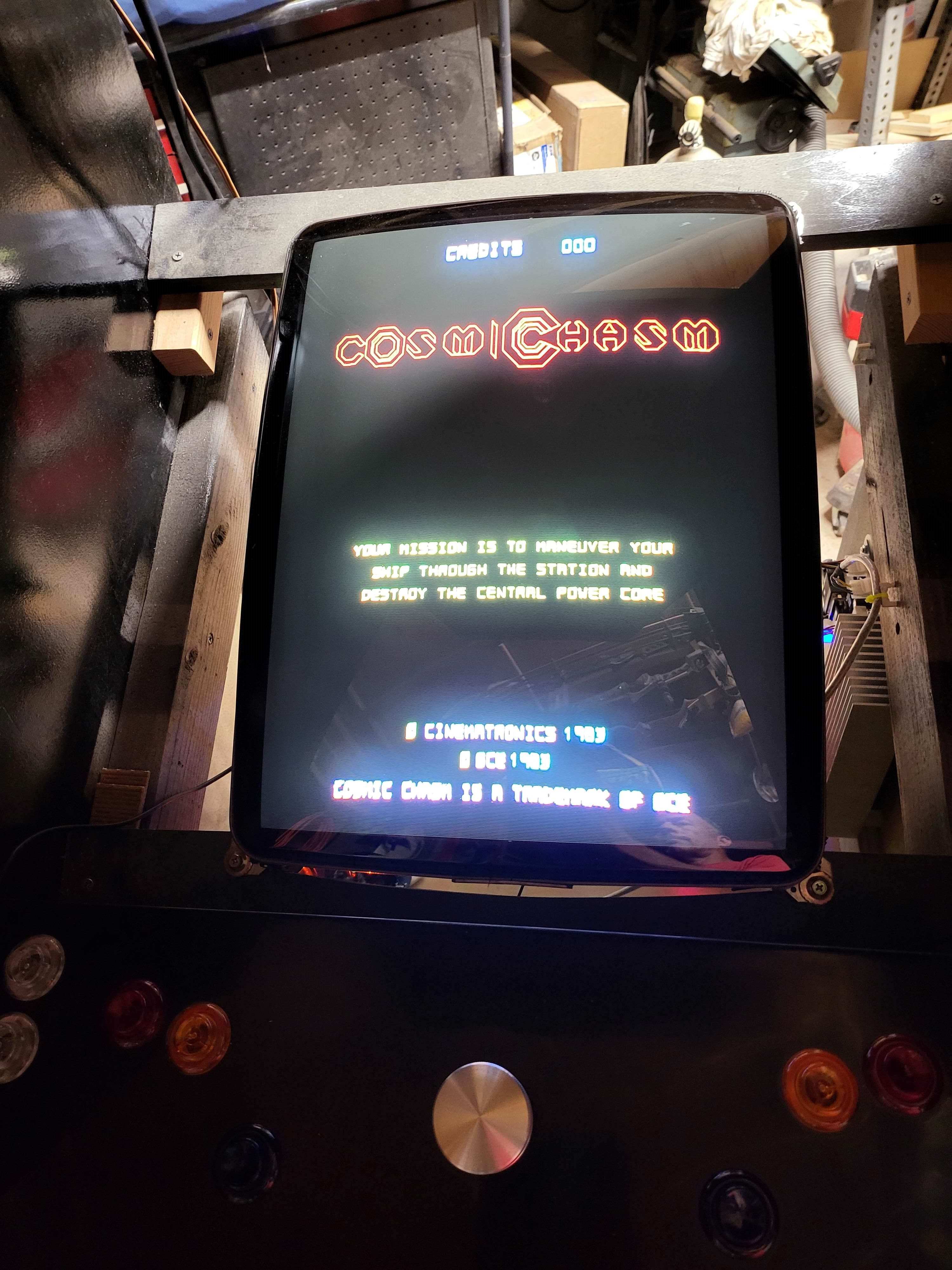

Encouraged to see that even with the cabinet rearragnement to accomodate the fan's crazy emf I still have great heat sink temps.
Even with that massive block of aluminum I think the fan is a must to not have to worry about roasting components on the deflection board over time.
So after I moved everything else around to accomodate the audio (I built a little box for the woofer I had for it- just for fun) and moved the shelf I accidentally put in my own way for getting the kick panel off I think I have finally arrived at the final cut.
Time to add a little screen to the bottom vent slot and then pop a hole somwhere in the top (or maybe the backside transom panel?) to finalize the cooling flow route.
At this point it is really fun to play and produces an image that is damn sharp and has no issues during gameplay at least.
Winning!
