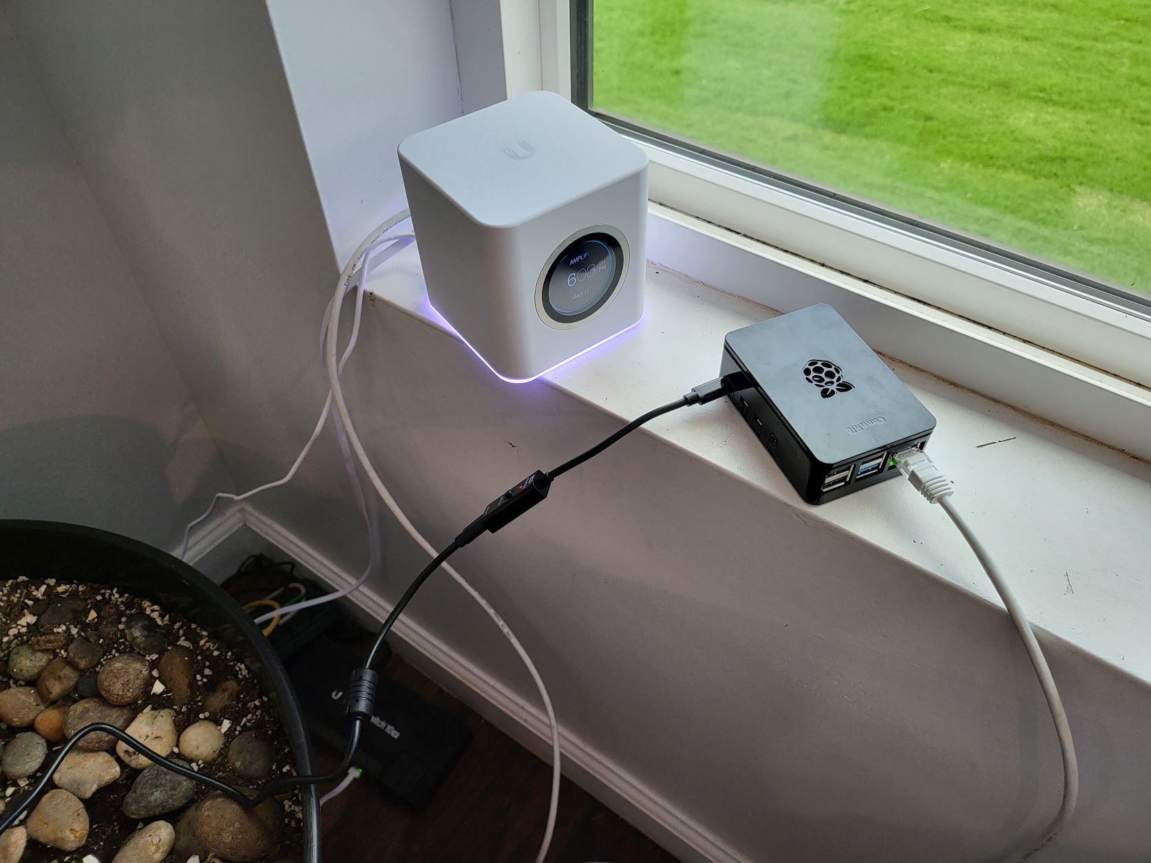

After you have stuck your now properly imaged SD card into your Pi, plug the Pi into an available ethernet port on your router and power the Pi up.
Give it a minute to understand that it is alive before you try to log into it through Windows.
It takes a few minutes for it to boot up and for the rest of your network to recognize it is there.
If you open an Explorer window on the PC you should be able to type this in and actually get somewhere.
It will take time even if it is working properly so be patient.
If your PC can't find it then it will say so and you have a network issue to address that I probably can't help you with.

I dragged the Pi back down here anyway, as I know that I can add a line to the vmmenu.cfg file (for some reason it isn't an '.rc' file in this particular instance) and force the Pi to realize it is there.
If I knew more about how Linux works this wouldn't be so confusing and cryptic- sorry- but at least we know what I am doing works.
I may go try it again before I go to sleep because I can't help myself.
No, of course I will try it again before I go to sleep.
