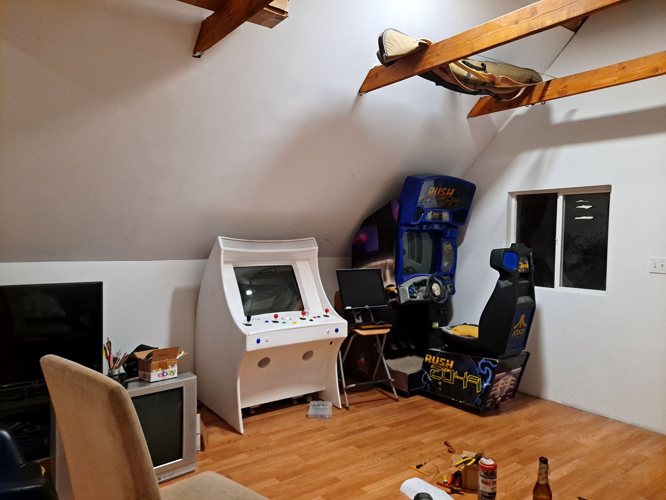

Had a few minutes after dinner to try to do something and got all motivated.
Mounted some usb plugs under the control panel for console controllers to use with the MiSTer.
Then it occurred to me that I hadn't actually seen how the monitor and bezel were going to fit together actually inside the cabinet at the same time, so I couldn't help but try to stuff the monitor in there and...
It's alive!!!
Need to get better signal cables for the amp since it buzzes like mad.
Now if I don't get some controls in that panel this week and get some software in the PC sorted it will make me nutty.
A few more details to figure out but I think it will actually work.
 :o

I know there's a long way to go, but looks awesome already.
Re: New cabinet build named... 'ehukai !
« Reply #166 on: April 13, 2021, 09:34:34 am »
That looks fantastic.  Like something made in a factory.   :cheers:

Looks great - hard to believe it's made out of plywood.  You are getting so close to finishing!  Couple more of those Mai Tais should do the trick.

Thanks Zebidee. And you are correct about a long way yet.
Some light leakage issues and the back panel are all that's left for the box itself I think.
I think I'll have more fun with what is left.
I'm stoked to have a good platform to learn more about the software side of all this too.
It is good enough for me, but given the company in these parts I think it only merits a B- actually.
I aspire to the fit and finish produced by many here!
My next one will be better.
I have discovered through this build that a mix of good plywood and mdf is the way to go in future builds.
There are places where it is silly not to take advantage of the different properties of the materials and had I used mdf in spots with this one it would have saved a LOT of time and frustration!

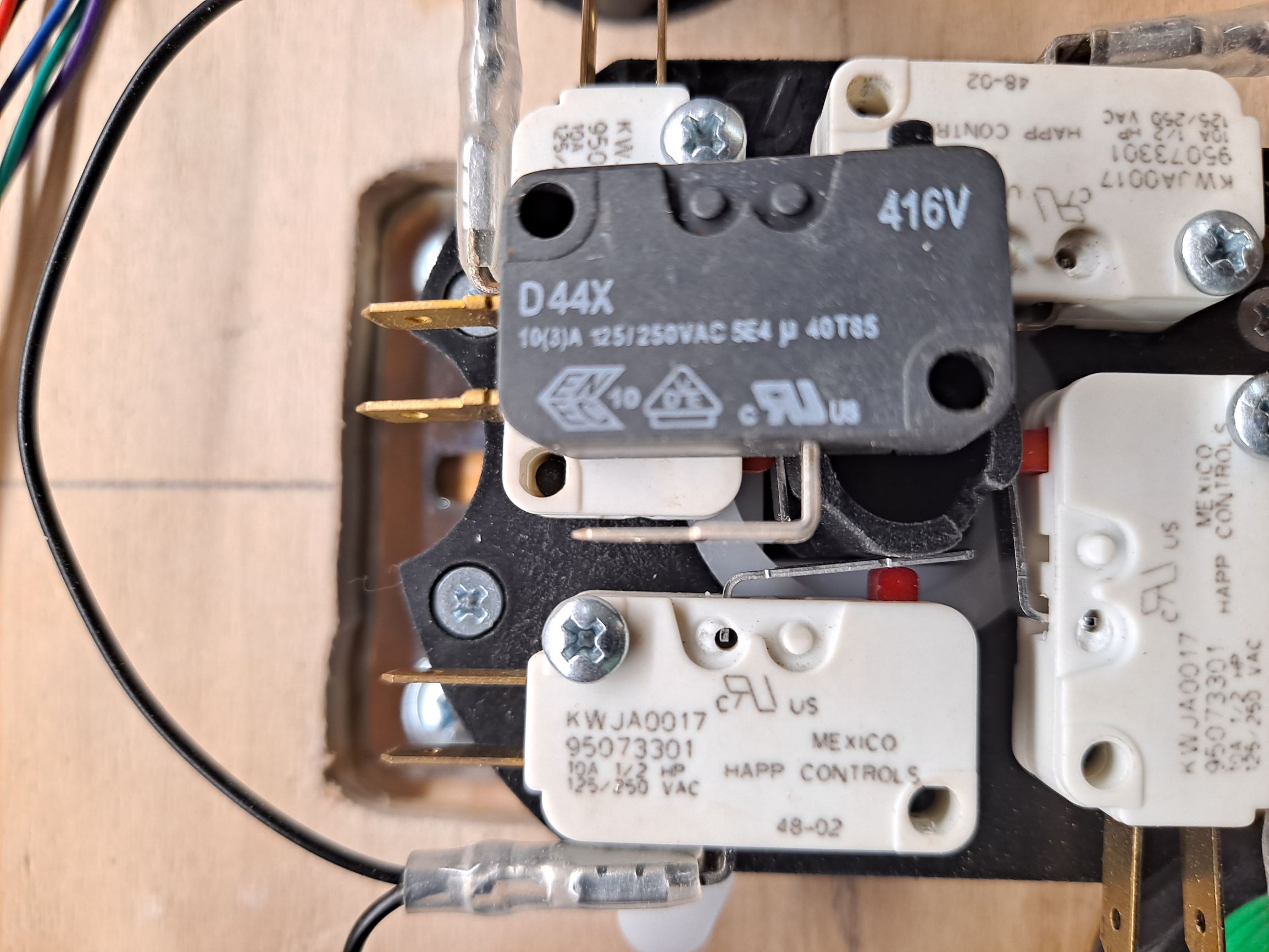

Now onto what I like, control panel fun.
Had to run the router to sink the sticks deep enough to feel proper.  Love my Milwaukee stuff.
This portable vac unit that plugs right into the router makes for a zero dust routing setup.
Now I know that most everyone has strong opinions on joysticks and I am still learning what mine are at this point, but for this machine I wanted to have 4 to 8 way switchable sticks.
I am first trying Mag-Stik Plus units.
I had swapped a pair into the cocktail-ish cabinet I made first and I am MOSTLY satisfied with them, except that the Sanwa switches in them have a pretty high actuation pressure (not sure exactly what it is- but it is the heaviest of all I have encountered) and they have a VERY snappy engagement and are REALLY loud too.
I anticipate that it may be that these switches are intended to counteract the effect of the pressure of the magnetic centering and so switches with other characteristics may be a failure-, BUT...
Can't help myself.  With my tinker til it hurts mantra, I still need to try other ones to see if I might like something else more.
So I figured why not try a bunch all at once, and this particular panel seemed like a great test bed.
Once all set up, I will just map controls in a few games so that any stick on the panel could be used and just go back and forth in game to compare characteristics and see what I like best.
Seems like Pac-Man and DK would be the seminal choice for testing 4 way function but apart from Xevious I am having issues coming up with something I am familiar with that would be a good litmus test for 8 way function.
Thoughts anyone?  I will try anything my machine runs at 100% speed really.
And so...
One stick with original Sanwa switches, another with some Cherry ones that I had to swap levers into (I'll have to look at exactly which model,) Zippy ones that came from RandyT in his MicroLeaf switches and some other ones that I got from a local supply house that I will need to get details on also I suppose.
I have a little soldering to do but my back is killing me and I can't do much else at the moment anyway.

FINALLY got 'ehukai reassembled after relocation upstairs and got to work on making it actually functional.
Not much progress though really- still fighting with Windows to get what I want out of this thing.
The first box I put in it, the audio was so chattery and scattered that it was stupid.  Couldn't figure out what was wrong except probably that the processor isn't up to the task.
CoreDuo in an old Dell, I think 2.6ghz if I remember properly, but I still only have a 0.197 set which I didn't think was really that demanding for audio- but I'm not that savvy.
I can't update any of that currently as it's been 2.5 years of a third world internet connection for me at the new place- and I'm over it.
The .106 set I am pulling for the vector project has been almost 17 days and is not quite 90% right now!
Maybe in a month or so we will get a reasonable speed connection radioed up from where there is a fiber line a few LOS miles from here and I can get back in the Q-bit community again.
Anyway, the second PC I stuffed in there seems to be behaving better but we'll see how I can manage with controller IDs.
I know it has been asked many times and explained but the code to sort that out makes my hair hurt just looking at it.
Maybe Dr. Venture's fix is the way?!
Once I get stability for that crap sorted then I can pray to get a clean CRTemu and groovymame load and life will be grand!
And I thought a picture of it sitting in the intended spot might explain part of the ridiculous form factor decisions.
I DID however sort out which of the switch setups I preferred for the Mag-Stik Plus units.  Took about 25 seconds of Ms. Pac-Man to decide, an opinion further cemented with a few minutes of Xevious.
Given the 4 choices of:
-The original Sanwa switches
-The Micro Leaf with Zippy micro switches
-Some other unbranded micro size ones that look like the old volcano button switches
-The old white Cherry switches that Happ used to put in their buttons
Survey says...
The old Cherry ones.
They are the only set of the four which for me (in this application at least) combine the elements of:
-Nice smooth engagement sensation (not a ton of 'snap' on and off)
-Good middle of the road engagement pressure (maybe 50g or so?)
-Not absolutely silent, but NOT really loud
-Didn't seem to false (or fail to!) trigger
-Allow the stick to return to center at a nice rate and don't false trigger by going past center
Not sure what other criteria one might consider, but these traits where what seemed to me to be what was most desirable and how to describe them.
Those Cherry ones are some 40 series one it appears.  I read that Happ opted for a different vendor years back and I have had trouble finding exactly what currently available switch to substitute.
At least I have enough of these switches scavenged off some buttons that I think I can populate the whole panel with them now while I wait to find a new replacement for future purposes.
And although they are far too light an actuation for me here as a joystick switch (wanted to try them anyway just in case...) I can say however that those Zippy Micro Leaf switches from Randy T are very nice as button switches.  The mounting plate to make them work is quite cool and as a button switch they really do feel like an old leaf- to me anyway.
