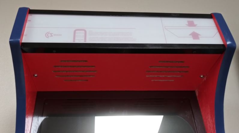

I routed out the speaker holes Nintendo style. I used an up spiral bit from Home Depot and a board with a slot in it for the bit to go into. I lined it up and clamped a yard stick for a straight line and tried to block off each side for stops so I wouldn't go too far. It worked on both sides on the smaller ones but not the bigger ones so I had to try and eye those up. I think it got better as I went along.
It turned out pretty good. I did wobble a tiny bit but that is only really noticeable up close.
They seem fairly even. Close enough to look decent. I think I could do a little better if I did it again but I don't know if I will. I just wanted to try it out.
It was at least something. It has been quite a while since I could do anything in the garage. Feels good to be out there again. I can't wait to do more.

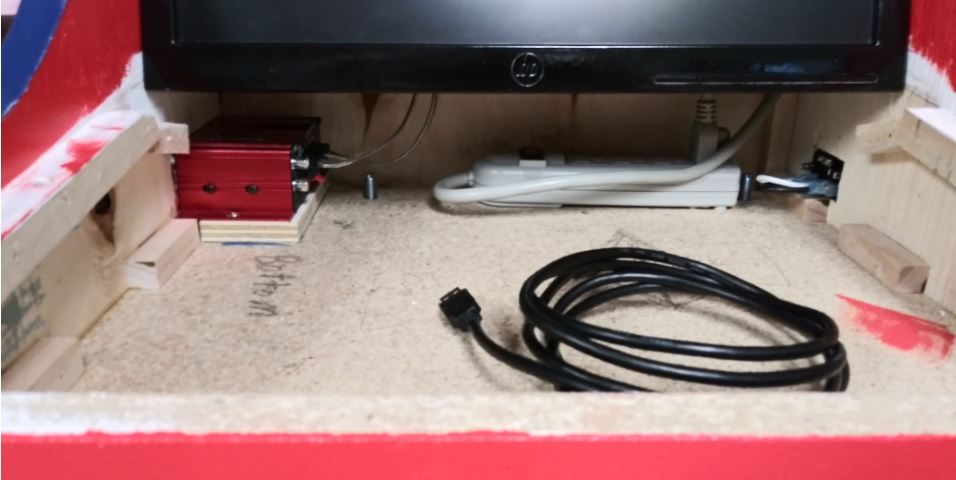

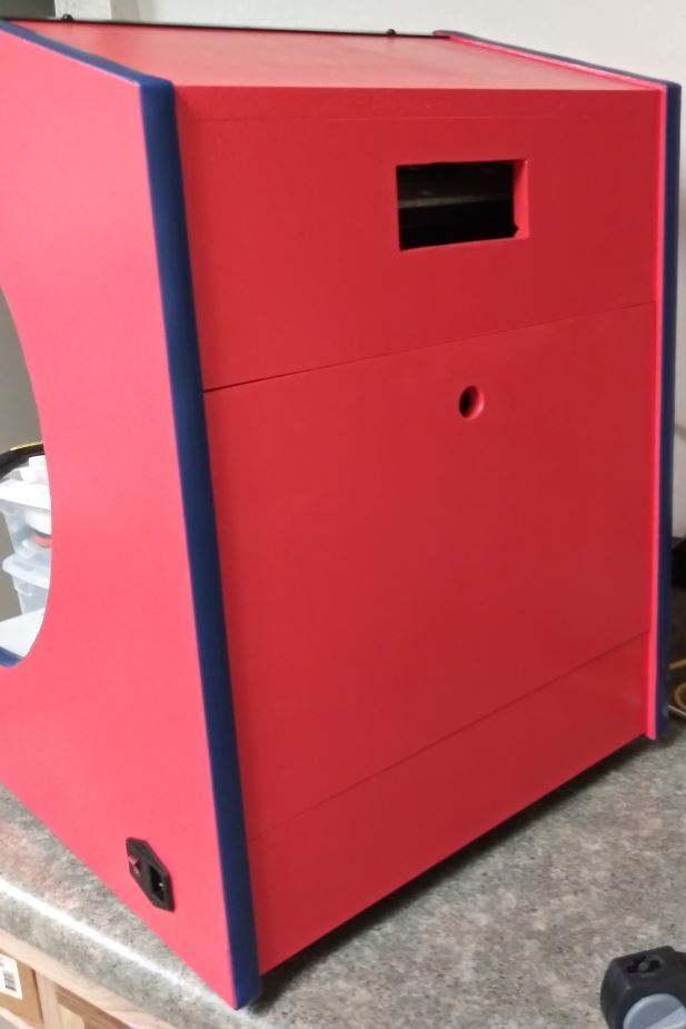

I little more progress on this. I added a back door with some magnets. I did not do a great job on it as the whole thing is slightly tilted. I had to sand down the top on one side and I should have sanded down some on the top and some on the bottom. I am hoping with paint, it will look a little better. Here are some pics.
I also took some shots of the insides to show how I put it together. The speaker board and control panel will be attached with screws.
And a couple shots of the speakers attached and how they look installed.

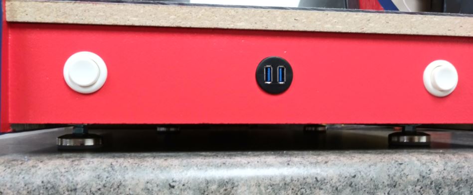

I did buy these feet from amazon. They are VERY nice. Heavy duty with a nice grip on the feet. And they come with t-nuts which is nice. I will post pics once I mount them.

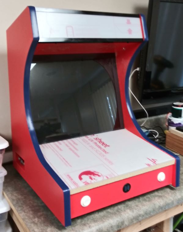

J_K_M_A_N
  • Posts: 983
Re: The bartop without a name
« Reply #27 on: June 06, 2019, 06:33:23 pm »

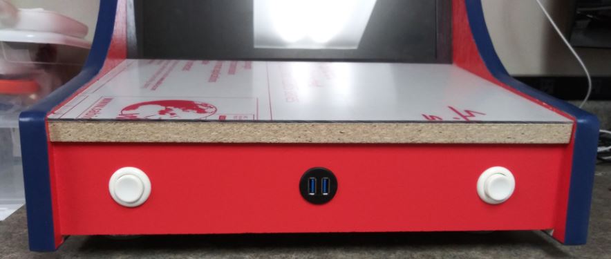

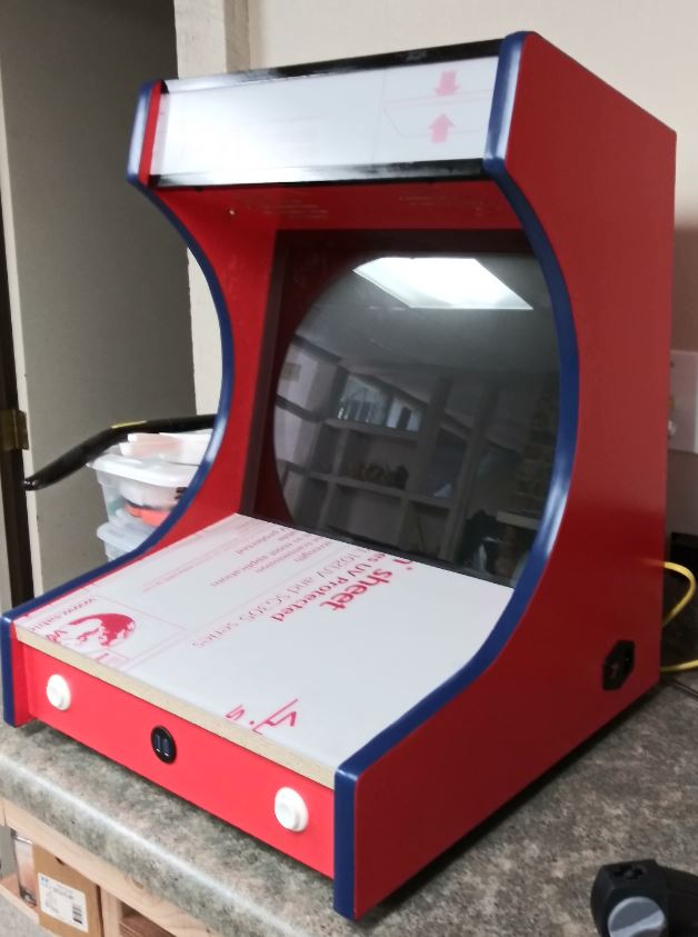

Some progress. I am done with paint and I now know I suck at painting. And I used some cheaper plywood. I will use better next time.
I still need to figure out my CP layout and graphics and the marquee. Mount the PI inside and wire everything. Not much else. Getting there. Here are the pics.
Power connector on the side instead of the back. I like it better there so you can push it back to a wall.
Speaker amp. I am not wild about how that worked. I should have taken it apart and flush mounted it. You can see past it but oh well.
I like the front. I will probably keep the white buttons as I like to colors together. Needs t-molding on the CP.
I couldn't get paint in the speaker grill area well and I gave up figuring people will not look up there. :(
The feet work great. I highly recommend them. Link in an earlier post.
It's the back...what can you say. Not a great cut but it closes. I need to add a grill on the inside for venting. It is just a hole right now.
Inside where the Pi will mount. I have not wired the strip to the switch yet but that is very easy.
I did learn that you should line up the t-molding with the INSIDE of the cabinet. I had to shave off some of the t-molding to get the CP and glass inside. Not happy about that. I wish 3/4 plywood was actually 3/4" and it would line up on both sides. :( Lesson for the next one. I also know I can't have any straight lines on the marquee. It got a little tweaked when putting it together and the right side is about 1/8" shorter height than the left side. If I use a plain background or some kind of star field type thing it should be OK.
J_K_M_A_N

lol, well the pictures are cool.. nice work man

Turned out really nice! Is the red more red in person? Never can tell with images/lighting sometimes.
For the speaker grill, I think I would try masking the painted side and spraying the other side/interior with some black spray paint. Like you said though, chances are people won't see it and it doesn't appear that noticeable in the pics.
It's been fun watching this bartop come to life!
J_K_M_A_N
  • Posts: 983
« Reply #32 on: June 07, 2019, 01:04:46 pm »
Thanks.
It is definitely more red in person IMO. It does look a little weird in the pictures. Cheap phone. Easier than using a real camera though. :)

Here are a couple pics of the CP drilled and some generic vinyl added on.
It is not wired and set to play yet but it doesn't look too bad. I will probably make a new CP though once I figure out graphics. I think I would need to put the printed vinyl on and then drill holes. I am not sure how you guys line that crap up.
I will also be using different colors for the buttons. I could not find my box o buttons so I had to use some that I had lying around.
That is all for now. I will wire this and make it playable as is as it will probably take me quite a while to figure out a name and get graphics done. Thanks for checking it out.

I like to think they are getting better.
The first one is on the left. I did not have a lot of tools when I made that.
The second one is on the right. That was kind of a practice run for some of the new tools. Mostly the router. I did not do a project thread on that as I wasn't even sure I would finish it.
The current one in the middle is now playable. I have RGBCommander working with the Ultrastik 360. I am REALLY starting to like that joystick. It feels really nice playing Donkey Kong. I was not sure if I would like it without a restrictor . I even bought a mag stik plus to rotate from the top (didn't want to go straight to the servostik). I did not care for it actually.
I still need to add games and tweak the software a bit. I also need a damn name! Then I can get some graphics. (No I am not going to keep the generic old MAME marquee printed on plain paper and taped together.  :) ) I would like to get something on the CP and for the front. I want the words printed near the buttons to show what they are for. The front is exit and speedup.
That is all for now. Hopefully someday I will figure out a name and finish this.
