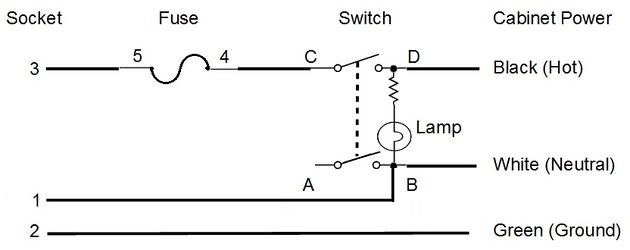

As with many MAME cabinets these days I have one of these:
I am reading about how to wire up one of these to a power strip, but there everywhere I look there are people giving conflicting instructions on how to wire them up. I'm trying to get to the bottom and understand the proper way to do it, so the light works, the fuse works, and it is safe.
First I came across this video by GameRoomSolutions.com, an Arcade cabinet vendor:
He says to wire it up like this (which is from the BYOAC wiki I think):
But then the very first YouTube comment:
You have made it actually more complicated than necessary, and potentially unsafe.
You only need to switch the hot/black. You should NEVER have the common/white on a switch. Remove that little white jumper. Wire the white from the power bar directly to the socket terminal. And make sure the black is feeding through the fuse.
Okay, so this video is from what appears to be a reputable arcade cabinet vendor but is he accidentally giving everyone unsafe instructions? Was the diagram from the BYOAC Wiki potentially unsafe? In the same list of comments I see a link to these instructions:
http://www.instructables.com/id/Wire-Up-a-Fused-AC-Male-Power-Socket/
I then I see this thread:
http://forum.arcadecontrols.com/index.php?topic=147423.0
In which there are conflicting instructions from various people too.
This guy here wired it up following the instructables diagram and he says it works:
http://forum.arcadecontrols.com/index.php?topic=132089.0
So.... which is the correct way? Is the diagram from the wiki unsafe? Is the instructable version correct? The diagram from the wiki appears to bypass the fuse altogether, which I don't think is safe, but the instructable diagram appears to use the fuse correctly if I am understanding it correctly.
Can anyone shed light on this? I don't want to hear opinions. I want to know what is the correct way.

1. The video only gives part of the info available in the Wiki (backup copy here) and assumes that the rocker switch will always be installed in the same orientation.
When the rocker is turned 180 degrees, the lamp leads -- visible on the black and white "Load" tabs -- are on the other side which causes the lamp to be always on since it is before the switch. (one of the YouTube commenters complains about encountering this problem)
2. The YouTube commenter is correct about not switching Neutral for most applications.
https://www.ecmag.com/section/codes-standards/switching-neutral-ok
TL;DR summary.
Grounded and neutral conductors generally must not be switched; doing so can be dangerous.
Electrical best practice is to avoid switching Neutral, but for this application it is not dangerous.
The picture from the Wiki is wired the same as the Instructable diagram.  "Power to cab" (Wiki) = "Load" (Instructable)
The Wiki and Instructable methods are not inherently unsafe.
Electrically it's the same as unplugging the power strip while leaving a ground attached to the computer and monitor.
That said, there is a slightly more safe way to wire the power inlet that might be needed in a very few, very rare, edge cases.
Tab labels:
Original wiring diagram:
To keep the lamp working and still wire it in the slightly more safe way suggested by the YouTube commenter, daisy-chain from 1 to B to White (Neutral) wire of the power strip in the cab.
Slightly more safe wiring diagram:
Once wiki access is restored, I'll update it to include this slightly more safe way to wire the 4-tab switches.
(3-tab switches are already wired this way)

can anyone explain the reason for the difference in these two wiring setups:
The difference is that one runs Neutral through tabs A/B and Hot through tabs C/D like the diagram below.
The other runs runs Neutral through tabs C/D and Hot through tabs A/B.
It doesn't matter which pole of the DPST (Double Pole Single Throw) switch is Neutral and which pole is Hot as long as the wire connected to A matches the wire connected to B and the wire connected to C matches the wire connected to D.
Don't worry if the physical layout looks different -- just match the electrical layout and you'll be good to go.   ;D
