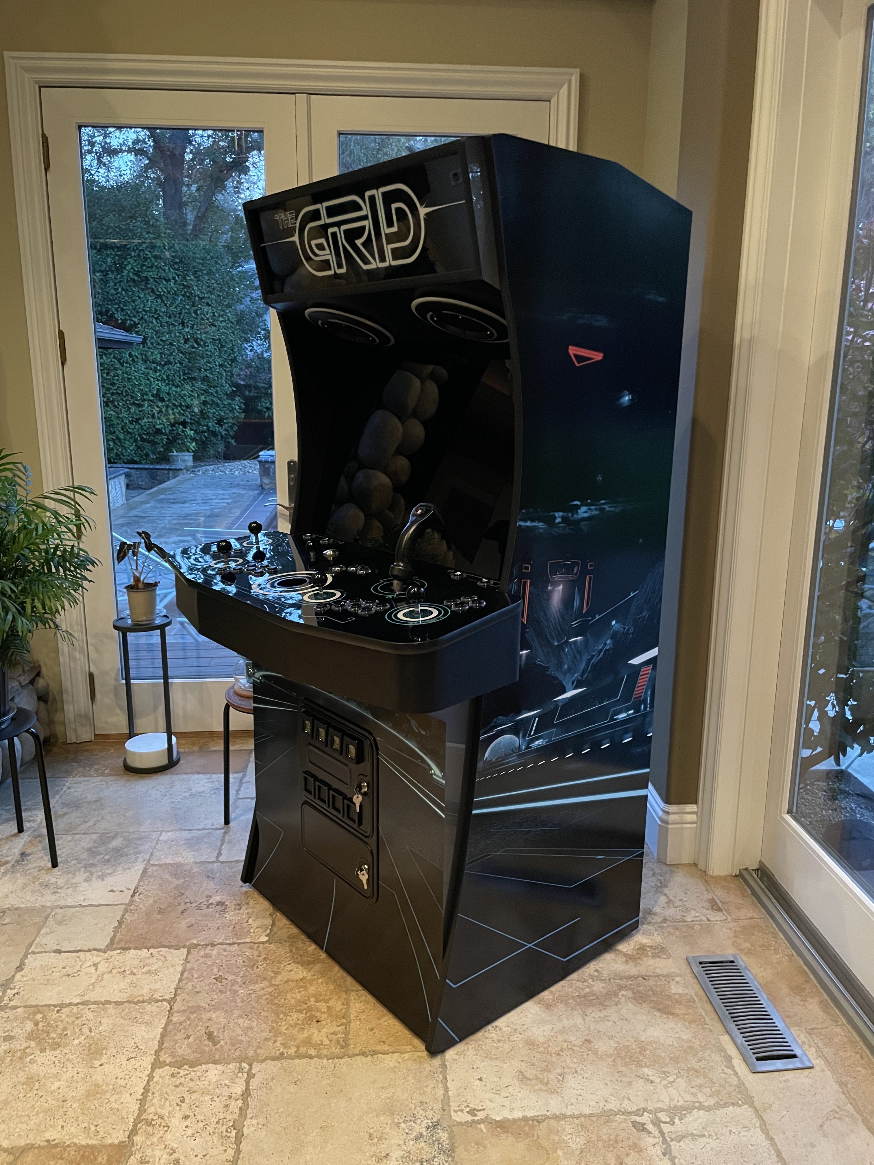

I’ve been needing to post here for a long time, but have put my energy into making cabs instead.  Long overdue so here we go.

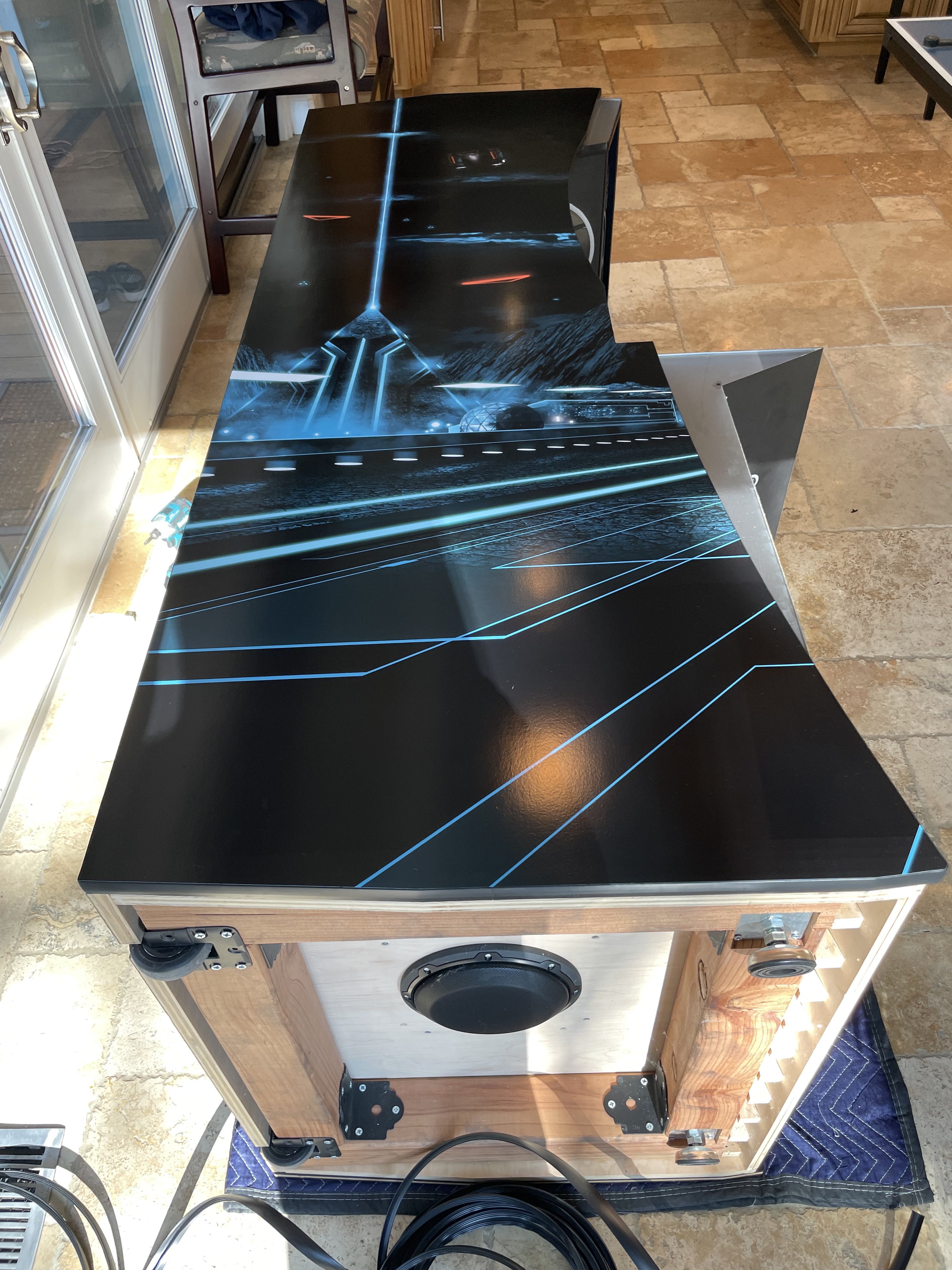

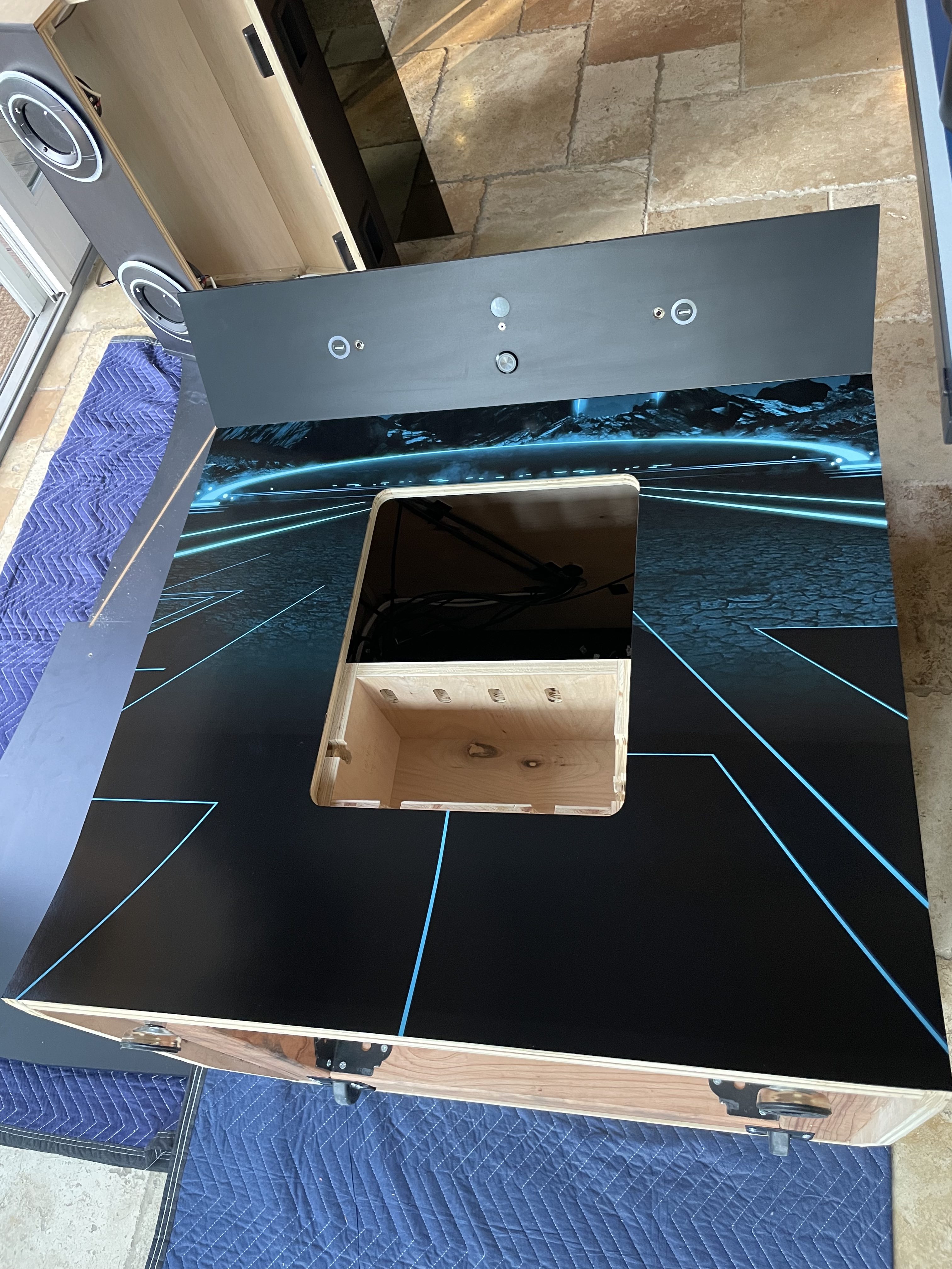

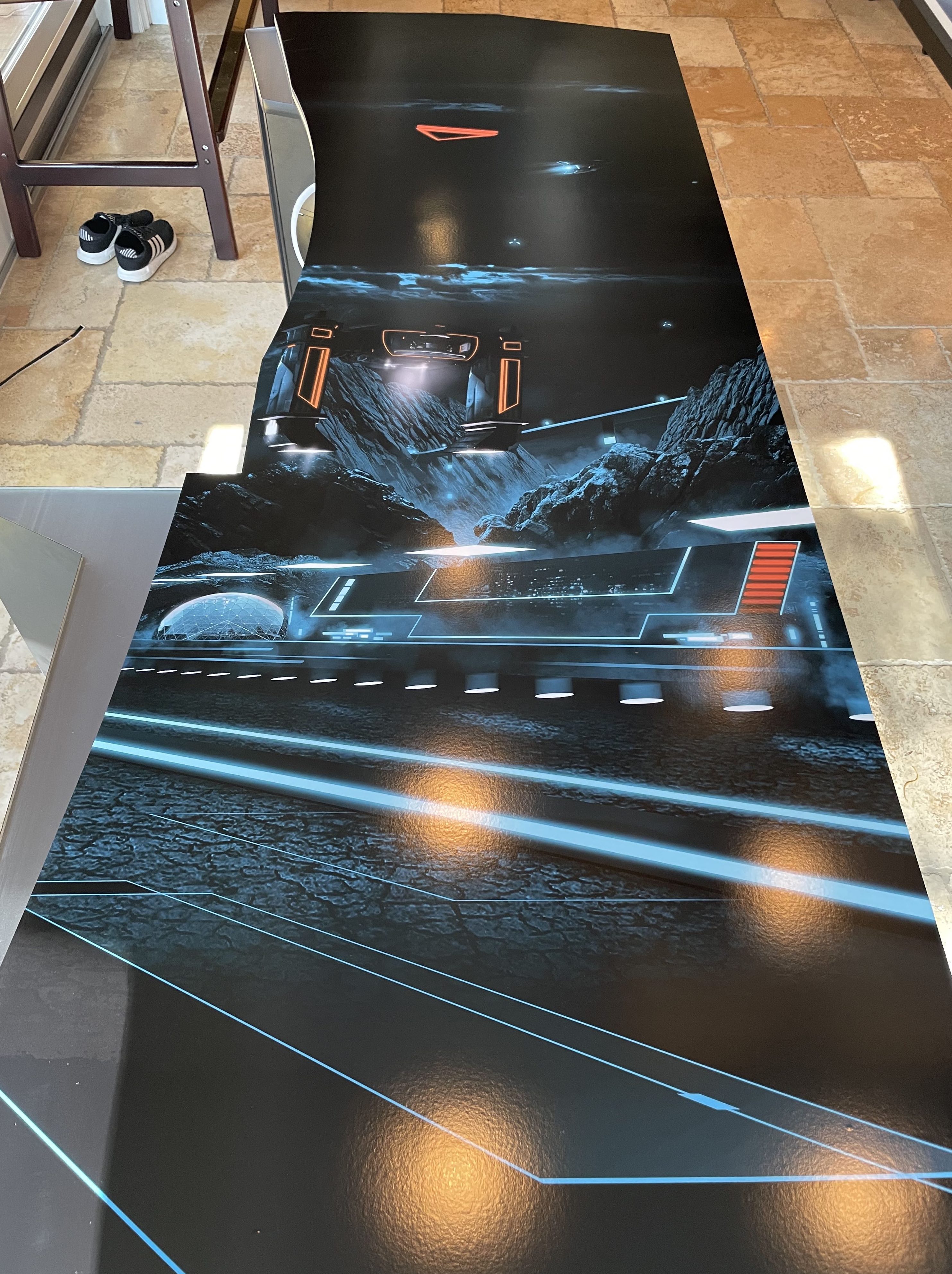

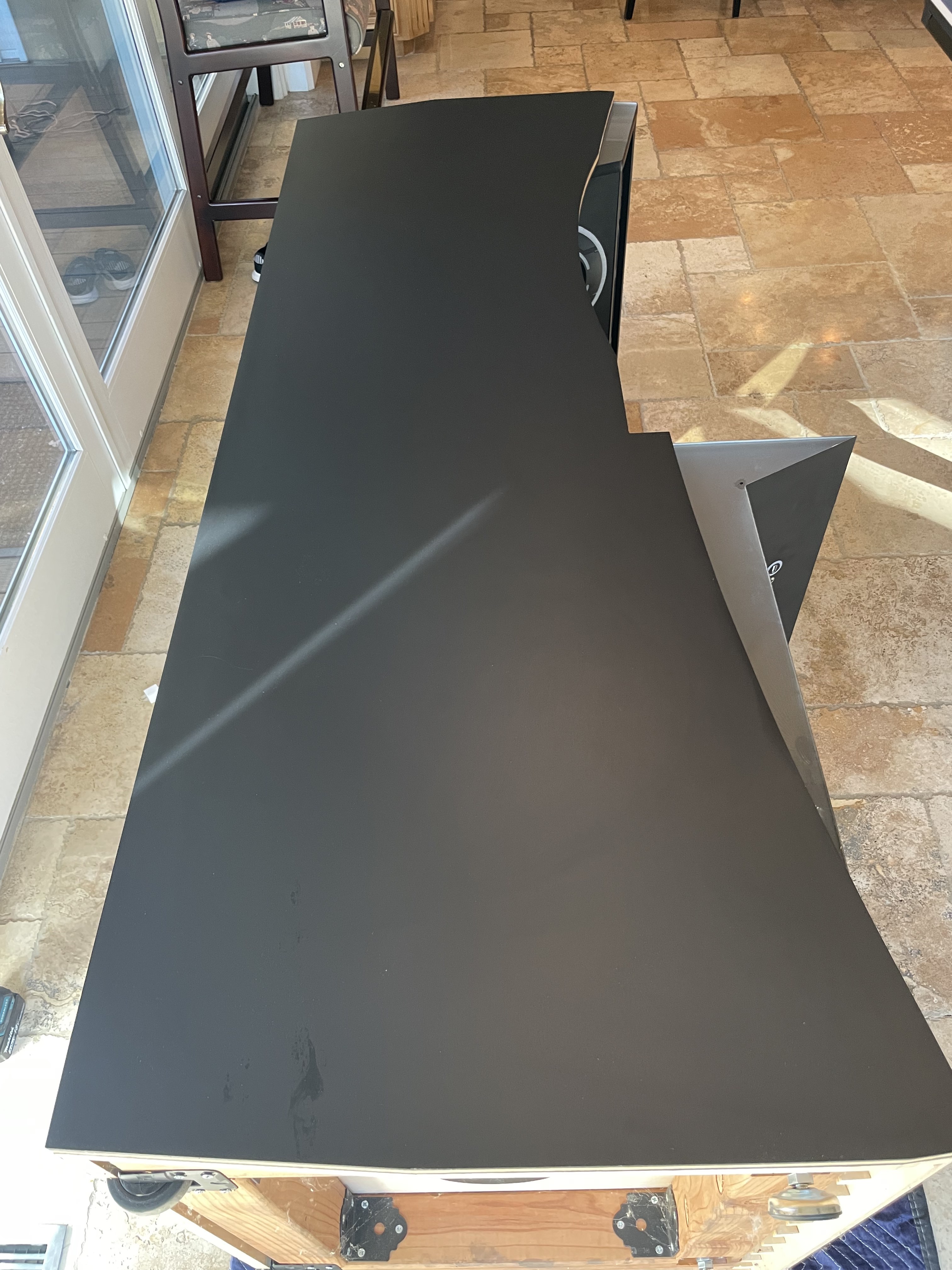

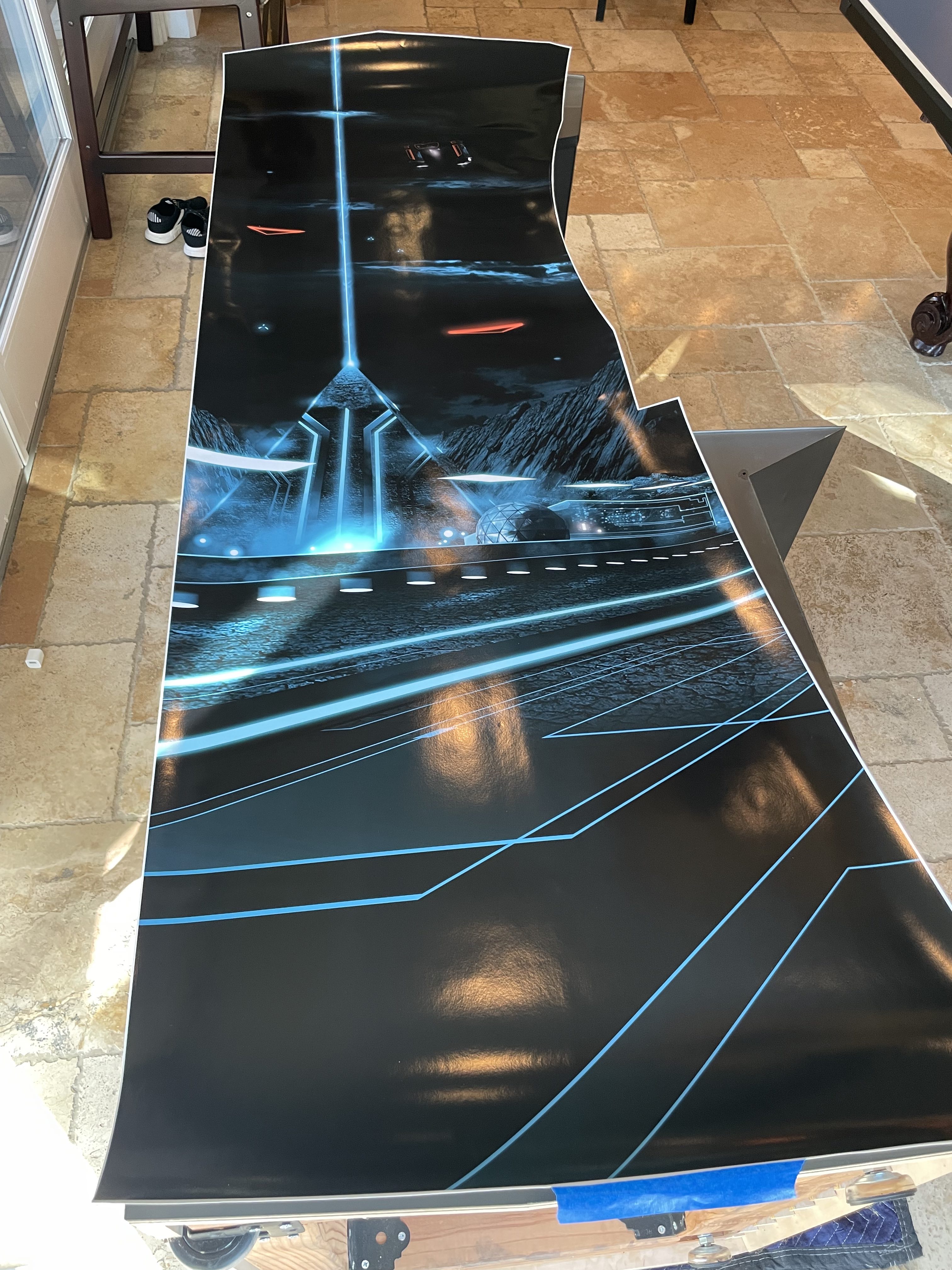

Artwork needed to get installed:
Sprayed it down with Isopropyl Alcohol to remove any oils.
Laid out the artwork from Szabo’s arcade print shop:
Nice part was I designed it in Photoshop to have a 1/2” hang on all sides and Szabo plot cut it to the shape.  Made it easier to install as I could see all the sides.  I did the usual painters tape in the middle once I had aligned it so it wouldn’t move.  Then did the hinge method of peeling away the backing and used a squeegee to slowly press it down.  This stuff is very forgiving with bubbles as it is perforated. Having said that I have since discovered Rapid Tac and would use that in the future.
Rubber mallet for installing the t-molding.  I found that not using a towel was better.  When I wrapped it in microfiber it actually left impressions of the fibers in the plastic.  If I hit it with the mallet directly it was better.
Other side:

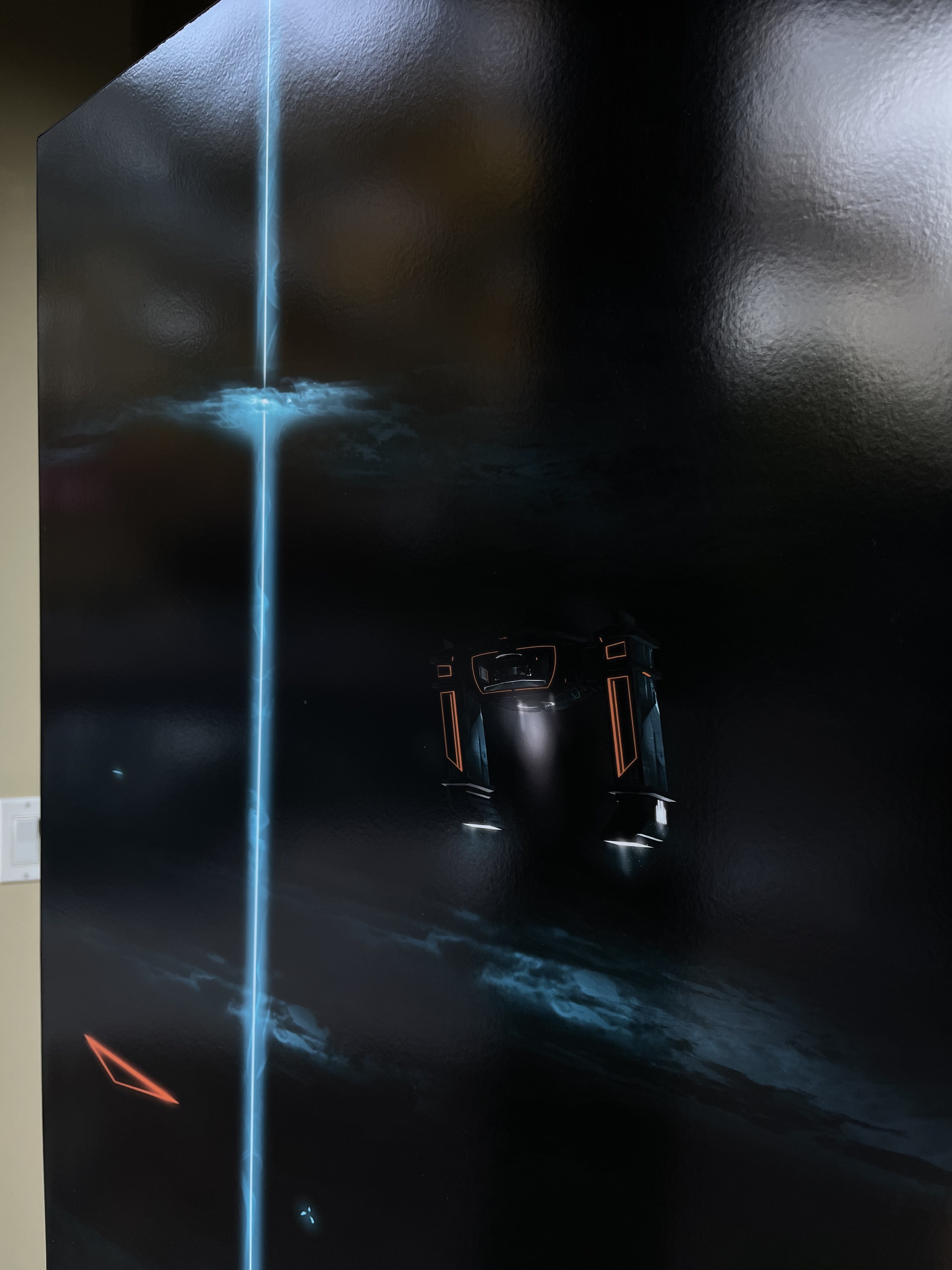

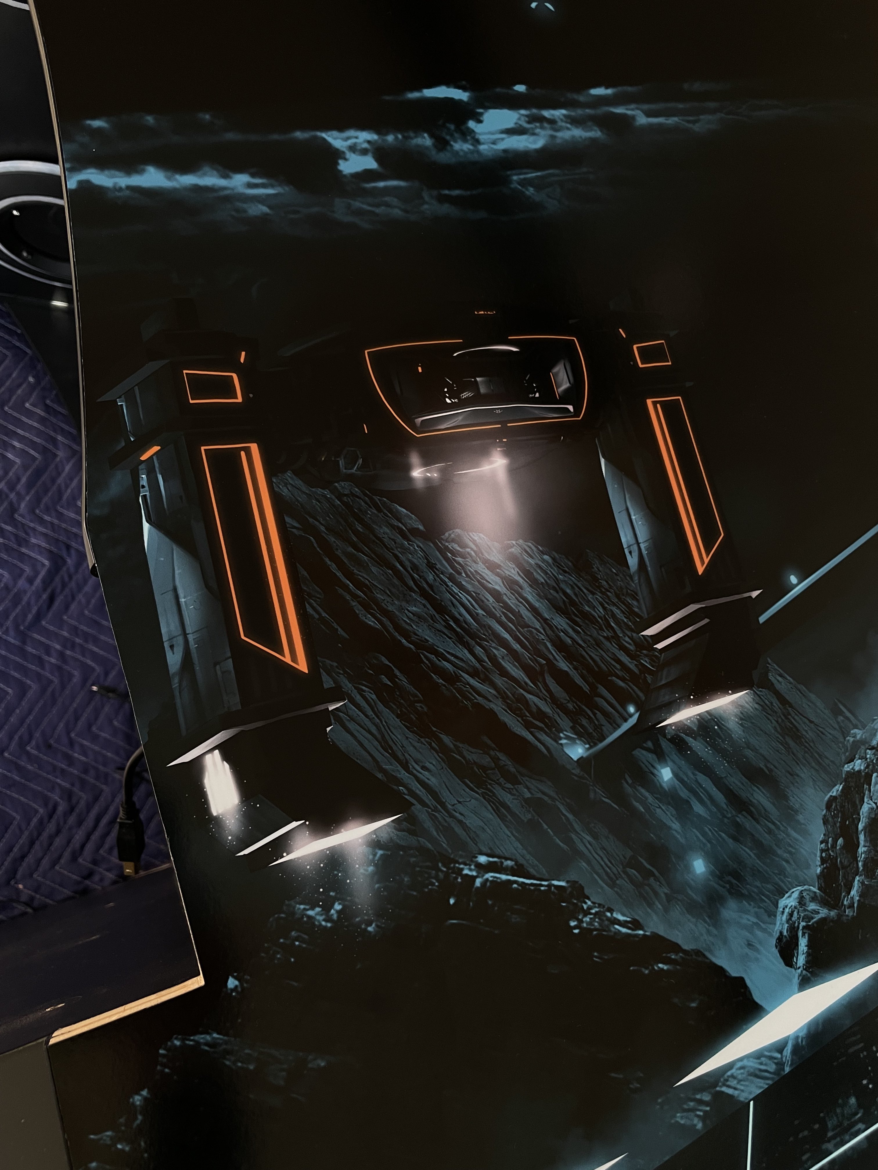

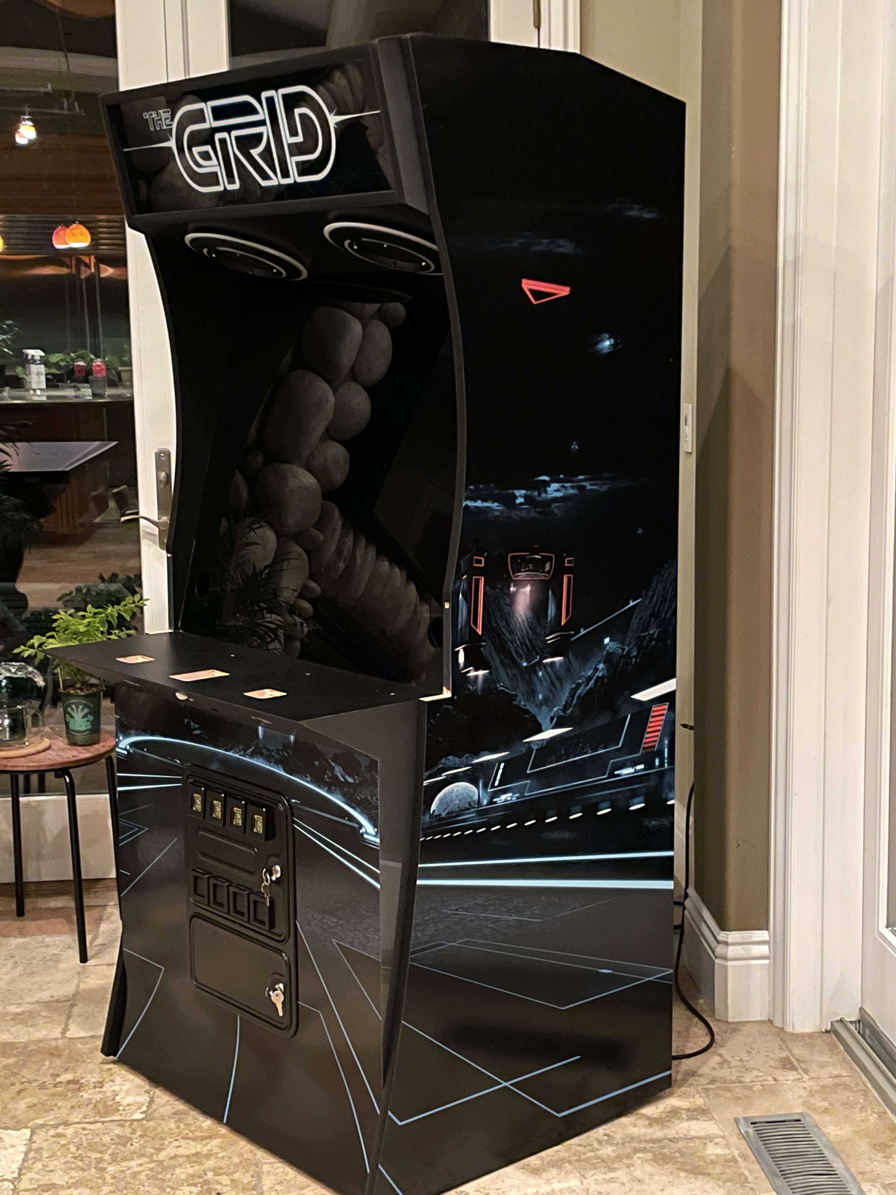

Very happy with how the artwork came out:
Wrap around for entire scene:

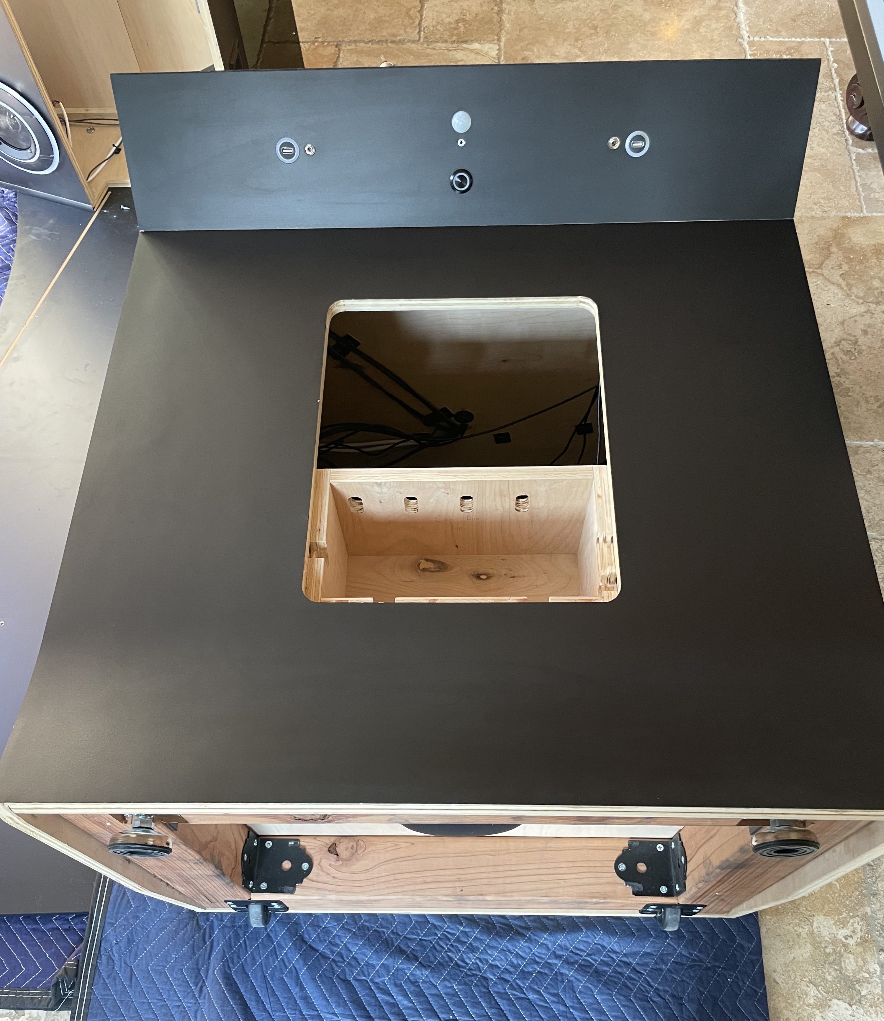

Put back together before CP install, always looks funny without the CP on.

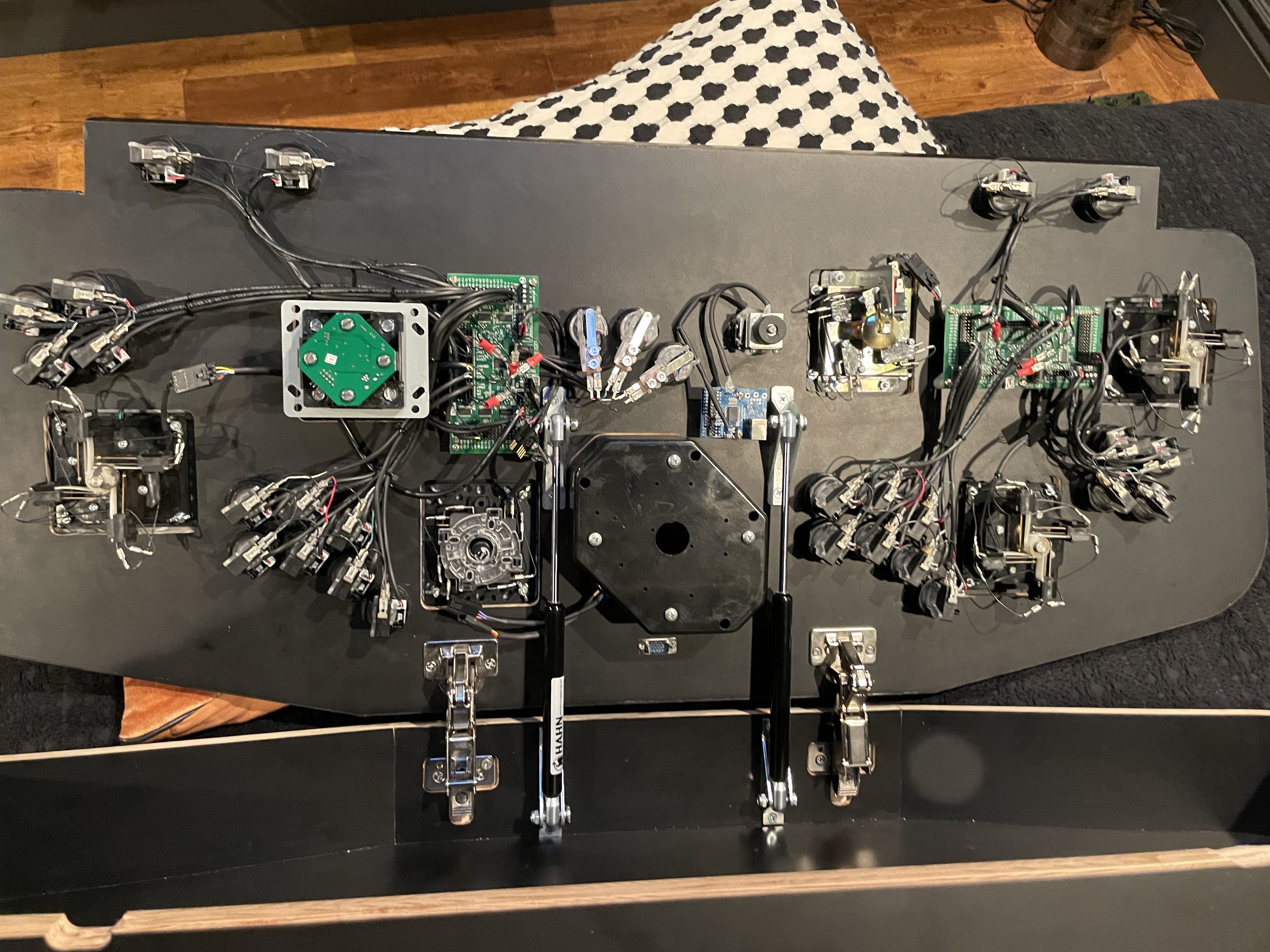

Full view of the CP with wiring completed and gas struts installed to keep it held up:
CP back in place:

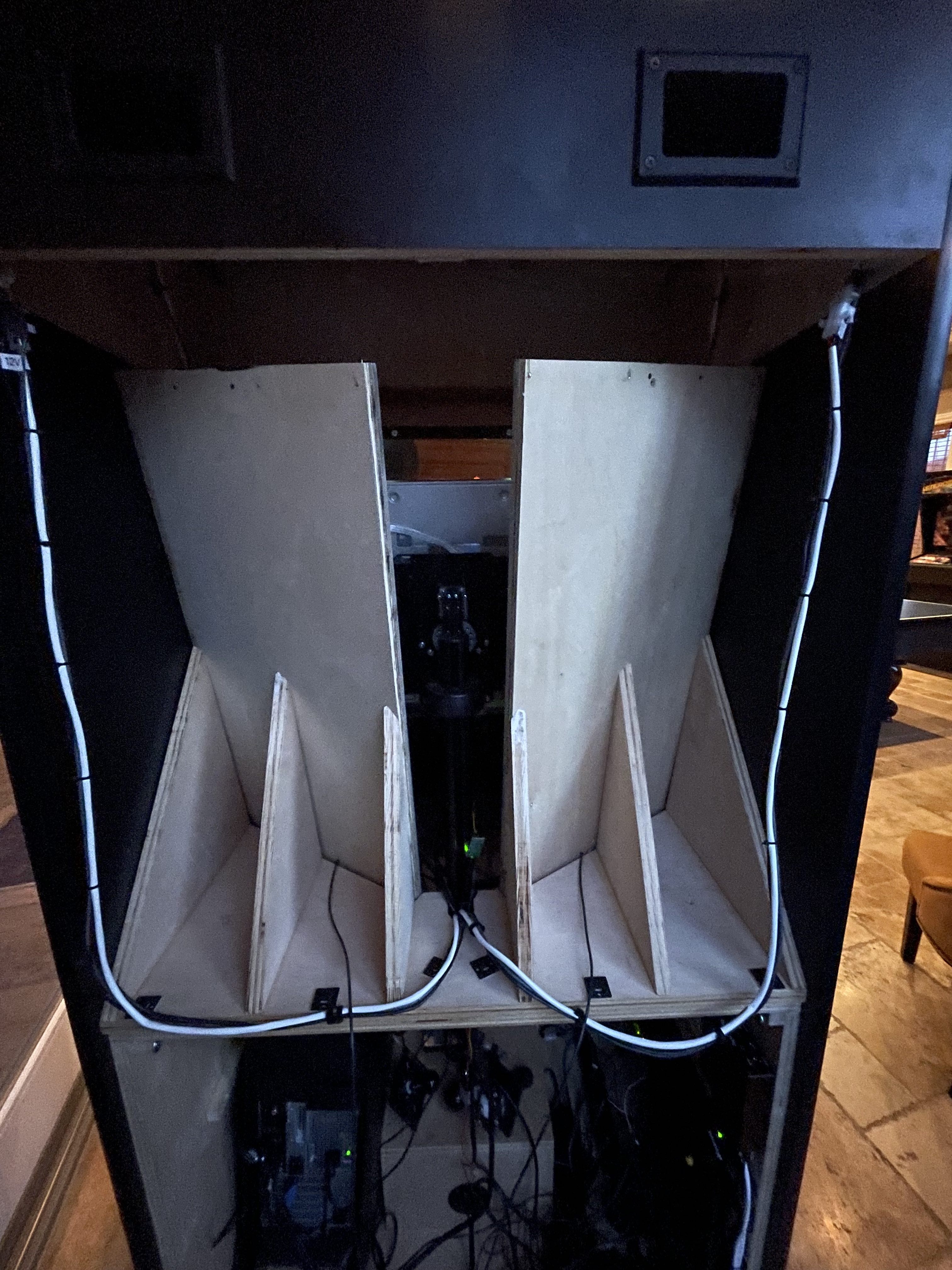

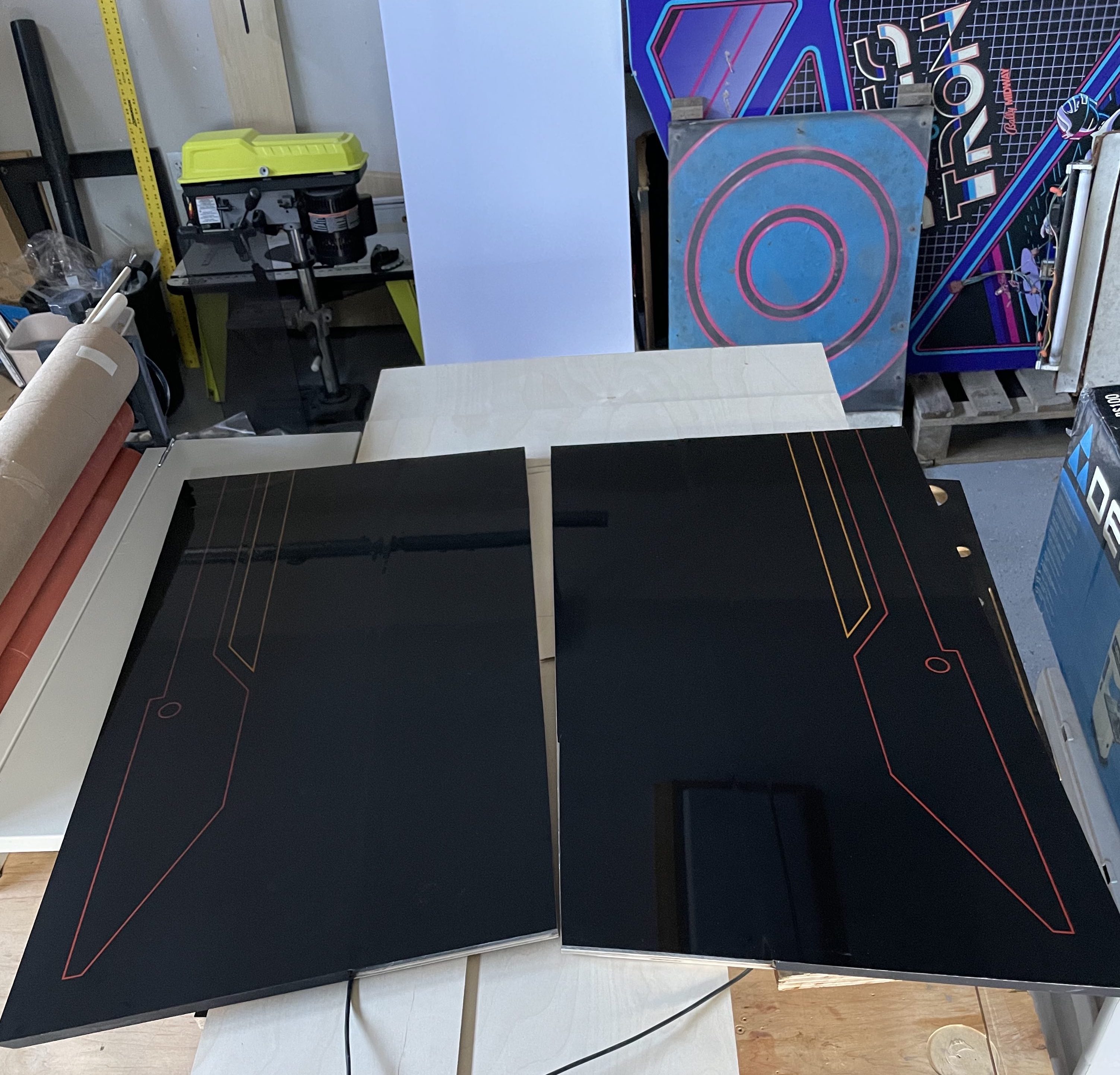

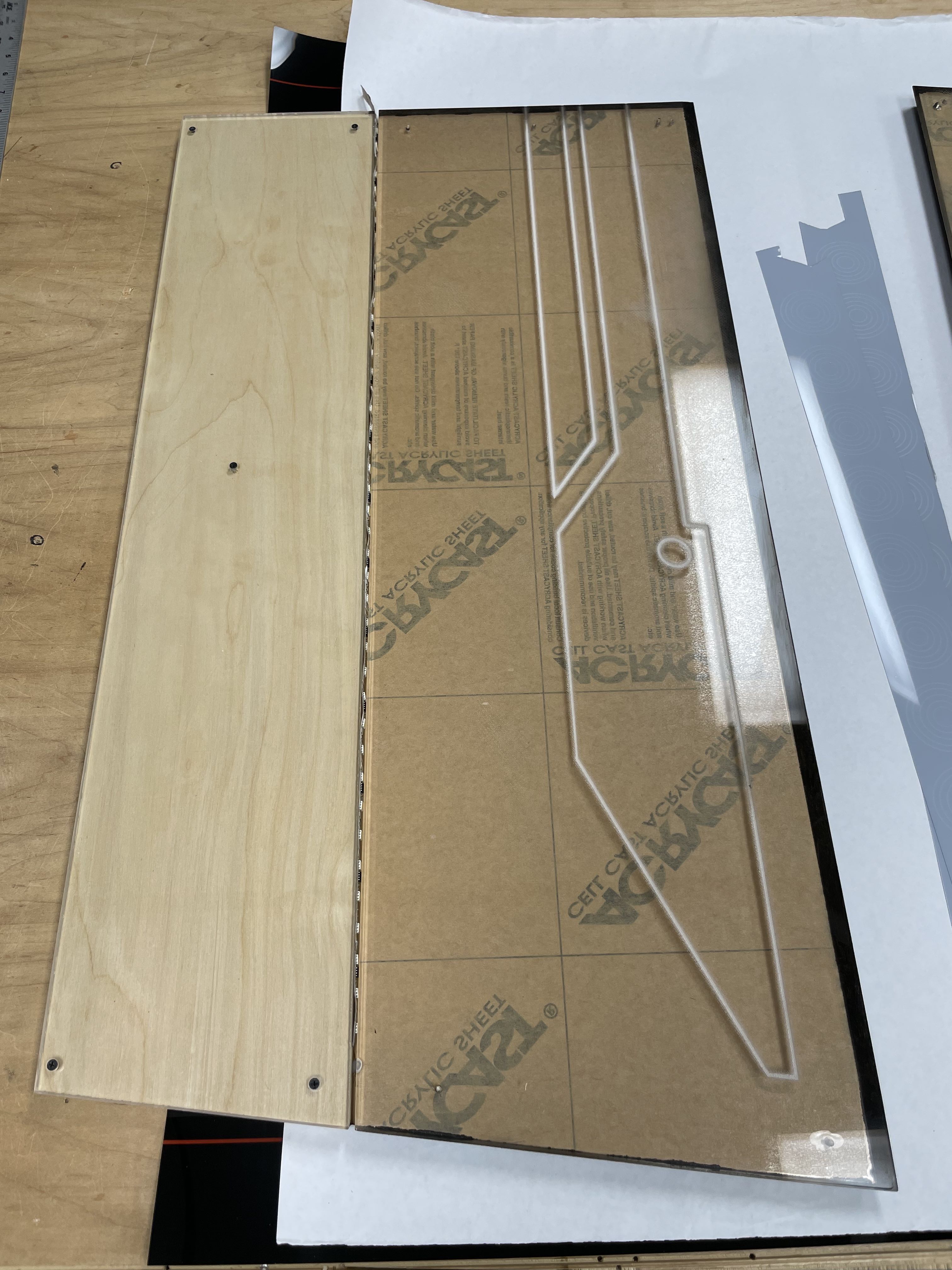

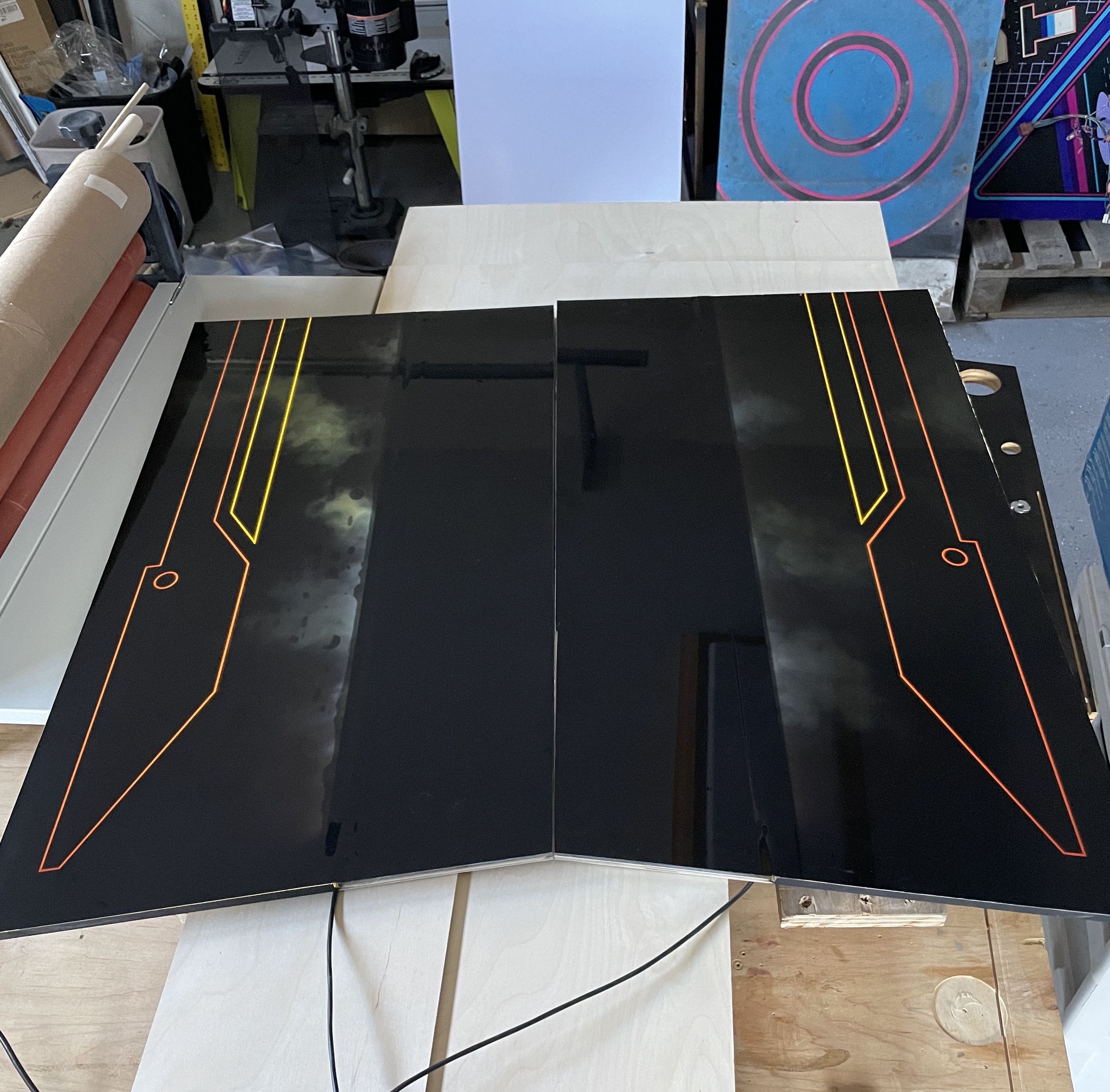

Finishing touch was the monitor surrounds:

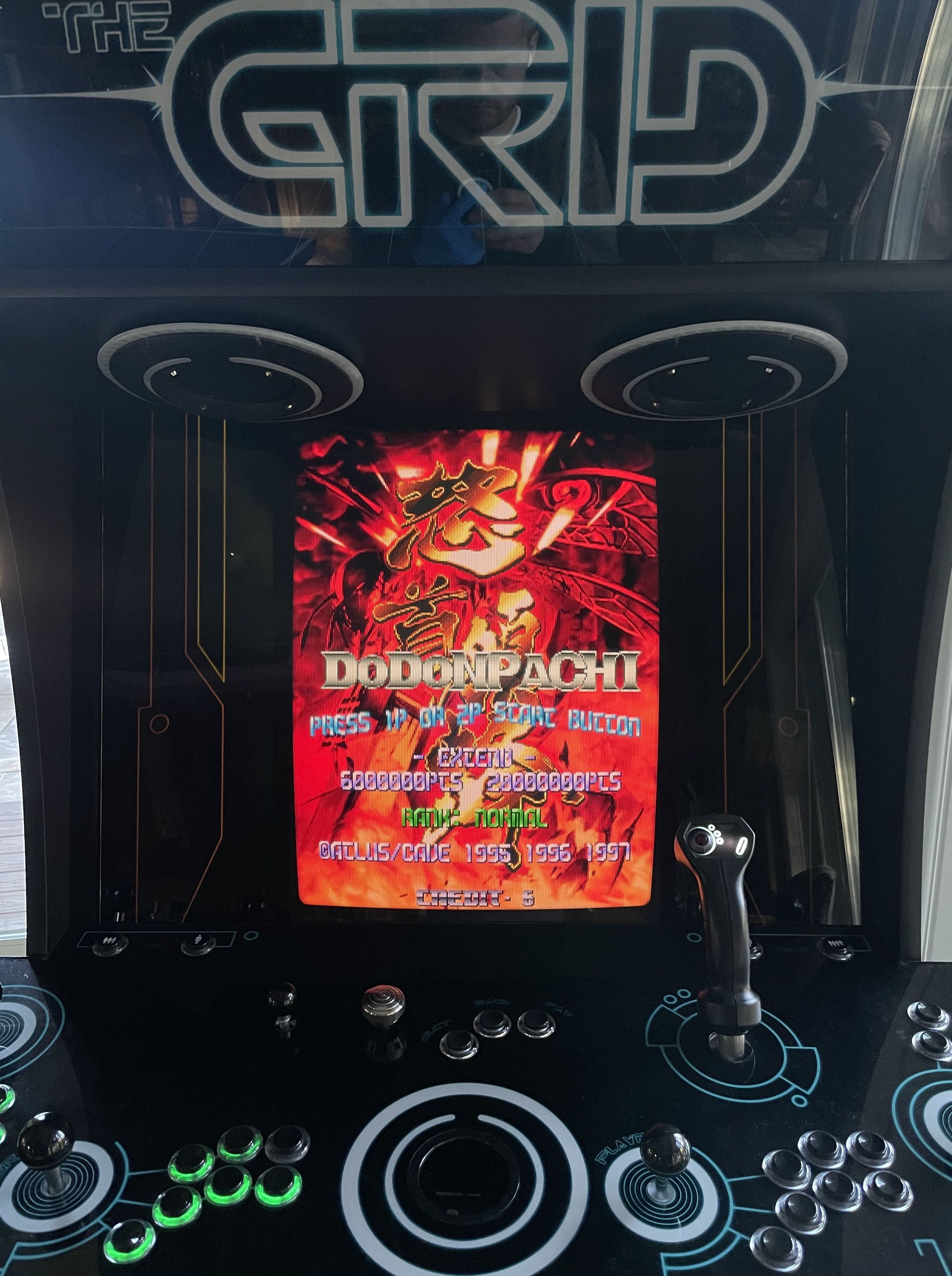

When you rotate the monitor vertically the graphics light up around it.  Looks really cool during the day as the monitor looks like it’s floating in space:
Not quite as cool at night as LCD shows light to the edges of the screen.  Had it been an OLED then it would work much better at night.

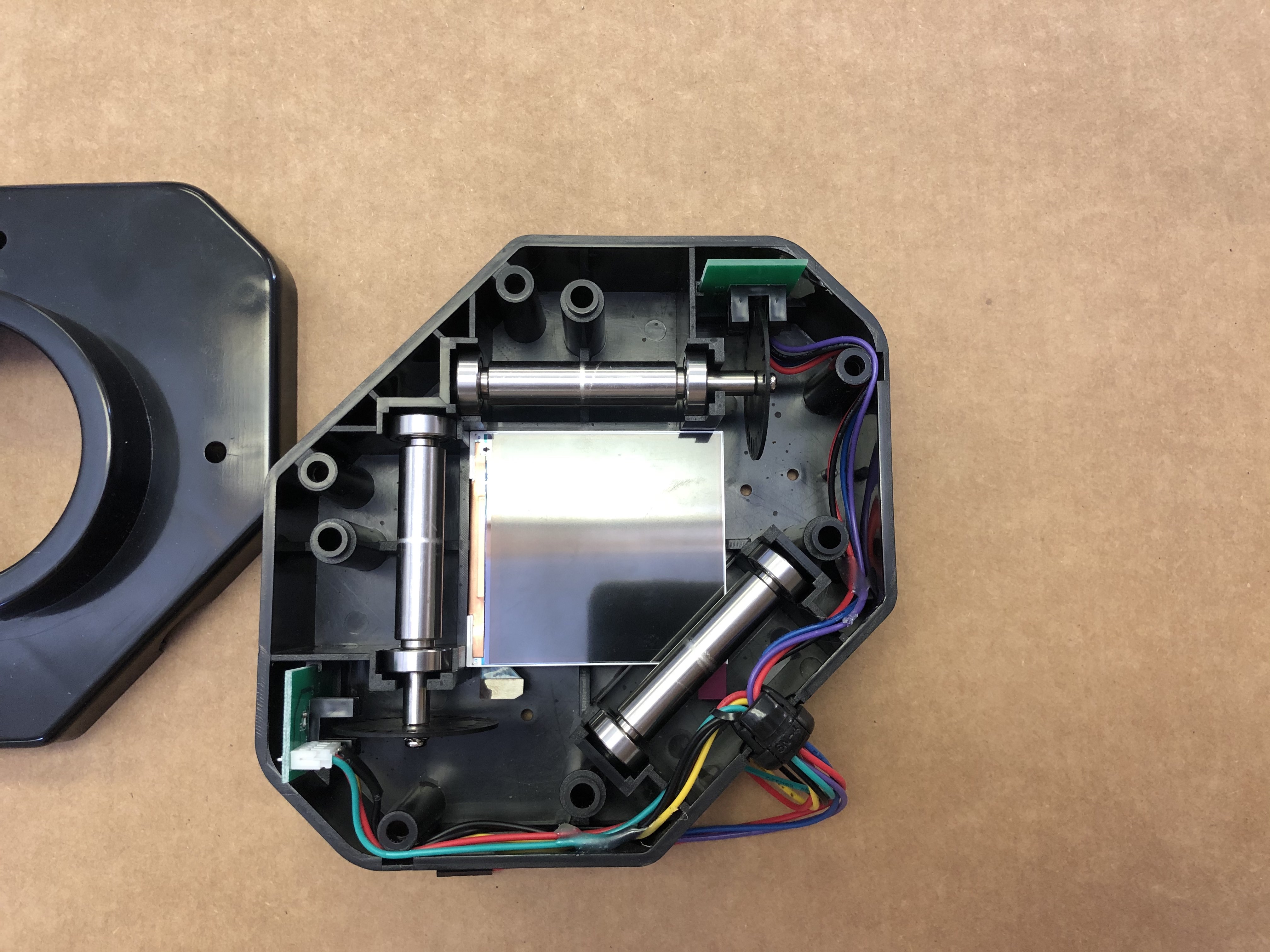

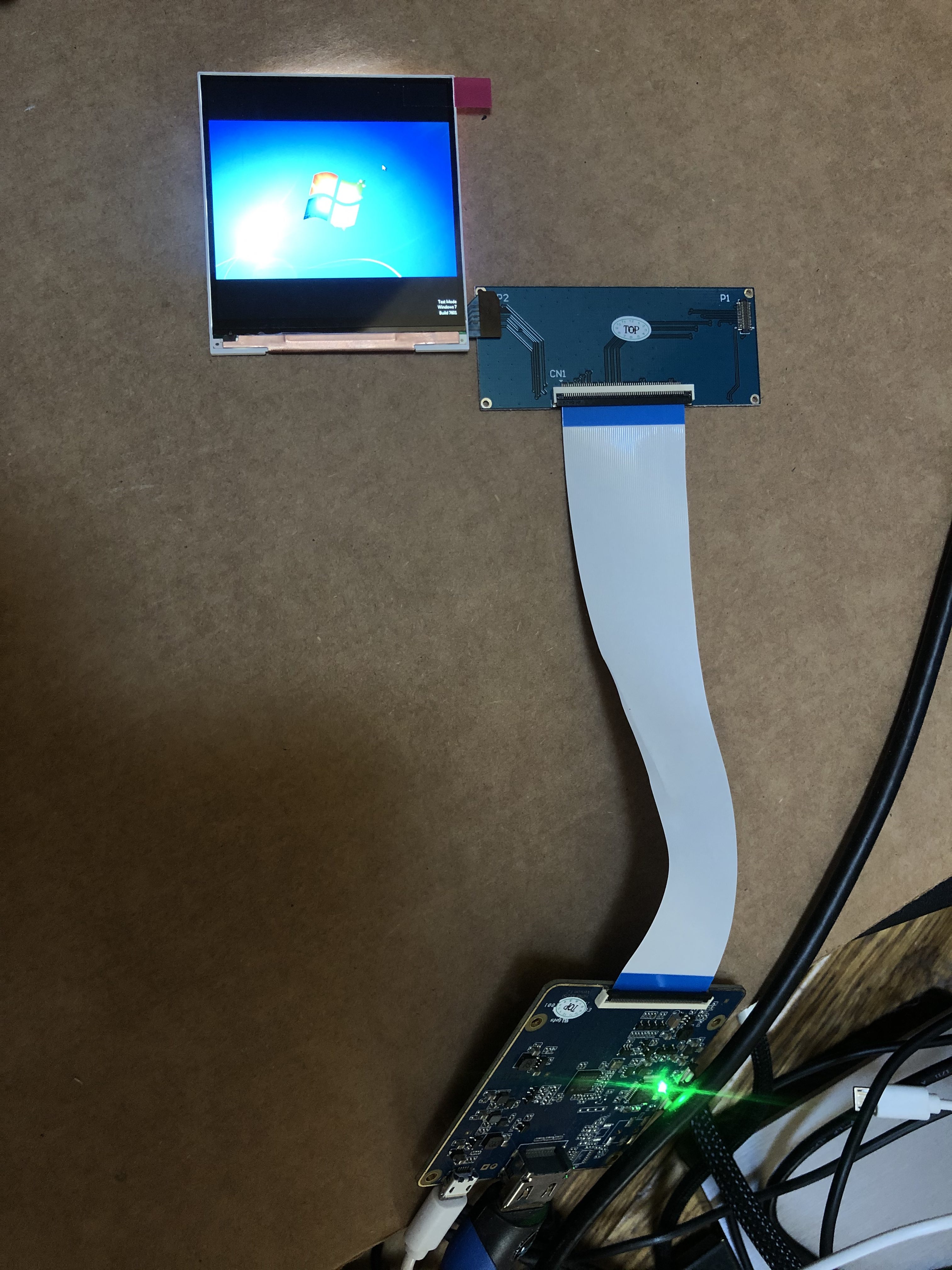

One last thing that I haven’t quite completed but thought the idea was fun.  Early on I had the idea of using a clear track ball, however instead of using an led to make it a particular color I thought it would be fun to put a screen under it so you could make whatever you wanted show up inside.  Trick is it has to be very close otherwise the image becomes inverted (upside down).  It is a really cool effect, looks like you are looking through VR glasses.  To do this I bought a small LCD screen from a Blackberry off of Aliexpress with an HDMI interface:
Here you can get a sense of what it looks like (this was early on when using a clear globe I had):
I thought it would be fun if someone built a Star Wars cab and had the death star on rotation, seems like it would look really cool.
I’m sure I will come back to this and button up the lighting and trackball, for now however I have many other projects to get to.  So done for now

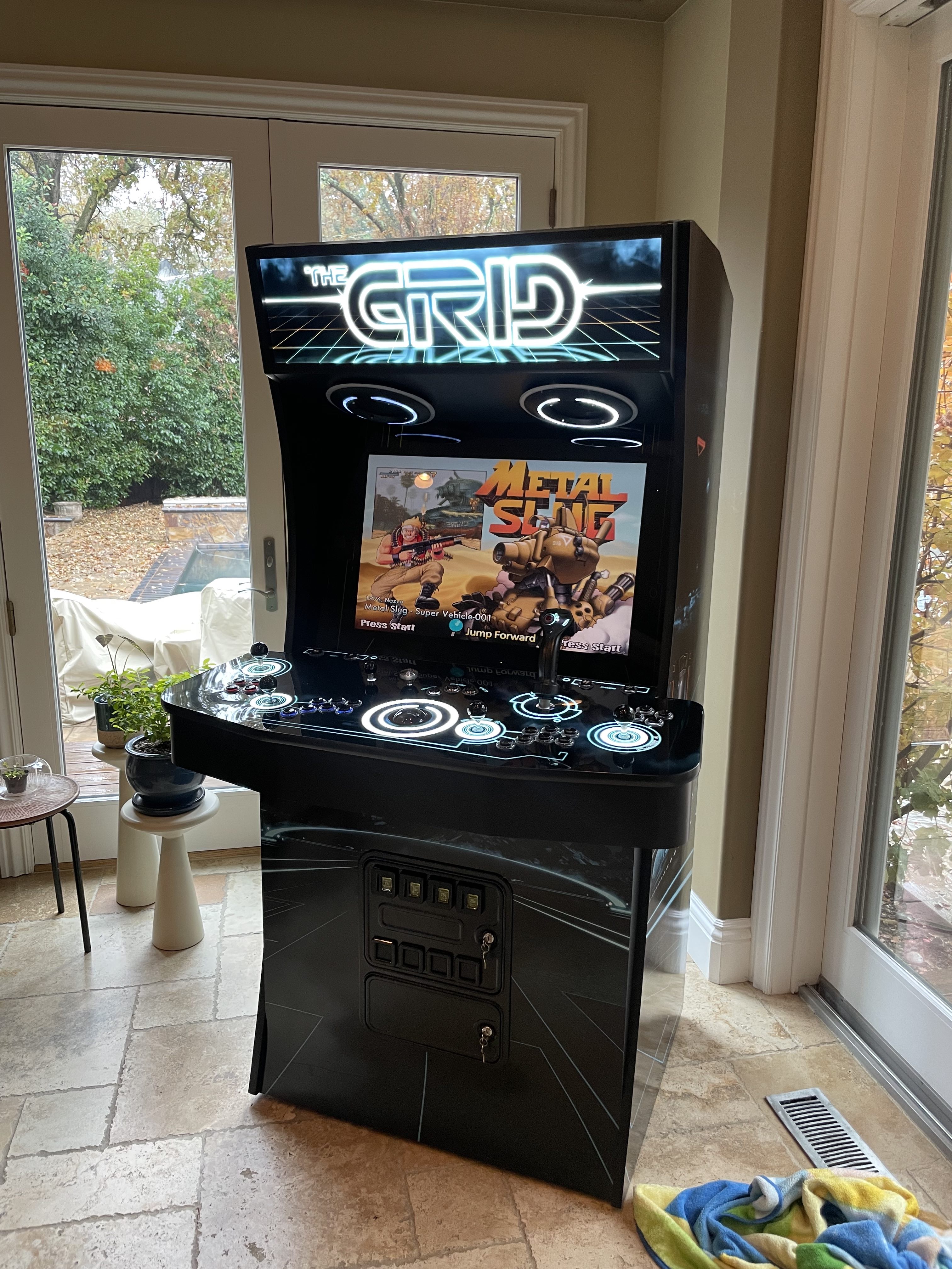

Completed cab:

Your lighting treatment parts are just beyond the beyond.
Trackball backlight/image bit is just awesome.
I envy you your patience and attention to detail and fit/finish.
Next level.
Nicely done!

Man, that cab is even beyond awesome.
There are many things to admire, but there are a couple of small details I really liked.
First is the hydraulic lifters to hold the control panel vertical while you have it open and working on it. This is both inexpensive very practical, especially for a larger panel like yours. Very neat idea.
Second, is that a bass speaker/woofer built into the floor of the cab? That must really add some chunky sound feeling when playing :D

Arroyo - glad to see you finish this up. It looks awesome. The lighting and every detail is second to none. I love the artwork and I think everything came together perfectly. I definitely want to see some videos of this thing in action!
How are you rotating the monitor?  I'm sure you explained it at some point but my middle aged brain isn't what it used to be...

Thanks bobby, it's been a big labor, but I learned a ton in the process.
Thanks Zebidee, yeah the gas struts proved to be a requirement, as the panel is pretty heavy  :o  Bass is pretty hefty when you turn it up, it's fun on fighting games like Mortal Kombat, really feel the hits!
Cheers Javery, appreciate it.  I'll do a video some day when I get all the lighting finished. The rotating monitor starts on post #54, there's also a tutorial here.
