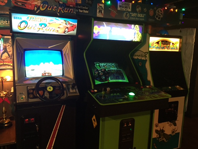

The goal here is to fully restore one cab and the other (100% dependent on if the board is working and if I can get a good monitor) will be a restore as well. If not I will part it out to other outrun restorers since these cabs have a lot of parts that are not replicated right now.
Ian
  • Posts: 1060
Re: Why race when we can OUTRUN!
« Reply #3 on: August 01, 2017, 10:21:49 pm »
I have to lighten this beast before going into my dungeon. So off goes the steering wheel! Looks like I have quite a bit of cleaning to do. These things are gross. Cab 1 is greasy everywhere... cab 2 is pretty clean.
Cab 1 Grease cab!
Cab 2 Not so bad... lol

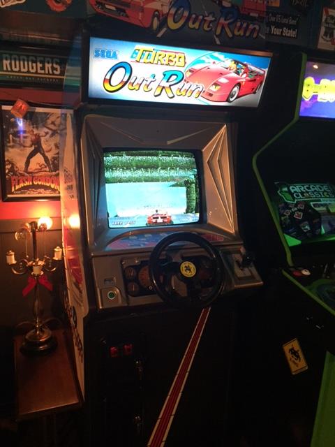

Not a terribly exciting clean up... but it is done. I just scrubbed, wire brushed, rewired a marquee light, scrubbed, and scrubbed. Here are some after pictures... Just need to find an original Outrun Board. Turbo Outrun kind of sucks.

I still need to desuicide the board... and get myself an original Outrun... but it came together great. Replaced the springs and wire brushed the pedals... it was a piece of cake.

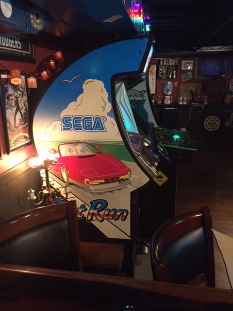

Well... Last Thursday was an important night for my Outrun Project. I posted a WTB over at Klov for a working Outrun board and after a few weeks I nearly lost hope. Then bam! A guy had a working board he was willing to sell. And as luck would have it, he lived less than 30 minutes from my house! Went over there checked out his collection (He had a SpyHunter, Star Wars upright, Cabaret Centipede and Outrun, 4 of the shorter pinball machines that Williams put out, Pole Position cockpit, and a (I believe) a Sea Rider with the Periscope! Very cool. He also had a few projects but overall I was impressed!
Anyway put the final touches on the Outrun. Ripped off the Turbo sticker on the side art that covered the Sega Logo, Replaced the Map artwork on the dashboard, shined up the Steering Wheel and Stick shift knob. Put in the textured black t-molding, and of course put in the Outrun PCB.
Oh, and the PCB had an added bonus. It had the highscore save kit, MPH, Attract mode, song select (with the music), and freeplay upgrade! Not bad!

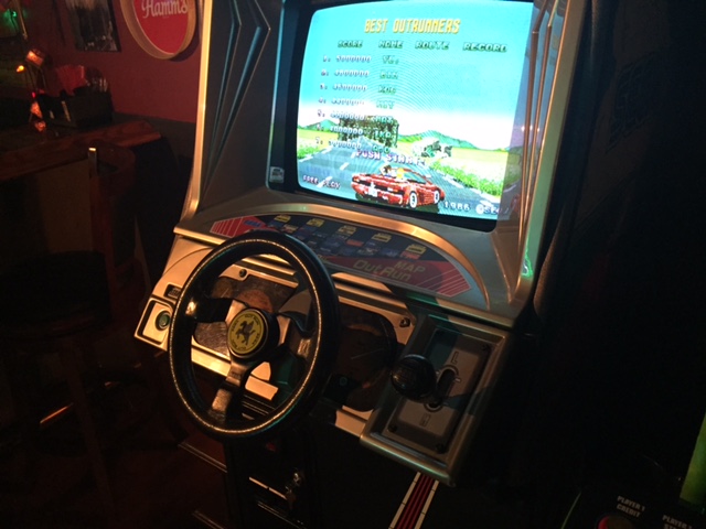

I get a nice refurbed monitor (the old one had terrible terrible screen burn) a Wells Gardener 7200 and plugged her in. And she is beautiful! I play it for 4-5 days and am loving it. Well I had company and left the machine on for like 6 hours and when I came back I found that the picture was a bit glitchy. The blue sky was gray and the water was gray. So I unplug everything check my voltages and found that my power supply  5 volt is giving off like 5-6 volts and the adjustment knob is doing nothing. So I have replaced the powersupply voltages are now a solid 5v. I also noticed that the second fuse down was blown. So I replaced the fuse and powered the game on again and the sky is nice and blue but the road is half brownish gray and the other half is blended into the background.
Game plays fine.. but the road is really bothering me. Also I would like to point out that the boards have been reseated together (A and B boards), and the chips themselves have not been touched since they are newer chips (the board was fresh off of a repair).

Attack the symptoms. Why did the fuse blow? That would be my first question. I can't view the video until I go home, so if that is already answered in the video you can disregard that advice.
Ian
  • Posts: 1060
Re: Why race when we can OUTRUN! ***New Issue Need Help****
« Reply #27 on: October 05, 2017, 04:54:37 pm »
wrong fuse... it was a quick burn fuse. This fuse is for the fan motor, the florescent light and the monitor power. I assume the monitor spiked when booted up which caused the quick burn to pop. I put in the correct fuse and it seems to be running fine.
