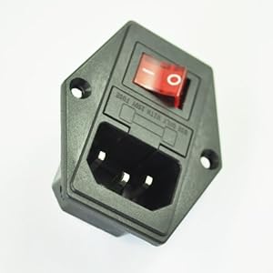

Know its a ton...just happy I made a cabinet - never made stuff before really...not even the birdhouse in school.

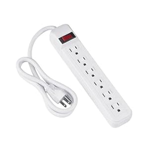

The power switch button, what connects to what from extension cord?
What kind of switch?  3-tab?  4-tab?  :dunno
Check out the wiring diagrams at https://web.archive.org/web/20150928061832/http://newwiki.arcadecontrols.com/index.php?title=Wiring#IEC_Fused_Power_Inlet_with_a_Lighted_Switch.
Your setup should be similar, except for the fuse and maybe the lamp.

Same idea I'm going to run with for getting power to the power supply. With the 3 open wires, do I just put them under the screws for attach to a spade terminal and wrap em a bit? How do I know what guage the inside wires are?
I've got a ton of 14g around the house so I could easily rip one and add a 15amp plug to one end and connect other to supply?

Right now I'm still trying to understand the power switch button and basically can I cut a computer power cord to go to the arcade power supply and plug that into a surge protector inside the cabinet, cut the plug off of that and hook it into that power switch club which would then be on the outside of the cabinet so hopefully one wire goes from the cabinet to the wall.
  • Posts: 9725
  • Last login:Today at 03:55:29 am
Re: Wiring - got it but don't got it...
« Reply #17 on: June 29, 2017, 10:13:50 pm »
So you're saying that you want to plug an IEC power cord into the wall socket . . .
. . . that connects to an IEC power inlet . . .
. . . that connects to a power strip (plug cut off and replaced by 1/4" Quick Disconnects that connect to the back of the inlet above) . . .
. . . then you connect a power cord from the power strip to the screw terminals of the switching power supply. (IEC connector cut off)
Sounds good.   ;D

Cut a computer cord and the colors are blue, light green, and brown/bronze....which one is what?
JDFan
« Reply #19 on: June 30, 2017, 03:08:07 pm »
Green - Earth Ground or middle prong
Blue - Neutral
Brown - Hot
Ninja69Assassin
  • Posts: 33
  • Last login:July 28, 2017, 11:59:37 am
  • I pay for everything I refuse to pay for...
« Reply #20 on: June 30, 2017, 07:30:56 pm »
Have power for the surge protector....progress 😀
