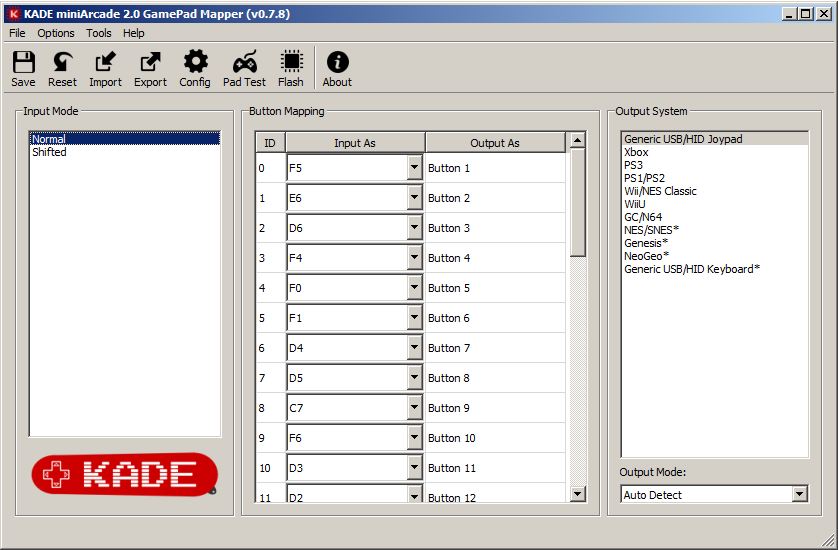

The KADE Team is proud to announce the beta release of the miniArcade 2.0 Mapper program and PCB fabrication files.
This Google Drive folder has complete download packages for Windows, Mac, and Ubuntu 64-bit: is no longer available.

What does Mapper do?
It allows you to program a 32u4 AVR to work with a variety of arcade-style controls.
What AVR and bootloader do I need?

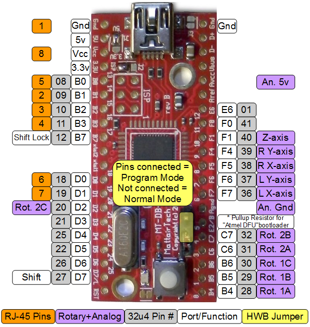

MiniArcade 2.0 is designed to work with a wide variety of boards.
Any 32u4 AVR with DFU (FLIP) bootloader + 16Mhz crystal like the MattairTech MT-DB-U4 will work automatically with Mapper.
("Atmel DFU bootloader" will work too, but requires a pullup resistor on E2/B)
The MT-DB-U4 is a perfect pin-for-pin match for the miniArcade 2.0 daughterboard.
To use 32u4 AVRs with other bootloaders, you need to be able to be able to upload a firmware hex file and an EEPROM hex file to the board. (currently working on procedures for Arduino and Teensy 2.0 boards)
How many input ports are available?
Mapper has 47 available Button Mapping IDs. (0-46)
The Button Mapping ID "Input As" indicates which of the 24 Normal input ports or 23 Shifted input ports (Shift + B7 is reserved for Shift Lock) will trigger the related output.

If you don't want to bother with fabricating the daughterboard, you can use header pins or solder wires directly to your AVR board.
If you don't want to bother with fabricating the multi-out board, you can build the circuit on a prototype board or solderless breadboard. (use the gerber files to determine the necessary connections)

Steps for flashing into a Teensy 2.0 board should be something like:
- Load a .DAT mapping file and/or change mappings and settings as you wish
- Select Tools -> Save EEPROM config data to .ELF for Teensy Loader
- Open Teensy Loader
- Connect Teensy 2.0 PCB to your PC's USB and push the button in order to get into programming mode
- Click the Open HEX file button and select MINIARCADE2.hex inside the mapper application's firmware folder
- Click the Program button
- Click the Reboot button
Please note that you flash the .HEX file with Teensy Loader, however, the .ELF file should be at the same folder otherwise EEPROM data won't be flashed to Teensy.

If anyone has an Arduino and wants to try loading the miniArcade 2.0 firmware and EEPROM using avrdude:
1. Install the avrdude programmer.
2. Install the Arduino Leonardo/Mini bootloader driver as per the instructions at https://www.arduino.cc/en/Guide/ArduinoLeonardoMicro#toc2
3. Configure miniArcade 2.0 Mapper as desired.
4. Click on "Tools -- Save EEPROM config data to file (HEX)..." and save the "EEPROM.eep" file in the "\firmwares\" folder.
5. Rename "EEPROM.eep" to "EEPROM.hex". (both are hex format)
6. Copy the "MINIARCADE2.hex" and "EEPROM.hex" files from the "\firmwares\" folder to the avrdude folder.
7. Find the COM port assigned to the Arduino bootloader.  Look in the Device Manager properties screen or the Arduino software under Tools--Serial Port (look for the check mark)
8. Create a "miniArcade2.txt" file with this text in the avrdude directory. (Change "COMXX" to the Arduino bootloader port i.e. "COM7")
avrdude -p atmega32u4 -P COMXX -c avr109 -U flash:w:MINIARCADE2.hex -U eeprom:w:EEPROM.hex -C avrdude.conf
9. Rename "miniArcade2.txt" to "miniArcade2.bat".
10. Launch the .bat file to program the Arduino.
*** Still need to confirm/refine this procedure. Suggestions welcome.  ;D ***
If anyone has a Teensy 2.0, the team could use help figuring out and documenting how to load the firmware and EEPROM files onto those boards.
Related thread here.
Just flashed an Arduino Leonardo/Micro cheap clone from eBay on a Mac using the following command (right after pressing RESET in the board):
avrdude -p atmega32u4 -P /dev/tty.usbmodem1411 -c avr109 -U flash:w:MINIARCADE2.hex -U eeprom:w:EEPROM.hex -C avrdude.conf
It works!
The avrdude.conf referenced file above is from the XBOXPadMicro package (that includes the avrdude.exe for windows and Arduino serial drivers, which are required only on Windows as well): https://drive.google.com/open?id=0B6zru_SYfdYbMmwyaVdkSVFGcVU
Edit: it works with EEPROM file extension as .eep as well (i.e., EEPROM.eep instead of EEPROM.hex)

Here's a pinout for Teensy 2.0 users.   :cheers:

I installed it to my "Hotrodded Hanaho Hotrod Leonardo" Setup. and only have 2 problems (ok 1.5 problems)
The Pin mappings do not have R2 by default. Kludge: Use R3 pin instead. Solution: Map out one of the empty Pins
Shift Seems Non-Functional (Perhaps it is one of the empty Pins). Would be nice to assign it to a key combo or find its dedicated pin and use an empty pin as an LED indicator.
Other than that it works on PC, PS3 and PS4 games with legacy stick compatibility.
(The leonardos were carefully converted to Pins as i find the arduino style plugs to be fiddly)
My suggestion is to follow the arduino pinheader assignments (thus 0 = Cross, 1 = Circle, 2 = Square, 3 = Triangle Etc) for simplicity as this is how my homebrew joystick firmware was set up and now its a spider mess matching the mattairtech board as best I can.
By default, R2 is on port D5.
Unfortunately, Arduino uses that pin as TxLED. (32u4 pin 22)
Shift is on port D7. (Arduino pin 6)
"Wiring shifted functions" is covered on Pg. 11 of the User Guide.
An LED indicator might be a nice addition, but there probably isn't a pin to spare -- Bruno and I will look into it.
Glad to hear you got it working on several systems.   ;D
MiniArcade 2.0 was designed for a MattairTech board pin layout.
Unfortunately for Arduino users, the Arduino has less pins available, which makes workarounds like the one you mentioned necessary.

Thanks for asking about a Shift Indicator LED, djfender.   :cheers:
Here's an easy way to add one using an LED and the appropriate value Current Limiting Resistor.
There's an LED resistor calculator here.
- Source voltage = 5
- Diode forward voltage = the voltage that your LED drops
- Diode forward current (mA) = usually 20
When the shift button is not pressed, the internal pullup resistor for Port D7 pulls the port up to logic high (5v) which lights the LED.
When the shift button is pressed, ground is applied to Port D7 and the LED goes out.
Already added to the next edition of the User Guide.   ;D

Pin 0 (PD2),2(PD1) and 3(PD0) and 11(PB7) are empty here. thus making my workaround a "Software issue" as some of these aren't available in the default mattairtech build.
Also on the Leonardo, Our ICSP is -Not- Tied to the side pins, thus they'd be PB1 to 3 and I've used these willy nilly in sketches before, therefore there's 3 extra pins, Without hacking up the arduino to free the RX and TX LED.
We could swap pin 6 and 13 as 13 possesses its own resistor as this is by default the LED on most arduinos (On my setup pressing "select" grounds said LED and turns it off!)
You're thinking; "But fen, Where will the RJ45 Go if you're using up all the I/O?" My reasoning is that the Leonardo is a drop in replacement for the -Classic MiniArcade- of which i am quite fond of but cannot use as i broke one of my Minimus AVRs.
"Why not buy a new one from the kade store?" well this here is the new hat now. Its compatible with stuff most tinkerers like mineself have "at least a handful of" and a retrofit is generally better than a complete gutting.
Considering that, designing a Kade Shield for leonardo would be a drop in the pond to make and im actually gonna take a whack at it while at work today.

I understand that the default pin/port order can be extremely confusing.   :dizzy:
It was one of the first issues I brought up to Bruno when he invited me to join him on this project.
If he's so inclined, I'll let him comment on why reassigning/rerganizing/redocumenting all the default pins/ports wouldn't be worth the considerable investment of time and effort.
From a user's point of view, the important thing to remember is that there are several fixed function ports (D7=Shift, B7=Shift Lock), but you can assign any available input port to any output.
I did exactly that for many of the preset mapping (.DAT) files. (See pg. 2 of the User Guide)
For your convenience, there is a "Port_Order.dat" mapping file that has all the ports in alphanumeric order.
If you prefer starting from a blank slate, there is a "Blank.dat" mapping file that sets all Button Mapping IDs to blank.
Those pins are all available on the MattairTech board, but most are assigned to other functions.
Fixed function:
D7 (Shift) + PB7 = Shift Lock  (EDIT: Corrected the description of this function.  :embarassed: )
Ports that can be changed to inputs at the expense of losing console outputs:
The "RJ45" pins (orange squares below) are assigned to autosense/autoswitch between various consoles, making all of the consoles on pgs. 6-7 of the User Guide plug-and-play without reprogramming the board.
You can change these "RJ45" ports from console outputs to control inputs (User Guide pg. 4, Step 2)
PB0 - used by PS1/PS2 consoles (you overlooked this one)
PB1 - used by PS1/PS2 consoles
PB2 - used by PS1/PS2  consoles
PB3 - used by  PS1/PS2 consoles
PD0 - used by Wii/WiiU/NES Classic consoles
PD1 - used by most pre-USB consoles
Port you mentioned that is already an input:
PD2 - Assigned to Button Mapping ID 11, used as an input for PS1/PS2, PS3, and XBox.
Setting aside the coding/documentation effort involved in swapping just those two pins, how do you plan to make that board-mounted LED visible to users?
If someone wants a visual indicator of whether normal or shifted functions are activated, a separate LED that they can mount where they choose seems like the the most flexible approach and it works right now with any of the 32u4 boards without recoding and without changing the documentation.

Is there a "For Dummies" on this yet?
I loved the original KADE.  I still have a couple of the minimus AVRs just for it.  However, my eyes glaze over completely reading this thread.
MiniArcade 2.0 Mapper software won't work with those old Minimus AVRs, but it will work with 32u4 boards, including that Arduino Pro Micro you bought several years ago.
Bad news: If you try to wing it, you'll probably get lost/frustrated trying to use the new Mapper software like the old Loader software.  :banghead:
Good news: Like plazma mentioned, there is a User Guide PDF in the .zip file with step-by-step directions.
More good news: We have received an official exemption from the Man Card Bureau -- nobody's Man Card will be pulled/confiscated for reading this User Guide and following the directions.  :duckhunt
Read it from the beginning so you get the new/different terms/concepts that you will need to know for the 16 step programming process on pgs 4-5.
LMK if you have any further questions or if I failed to explain anything clearly.   :cheers:

Just to verify though, KADE 2.0 can be used in a similar fashion as the original KADE just with more functionality?  So I could actually build, say, a star wars yoke from scratch and use KADE 2.0 as the interface?
Yes.   ;D
- Enable analog axes F7 and F6. (page 4, step 2)
- Assign a different port to Button Mapping ID 2 (Button 3) since port D6 isn't available on the Pro Micro board. (page 5, step 6)
There's a chart showing the available ports and labeling on the Pro Micro board on page 12.
- Program the board using AVRDUDE. (pages 13-14) *** LMK if the procedure isn't clear enough. ***
- Wire the buttons to the ports you selected in Mapper and a daisy-chain ground.
- Wire the potentiometers.
-- 5v and ground on tabs 1 and 3 (Arduino pins VCC and GND, swap if the axis is backward)
-- X-axis wiper to port F7 (Arduino pin A0)
-- Y-axis wiper to port F6 (Arduino pin A1)
Fixed function:
PB7 is dedicated shift lock
oh jeez. the blank.dat fixed all of my silly problems. haha...time to put all my cables back  :banghead: :notworthy: :hissy: :laugh2:
Glad it worked out for you.   ;D
Please feel free to export and post your .dat file for anyone else wanting to use a Leonardo.   :cheers:
Most of the current batch of .dat files and pinout images in the "docs" folder are for the miniArcade daughterboard, MattairTech, and Teensy AVRs.
I still need to find a good layout, make .dat files and make pinout images for the Arduino Leonardo/Micro/Pro Micro boards -- they're a lot more work because not all pins/ports are available on them.
