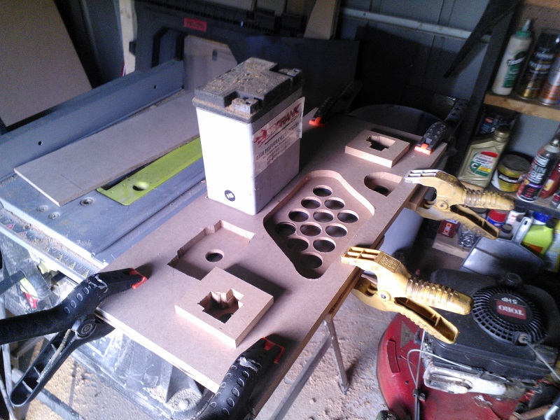

I've done a few.  None of them really 100% right.  :lol
I tend to just use screws instead of bolts that go all the way through.
My cab would not last in public.
Anyways after routing the first couple I switched to sandwiching a top layer of 1/4" and bottom layer of 1/2" MDF.
I like this way much better.  The 1/4" thickness works good and I like the height it puts the joysticks at, but I wouldn't trust 1/4" to hold the joystick bolts.
On my own cab, I used S-plates and routed the back layer down far enough that the face of them was against the top layer.
It doesn't really leave enough wood to get away with just using screws.  I've got 6 screws in each one (drilled extra holes) and it's probably still going to give out someday.

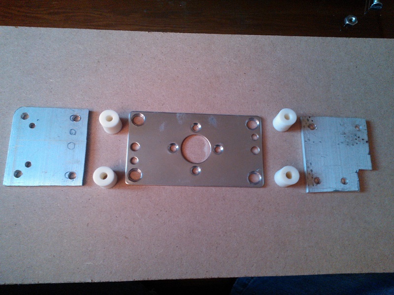

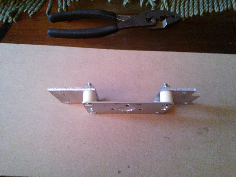

On another CP for someone else, I used the original plate, 1/2" nylon spacers from Lowe's, & some scrap aluminum plate to make my own S bracket.
I like this solution much better than the OEM S bracket.  It feels more solid.  Both because you're bolting into thicker wood and you're using 4 screws (or bolts) instead of 2.   I used a large bit and drill press to taper the mounting holes in the mounting plate so they would sit more flush in it.
My other tip is to cut out the button holes close enough that the button nuts (rings) on the back just barely touch.
It keeps the buttons evenly spaced.   ;D
Button wrenches don't work on the Japanese style buttons, so you need a fair amount of room around the outside edge to get your fingers in there to tighten them.

Bad mouth I forgot to mention , why would this person what a crazy amount of buttons in one area lol . I can see this becoming a serious weak point in the Control panel.
It was for a paraplegic guy who didn't have use of his hands, but could still hit buttons with his pinky knuckle.
He came up with the layout.  The buttons are all grouped together so he can get to them faster.
He said it worked good, although he did ocassionaly hit start or select by accident.  If there is a version 2.0 it will probably have those moved up a bit.
http://forum.arcadecontrols.com/index.php/topic,128941.0.html
Also you should have just routed out about 35-35 mm for each button and this would have at least left a few MIlimeters of thickness in the wood between buttons .
Not sure exactly what you mean here.  The nuts that screw on the back are wider than the top side of the buttons.
I use them as a guide with them just touching, so the amount of wood between the holes would be equal to double the thickness of the nuts.
The diameter of the nuts on the back are 35mm, so it sounds like we're talking about the same amount.
(that would leave 5mm between button holes.)
For the recess behind the buttons though....
A 35mm hole leaves no room around the edge to get your fingers in there to tighten the nut.
So, I'm saying on the backside you need to route it out a little farther around the outer edge of where the button group is so you can get your fingers in there to tighten them.  Maybe you could get in there with a pin and turn the nuts a little at a time.
Start in the middle and work outward when installing the buttons.
