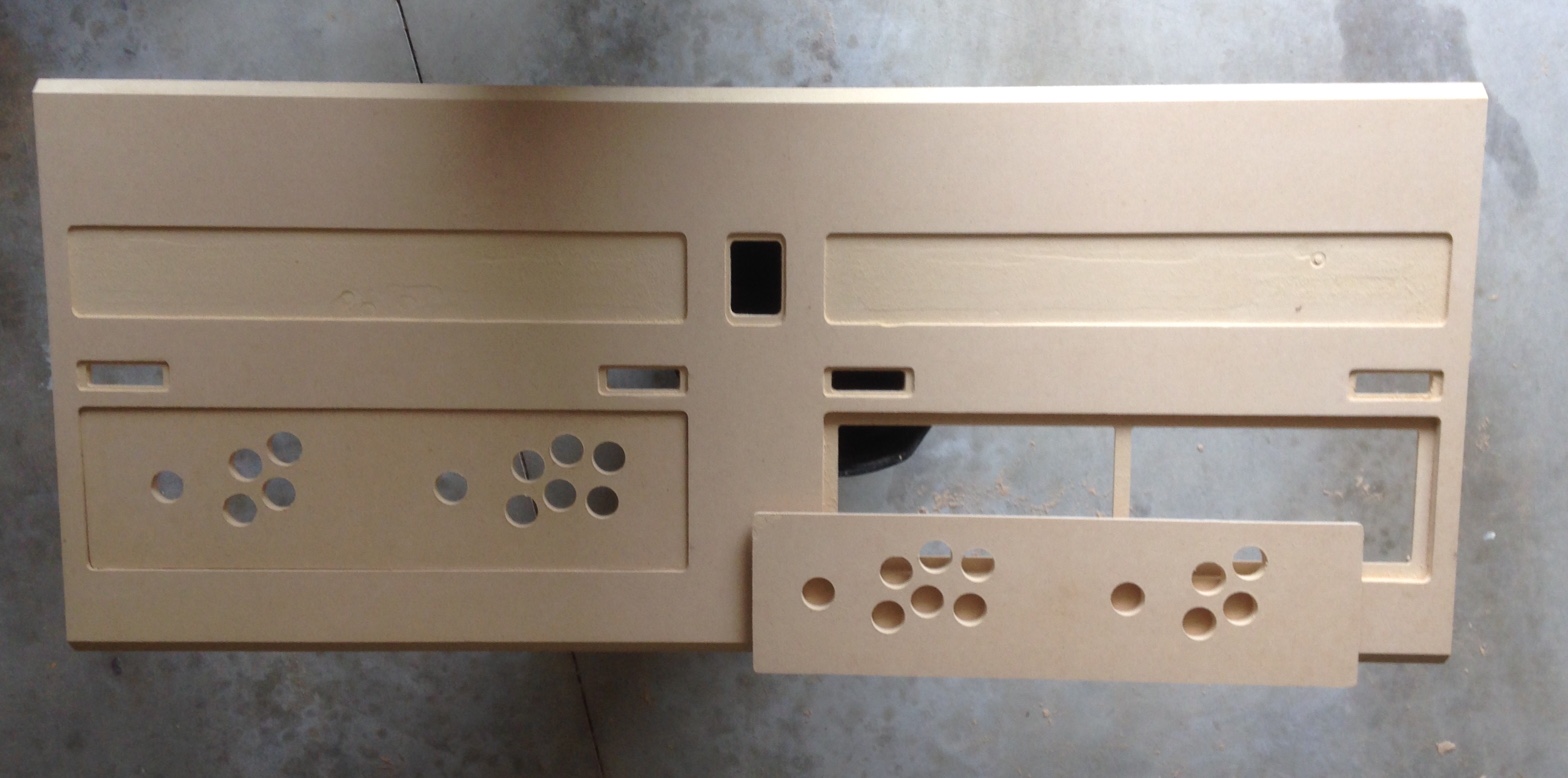

This is the panel.  It is ~19"x46" as shown. The smaller panels pull out mostly because I thought it would be neat.  No real reason, it's completely unnecessarily and overly complicated.  Just like life.  The eagle eyed may notice a few places where my router skills decided to color outside the lines.  I'll fix this with bondo, or in post-production so you all think I did.

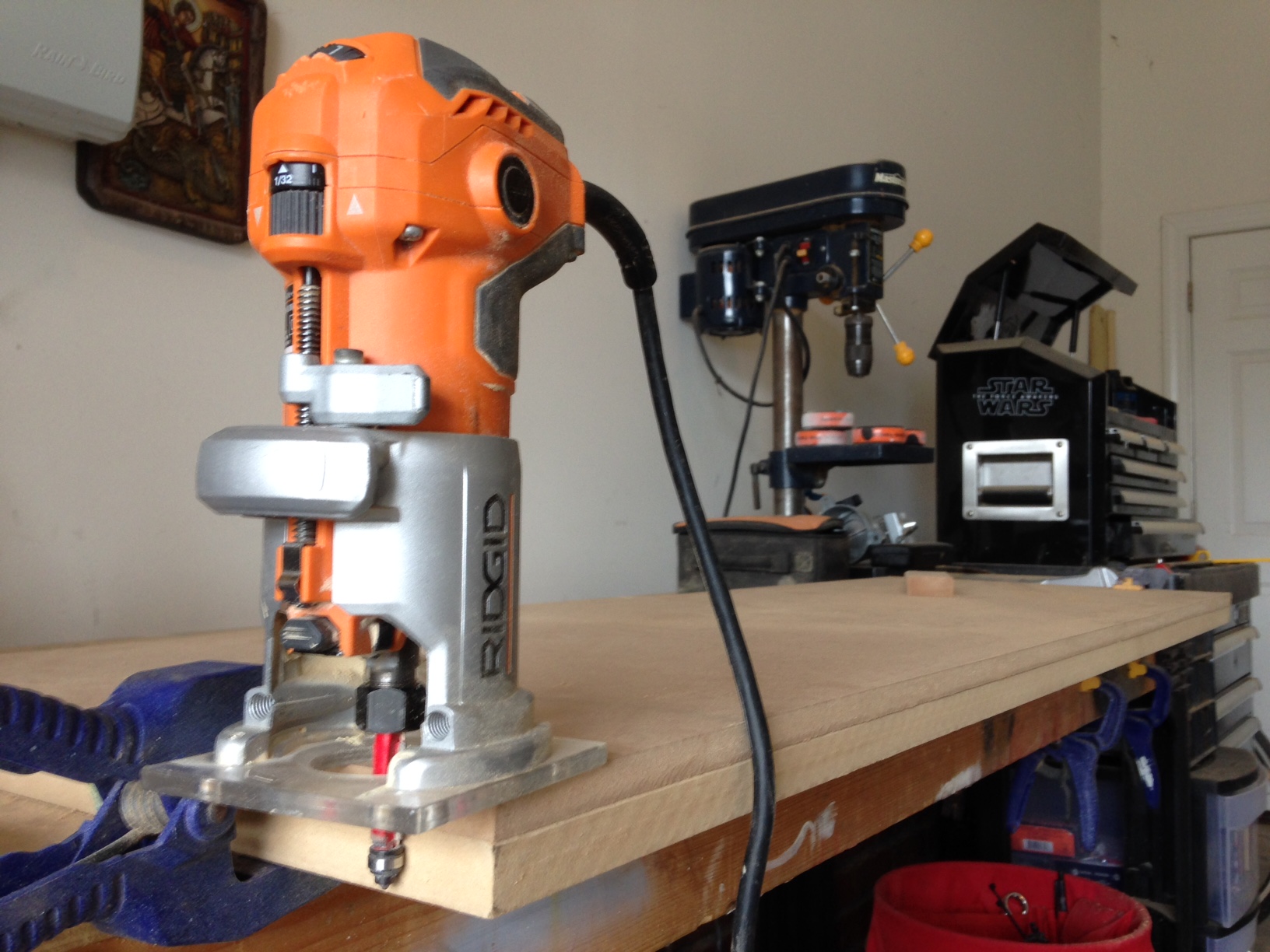

This is a pro-tip.  I call it "refreshing the factory edge."  I don't own a table saw, but even if I did I'd still do this because in my experience most home tools just don't cut straight.  They cut mostly straight.  Even the big box stores only gurantee cuts to be within a 1/16th or sometimes an 1/8th.  So after I make a cut I clamp to a known factory edge that is nice and straight and template bit the edge, thereby refreshing the factory edge.  With bit changes and whatnot it takes me about 3 minutes.  Yes it slows you down, yes it adds up, but I don't do this hobby because I'm in a hurry and it saves me time on the back end because everything fits together soooo much nicer.  Boom, take it or leave it.  YMMV.

How thick are you left with for the remaining ledge of wood that the removable panel piece sits on? I am doing a similar sunken control area so I am really just curious if it flexes or seems real stable still.  Thanks.
The ledge is .2" but there is plenty of room for me to add supports if it becomes an issue.  I'll play it by ear, but thus far its okay.

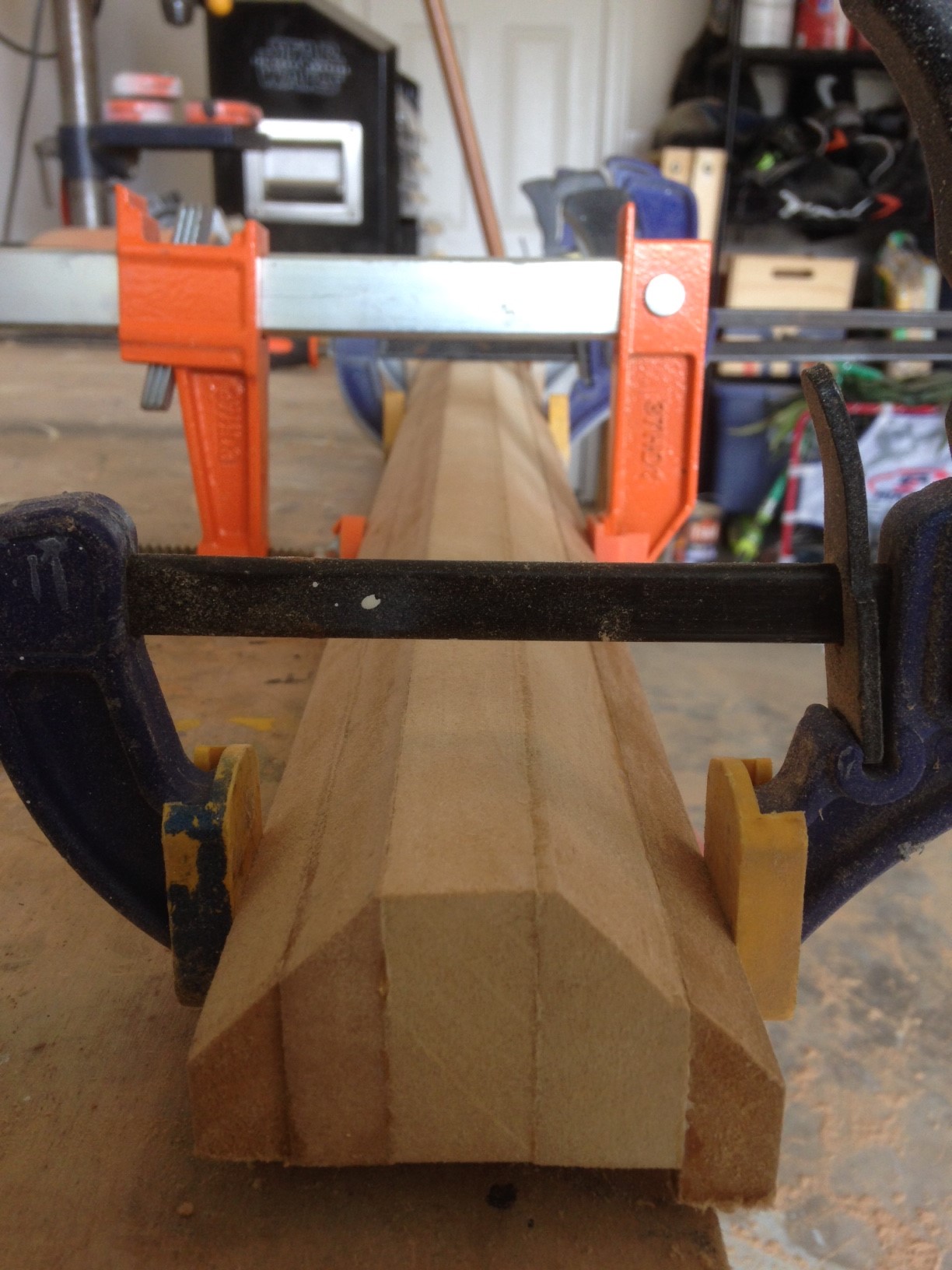

When faced with cutting compound angles I recommend slowly backing away from the tools and taking up knitting instead.  I have also been known to give horrible advice (I think I urged someone on here to commit felony theft yesterday) and rarely take my own advice.  Less talky more picy!
I took quite a few pics as I went incase anyone is silly enough edging like this after my very clear and well worded warning above.  Shown here is where you should stop.  Just stop and save yourself.  It's a single bevel and looks nice.
You kept going didn't you?  Okay, here's the 45o that takes an inch off the edge.  I think this looks pretty sharp too, stop.  Go no further.
Somebody must have a learning disability.  Whatevs.  Draw some lines Mr. Fancy-pants.
Are you happy now?! Do you see what you've done?  Now you're taking latte art-style shots of ---fracking--- MDF.  Better reposition that ruler and check the natural light you doucher.
To be fair, I think it looks good.  It looks like my drawing too, more or less, which is always a plus.
If you're using a cheap compounding miter saw don't bother doing math.  Your cheap ass saw can't do math and the numbers written on it are more or less made up.  My angles ranged between 32o and 47.5o to make this and each one was different.  Be sure and make some extra so you can practice a bit or else just fix it with filler at the end because MDF is basically the most forgiving thing on the planet.
Thus completes the rough work on Blanche Dubois.  Let the finishing work commence!
