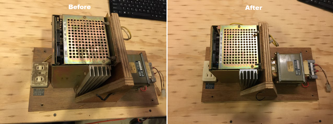

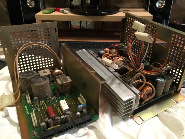

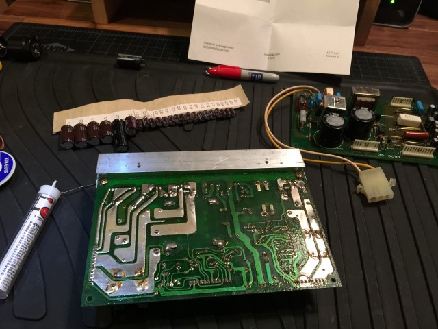

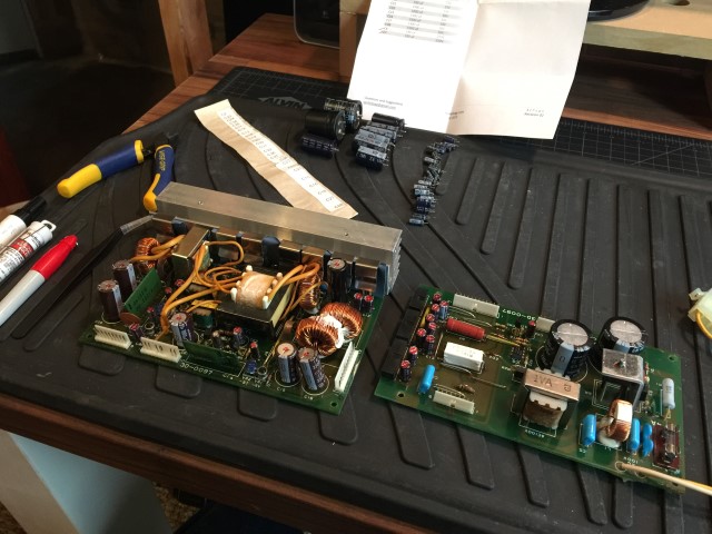

Well if you thought washing a monitor was controversial...how about this?
I'm trying to track down this annoying speaker hum and siren sound on my fugly DK...so I figured what the heck...I'll cap the power supply. I took it out of the machine and cracked it open. (BTW...Nintendo must have hired a gorilla in their power supply factory because I stripped 2 screws trying to get this beyoch open.

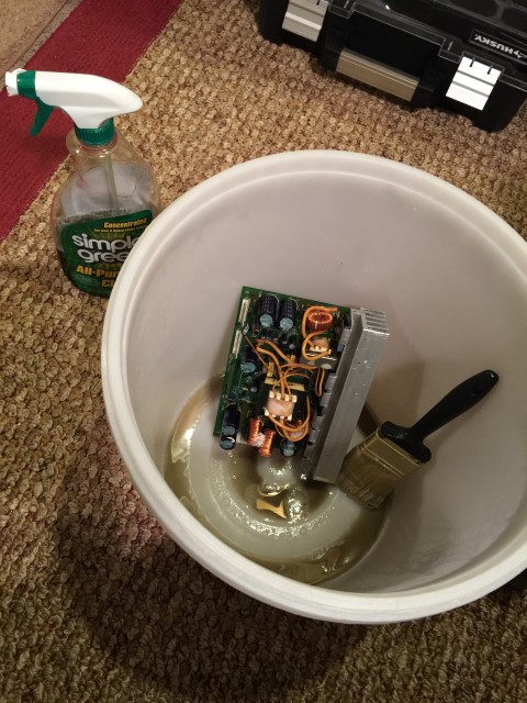

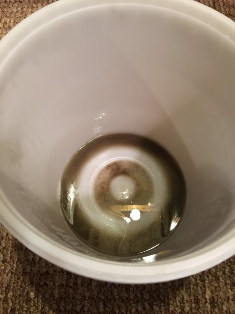

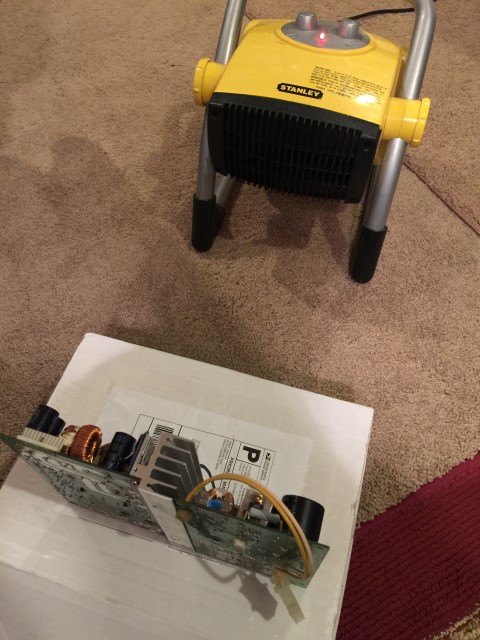

It was filthy so I washed it in simple green of course! (gasp!!!) Used a paint brush to get in the tough spots. Then rinsed it off with a spray bottle with water.
Here is the aftermath of snot that came off the 2 power supply boards
I propped them up in front of my space heater for about 10 minutes. And then let them sit for a few days.

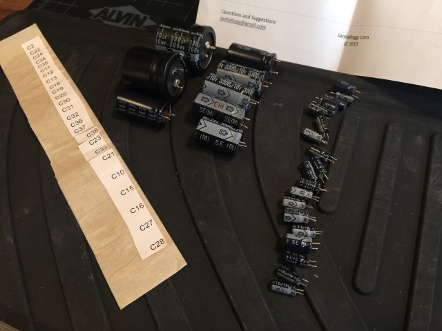

Of course I used another one of Ian Kellogg's shaweet cap kits.
Soldering these caps was was a real PITA. Really huge globs of solder followed by very small tacks of solder. Some spots were dangerously close.
For the record...I'd rather cap 10 CRTs than cap a Nintendo power supply again.

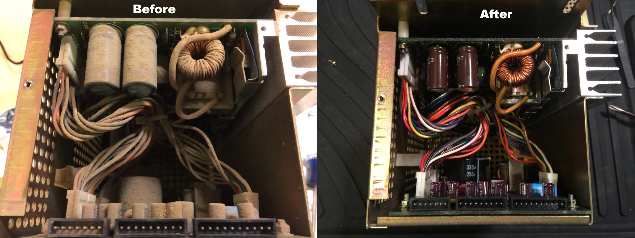

All said and done, I think it was 27 caps inside that monster. Sheesh!
And for those of you that like before and after pics..
I then threw it back into the DK and fired it up. (Not gonna lie...I closed my eyes and flipped the switch with a wooded broom handle. lol)  BUT, no sparks, smoke or fire. YAY!
Next step was to check all the voltages coming off the PS. So I used my crappy Harbor Freight mulitmeter and got 5.1v, 12v, and 24v where appropriate.
Now that the voltages checked out, I threw in the 2-stack DK PCB and fired it up.
The Good news: The game still works and plays fine.
The Bad news: Still have that hum and siren noise. (However, I am giving up on the "hum." I'm told that I need to stop wasting my time as all Nintendo cabs do this....guess I never noticed it)
So I'm back to tracking down the "siren" noise. I'm going to look at the transistors on the PCB again.
« Last Edit: February 23, 2016, 12:16:24 pm by vwalbridge »
