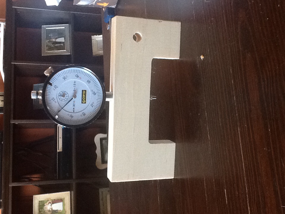

Yvan coded up a quick height gauge so we could be sure the chamfer bit was set at the right height for routing 15 degree angles, then I modified it with a dial indicator and now it will work for all our angled bits.

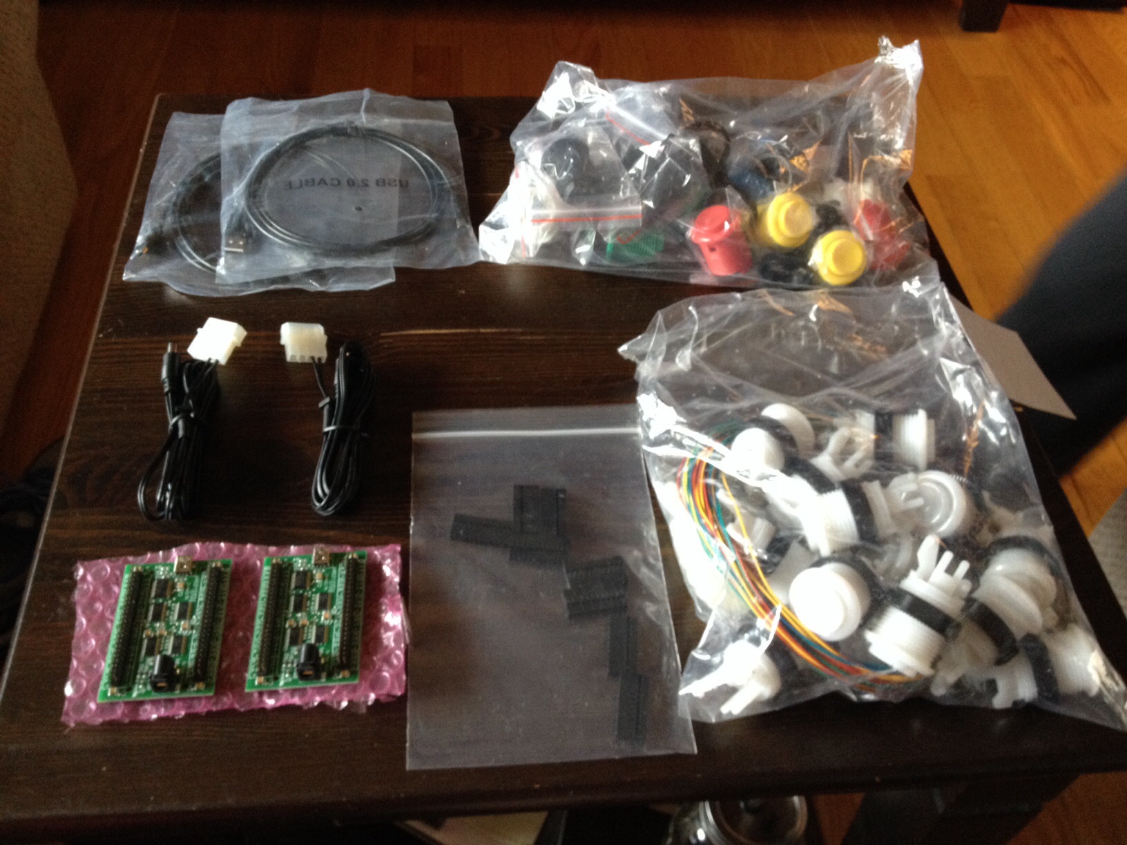

We are making two cabs, so one PacLED each and seven RGB buttons each. The 16 GoldLeafs are for Yvan and are for a different project, but Yvan and I will be doing full reviews of both button types and the PacLED once cab is completed. Fastest shipping ever, two and a half days from London to my hickville postoffice. I was hoping to order a Servo Stick at the same time, but budget didn't allow...next order :cheers:. Thanks Andy  ;)

Lots of Ultimarc goodies.
2 x PacLED 64's
14 x Classic RGB buttons
16 x GoldLeafs (various colours)
We are making two cabs, so one PacLED each and seven RGB buttons each. Yvan and I will be doing full reviews once the cabinets are completed.
I can't wait to test those parts, I've searched about lighted buttons and in my humble opinion the ClassicRGB from Ultimarc is the best one. The buttons are made using a semi-opaque white plastic instead of clear so it makes them look like coloured buttons instead of simply being lighted buttons. And when they're off, they're a nice milky white.
And sorry to be mysterious about that project, but only two other people know about it so far and the CAD is nowhere near complete. Let's just say that the Ultimarc Goldleaf were the only concave buttons available in such a short length. The other options were to use either Sanwa or Seimitsu buttons but I'm old-school and I need my concave buttons if I can have them. The leaf switches are a bonus. ;D
