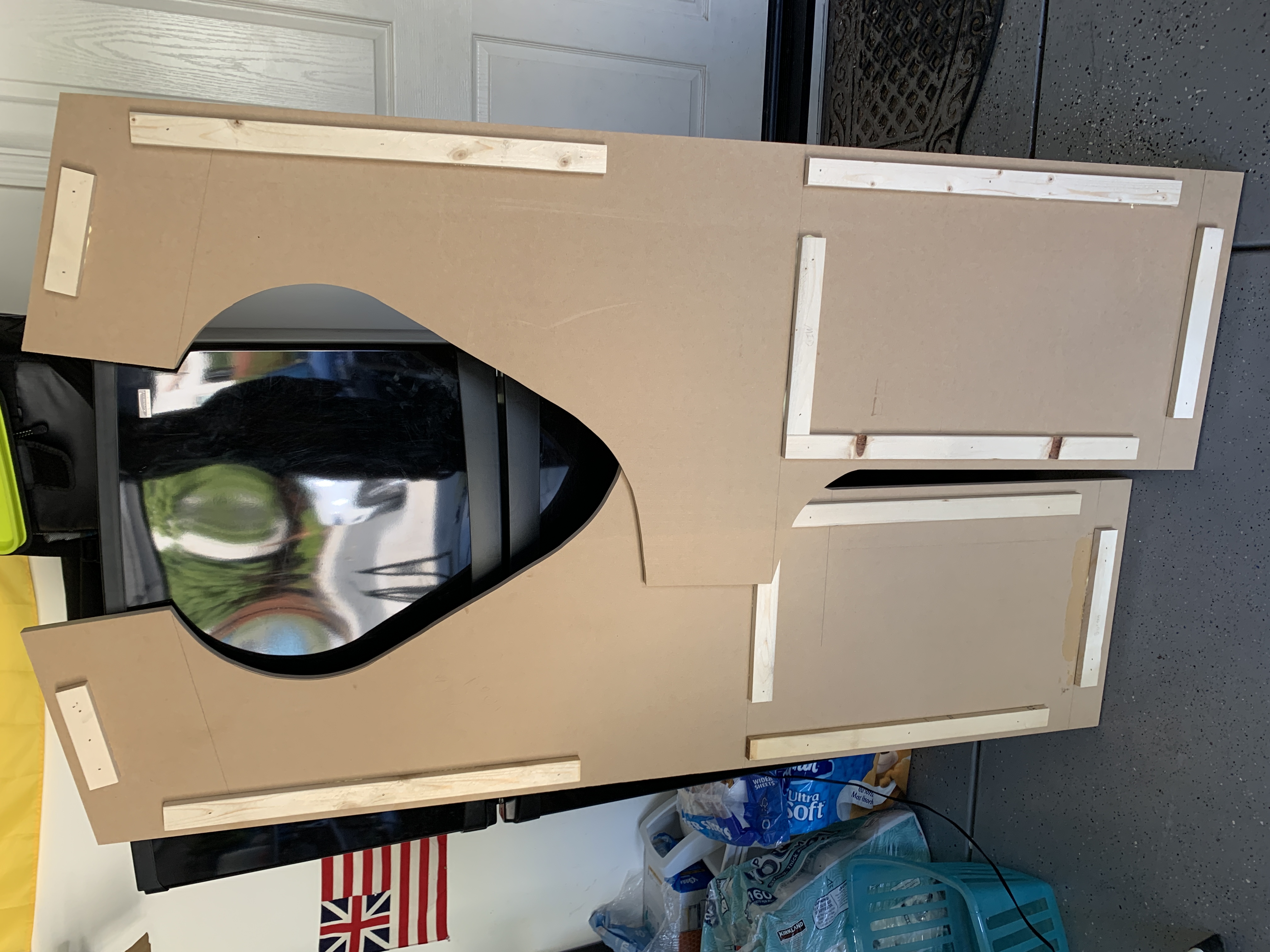

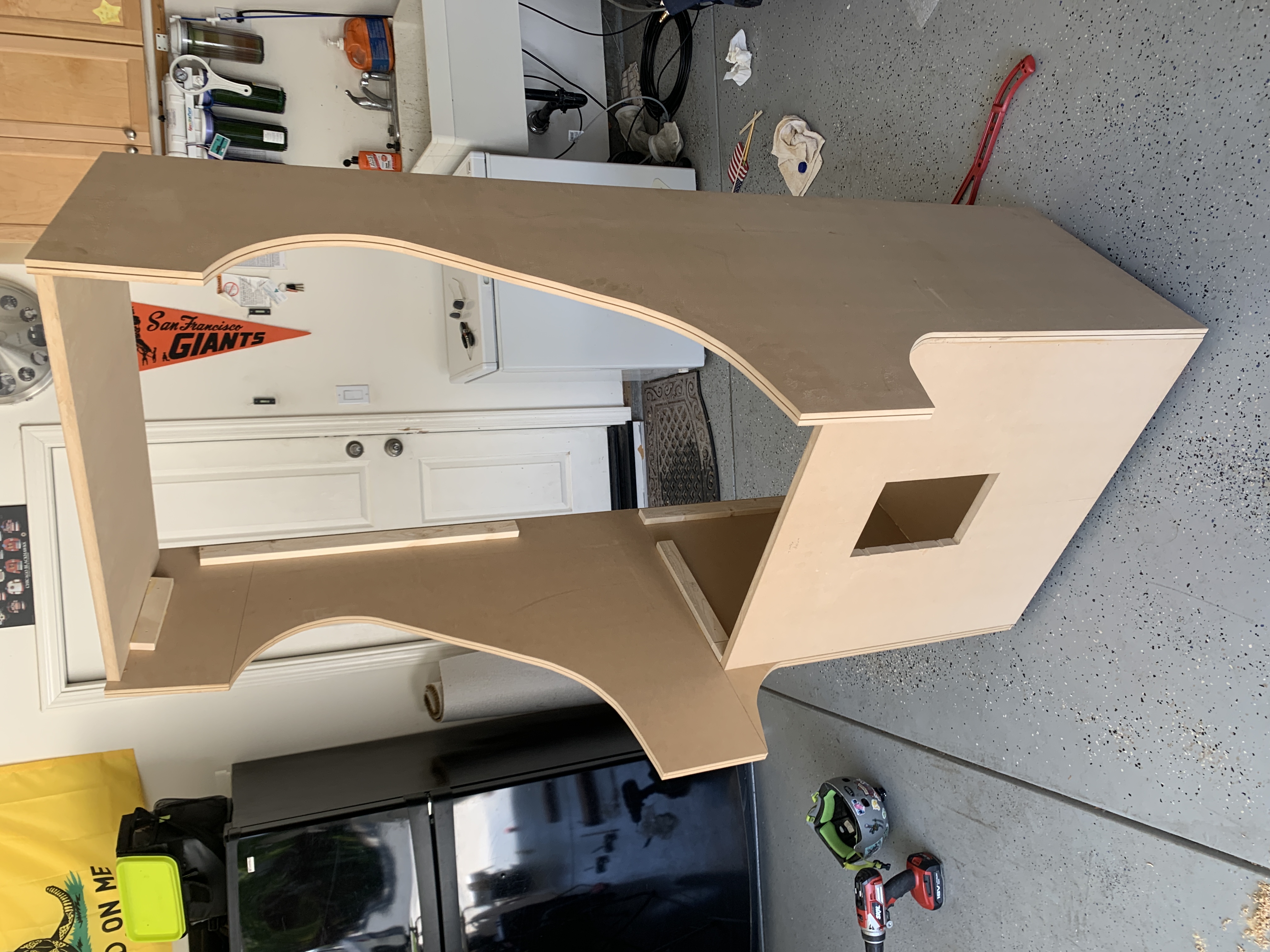

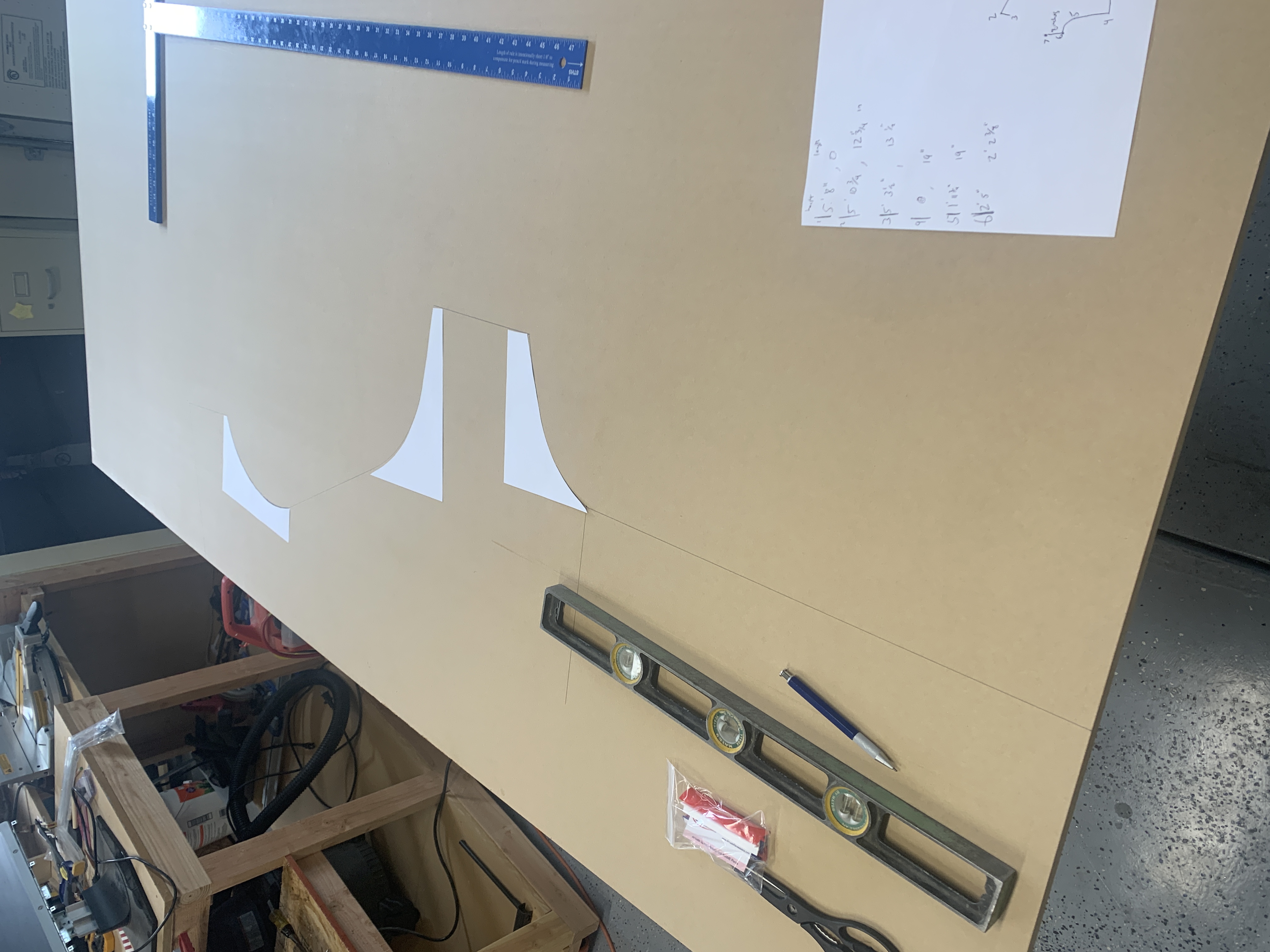

7 years later and we finally have sawdust.  2 kids later, and now they can take care of themselves enough that i can dedicate 3-4 hours each weekend to making progress.
I took my sketchup design and got all the XY coordinates i could, and transferred those to the MDF and marked all the straight lines out.  Then i exported a PDF of the outline, and printed the curved parts so i could trace those.
Then got to work with a jigsaw, which is probably my least favorite tool.  the last time i used one, i borrowed it, and it went terribly, but i think that is becuase i had a back cut blade and the plate was loose, so none of my cuts were perpendicular.  I bought a new jigsaw and 10TPI regular cut blades.  Not terrible, still not great, had so sand some of those curves back into shape.
Then the tried and true method of router with pattern bit.  Nailgun with woodglue and we have battens.
I thought about going the pocket screw route, but MDF and pocket screws dont get along so well.
the interior width is 29 inches across, just enough for a 32 inch monitor.  Ive got the artwork mostly done, this will go in my Wall-e Themed office, where i have multiple posters and pieces, so i figured i'd stay on brand.
sides.

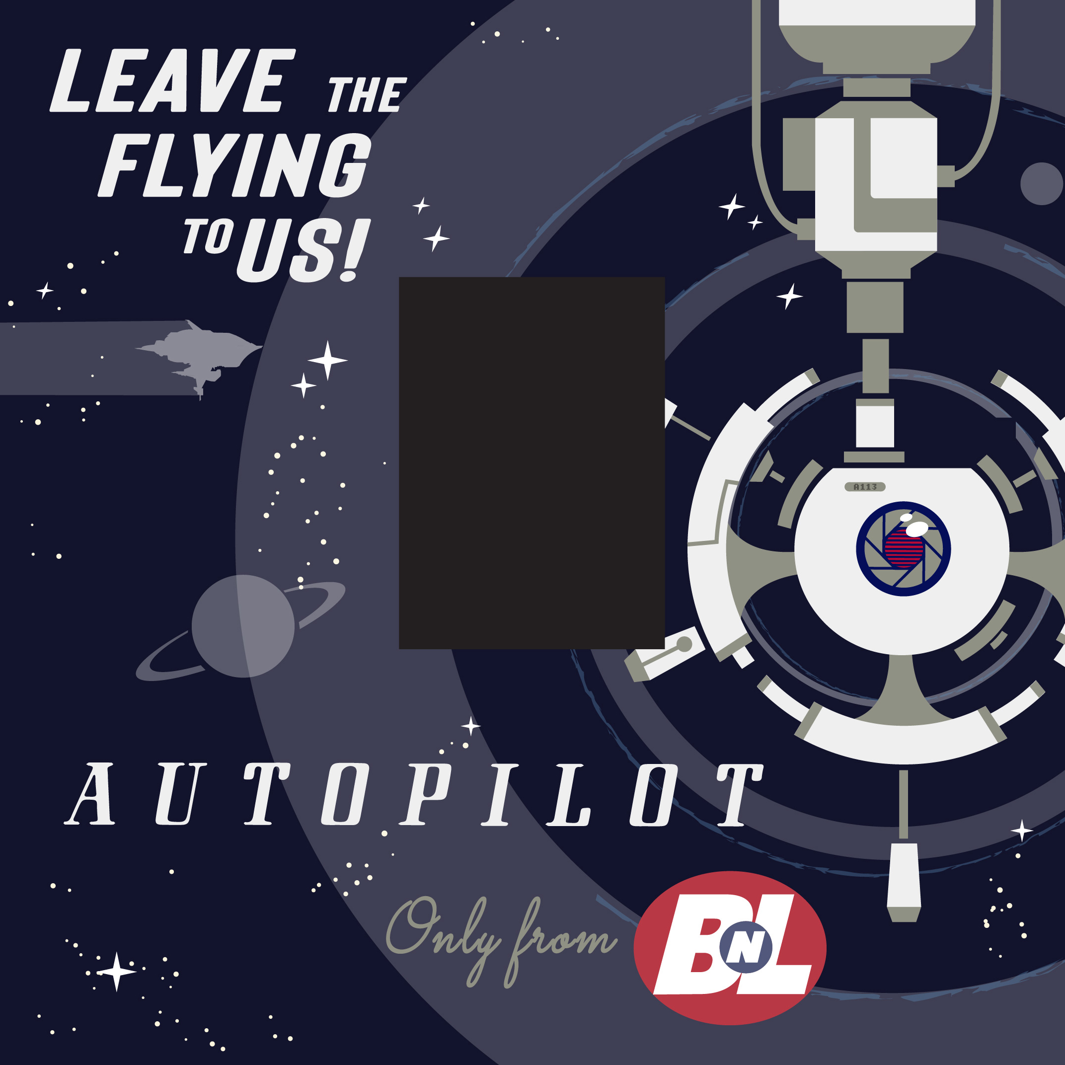

Here's version one of the CP.  not too busy i think.  i originally had a big wall-e and eve in the middle, but made them tiny flying around the axiom.
 pink dot in the middle is the pilot hole for the trackball. - edit: realizing i left off p1, p2, and pause buttons.   will add later.

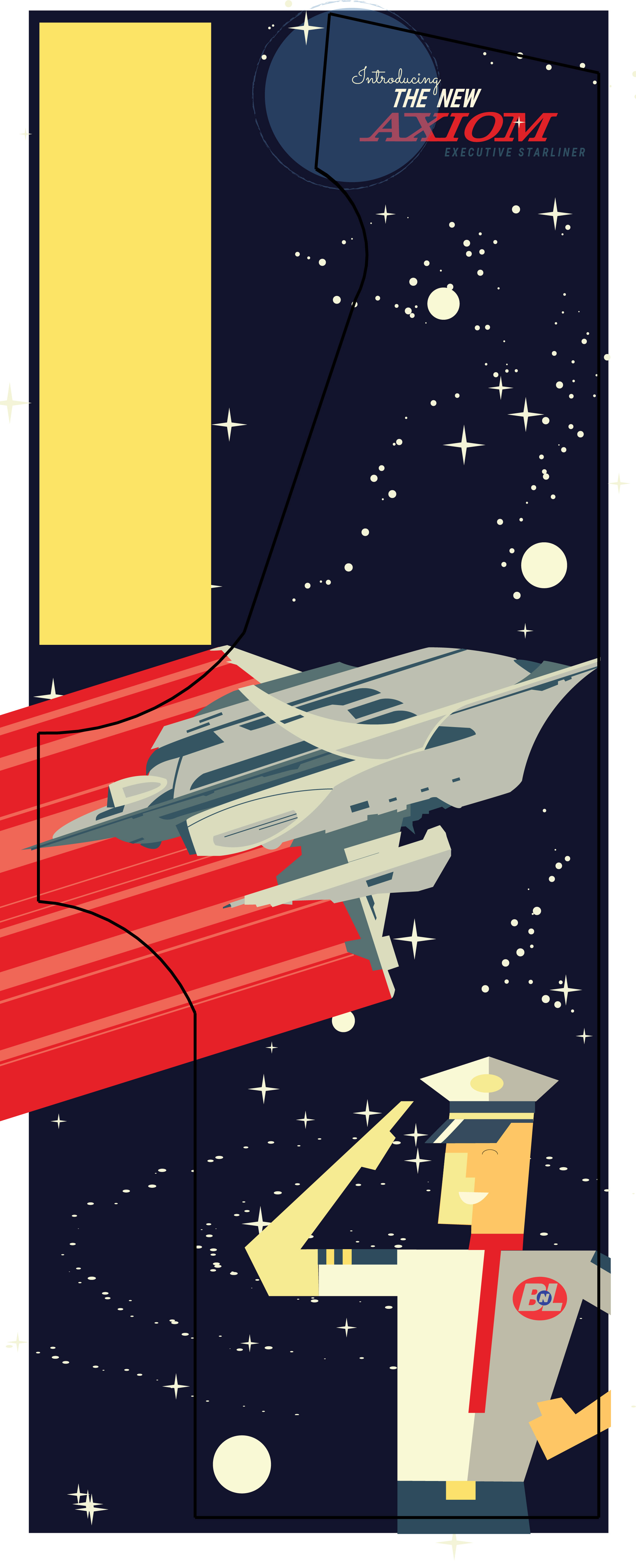

On the front of the cab you have 3 art styles going on which don't match.
Regarding the CP overlay:
- ditch the "axiom arcade" text, you have got that on the marquee
- ditch the joystick surrounds, they clash with the art style
Aaaand ... arcade = room with a bunch of arcade cabinets in it
      axiom arcade = room with a bunch of arcade cabinets in it

Yeah the control panel art doesn't fit with the rest.  Everything else is what I'd call flat 2D clipart with no gradients whereas the control panel has the 3D spaceship and pink and blue nebula colors not found anywhere else.  Also it seem like every section of text is a different font.
  • Posts: 7994
Re: My noob adventure (7 years in the making)
« Reply #15 on: June 01, 2021, 12:16:47 pm »
yeah this really stands out to me as not ideal.  It makes each piece it's own separate thing and taken together it's not a cohesive design, even though it is a cohesive theme.  The side art and front panel look like they "match" (other than the font) but the marquee and CPO look like they are from two different projects.  I think "The Axiom" is a much better name than "Axiom Arcade" for the reasons yamatetsu stated and I'd get rid of Eve/WALL-e altogether.  People who know, will know and to everyone else it will look like a really cool space themed arcade cabinet.

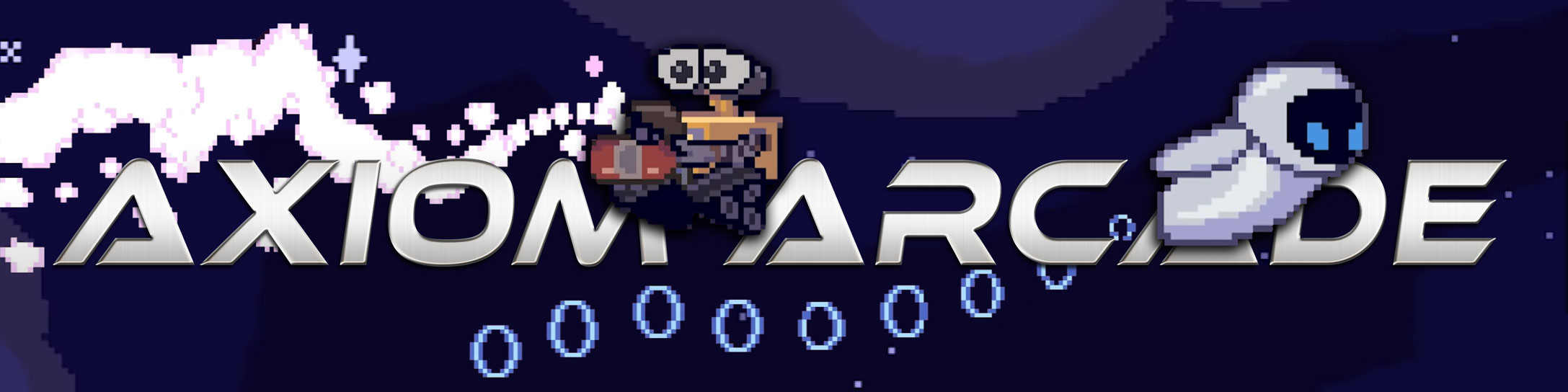

Redid the coin door to use the same fonts as the sides
redid the marquee to match the theme better.

Much better. Now, of course, the nebula will stand out even more as being the one element that doesn't fit style wise.
Perhaps you could do a starfield like on the sides, put the Axiom from the sides without the red trailing stuff somewhere inside. Take the ringed planet from the coin door, make it the size of the trackball.
Maybe left side -> Axiom - middle -> ringed planet - right corner -> hint of a certain green and blue planet ?

I like the nebula too, but there is a disconnect in color continuity between the CP and the rest as a result it seems.
Maybe integrate the cooler spectrum stuff from the nebula into small detail on the other panels to tie it together?

Re: My noob adventure (7 years in the making- all done!)
« Reply #28 on: July 20, 2021, 03:01:38 am »
Looks great!   ;D
Maybe people won't notice that left-handed salute on the left side art.   >:D   :embarassed:   :lol
« Reply #30 on: August 04, 2021, 12:14:27 am »
I never would have till you pointed it out now I can't unsee it.
