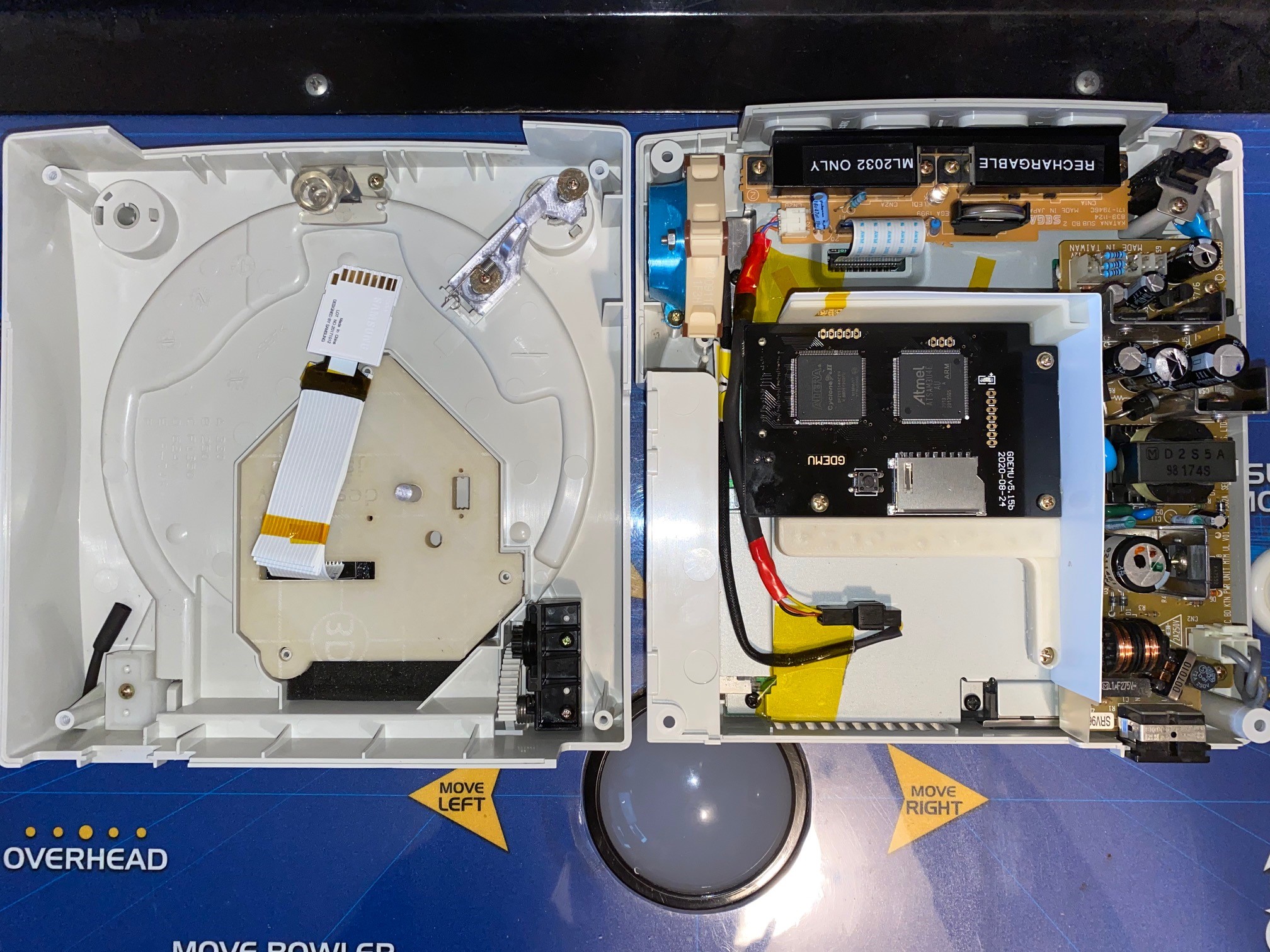

So, from some play testing this weekend, everything is running smoothly. I haven't run into any issues. Just need to finish downloading my new romset and try it on a 256 card.
Here is my other cleanup on the system -
  • Already added 3 1k resistors to reduce the draw, as outlined in this tutorial. I know there are a few different ways to address this one, but I have plenty of 1Ks  on hand.
  • Still need to replace the CMOS battery. Have a rechargable ML2032 and a button cell holder I am going to put in.
  • Going to finish printing 3d insert. I currenlt have the hollow one in that can hold spare SD cards, but since I am going to go for everything on one card, I am going to swap to the other style.
  • I have a noctua fan and will be doing the fan mod to make it as silent running as possible.
Regarding sports games, that is probably a good thing to avoid if you have no attachment. I forgot this before, but was rudely reminded yesterday that the DC is very cruel when it comes to it's VMU memory usage and the sports games are among the worst. I played a little NFL 2K1, it wanted 134 blocks of my VMU, which only holds 200 blocks.  :embarassed:

dreamcast is a go.
got a little side tracked when my psu and mb blew on my main rig.
it's cheap to replace and even upgrade when you run an old i5. :)
replaced the rechargeable battery today.
put in the resistors. i soldered them to the posts didn't like just forcing them in there.
also spent a minute playing metal slug 6.
gonna leave the dreamcast plugged in and on over night to give the battery a good charge.

I am gonna reprint the plastics on the GD drive insert plastic, I was mostly dialing in my printer when I made the original prints, so it wasn't up to snuff.
Noctua mod is fine, but it needs a 10k resistor between the 5v and tach lines. (It uses the tach line to determine if the fan is running, if it isn't, the system shuts down). In this picture, I added the resistor in the line and made a little adaptor cable, but didn't feel good about the look, so I did go back and just changed the header pins and added the 10k resistor on the DC board itself. Anyway, it works great. I tested the sound difference by turning the DC on side by side with my other stock DC. Night and day difference in volume.
Battery was super easy with the little solder-on battery holder, I just needed to add a reminder for future me that it is a rechargeable battery, so I put a label inside as well.
And for some reason the SD extender doesn't work, so I am buying a new one. I used it for years with my old 3d printer, probably just went through too much abuse.
