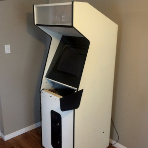

Hi Everyone. First off I would like to say that I really appreciate a spot like this to document the progress of a project. Looking at completed projects is incredibly motivating.
Like most people I have unfinished projects that seem to disappear for years on end. This arcade machine was one of them but I am now taking a run at finishing it up nicely. It may even find a spot on the main floor of the house if it turns out well.
goals So my goal with the project when I first started was to build a mame machine on a budget. I traded for most of the parts and had very little into it. Fast forward 8ish years and a lot has changed including my goals for the machine. I now want to be able to play most games and have a great addition to my family room that will entertain myself as well as guests. I still want to play most mame games but I plan on using Hyperspin as my frontend. I am hoping that this is a first step project that allows me to learn about the inner workings of these emulation cabinets and gives me the base knowledge to build a virtual pinball table to compliment it in a year or so.
the first makeover (8ish years ago) The cab was a converted Street Fighter 2 cab that was missing all its artwork and was beat up really bad. I can't remember what game it was converted from. I went with the street fighter button combo (layout copied from the games control panel) because I had the buttons and the joystick and I did love throwing quarters at this game as a kid. I also came across a 3" happ trackball and incorporated it into the replacement control panel.
So here it is in it's as I pulled it from the depths of project hell. I may have dusted it off a bit for the pics  ;D
It needs a lot of work as it looks like the first round of paint and such don't meet my standards now but it is a start.  Thanks for reading along.

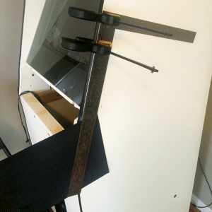

I am planning to try something I have not seen on here before and that is an edge lit marquee. I have taken the original marquee retainer (which was sandblasted and repainted a long time ago) and applied a strip of white LED lights to it with the adhesive backing. It is roughly the same width of the two 1/8" pieces of plexi used in the marquee area.
I then notched the bottom of the two pieces of plexi using the router. I notched it just enough that the plexi still sits on the retainer and misses sitting on the strip of LEDs. I imagine it would have been fine sitting directly on them because they have a rubber coating over them but I didn't know if that would effect them long term.
One thing that has worried me from the beginning of owning this cab was the way the marquee retainer was mounted.  It was just screwed into the wood and those four screws were the only thing holding up the plexi and the retainer. I have already needed to go up a screw size once to keep the retainer good and tight so I found threaded inserts with a flange on the top that could replace the large screw holes and let me take the marquee retainer on and off as many times as I needed.
The end result is nice and clean. More to come on the marquee area in the near future.

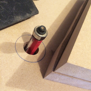

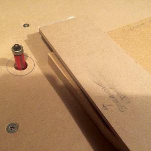

I missed winning a nice router table on a local auction site the other day and I was a bit bummed so I decided to make my own. It doesn't raise and lower and do all those fancy things that they can do but for just flush trimming it seems to work great so far.
After a few cuts it was evident that I needed a dust collector. Luckily I had what I needed to rig that up too. I was surprised how much fun working though these little problems can be. At the end of the day my little makeshift router table was my favorite thing that I had made.  :lol

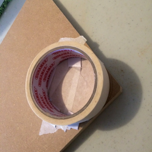

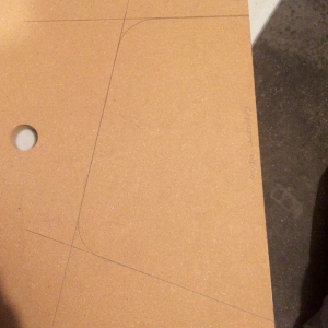

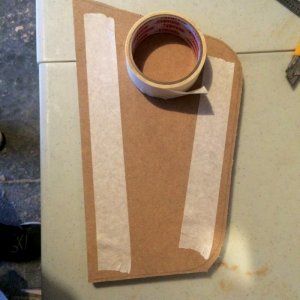

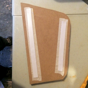

Since I had a router table sorted it was time to get started on the control panel base. Knowing what I know now I would have never mangled this cab and I would have started from scratch. That being said I cannot change the mistakes 10 years ago me made and I can just make the best of the situation. I started out with good old cardboard sheet to get my sides. I copied the lines and angles from the side of the cab and made sure to have a control panel angle that is between 2 and 7 degrees as suggested way earlier in the post.
I then cut it out and taped it to the side of the cab to see if I liked the profile.
Once I liked the cardboard shape I transferred it to 3/4" MDF and rough cut it out with a jigsaw.
Using my router, some double sided tape and a straight piece of scrap wood, I flush trimmed all the straight edges. After I had the straight edges done, I found something round that fit the profile to help make the corners perfect. I double sided taped that to the MDF and used the flush trim bit to follow the curve and make nice clean corners.
Once I had my "master" shape cut out I gave it a quick sanding just to make sure it was right on the money and I was then ready to make copies for the "ribs" of the structure. It's common knowledge that double sided tape is the best way to go about making a copy of a master or a template but I found a great tip online about using double sided tape with masking tape to help with the super stickiness of the double sided tape as well as the residue that it can potentially leave on your wood. So here it is... I took wide masking tape and I put it in the same area on both the piece to be cut as well as the master template piece (wipe your pieces clean of any dust). I then applied the double sided tape on to the masking tape on the piece to be cut. Then I stuck down the master template to the piece to be cut. The double sided tape was then stuck to masking tape on both pieces. This did make getting the pieces apart WAY easier since the tack on the masking tape is much lower than the double sided tape. An added bonus was that sometimes if they came apart well enough you could get two or three uses out of the double sided tape by carefully peeling the masking tape off the one side.
step 1: masking tape on both pieces (roughly in the same place)
step 2: put on the double sided tape and stick both pieces together
step 3: make perfect copies
...more to come...

« Reply #26 on: May 05, 2016, 10:25:57 am »
I like your style of work n3wt0n. Your ingenuity is great.  :applaud: I've used a roll of tape a time or 2 for a rounded contour.  ;)

...continuing on with the "ribs" for the base...
Once I had 6 identical copies made of the ribs I needed to make end pieces that were 3/16 of an inch larger than the other ribs. I didn't have the ability to swap out the router bit bearing to make this adjustment so I used thin pinstripe masking tape I have had sitting around for years. You can probably get it at any paint store. I can't remember the original reason I have it but it sure did come in handy here.
I wrapped the tape around the bearing until I had the difference I needed, making sure I wrapped it very tightly so it didn't ripple or crease. I took a small piece of wood that was the thickness that I needed and slipped that under the taped bearing and against the cutter on the router bit to to gauge if I had put on enough tape or not. In the end it actually took very little time to do and was quicker and more accurate for my needs than changing out the bearing.
Tightly wrap the bearing. I wouldn't go much further than this. The tape was a bit wobbly.
After trimming the one edge. Nice and clean.
Progress so far. I think the ends are going to be a nice fit.
... to be continued...

Carrying on with the ribs. I needed to remove a specific section of each rib. I (again) used double sided tape, straight pieces of wood and the flush trim bit in the router to make the shape. Then I just copied it for the other side.
 After carefully matching the position of each rib on each side I drilled some holes and added some threaded inserts for mounting.
Once mounting was I screwed and glued the end pieces together and added a brace across the bottom edge using pocket holes.
I also added a "front" that will eventually have the panel top hinges attached to it.
The base frame is almost complete.

« Reply #32 on: May 15, 2016, 08:56:03 pm »
I have my first issue with the build. I was hoping to wrap the control panel base with a 1/8" panel that I bought at Home Depot but it doesn't want to bend and just breaks. I thought it may need to have some kerfing done to help it bend but even with that it just snaps off. Any suggestions for materials I could bend in this situation? Ideally it would need to be 1/8" but could be less. I am going to head to Home Depot to see if I can find something that will work tomorrow but any suggestions are more than welcome. Here are pics of my kerfing attempt.
