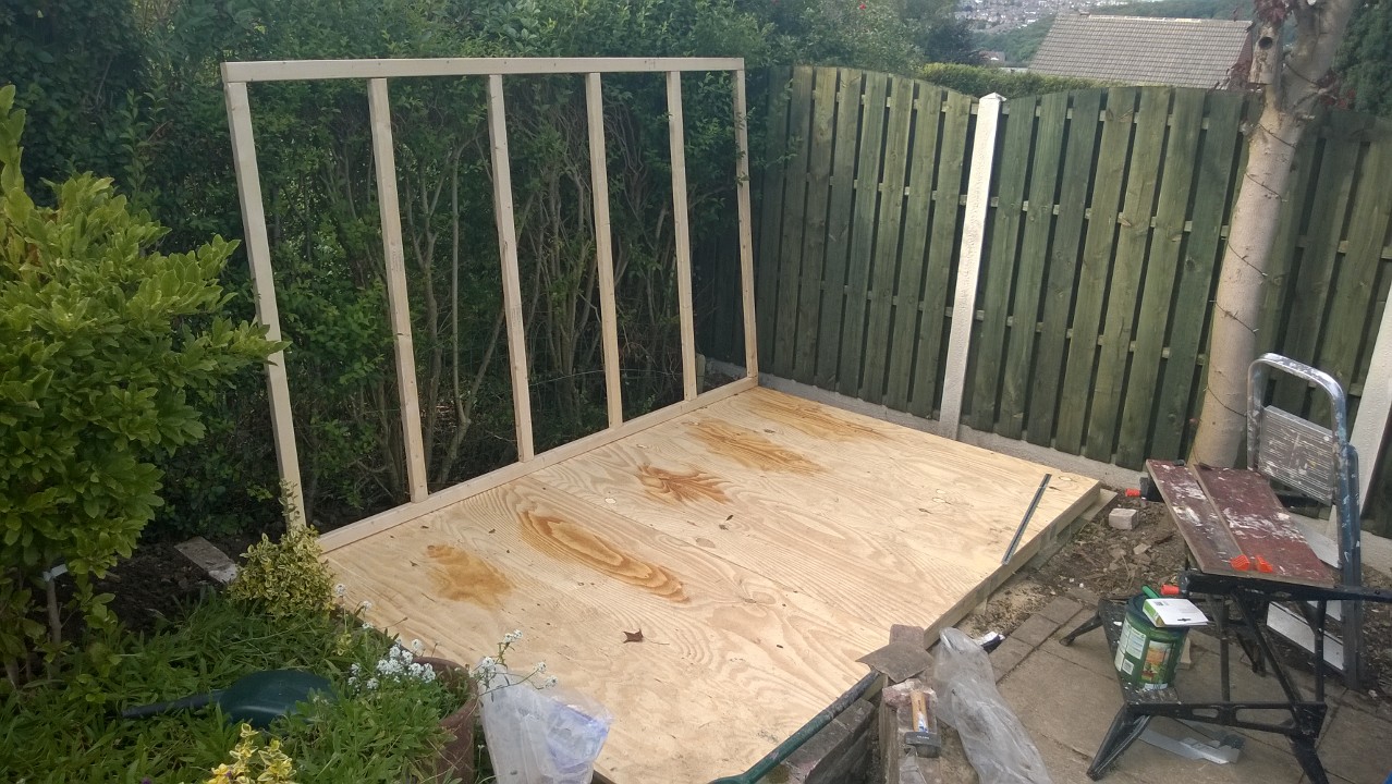

Thought I would post progress for my new shed project, in case anyone else is interested. The current shed may not last another winter, and I need a new home for Insert Coffee. The family patience has finally run out with me using the conservatory for hobbies.
I don't really want to keep my electronics in the shed as it stands...

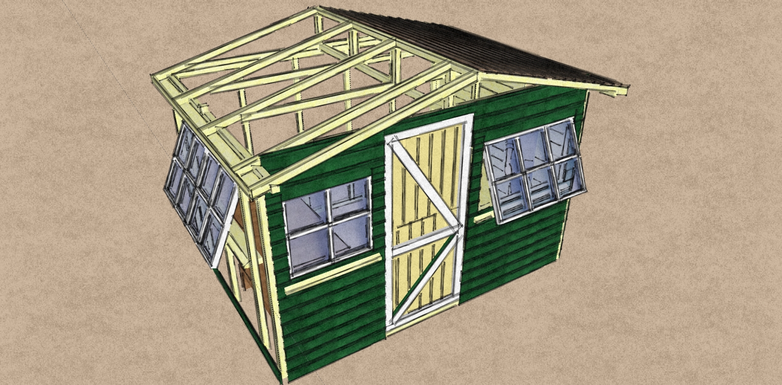

So I came up with a design for a new one, lots of windows, more useable headroom and if I put the door on the other side, I get a bit more room for floor space...
My old shed has hosted it's final project - building windows for the new one...
It's surprising how much a car full of wood balanced near your head focuses your attention on driving gently  :o
The cost of the timber was my father's day present, so I finally drove up to the timber yard. It took 2 trips. this was the 1st.
Here is the base finished. It's treated wood and I discovered joist hangers to help me join (most) of them together. They weren't quite the fit I needed, but that's what Dremmels are for.  :applaud:
And floored with some 18mm 'shuttering ply' = cheaper than normal ply. I think its used to board up buildings when windows get broken etc.
The new flagstones represent the extra space I got by moving closer to the hedge and the new fence at the back.
And this is how far I am at the moment. Just finished the 1st wall frame. I'm going to put tongue and groove panelling on it next and paint it (It will be easier to do now than  when it's next to the hedge)
And now I have my 1st worry. Any sort of banging or hammering on the base seems to be amplified, like an acoustic guitar. It could be a problem for me when I'm doing woodwork in there - mainly hand tools which often means hammering and chopping (I use it mainly after the kids have gone to bed, so want to keep noise down). I'm wondering if I should take steps now before I start fixing the walls on. Any ideas? Maybe some sand around the gap under the base (I put it on flagstone 'piers' so it doesn't touch the ground). Or maybe something under the ply to deaden the sound?

Looks good man.  I always enjoy a good shed.  Word of warning though... unless your climate is very moderate I wouldn't put any electronics in there.  While technically they can handle a range of temperatures, they preserve best if you keep them at room temperature.  Did you hammer the plywood in place or nail it?  If you nailed it take it up, throw some talcum powder on the beams and screw it down with deck screws.  It'll hinder vibration and make things a bit quieter.  That being said your walls are there to absorb vibration... you'll need to put some insulation on the walls.  I'm not familiar with that construction technique... why are the 2x4's for the stud walls assembled on their side?

Yeah the problem with pre-built sheds though is they cut corners.  I wouldn't be copying them if I could help it.  The lattice sheathing will help with stability so it might not be that much of an issue, but around these parts we nail the studs the other way around, 16 inches on center.
The main reason for that is it gives your shed much more stability when horizontal stress is applied (wind, someone/thing leaning on a wall, ect).  It has a couple of other benefits as well, including natural insulation.  If you do it the other way around you've got 3 1/2 inches of air between your inner and outer wall.  Believe it or not that's a pretty decent R value... at least for a shed anyway.  Of course if you choose to add additional insulation that cavity gives you a place to put it as well.

Ahhh, I see what you mean now. It was a deliberate choice. It's fairly sheltered horizontally - I wanted the extra strength vertically - I'm possibly going to put a 'green roof' on there at a later date (gravel/soil/plants etc) which will be heavy. Don't plan on insulating it - the absence of draughts through holes will feel like luxury after my old one.

I don't think this design adds any vertical strength.  It just subtracts horizontal strength.
What's the square footage?  Are there any permit issues regarding moving it and/or being that close to the fence?  Around here the max unpermitted is 120sqft and I think it's a 6' documented clearance from all property lines.  We can get away with rebuilding old grandfathered structures but only if the structure remains intact during the building process.  As a result you see a lot of falling down sheds/barns still there just in case anyone ever wants to rebuild the thing later on in a place that current code will not permit.
Yeah I wasn't going to say anything, but since someone else already has.
2x4's on their own tend bend when a load is put on them.  Turning them the more traditional way puts this bow towards the front and back of the wall where you want it, because with cross-bracing you can keep them from bowing and couple that with the over-lapping stud walls at the corner and you've made a very sturdy set of walls where all the load forces are pushing against each other.  The way you've got it the bend force is on the inside and outside of the wall where you can't re-enforce.  It's going to want to bow/break in the center of the wall... or just tip over.  So if anything it's weaker to vertical load... it'll just break on the horizontal.
Or at least that's how it appears just by looking at what you've posted thus far.  That's why I asked about the construction technique.

I noticed how the walls were framed too. I recognize that it is weaker than a traditional wall frame but for a shed I don't think it will matter much.
In any case it will be hot in there in the summer, reduced by shade etc.

Did anyone else notice those 2x4s are rotated funny?

Looks like EightBySix lives in the UK, so other than the absents of sun and constant drizzle, I doubt he needs to worry about snowfall.
Not advocating it by any means, but his twisted 2 x 4's and tongue and groove paneling is still miles ahead of the 1 x 3's on 24" center, chipboard covered shitters from Home Depot.
If you only framed the one side, then start over and use the lumber from the one wall to frame out windows and doors. If all the walls are up, don't lose a seconds sleep, finish it and enjoy (I don't think they have codes in the UK).

Well - they're my 2x4s and I'll twist them however I want  ;D
Lots of interesting stuff - I've learned  lot from reading them. At the end of the day - this is just a shed rather than an outbuilding. It's predecessor was made using 1x1 pieces of wood, stapled together and it came with the house 14 years ago so I think I'll be fine.
It's way better than what I could buy with the same budget, and I get a buzz out of making it myself.

So here is a pic of more incorrect studwork. More to follow tomorrow.
This is what I meant by a green roof by the way. A project for the spring maybe.
P.S. they are 2x3s anyway  :P

Well, rain stopped play today. I folded the thing up so the painted side was upwards and waited for a break in the weather.
When it came, I temporarily screwed the sides together and put a plastic sheet over the top. It was nice to see it taking shape, but less nice to see that I had mode the base too big  :banghead:
I'll fix that tomorrow, the forecast is dry, and try and get a proper roof on it.
For the record, I prefer hand tools over power tools - I find it relaxing. However... I need lights and the odd power tool / radio / kettle so...

One suggestion I can make on your shed is that you bore a couple of 1/2" holes in each square section of the floor beams, around the exposed area of the beams.
I ended up raising the whole base an inch or so off the ground with quartered paving stones for that very reason, and to keep it from any puddles etc. Putting some sort of wire guard makes sense. It would also help prevent leaves and other crud going underneath - the main cause as it turned out, of the last sheds demise, with a rotten floor.
