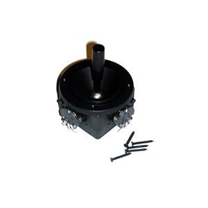

In addition to the board, you'll need a joystick like this or this or this or this or this . . .

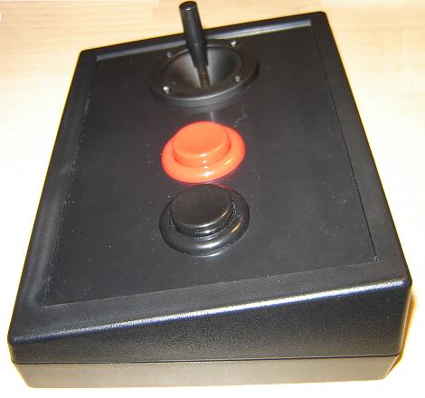

With all the pieces in place, let the build begin.

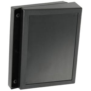

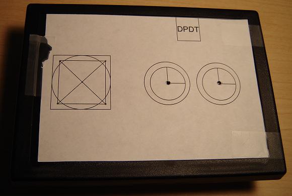

First, a template that fits into the recessed area on the project box.
The DPDT switch will be mounted on the back face of the project box.
Not sure if I'll go with red or black Goldleaf buttons so I test-fitted one of each along with the stick.
All joystick wires and button grounds soldered and tested good.
Found out later that the buttons and analog need separate grounds -- had to clip off the 0.110" daisy chain.  :lol

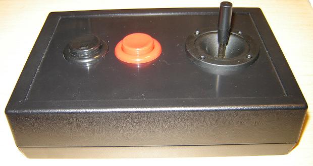

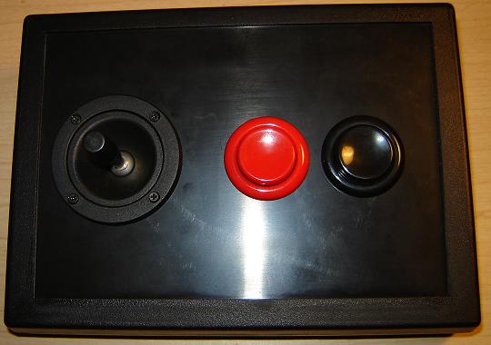

Next, I tried to polish out the squiggle next to the red button.
:cry: High speed on Dremel + my derpy "I'll learn how to polish plastic on the work piece" decision = several even worse marks.   :cry:
Time for Plan B -- woodgrain vinyl for a bit of Atari 2600 vibe. :lol
The thin gap in the lower right corner is almost impossible to see in normal lighting.

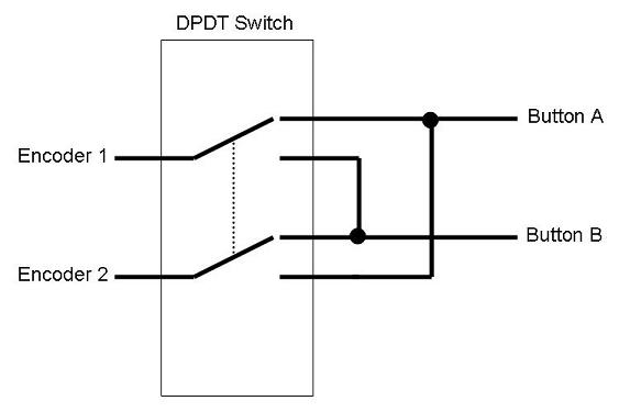

The reason this stick will have a DPDT switch is that Apple ][ games like Lode Runner were written for the Kraft Premium Joystick.
The red button is button 1 and the black one is button 2.
In Lode Runner, the red button drills on your right and black drills on your left -- the opposite of standard arcade button order.  :dizzy:
The DPDT switch changes which button is connected to which encoder input.
In the up position, Button A connects to Input 1 and Button B connects to Input 2.
Throw the switch and they change places.  :D

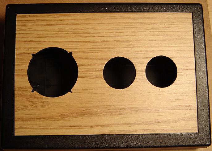

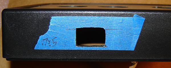

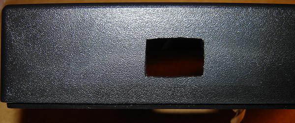

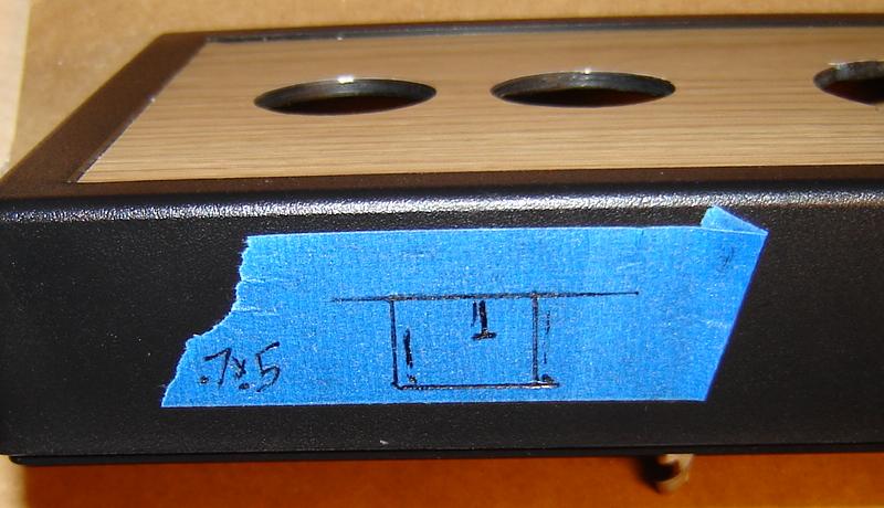

The first step is to mark where to mount the switch.
Blue painters tape makes it easier to see the boundaries of the 0.7" x 0.5" mount hole.
The mount hole outline is horizontally centered between the buttons and vertically centered on the upper back face of the case.
After chain drilling with a very small bit near the perimeter, I used an X-Acto knife to carefully shave the plastic down to the outline on the tape.

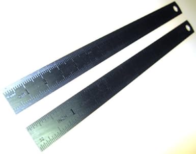

Protip: Use a tiny metal ruler like this to check if sides are straight/square as you shave them.
Final fitting required a little bit longer hole than advertised, but it worked out perfectly with the switch bezel barely covering the slight overshave on the sides. (I'll install the switch after soldering all the wires to it)
The hole is only .005 off-center vertically -- how the #&@% did I pull that one off?   :o

Wired the DPDT switch according to the earlier diagram.

PL1, how durable is the project box you used for the joystick? I'm looking to build an arcade stick for my Atari 7800 and this looks to be a great option, since my woodworking skills are rather lacking.
  • Posts: 9741
  • Last login:Yesterday at 11:14:52 pm
Re: Analog Apple ][ KADESTICK
« Reply #34 on: March 19, 2014, 02:48:34 am »
Welcome aboard, Bikeguychicago.
It's a hard plastic project box.   :dunno
If you press rather firmly on the top or bottom face with your thumbs, it will flex some.
I wouldn't put it in a commercial arcade setting, but as long as you aren't throwing your weight into it, it should be plenty strong.
The only two things that I'd change on this build are these:
  1. Solder wires to the button terminals instead of using QDs -- had to bend the QDs to keep the buttons from binding a bit when the QDs pressed against the back panel.
  2. Put the buttons on the left and the analog stick on the right for better fine muscle control over the stick (assuming you're right-handed) -- I've been seriously considering building a second one in this configuration.
Not sure if you will want to swap the buttons and stick for a digital (switch-based) 7800 controller, though.
« Last Edit: March 19, 2014, 04:27:05 am by PL1 »
