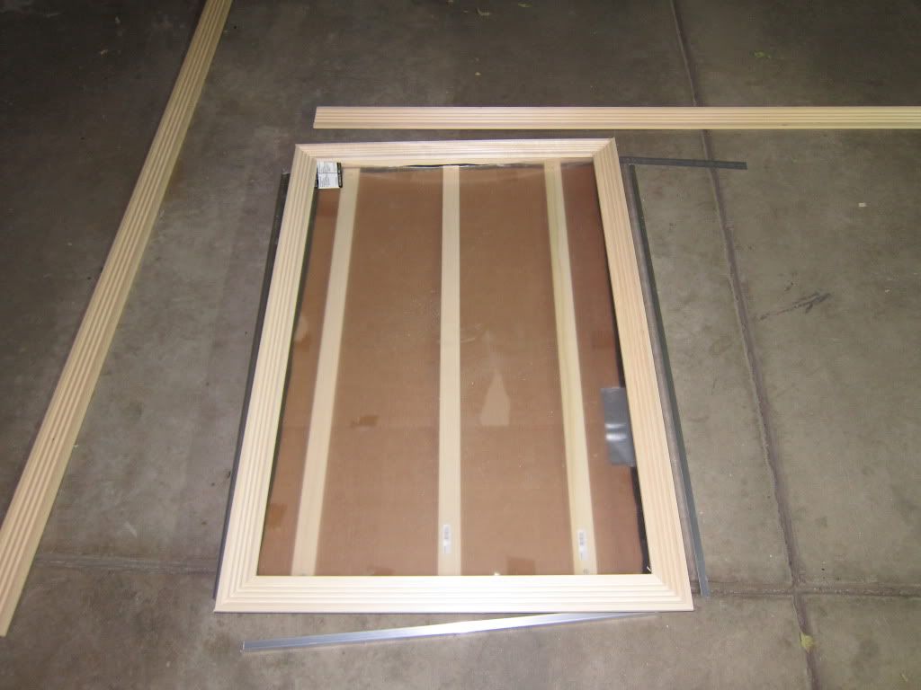

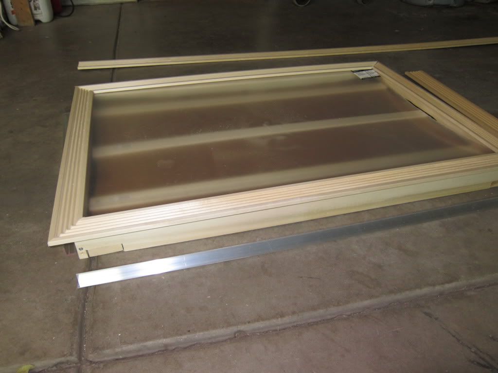

Update!
Spent all Saturday creating this guys frame
I also stapled in some card board in the back and using electric tape for the edge so light won’t escape. I cut the metal frame that will hold the plexie glass to the frame as well. I also found some light cool looking border trim at Home Depot. I made 45 degree cuts with my miter saw and made a frame from it. I will also use it on the sides of the box. Picture is just laying everything on top to show how it will look.
the 3 sticks in the middle is where I am going to mount my 3 sets of Nova LED’S  as soon as they arrive in the mail.

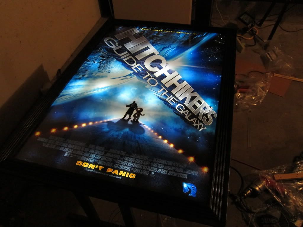

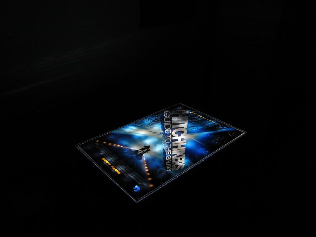

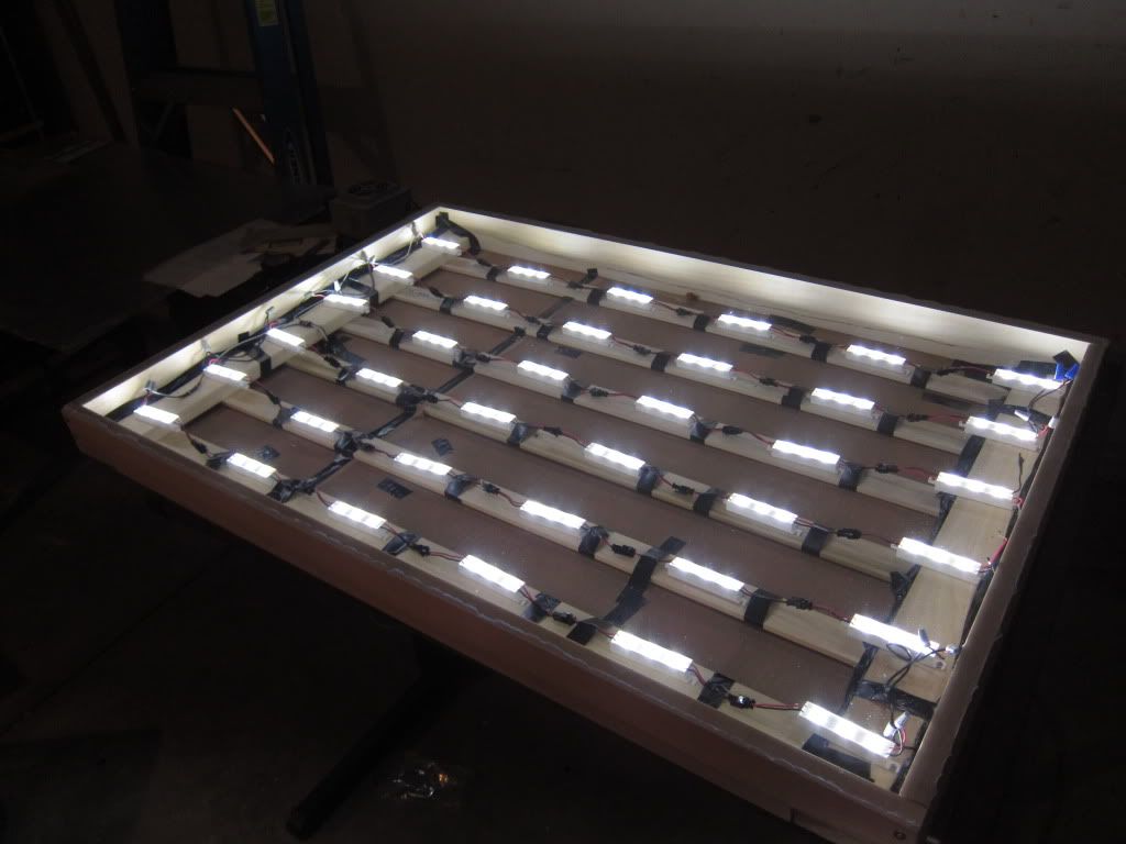

Update!
I ran into some problems. The 3 sets of Nova Leds was not enough. Plus I guess I had them to closr to the fram. They were creating hot spots and not lighting much around the hotspot. I had to re-work everything. I had to mount them farther back and add 6 sets instead of 3
Picture of laying a poster on top
Picture of laying the fram I made on top of the poster.

Bender
  • Posts: 1919
I'd try a diffuser panel from a fluorescent light.  You've done a great job so far, but those hot spots really don't look that great...
+1
Also paint EVERYTHING inside white including that black tape between each light which is just exacerbating the problem
+1
Maybe covering the tape with some reflective foil tape for sealing ductwork would be an easier route than painting tape. Or just retape with white electrical tape. I just see painting the wiring and tape as a messy disaster. :dunno

Ya I guess I will have to go Fluorescent. The led's just are not giving a strong enough light  for diffusers.

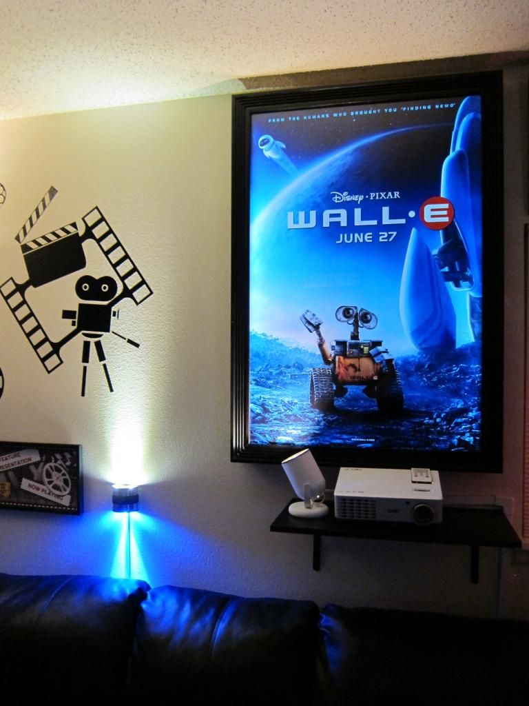

Re: Building a double sided poster light box for there Theater\Media\Game Room
« Reply #23 on: December 03, 2012, 07:00:35 am »
  • Posts: 4520
« Reply #24 on: December 03, 2012, 08:53:37 am »
Neat.  Any pics?

Looks great, for the marquee in my cab I simply stuck strips of LED lighting wired in serial on a 1/8" board, gives a very solid fill light without any hotspots despite being only 2" from the surface. It's cheap at less than a dollar a foot, looks like your solution came out well though too.
